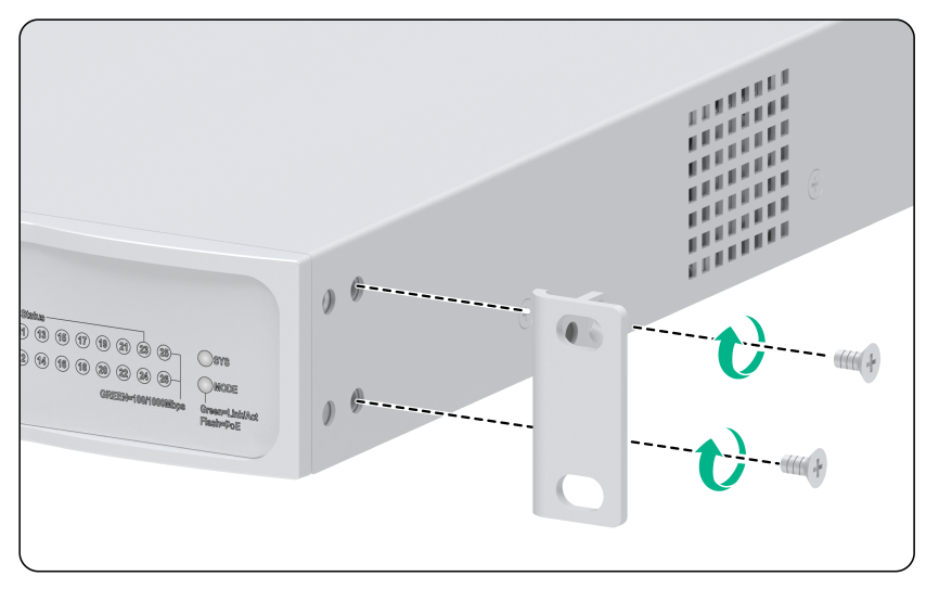

Front mounting bracket kit, including a pair of front mounting brackets and four M4 screws

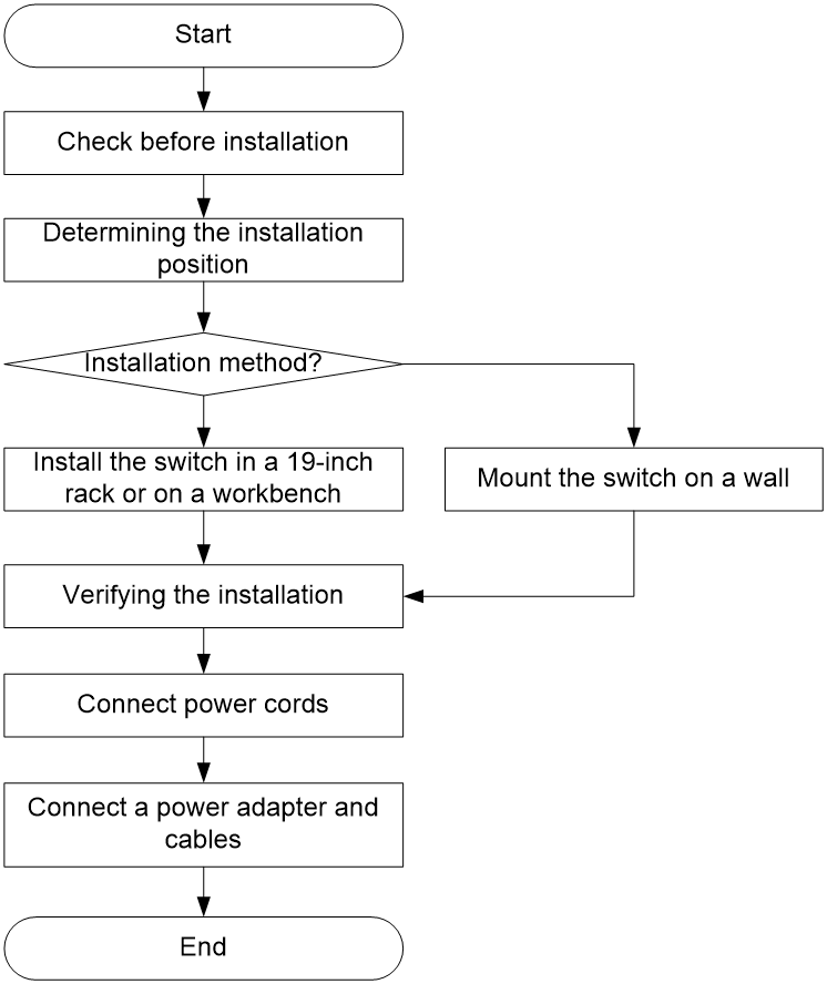

Installation flowchart
Figure 1 Installation flowchart

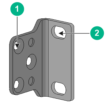

About mounting brackets
The S1600V2 series switches that this installation method come with mounting brackets, as shown in Figure 2.
Figure 2 Mounting bracket
(1) Screw hole for attaching the bracket to the switch
(2) Screw hole for attaching the bracket to the rack

To attach the mounting brackets to the switch:
1.     Align the mounting bracket installation holes with the screw holes in the chassis.
2.     Fasten the M4 screws (provided) to secure the mounting bracket to the switch, as shown in Figure 3.
The attachment methods for the mounting bracket are similar. This example attaches only one mounting bracket to one side of the switch.
Figure 3 Attaching the mounting brackets to the switch

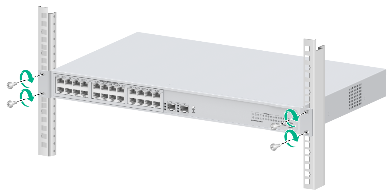

Mounting the switch in the rack
This task requires two people.
To mount the switch in the rack:
1.     Wear an ESD wrist strap and make sure it makes good skin contact and is reliably grounded.
2.     Verify that the mounting brackets have been securely attached to the switch chassis.
3.     Attach cage nuts to the front rack posts.
4.     One person supports the bottom of the switch, and moves the switch to an appropriate position based on the installation positions of the mounting brackets.
5.     Another person uses user-supplied M6 screws and cage nuts to attach the mounting brackets to the rack and verifies that the brackets are level and secure. As a best practice, use a torque of 30 kgf-cm (2.94 Nm) to fasten the M6 screws.
Figure 4 Mounting the switch in the rack

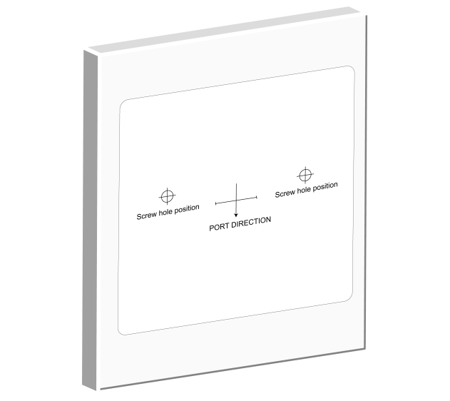

1.     Affix the installation positioning sticker horizontally to the wall with the arrow on it facing downwards.
Figure 5 Installation positioning sticker

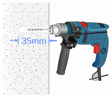

2.     Drill two holes with a diameter of 6 mm (0.24 in) and a depth of 35 mm (1.38 in) at the screw hole locations on the positioning sticker, and then remove the positioning sticker.
Figure 6 Drilling holes on the wall

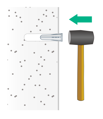

3.     Insert a screw anchor into each hole, and tap the screw anchor with a rubber hammer until it is all flush with the wall surface.
Figure 7 Securing the screw anchors

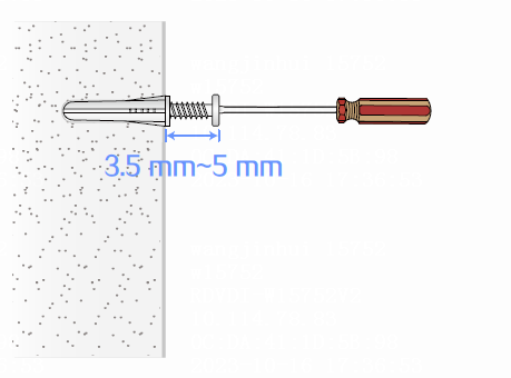

4.     Fasten a screw into each screw anchor. Leave 3.5 to 5 mm (0.14 to 0.20 in) between the screw head and the wall for hanging the switch.
Figure 8 Fastening a screw into a screw anchor

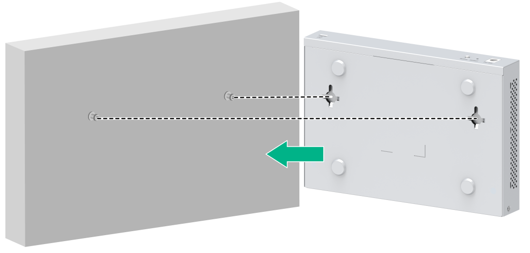

5.     Align the installation holes in the switch with the screws on the wall. Make sure the port side faces downwards. Hang the switch on the screws and slide the switch down until the screws seat securely in the installation holes.
Figure 9 Wall-mounting the switch (1)
Figure 10 Wall-mounting the switch (2)

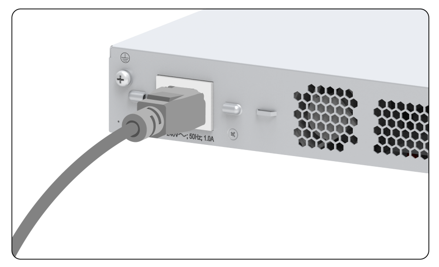

Connecting the AC power cord
1.     Connect the female connector of the AC power cord to the AC-input power receptacle on the switch, as shown in Figure 13.
2.     Use a cable tie to secure the power cord to the handle near the AC-input power receptacle, as shown in Figure 14.
3.     Connect the other end of the AC power cord to an AC power source.
Figure 13 Connecting the AC power cord (1)
Figure 14 Connecting the AC power cord (2)

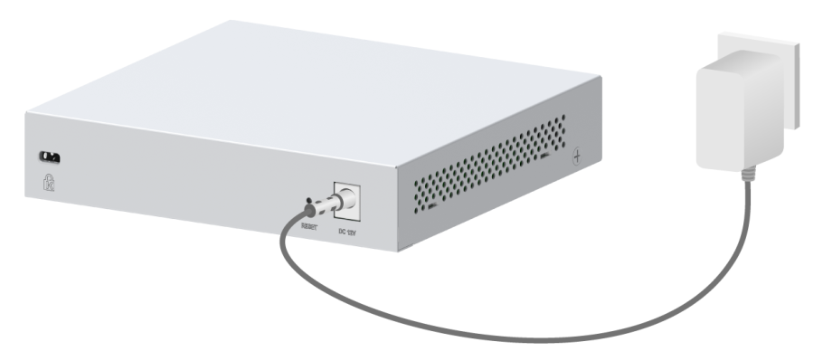

Connect a power adapter
The figure in this section is for your reference only. The power adapter appearance varies by country or region.
The switch supports the following types of power adapters and the supported power adapter varies by switch model:
·     Type-1 power adapter: A type-1 power adapter can meet the power supply requirements.
·     Type-2 power adapter: A type-2 power adapter must be connected to an AC power cord to supply power.
To connecting a power adapter:
1.      Connect the power adapter to an AC power cord. (This step is only applicable to a type-2 power adapter.)
2.     Insert the circular plug of the power adapter into the power adapter receptacle on the switch.
3.     Connect the other end of the power adapter to an external AC power source.
Figure 15 Connecting a type-1 power adapter
Figure 16 Connecting a type-2 power adapter
