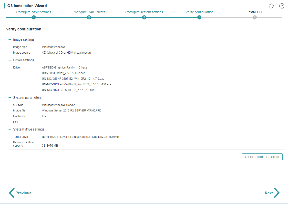

Installing an OS and drivers through iFIST
Mounting an OS image and REPO file

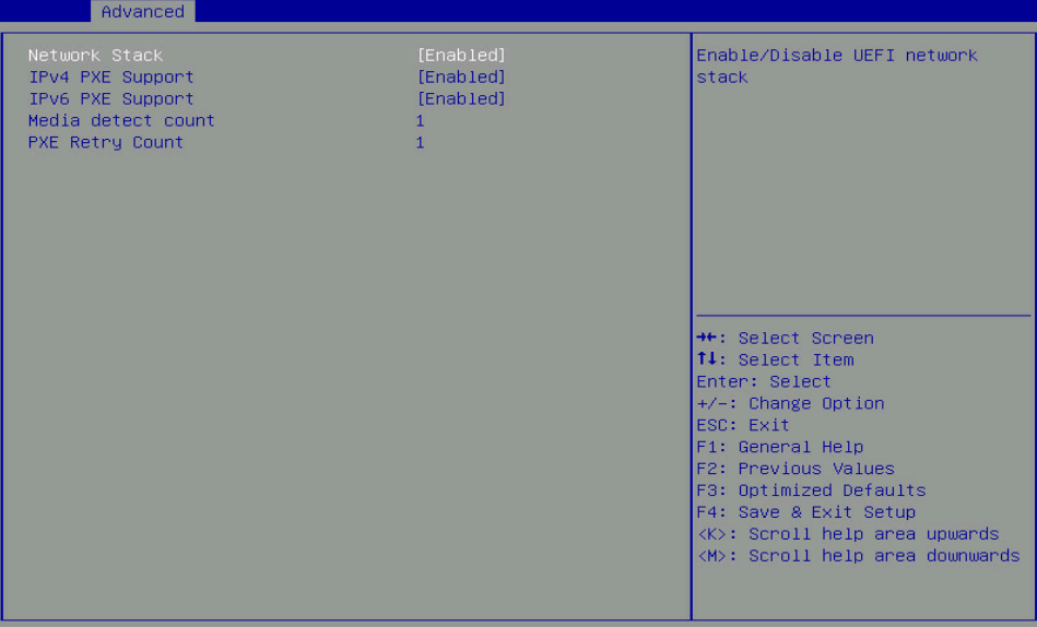

PXE is enabled by default and cannot be disabled if the BIOS boot mode is Legacy. This section describes how to enable PXE in UEFI boot mode. For more information about BIOS boot modes, see "Setting the BIOS boot mode."

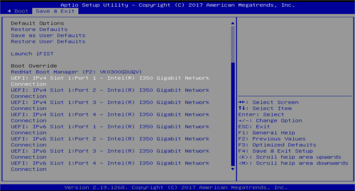

To enable PXE:
1. Enter the BIOS Setup Utility.
2. Click the Advanced tab, select Network Stack Configuration, and then press Enter.
3. Set Network Stack, IPv4 PXE Support, and IPv6 PXE Support to Enabled (Enabled by default).
4. Access the Advanced > Network PXE Control screen. Then, enable PXE on each port (Enabled by default).
Figure 6 Enabling PXE on network ports
5. Press F4 to save the configuration and reboot the server.
6. Click the Save & Exit tab, and then select the boot option for PXE in the Boot Override area.
¡ For UEFI boot mode, select the port connecting to the PXE server. In this example, port 1 connects to the PXE server.
Figure 7 PXE boot options in UEFI boot mode
¡ For Legacy boot mode, select the only option. All ports on the network adapter share the same PXE boot option.
Figure 8 PXE boot options in Legacy boot mode

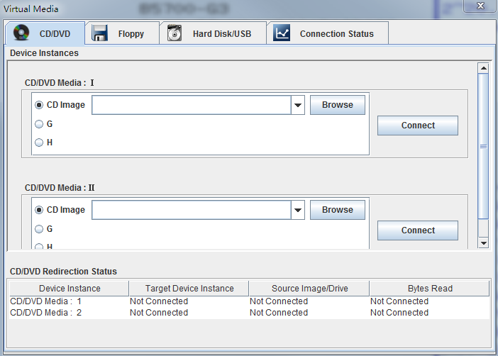

Mounting an OS image through a remote console
IMPORTANT: To avoid OS installation failure caused by connection errors in a WAN, mount an OS image in the same LAN as the server. |
This section mounts a virtual CD/DVD.
To mount an OS image through a remote console:
1. Log in to the server from the HDM console.
2. Select Media > Virtual Media Wizard from the navigation bar.
3. Click the CD/DVD tab, and then click Browse in the CD/DVD Media: I area. In the dialog box that opens, select a CD/DVD file, and then click Open.
Figure 10 Selecting a CD/DVD file
4. Click Connect to complete mounting the CD/DVD image file.
5. Display the mounted image. Enter the BIOS Setup Utility, and then click the Save & Exit tab. If you can find the mounted image file in the Boot Override area, the file has been mounted successfully.
Figure 11 Displaying the mounted image

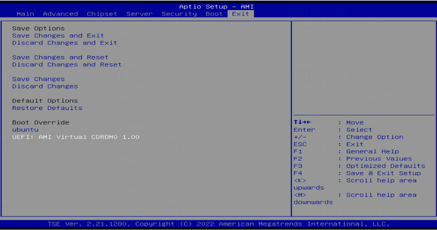

The server supports two BIOS boot modes: Legacy and UEFI. By default, the boot mode is UEFI. Support for the BIOS boot modes varies by operating system. For more information, see the operating system compatibility matrixes for the server.
IMPORTANT: · To install the OS on an NVMe SSD, you must set the BIOS boot mode to UEFI. · In Legacy mode, DCPMMs cannot be used for operating system installation. · To use the Legacy mode, configure the first boot drive, and install the OS on the drive. For more information, see configuring boot options in H3C Servers Storage Controllers User Guide. |

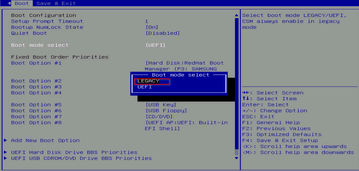

To set the BIOS boot mode:
1. In the BIOS Setup Utility, click the Boot tab, select Boot mode select, and then press Enter.
Figure 12 Setting the BIOS boot mode
2. Select the Legacy or UEFI mode, and then press Enter.
Figure 13 Selecting a BIOS boot mode
3. Press F4 to save the configuration and reboot the server.

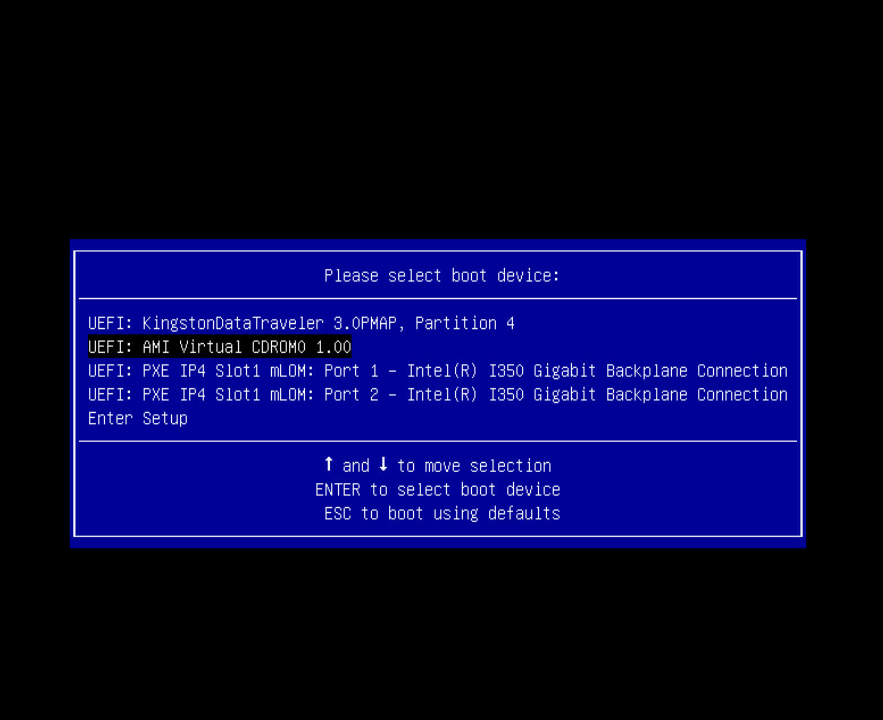

Selecting the boot media

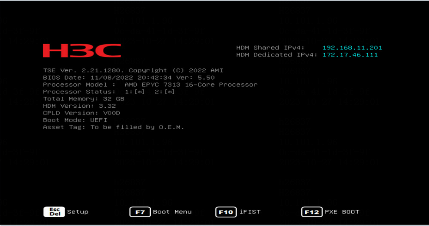

1. Start the server, and press F7 at the prompt, as shown in Figure 14.
2. Select the boot media that contains the OS image. This section provides figures for selecting physical optical drive GK-DT-STDVDRAM and virtual media AMI Virtual CDROM0 mounted from the remote console as examples.
Figure 15 Selecting physical optical drive GK-DT-STDVDRAM as the boot media
Figure 16 Selecting virtual media AMI Virtual CDROM0 as the boot media

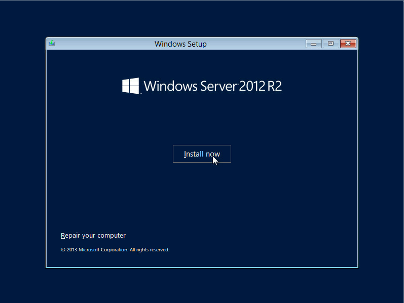

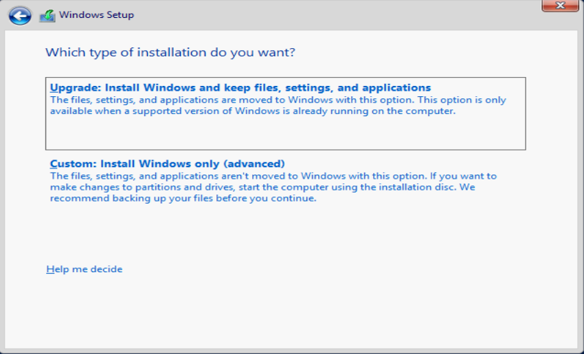

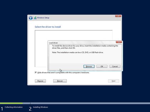

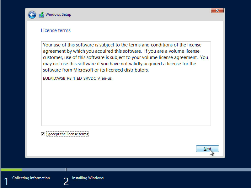

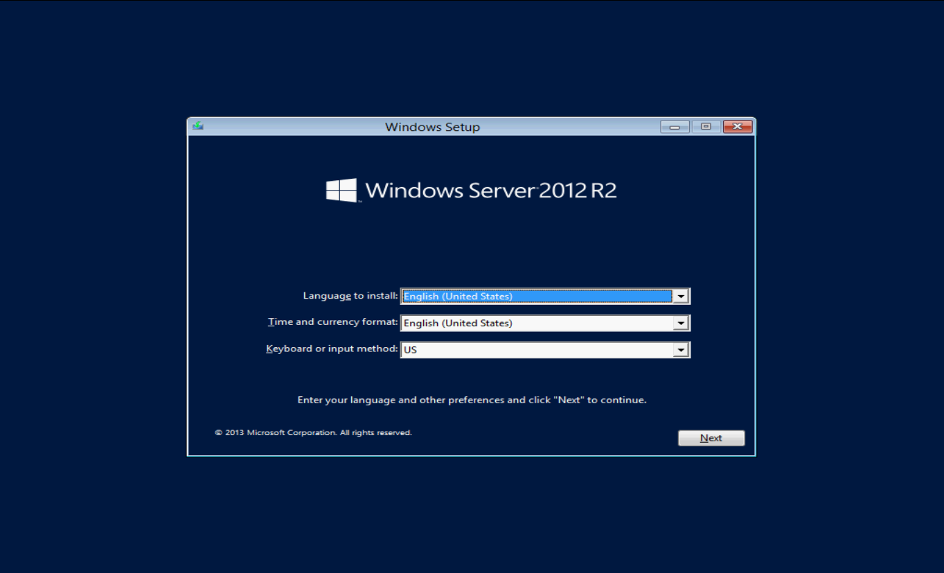

Installing a Windows Server OS
The installation procedure is the same for different Windows Server OS versions. This section installs Windows Server 2012 R2 and the storage controller driver.

1. Enter the BIOS and select boot options. For more information, see "Selecting the boot media."
2. Set the language, time, and keyboard layout, and then click Next, as shown in Figure 17.
Figure 17 Setting the language, time, and keyboard layout
3. Click Install now.
Figure 18 Starting installing Windows Server

5. Select I accept the license terms, and then click Next.
6. Select an installation type, Custom or Upgrade.
To install a new OS, select Custom. To upgrade your OS, select Upgrade.
This example selects the Custom type.
Figure 21 Selecting an installation type

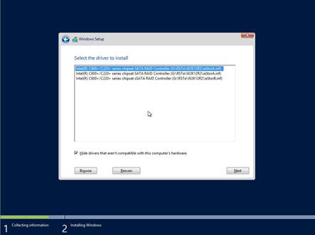

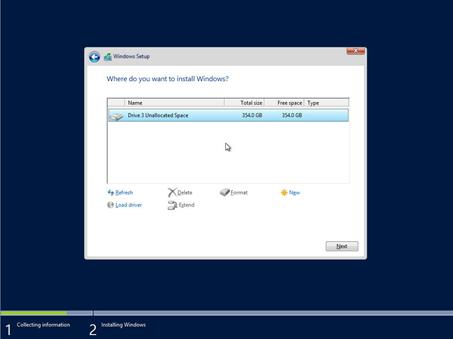

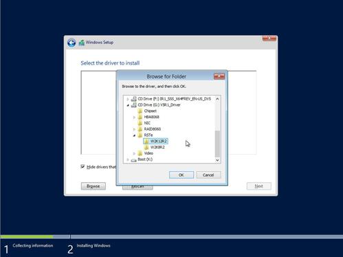

7. Click Load Driver, and then click Browse.
CAUTION: Load the storage controller driver when installing a Windows Server OS to avoid the following issues: · The disk cannot be detected (see Figure 22). · The OS cannot be accessed after installation. |
8. Select the path where the driver is located, and then click OK.
Figure 24 Selecting the driver path
9. Select the driver to install, and then click Next.
10. Select the destination drive to install the OS, and then click Next.
Figure 26 Loading storage controller driver completed

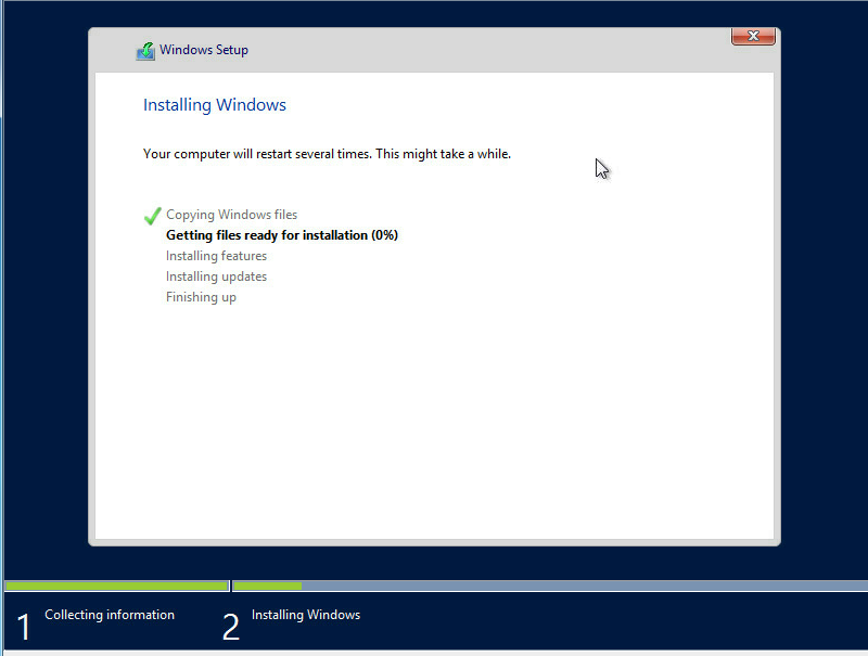

11. Wait for the system to complete OS installation.
Figure 27 Installing the OS

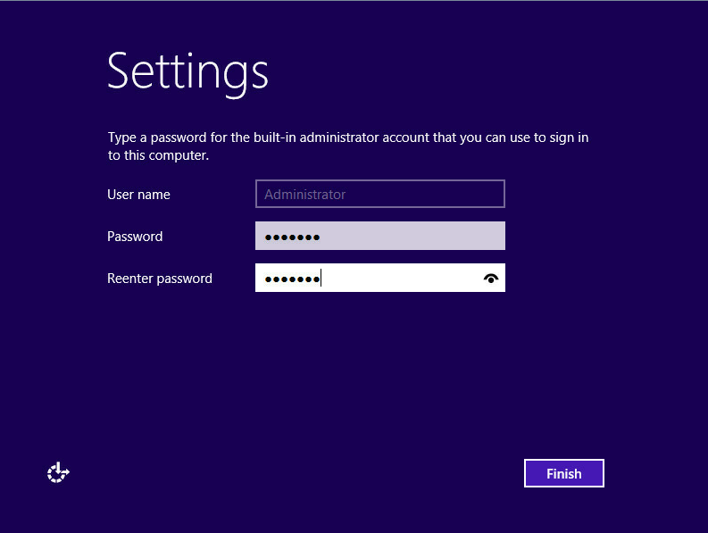

12. Set the password, and then click Finish after the system completes installation and enters the Settings page.
The user name is Administrator, which cannot be modified.
Figure 28 Setting the password

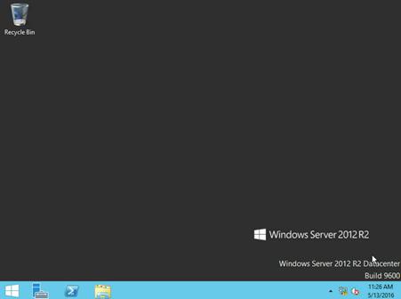

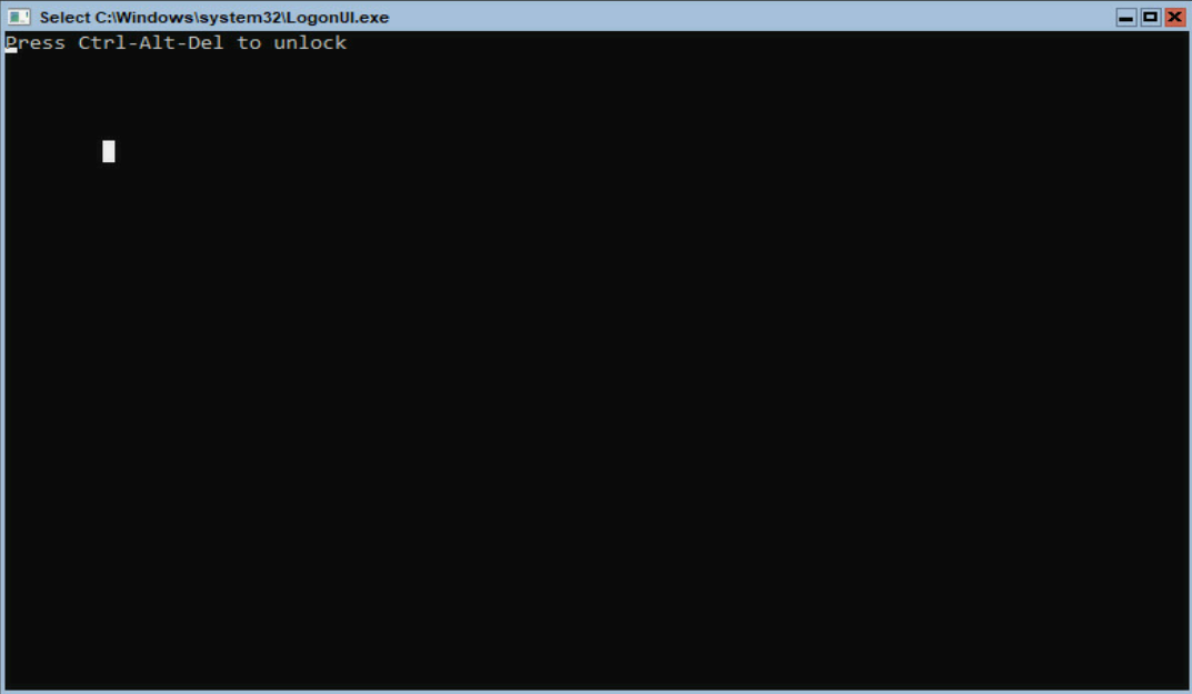

13. Press Ctrl+Alt+Delete on the keyboard of the remote console as prompted.
Figure 29 OS installation completed

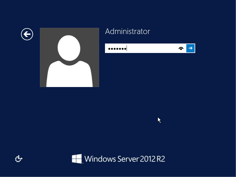

14. Enter the administrator password.
For the OS to correctly identify hardware devices, install the Chipset driver after OS installation.
Figure 30 Entering the administrator password

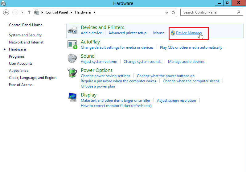

The CPU on the server supports QAT, if Device Manager displays the following:
To use QAT, contact Intel Support.

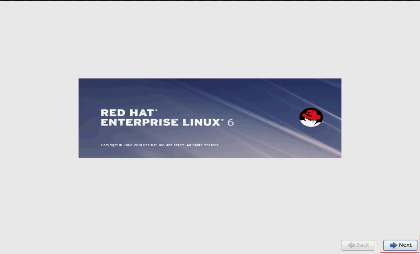

To install a Red Hat/CentOS 6.x OS:

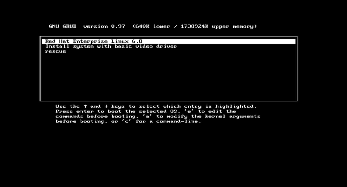

2. Select Red Hat Enterprise Linux 6.8, and then press e as prompted, as shown in Figure 32.
Figure 32 Confirming OS installation

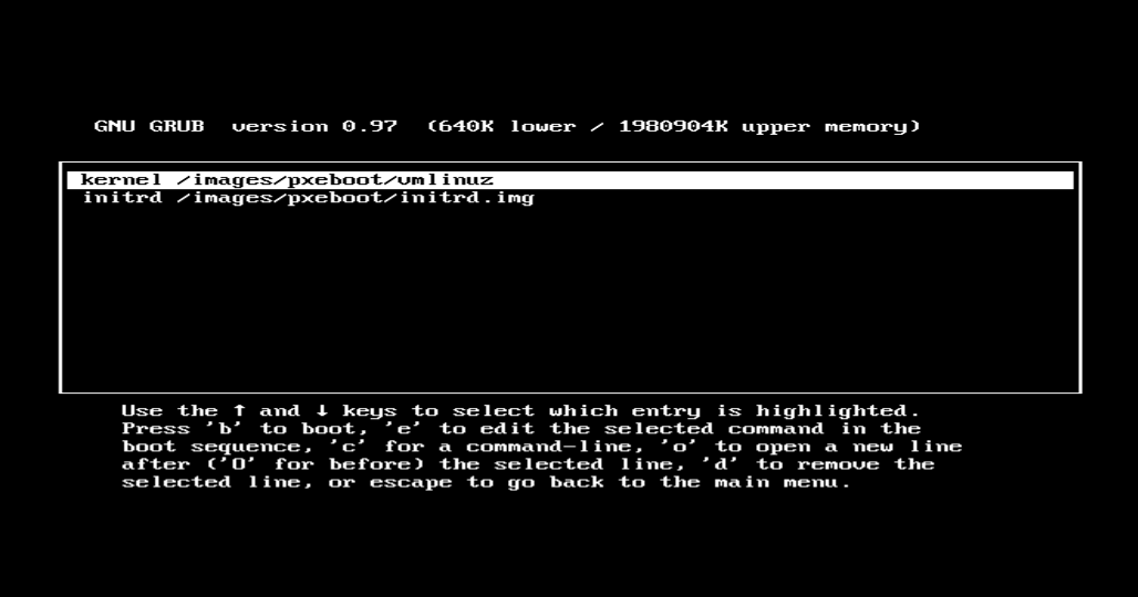

3. Select the line that starts with kernel, and then press e.
Figure 33 Selecting the line that starts with kernel

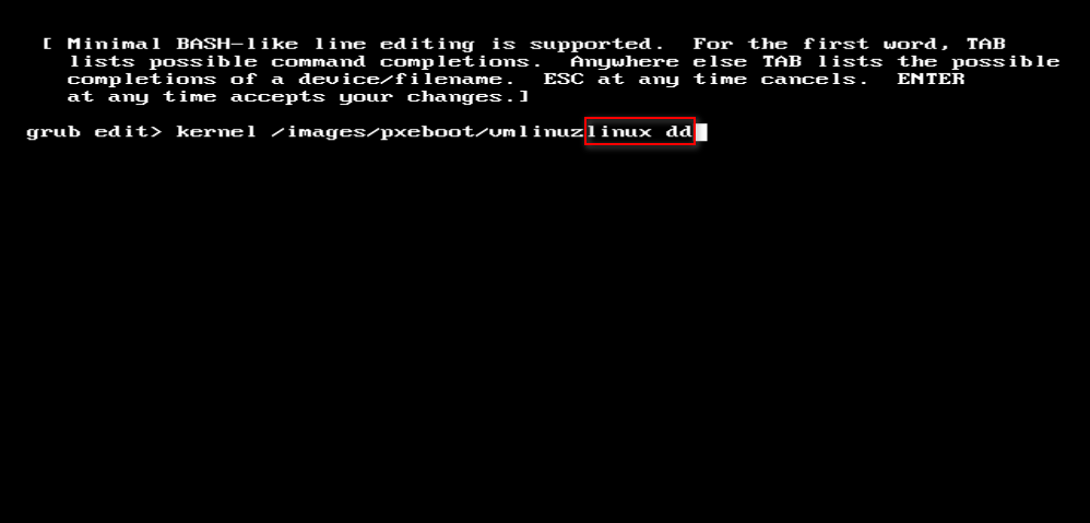

4. Input the linux dd command, and then press Enter. Then press b to start installation.
Figure 34 Entering the kernel page

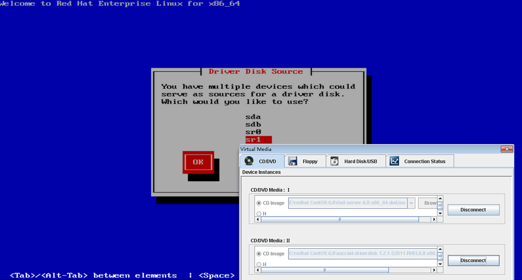

5. On the page that opens, select Yes.

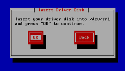

Figure 35 Selecting a driver disk
6. Select the mirrored interface to mount the driver disk.
Figure 36 Selecting the mirrored interface
7. Click OK.
Figure 37 Confirming the next step

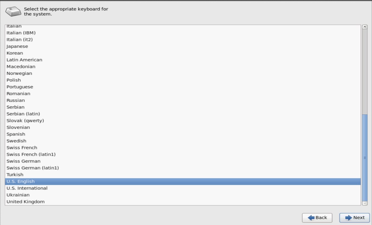

12. Select the keyboard, and then click Next.
Figure 42 Selecting the keyboard

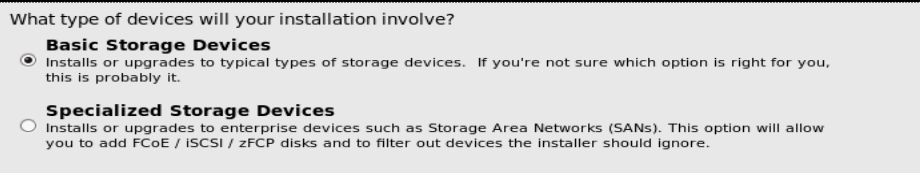

13. Select the device type, Basic Storage Devices or Specialized Storage Devices, and then click Next.
This example selects Basic Storage Devices.
Figure 43 Selecting the device type

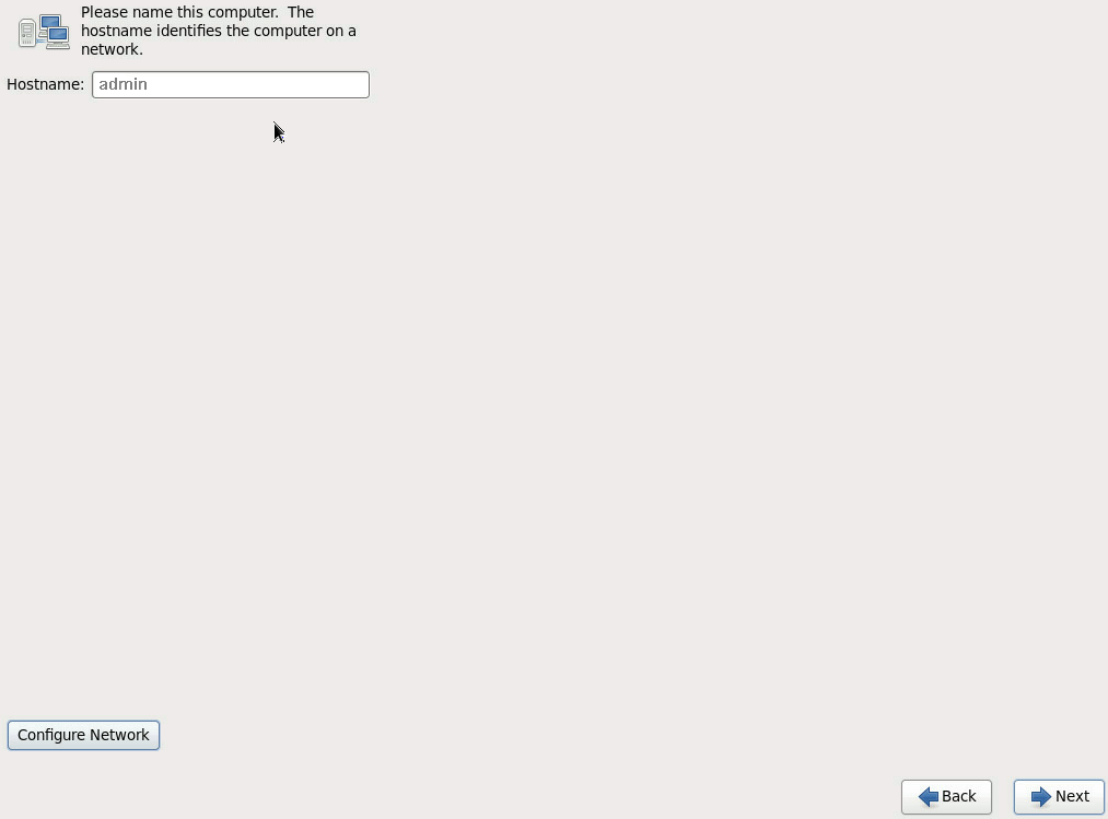

14. Enter the host name in the Hostname field, and then click Next.
To configure the network, click Configure Network on the lower left corner of the page. This example does not configure the network.
Figure 44 Setting the host name

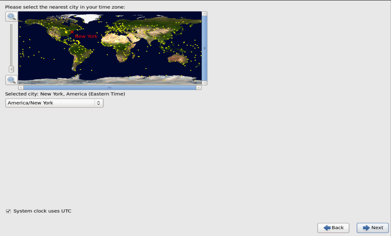

15. Select your time zone, and then click Next.
Figure 45 Selecting your time zone

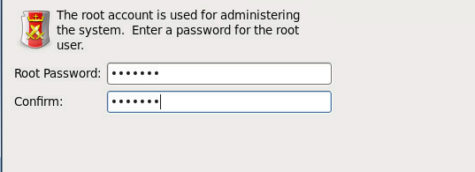

16. Set the root password, and then click Next.
Figure 46 Setting the root password

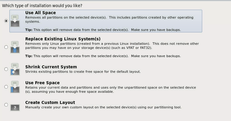

17. Select the type of installation, and then click Next. This example selects Use All Space.
Figure 47 Selecting the type of installation

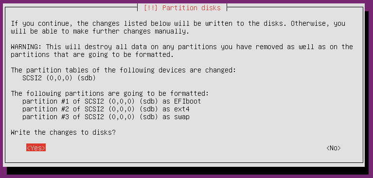

18. Back up all data on the disk, and then click Write changes to disk to format the disk.
Figure 48 Confirming the formatting operation

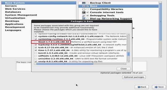

19. Select a server type and additional repositories, select Customize now, and then click Next.
The following server types are available:
¡ Basic Server—Base, without GUI.
¡ Database Server—Base, plus MySQL database, without GUI.
¡ Web Server—Base, plus PHP, Web server, and MySQL database client, without GUI.
¡ Identity Management Server.
¡ Virtualization Host—Base, virtualization platform.
¡ Desktop—Basic desktop, including commonly-used desktop software.
¡ Software Development Workstation—Includes base, virtualization platform, desktop platform, and development tools.
¡ Minimal—Core.

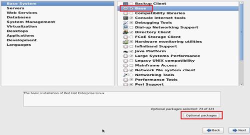

20. Select Base, and then click Optional packages.
Figure 50 Server installation options
21. Click Close, and then click Next. For the OS to start correctly, make sure the boot package is not selected if the BIOS boot mode is UEFI.

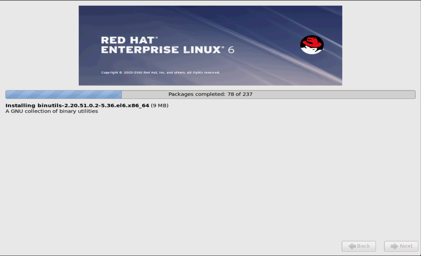

Figure 52 Installing the OS
22. Click Reboot to reboot the server.

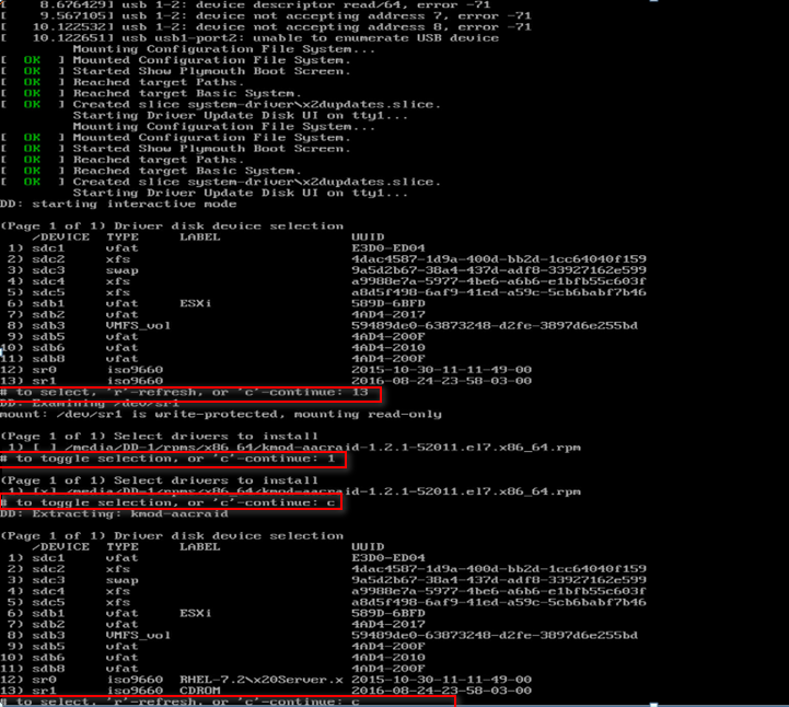

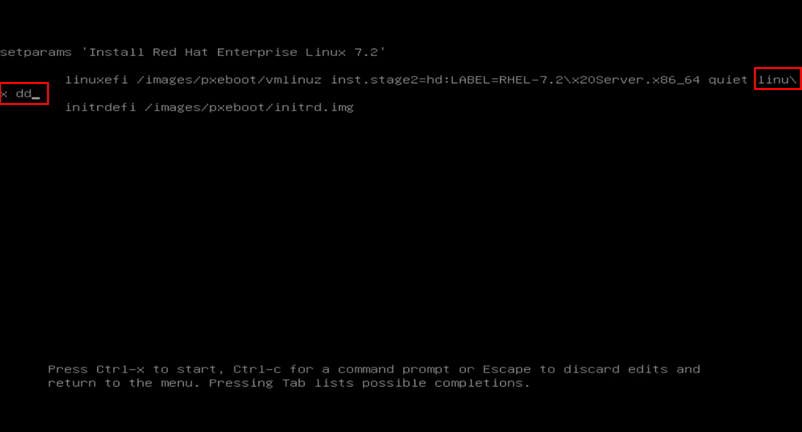

Installing a Red Hat 7.x, Red Hat 8.x, CentOS 7.x, or CentOS 8.x OS
The installation procedures are similar for Red Hat 7.x, Red Hat 8.x, CentOS 7.x, and CentOS 8.x OSs. This section installs Red Hat Enterprise Linux 7.2 and the storage controller driver.
Make sure both the OS image and the storage controller driver file have been mounted to the server. You can mount a file to the server through a CD/DVD, USB disk, or virtual media.

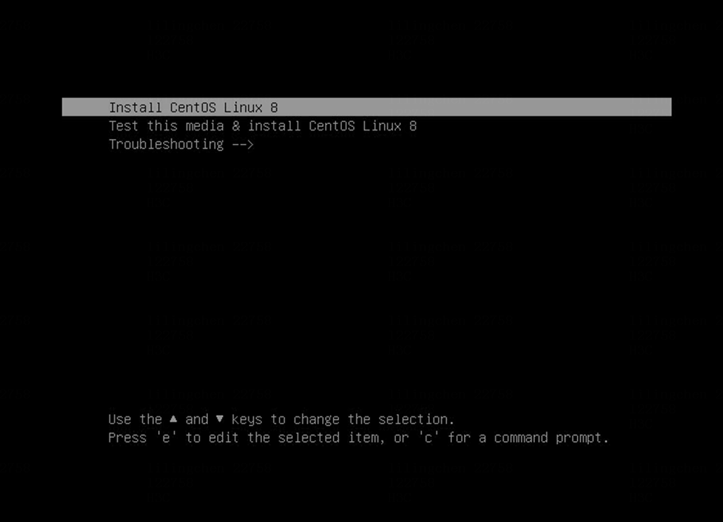

To install a Red Hat/CentOS 7.x OS:
2. Select Red Hat Enterprise Linux 7.2, and then press e as prompted, as shown in Figure 55.
Figure 55 Confirming OS installation
3. Input linux dd at the end of the line that starts with linuxefi, and then press F10 or Ctrl+X to start installation.
Figure 56 Parameter configuration
4. Perform the following steps to configure the parameters:
a. Display the location of the driver. In this example, sr1 has a driver mounted, so you select 13.
b. Enter 1 to select the rpm file.
c. Enter c to continue installation.
If not all drivers are listed on the page, enter r to refresh the driver list.
Figure 57 Parameter configuration

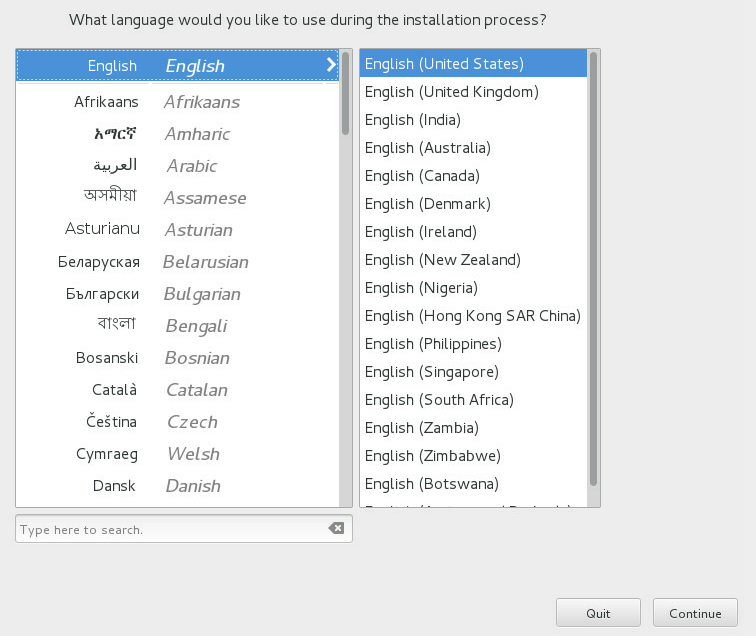

5. Select the system language, and then click Continue.
Figure 58 Selecting the language

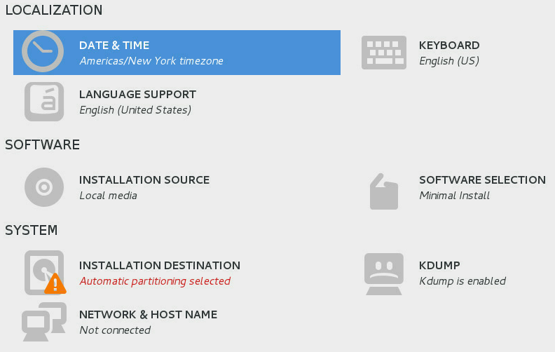

6. Configure the options in Figure 59 as required.
If an icon has a
mark, it indicates that the configuration is incorrect, and you must
reconfigure the option.
The following describes only the steps for specifying a destination disk. The default settings are used for other options.
Figure 59 Option configuration

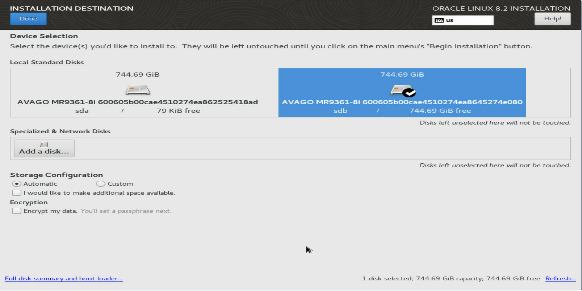

7. Click INSTALLATION DESTINATION. Select the disk where the OS is to be installed, and then click Done.
This example uses automatic partitioning. To use manual partitioning, select I will configure partitioning.
Then you must select Standard Partition from the New mount points will use the following partitioning scheme list for successful OS installation.
If you select manual partitioning in UEFI boot mode, you must create the /boot/efi partition, and the files in the partition must be in efipartition or fat format. If you do not do so, an error will occur during OS installation.
Figure 60 Selecting the disk to install the OS

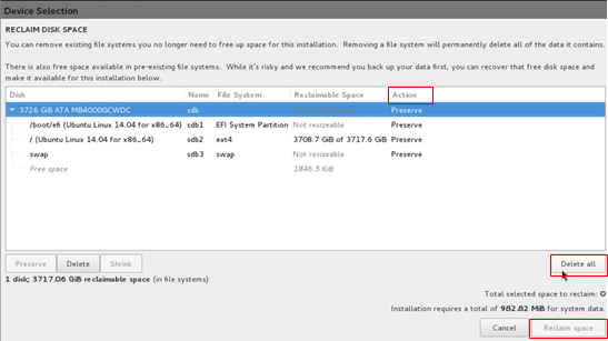

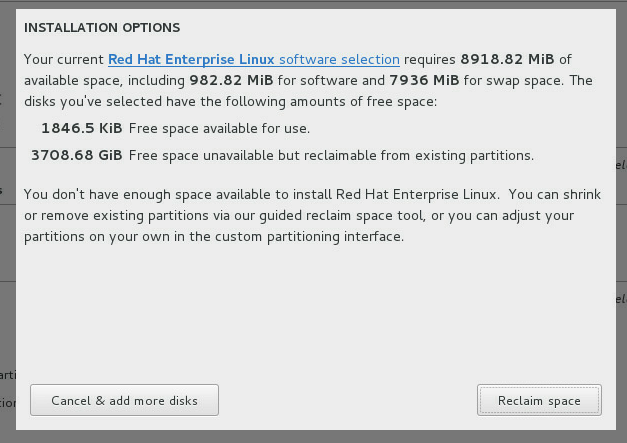

8. Click Reclaim space to format the disk when the following dialog box appears.
Figure 61 Confirming the formatting operation
9. Click Delete all. When the status in the Action column changes to Delete, click Reclaim space to delete all partitions.
Figure 62 Deleting the current partitions

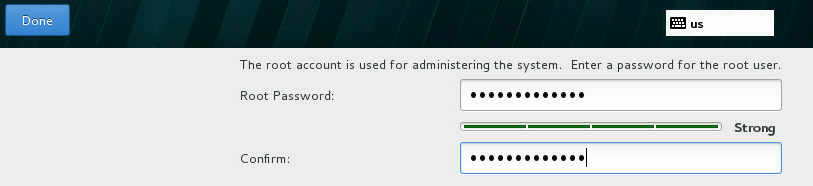

11. Click ROOT PASSWORD.
12. Enter the root password, and then click Done. If the password is too simple, the system gives a prompt. To accept the simple password, click Done twice.
Figure 65 Setting the root password
NOTE: As a best practice, set a root password to one with the Strong security level. |

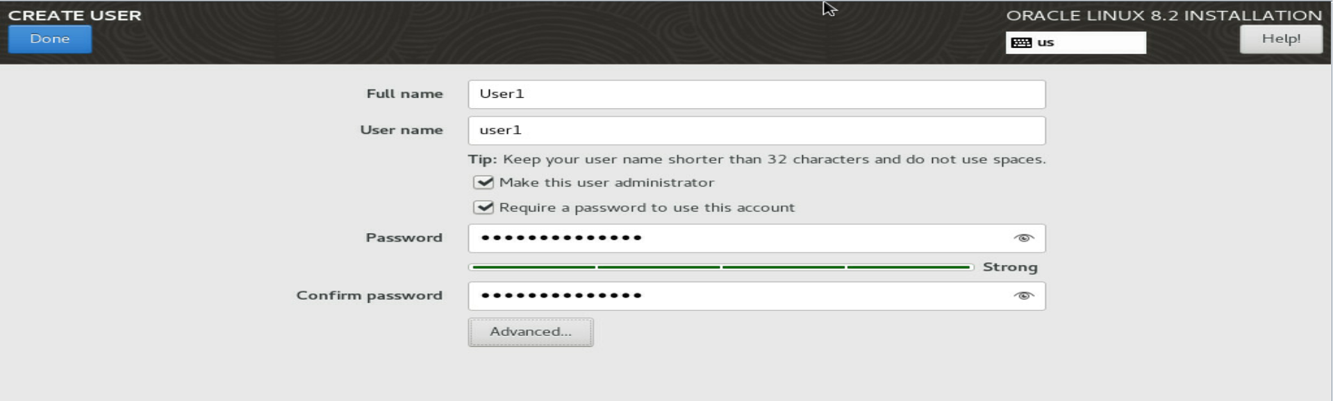

13. Click USER CREATION, create a new user account, set the password, and then click Done. If the password is too simple, the system gives a prompt. To accept the simple password, click Done twice.
Figure 66 Creating a user account

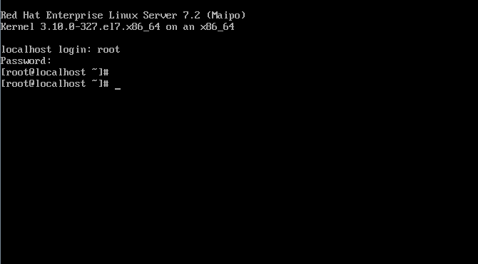

15. Click Reboot to reboot the server after the installation is complete.
Figure 68 Rebooting the server
Figure 69 Logging in to the OS

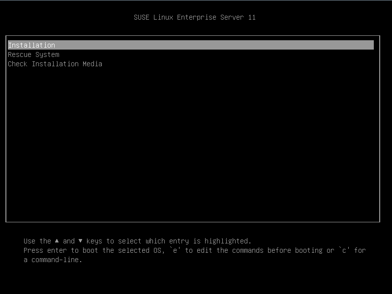

To install an SUSE 11 SP4 OS:
2. As shown in Figure 70, click Installation, and then press E.
Figure 70 Confirming OS installation
3. Open the soft keyboard, and press Ctrl+Alt+F2 to enter the CLI console.
Figure 71 Entering the CLI console
4. Enter the modinfo aacraid command to identify whether the driver has been installed successfully. Press Ctrl+Alt+F7 to continue OS installation.

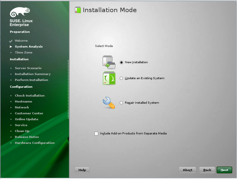

8. Select an installation mode and then click Next. This example selects New Installation.
Figure 75 Selecting an installation mode

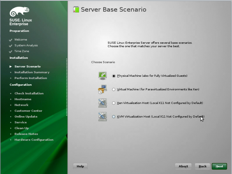

10. Select the server base scenario, and then click Next. As a best practice, select Physical Machine for new installation.
Figure 77 Selecting the server base scenario

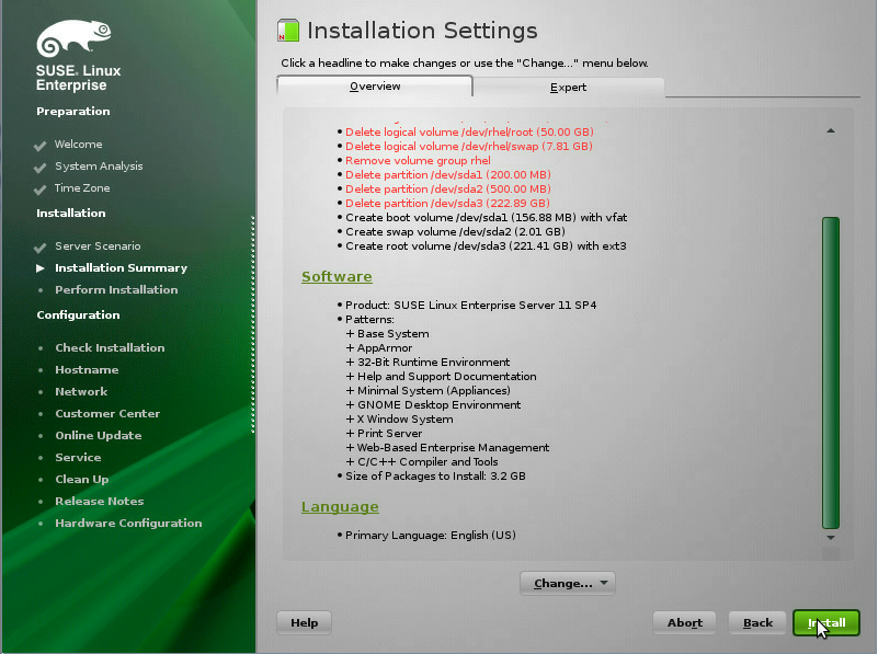

11. To use the default settings, click Install. The system will start OS installation.

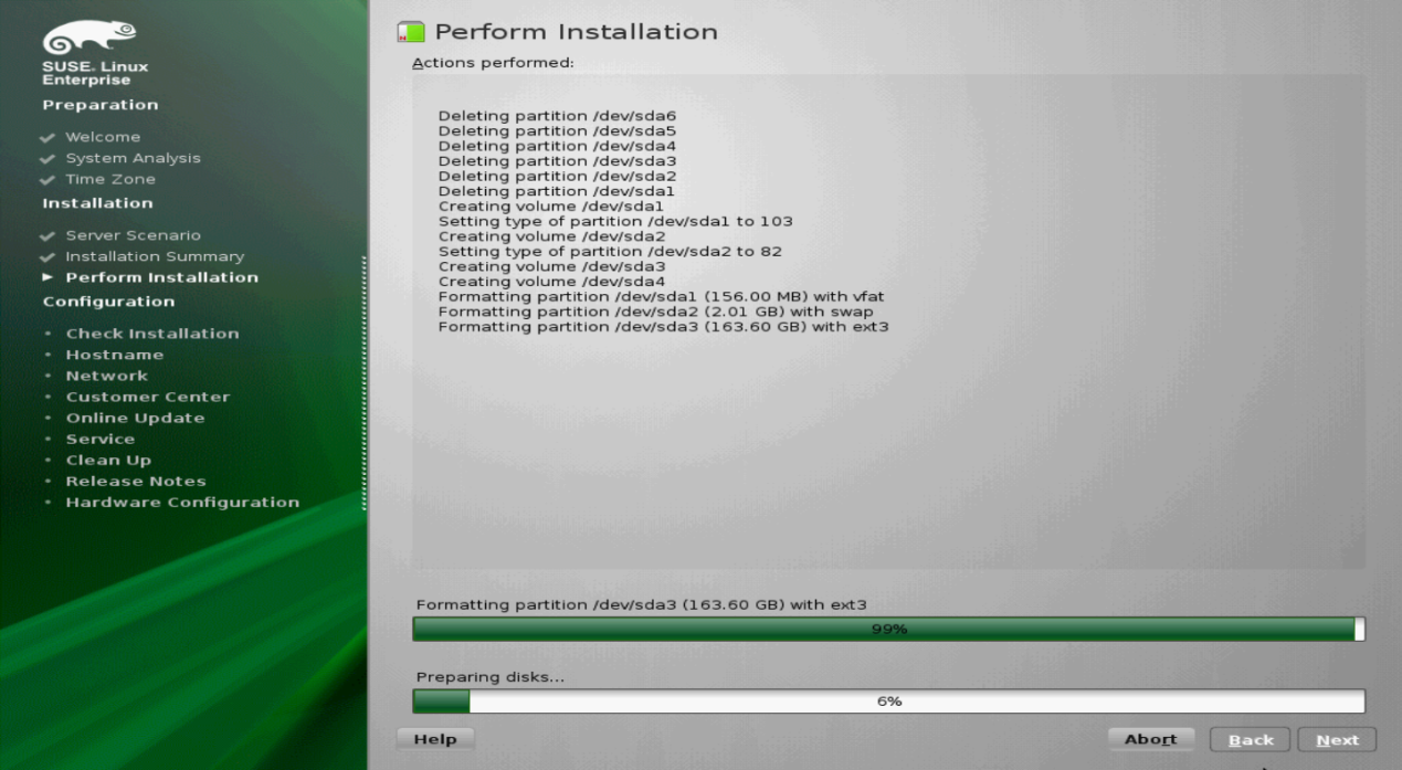

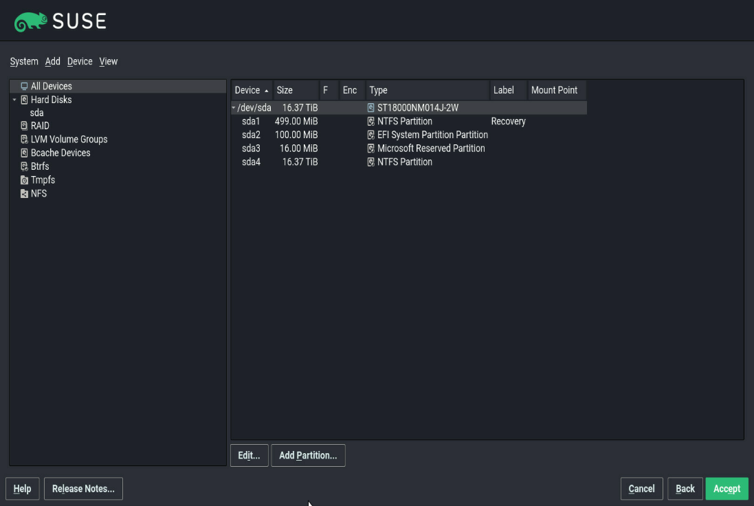

12. To manually partition the disk:
a. Click Partitioning, on the Preparing Hard Disk page select a partitioning method, and then click Next.
If you select 1.IDE Disk, the system will automatically partition the disk based on the size of the disk. If you select Custom Partitioning, you can manually partition the disk as needed. This example selects Custom Partitioning.
Figure 79 Preparing hard disk

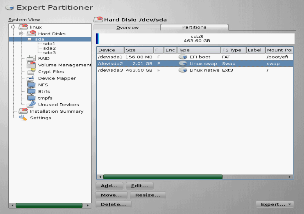

b. From the left navigation tree, select Hard Disks > sda.
The following partitions must be added:
- swap—Switching partition to implement virtual memory. As a best practice, set its size to one or twice of the physical memory.
- /boot/efi—System boot file partition. It must be in the efi partition or fat format. As a best practice, set the size to 100 MB to 200 MB.
- /—Root partition to save system software and files.
Figure 80 Partitioning the disk
c. Click Add. On the page that opens, set the partition size, and then click Next.
d. Select a file system and mount point, and then click Finish.
Figure 82 Setting the partition
e. To install software, click Software. On the page that opens, select software and set system tasks, and then click OK.
13. Click Install.
14. After the installation is complete, click Next. The system will automatically reboot.
Figure 85 Performing installation

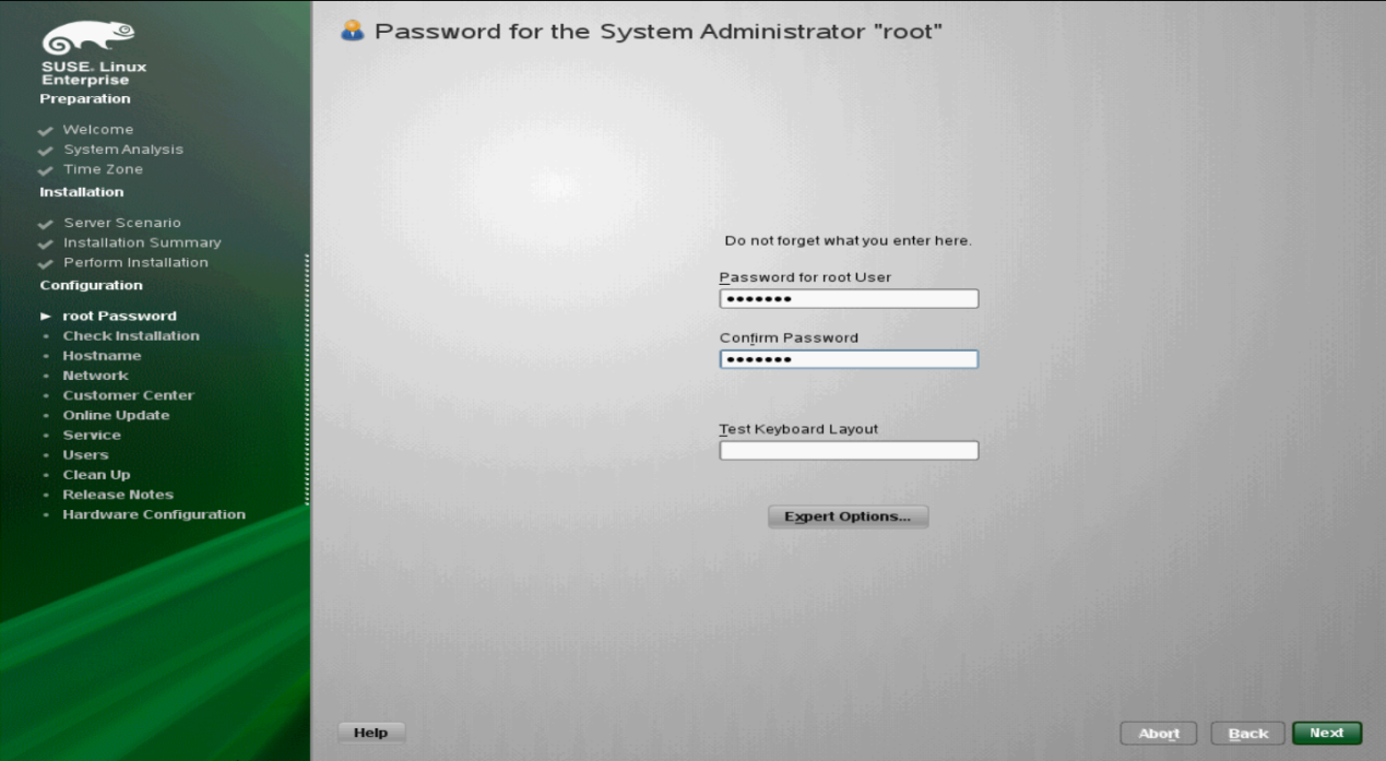

15. Set the root password, and then click Next when the following page appears.
Figure 87 Setting the root password

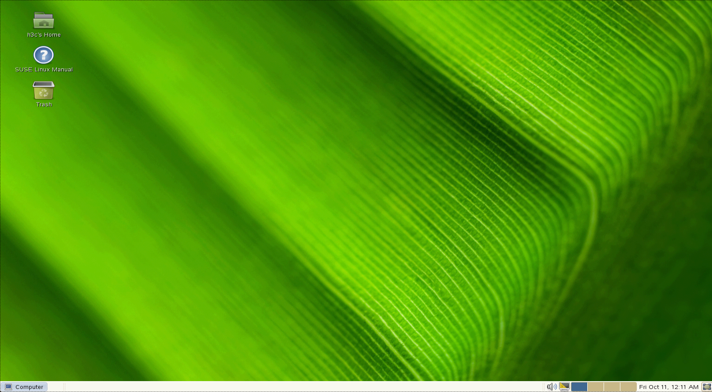

The suse 12xxxx and UEFI OS and suse linux xxx boot options will appear on the BIOS Setup Utility for an SUSE 12 OS and SUSE 11 OS, respectively.
Figure 88 OS installation completed

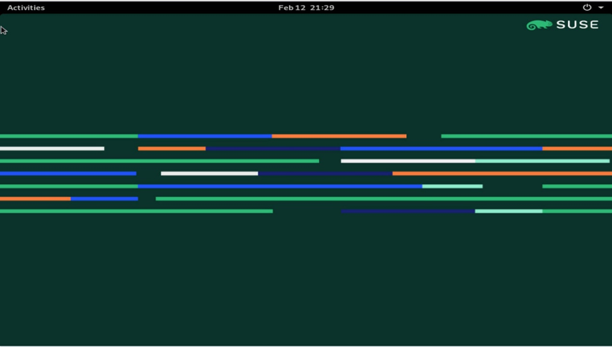

Installing an SUSE 15 SP3 OS
The installation procedures are similar for SUSE OSs. This example installs SLES 15 SP3.
You do not need to install the storage controller driver for an SUSE OS.
To install an SUSE 15 SP3 OS:
Figure 89 Confirming OS installation
3. Input dud=1 at the end of the line that starts with linuxefi, and then press F10 to start installation.
Figure 90 Editing the kernel
4. As shown in Figure 91, on the driver loading screen, select OK and press Enter to enter the driver medium selection screen.
Figure 91 Confirming driver loading
5. As shown in Figure 92, select the medium that contains the storage controller driver by using the up and down arrow keys on the keyboard. Then, select OK and press Enter to confirm the loading.
Figure 92 Selecting the medium containing the storage controller driver

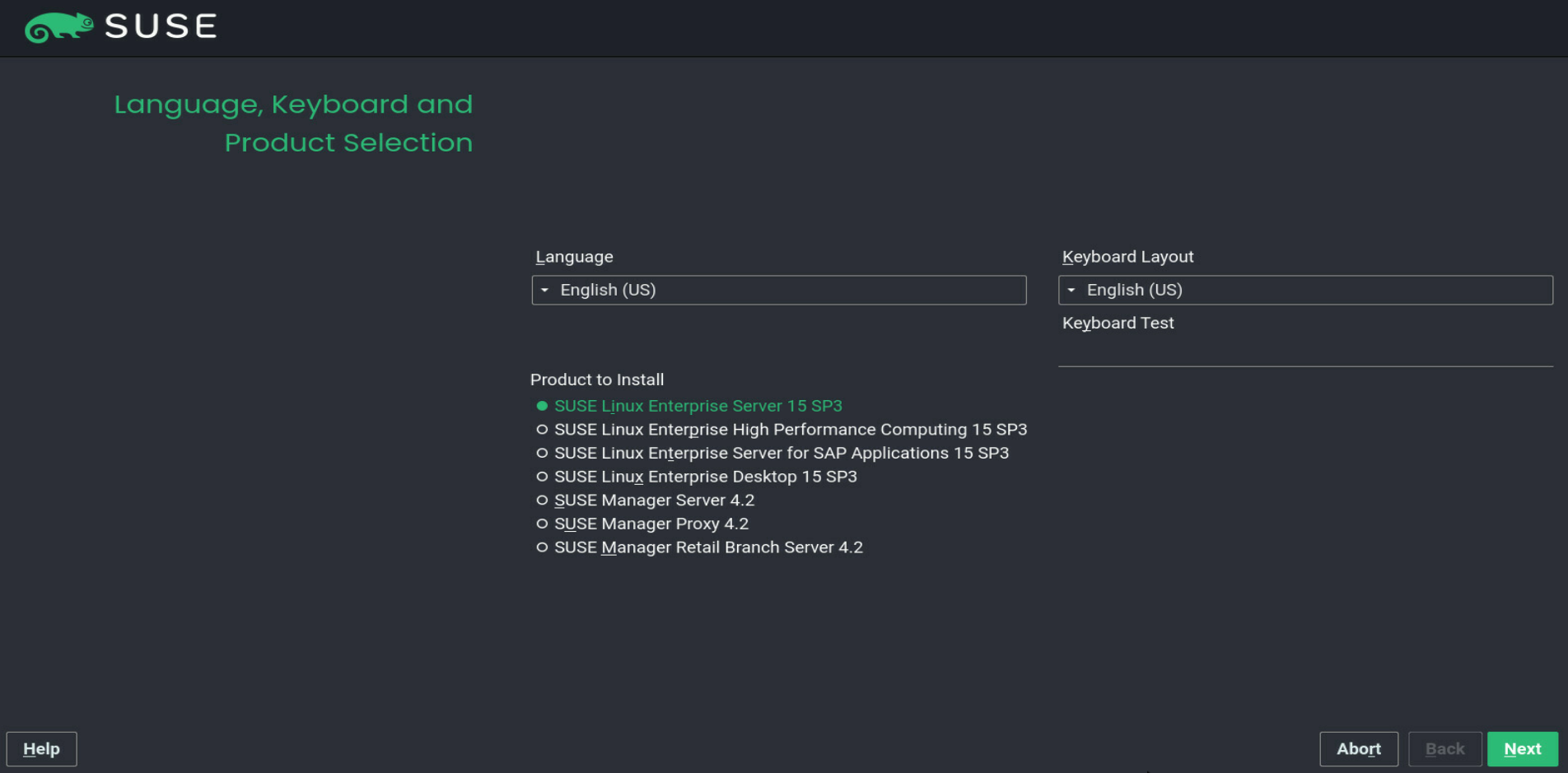

6. As shown in Figure 93, set the language and keyboard layout of the OS, and then select the type of the OS to be installed in the Product to install section. Then, click Next. The following installs a new OS as an example.
Figure 93 Setting the language, keyboard layout, and OS type
7. As shown in Figure 94, select I Agree to the License Terms, and then click Next.

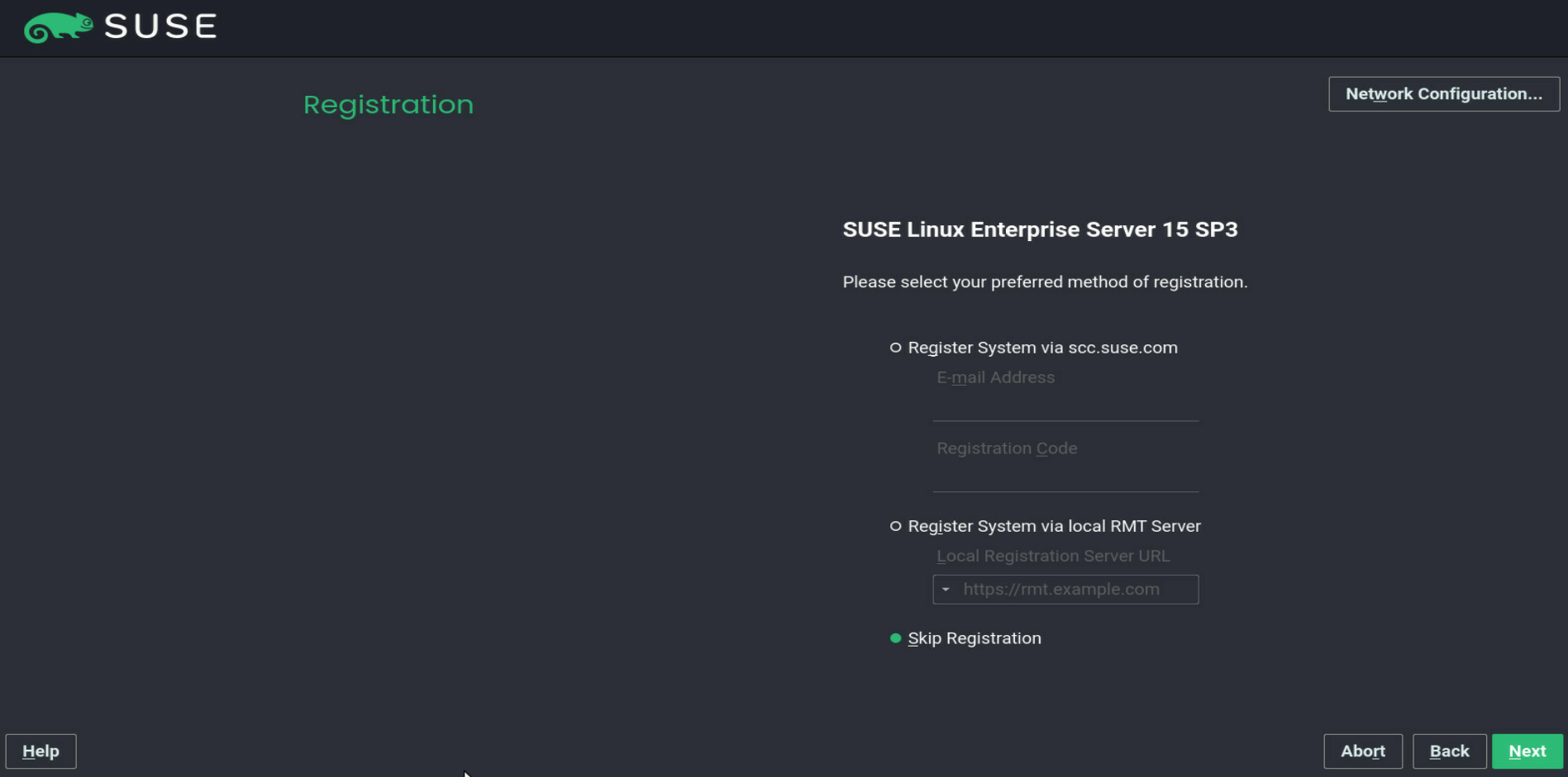

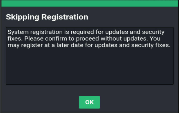

8. As shown in Figure 95, select whether to register. This example selects Skip Registration. Then, click Next. In the dialog box that opens as shown in Figure 96, click OK.
NOTE: An unregistered system will be unable to receive regular updates and fix security vulnerabilities. |
Figure 95 Selecting a registration method
Figure 96 Skipping registration
9. As shown in Figure 97, select extensions and modules for the system as needed, and click Next. It might be time consuming if you select many opions.
Figure 97 Selecting extensions and modules
10. As shown in Figure 98, click the target package, and then click Add or Delete as needed. Then, click Next.
Figure 98 Selecting add-on installation packages
11. As shown in Figure 99, select an application scenario for the system, and then click Next.
Figure 99 Selecting the application scenario for the system
12. As shown in Figure 100, to use the default partitions, click Next only. You can also configure user-defined partitions in the following methods:
¡ To configure partitions in guide mode, click Guided Setup to enter the screen as shown in Figure 101.
¡ To configure partitions in expert mode, click Expert Partitioner to enter the screen as shown in Figure 102.
NOTE: The following partitions must be added: · swap—Switching partition to implement virtual memory. As a best practice, set its size to one or twice of the physical memory. · /boot/efi—System boot file partition. It must be in the efi partition or fat format. As a best practice, set the size to 100 MB to 200 MB. · /—Root partition to save system software and files. |
Figure 101 Partitioning in guide mode
Figure 102 Partitioning in expert mode

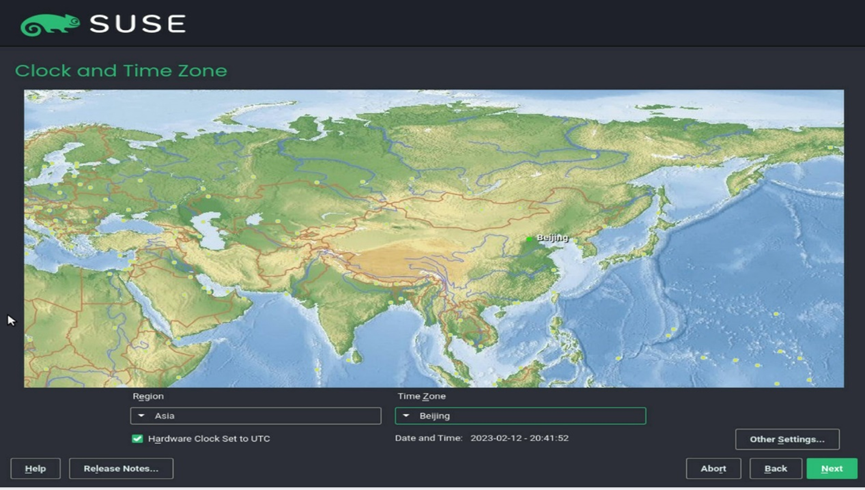

13. Set the region and time zone. As shown in Figure 103, click the drop-down arrow for the Region and Time Zone fields to set the region and time zone, respectively, and then click Next.
Figure 103 Setting the region and time zone

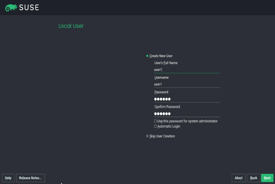

14. As shown in Figure 104, set the username and password to create a local user, and then click Next.
Figure 104 Setting the username and password
15. As shown in Figure 105, set the root password, and then click Next.
Figure 105 Setting the root password

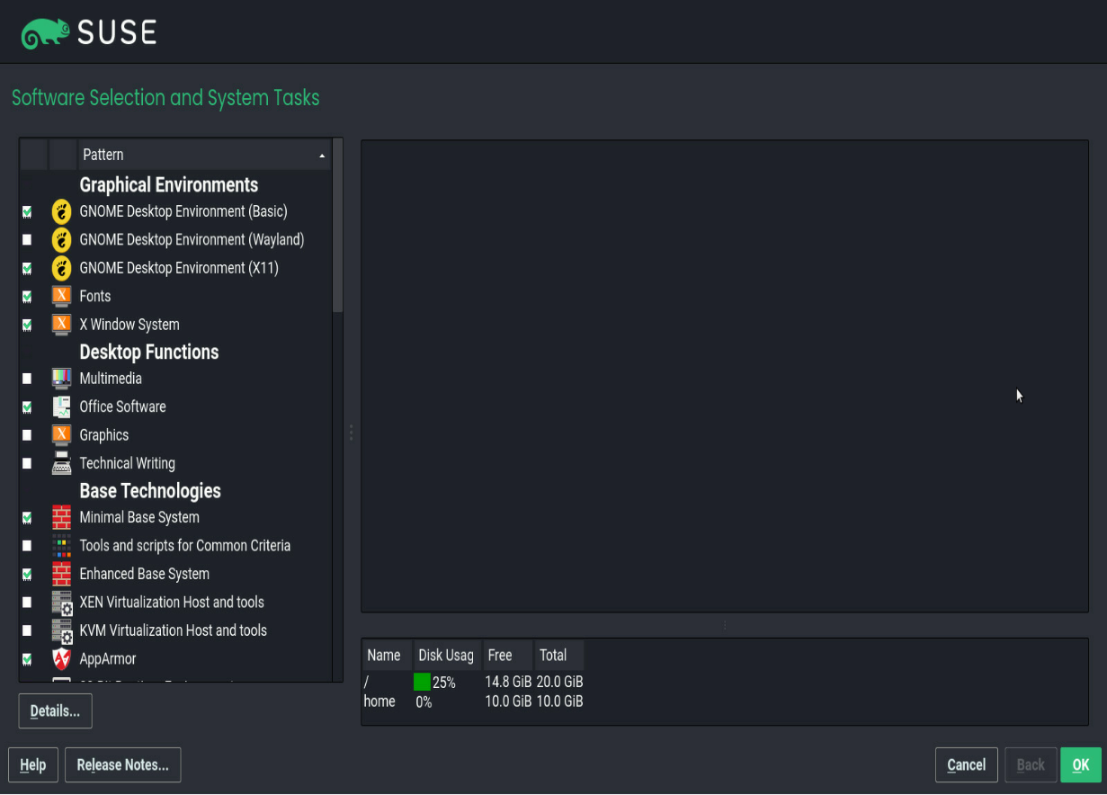

16. As shown in Figure 106, click Software on the installation settings screen. On the screen as shown in Figure 107, select software and system tasks, and then click OK.
Figure 106 Installation Settings screen
Figure 107 Selecting software and system tasks

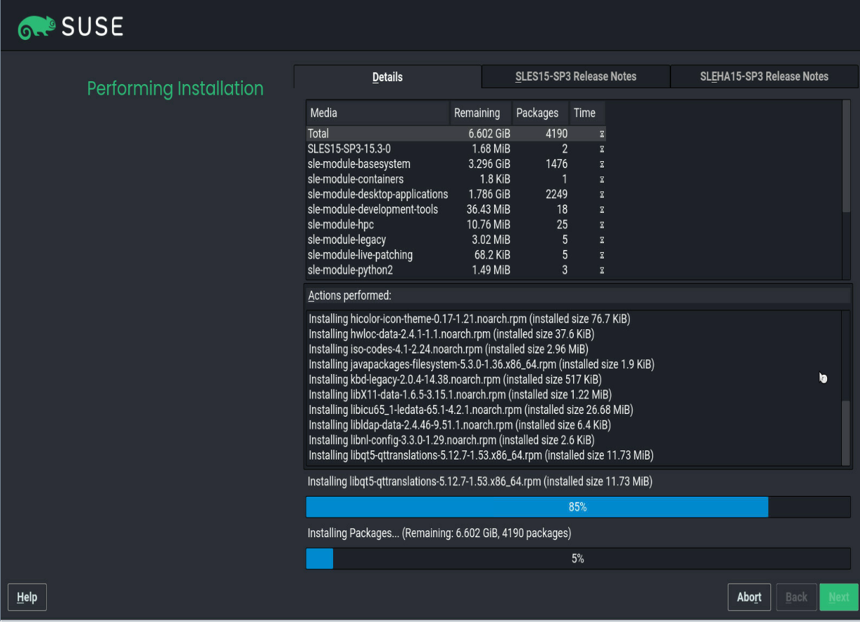

17. As shown in Figure 108, click Install. In the dialog box that opens, click Install to start system installation. The installation progress is as shown in Figure 109.

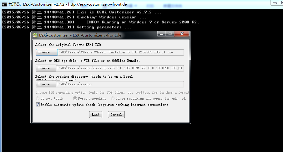

1. Download ESXi-Customizer and storage controller driver. You can download ESXi-Customizer from the Internet and a storage controller driver from the H3C website.
2. Run ESXI-Customizer.cmd, and perform the following tasks in the dialog box that opens:
¡ Select the original VMware ESXi ISO.
¡ Select an OEM.tgz file, a VIB file, or an Offline Bundle.
¡ Select the working directory.
3. Click Run.
Figure 111 Integrating an OS image and a storage controller driver

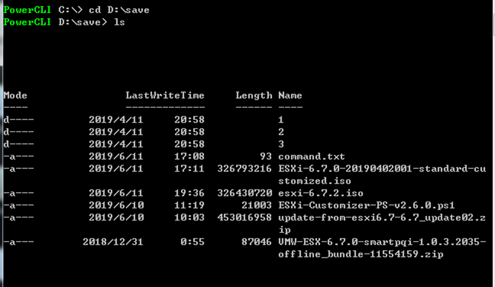

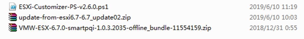

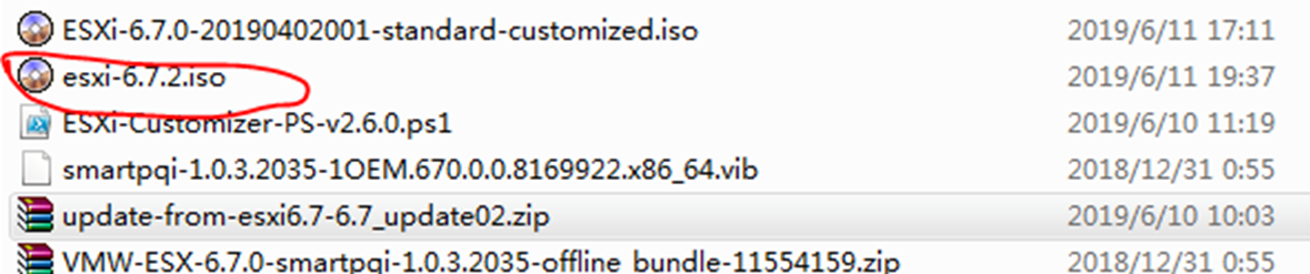

b. Put the storage controller driver, original VMWare ESXi OS image, and ESXi-Customizer-PS in the same directory.
Figure 115 Preparing the driver, OS image, and ESXi-Customizer-PS

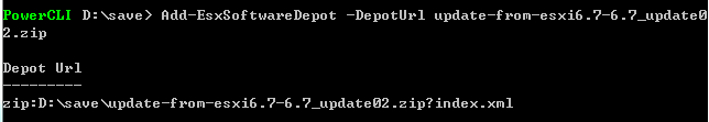

d. Execute the Add-esxsoftwareDepot –depoturl driver_file_name.zip command to load the driver file.
Figure 117 Loading the driver file

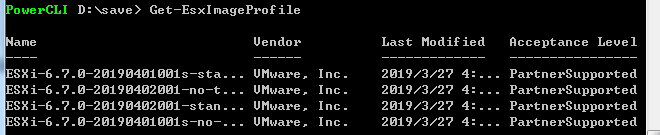

g. Execute the Get-EsxImageProfile command to obtain the name of the target configuration file. An OS image contains multiple configuration files for different installation scenarios. In this example, the OS image contains four configuration files. This section uses the third configuration file.
Figure 120 Viewing OS image information

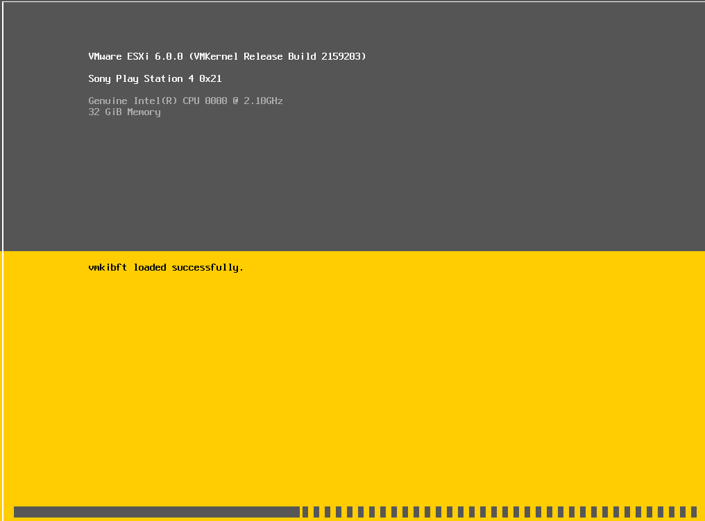

Figure 124 Loading ESXi installer
Figure 125 Loading the OS module

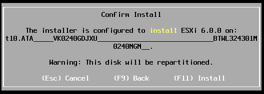

6. Confirm disk selection and then press Enter. To change to another disk, press Esc and then select another one.
Figure 129 Confirming disk selection

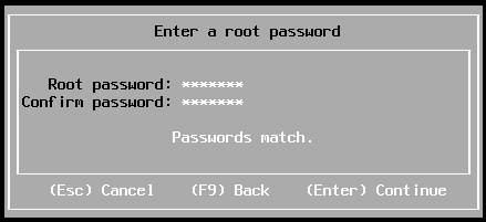

8. Set the root password, and then press Enter.
Figure 131 Setting the root password

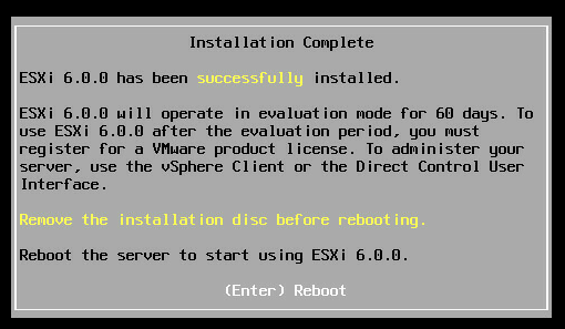

Figure 132 Confirming VMware ESXi OS installation
10. Press Enter to reboot the server.
If the OS image is obtained from a CD/DVD or bootable USB disk, remove the CD/DVD or USB disk, and then press Enter to reboot the server.
Figure 133 OS installation completed

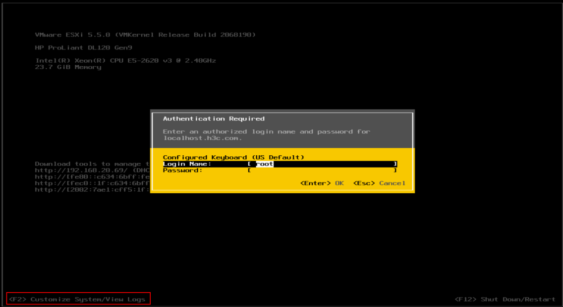

11. Press F2, enter the root password, and then press Enter.
The OS installation is complete when the page as shown in Figure 136 appears.
Figure 135 Entering the root password
Figure 136 Configuring the password

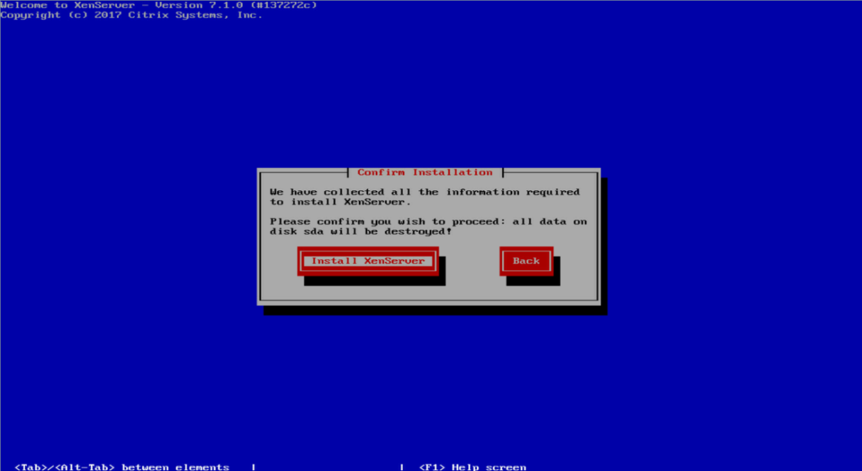

4. Confirm installation and then click OK.
Figure 139 Confirming installation

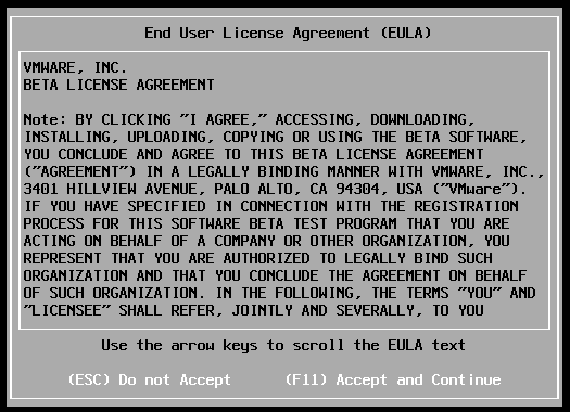

5. Read the End User License Agreement, select Accept EULA, and then press Enter.
Figure 140 End User License Agreement

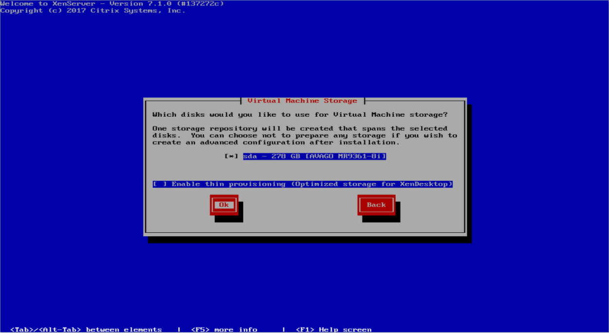

6. Select a disk to install the OS if you have multiple disks, and then click OK.
Figure 141 Selecting a disk

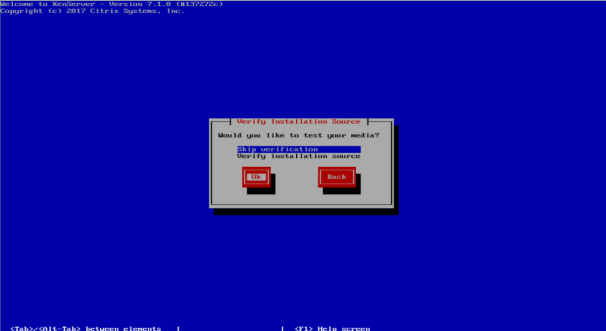

8. Select Skip verification, and then click OK.
If you encounter any issues during installation, verify the installation source as a best practice.
Figure 143 Verifying the installation source

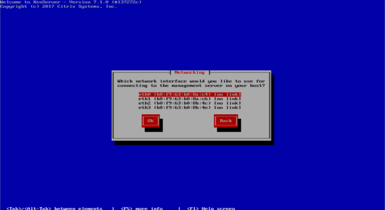

10. Select a network interface for connecting to the management server, and then click OK.
Figure 145 Selecting a network interface

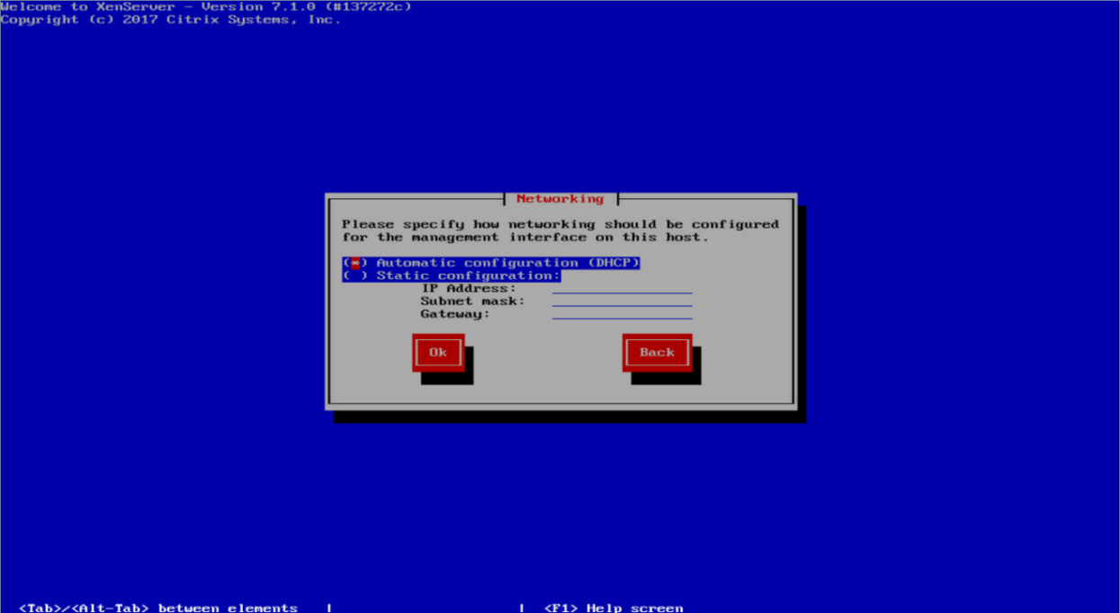

11. Select a method for specifying an IP address for the management interface, and then click OK.
¡ Automatic configuration (DHCP)—Obtains an IP address through DHCP.
¡ Static configuration—Manually specify an IP address. If you select this option, you must also specify an IP address, mask, and gateway address.
Figure 146 Specifying an IP address

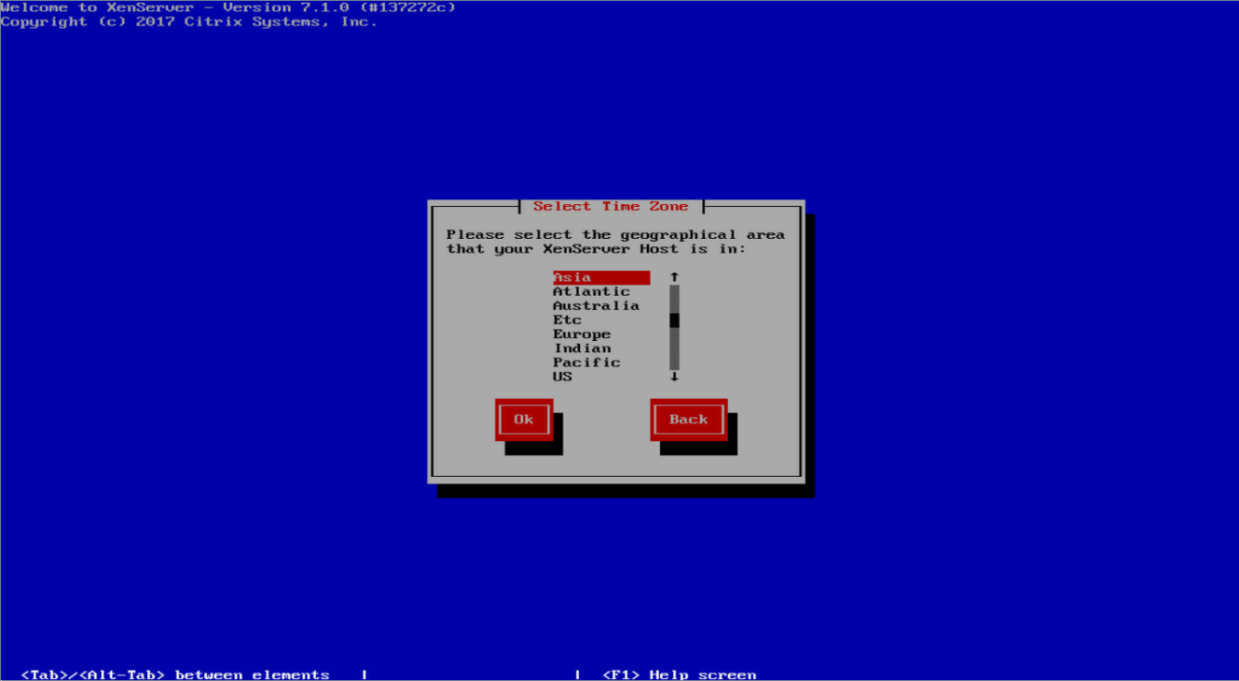

13. Set the time zone by selecting the geographical area and then the city, and then click OK.
Figure 148 Setting the time zone

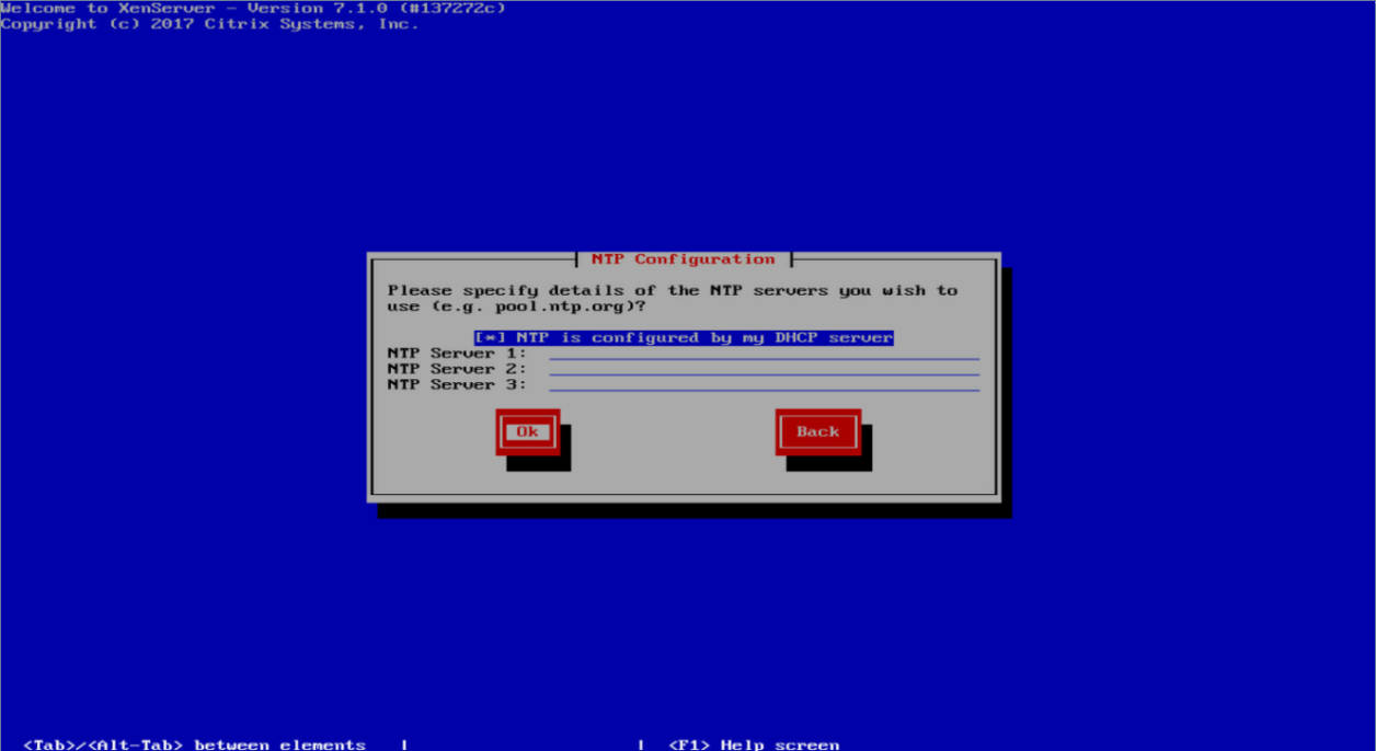

14. Select a method for setting the system time, and then click OK.
¡ Using NTP—You must specify a minimum of one NTP server and specify the IP address of the NTP server.
¡ Manual time entry—You must manually enter the system time after installation.
Figure 149 Selecting the method for setting the system time
Figure 150 Configuring the NTP server

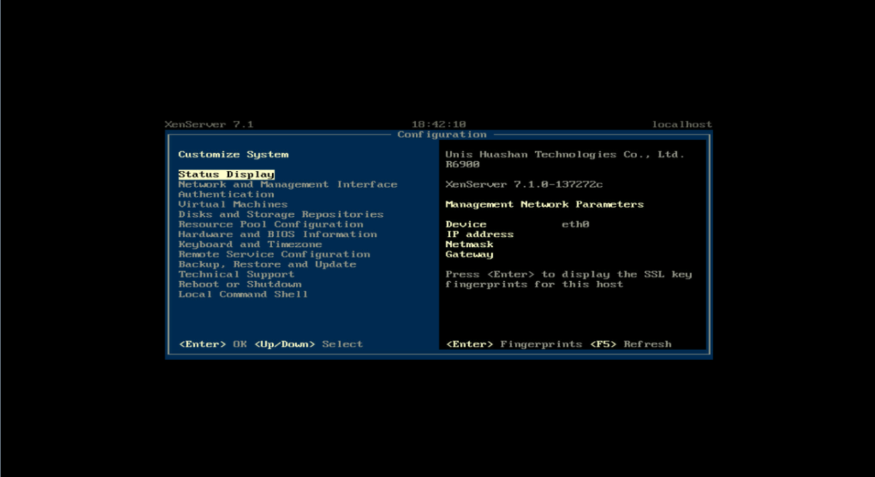

15. Select Install XenServer, and then press Enter to start installation.
Figure 151 Starting installation

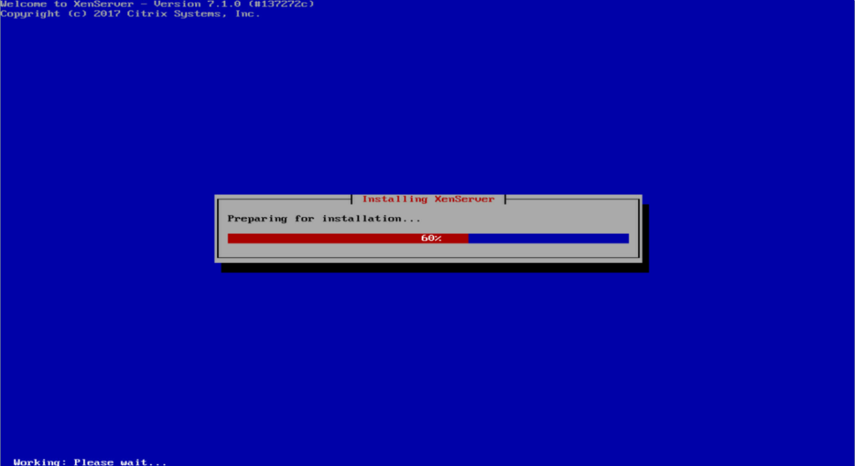

16. Wait for the system to complete installation.
Figure 152 OS installation in progress

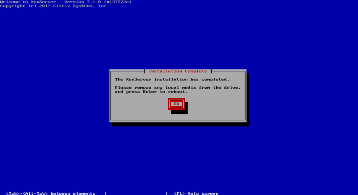

17. Click OK after installation is completed to restart the server.
Figure 153 Installation completed

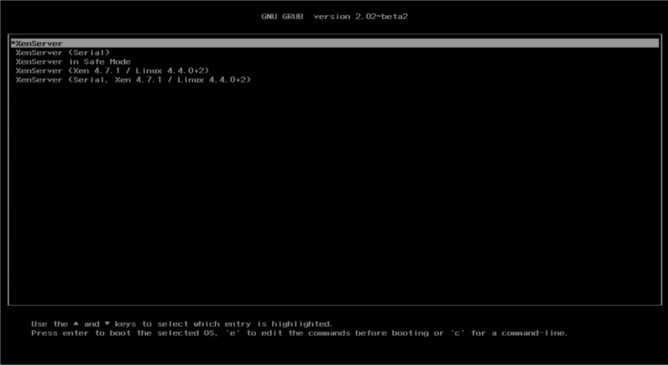

18. Select XenServer, and then press Enter.
Figure 154 GNU GRUB
You have entered the Citrix XenServer GUI when the following page appears.
Figure 155 Citrix 7.1 GUI

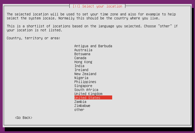

4. Select your location, and then press Enter.
Figure 158 Selecting a location

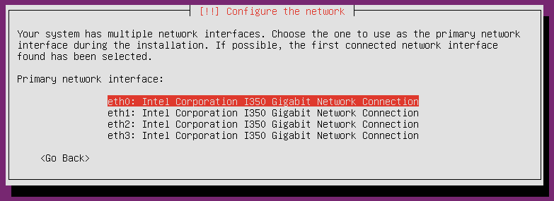

8. Select a connected network interface as the primary network interface, and then press Enter.
Figure 162 Configuring the network

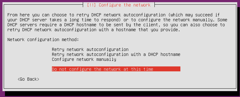

10. Select a network configuration method, and then press Enter. This example selects not to configure the network at this time.
Figure 164 Selecting a network configuration method

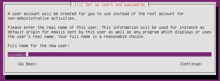

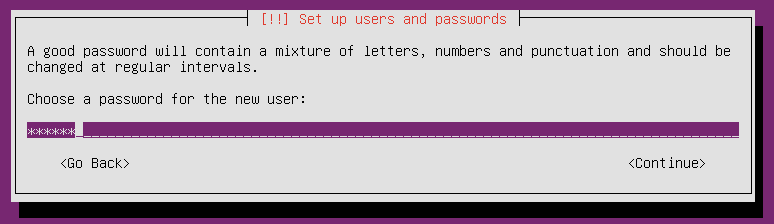

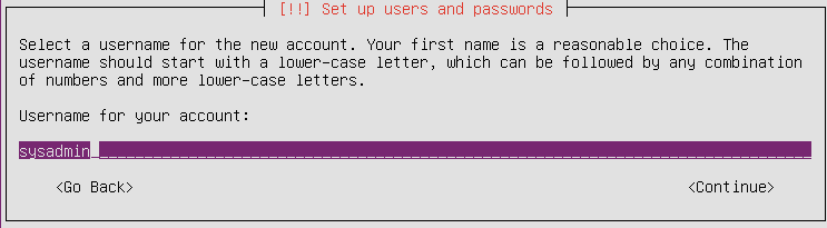

11. Enter the host name and set the user and password in turn by following the configuration wizard, as shown in the following figures.
Figure 165 Entering the host name
Figure 166 Entering the real name of the user
Figure 167 Entering the username for your account
Figure 168 Setting the password

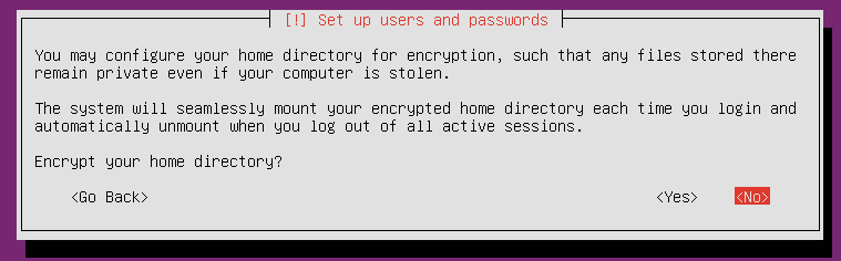

12. Configure whether to encrypt your home directory. This example selects to not encrypt the home directory.
Figure 169 Setting home directory encryption

14. Select a partitioning method. This example selects Guided - use entire disk.
In UEFI boot mode, to avoid installation failure, you must create the /boot/efi partition, and make sure the files in the partition are in the efi or fat format if you select manual partitioning.
In Legacy mode, if you select Guided - use entire disk, the system creates only the / and swap partitions. You must click no to return to the / partition and then set the bootable flag to on, or create the /boot partition, and then set the bootable flag of the partition to on.
Figure 171 Selecting a partitioning method
15. Check the partitions, and then select Yes. The system will automatically divide the disk into three partitions.
Figure 172 Checking the partitions

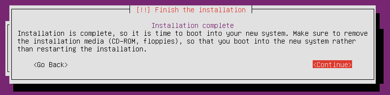

19. Press Enter when the following page appears to complete installation.
Figure 176 Finishing the installation

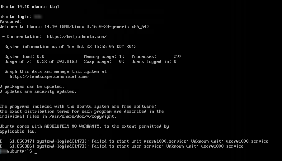

20. Enter the username and password to log in to Ubuntu.
Figure 177 Entering the username and password
Figure 178 Logging in to the Ubuntu OS

1. Restart the server and enter the screen as shown in Figure 179. Click Esc to enter the BIOS Setup Utility.
Figure 179 Restarting the server
2. As shown in Figure 180, select EXIT. Select virtual medium CDROM that has been added and press Enter.
Figure 180 Selecting a virtual medium

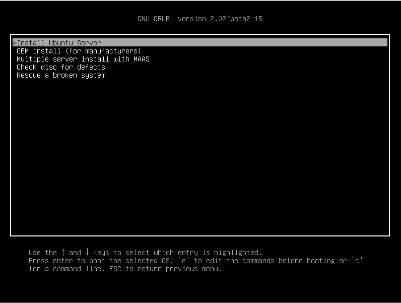

3. As shown in Figure 181, select Install Ubuntu Server on the GRUB screen to start Ubuntu installation.

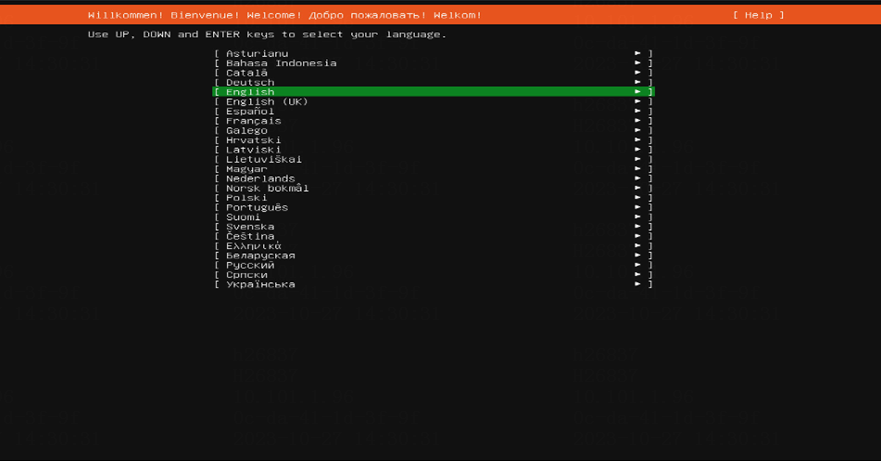

4. As shown in Figure 182, select the system language by using the arrow keys on the keyboard and press Enter.
Figure 182 Selecting the system language

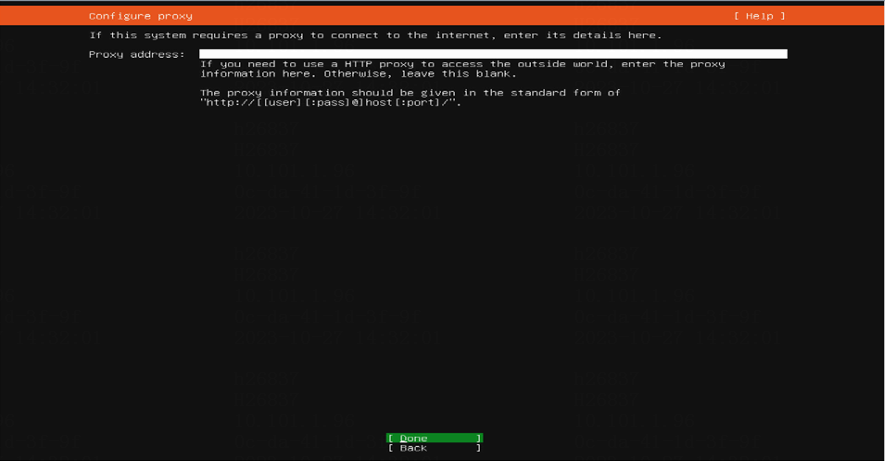

8. As shown in Figure 186, configure the proxy, select Done, and press Enter.
Figure 186 Configuring the proxy

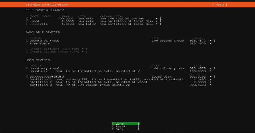

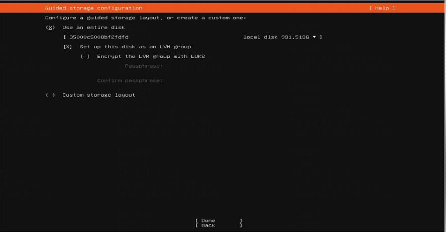

11. As shown in Figure 189, configure partitions.
¡ In Use an entire disk mode, select a disk, move the cursor to Done, and press Enter. The system will partition the disk according to the default settings.
¡ In Custom storage layout mode, move the cursor to Done, and press Enter to enter the manual partitioning screen.
Figure 189 Configuring partitions
12. As shown in Figure 190, manually partition disks. You can partition disks as needed. This example partition the disk based on the installation procedure. After partitioning, select Done and press Enter.
Figure 190 Manual partitioning

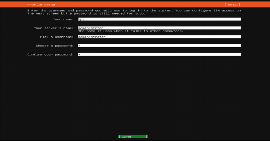

14. As shown in Figure 192, set the username, server name, and password. Then, move the cursor to Done, and press Enter.
Figure 192 Setting the username, server name, and password

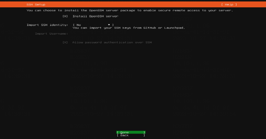

15. As shown in Figure 193, press the space bar and select Install OpenSSH serve. Then, move the cursor to Done, and press Enter to start installation.
NOTE: To use SSH after OS installation, make sure the OpenSSH server is installed. |
Figure 193 Installing the OpenSSH server

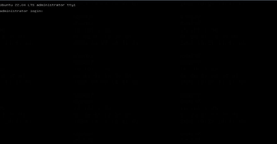

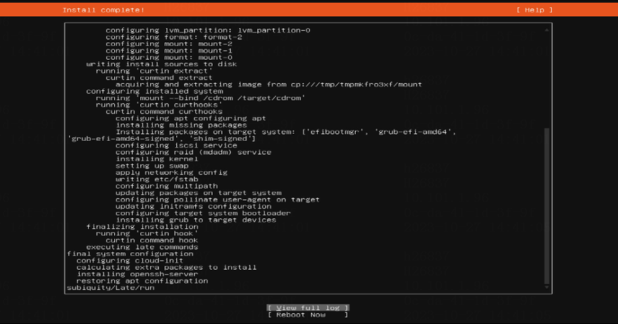

16. As shown in Figure 194, start OS installation. The installation process will take a while, during which other operations are not allowed.
Figure 194 OS installation screen
17. As shown in Figure 195, the OS installation finishes. Move the cursor to Reboot Now and press Enter to restart the server.

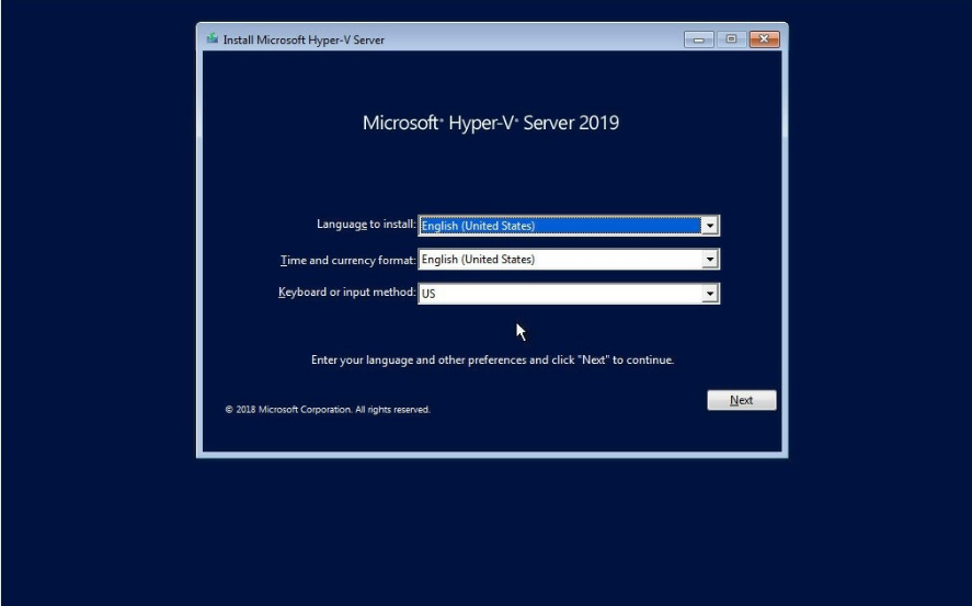

1. Set the language, time, and keyboard layout, and then click Next, as shown in Figure 209.
Figure 209 Setting the language, time, and keyboard layout

4. As shown in Figure 212, select an installation type, Custom or Upgrade.
Figure 212 Selecting an installation type

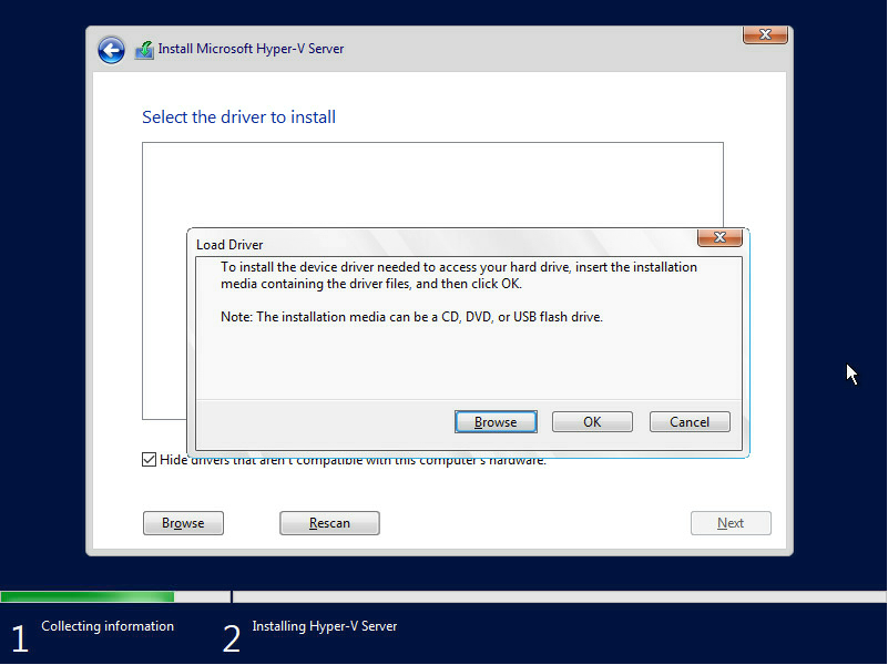

5. Click Load Driver, and then click Browse.
CAUTION: Load the storage controller driver when installing a Windows Server OS to avoid the following issues: · The disk cannot be detected (see Figure 213). · The OS cannot be accessed after installation. |
6. Select the path where the driver is located, and then click OK.
Figure 215 Selecting the driver path
7. Select the driver to install, and then click Next.
Figure 216 Driver detected
8. Select the destination drive to install the OS, and then click Next.
Figure 217 Loading storage controller driver completed

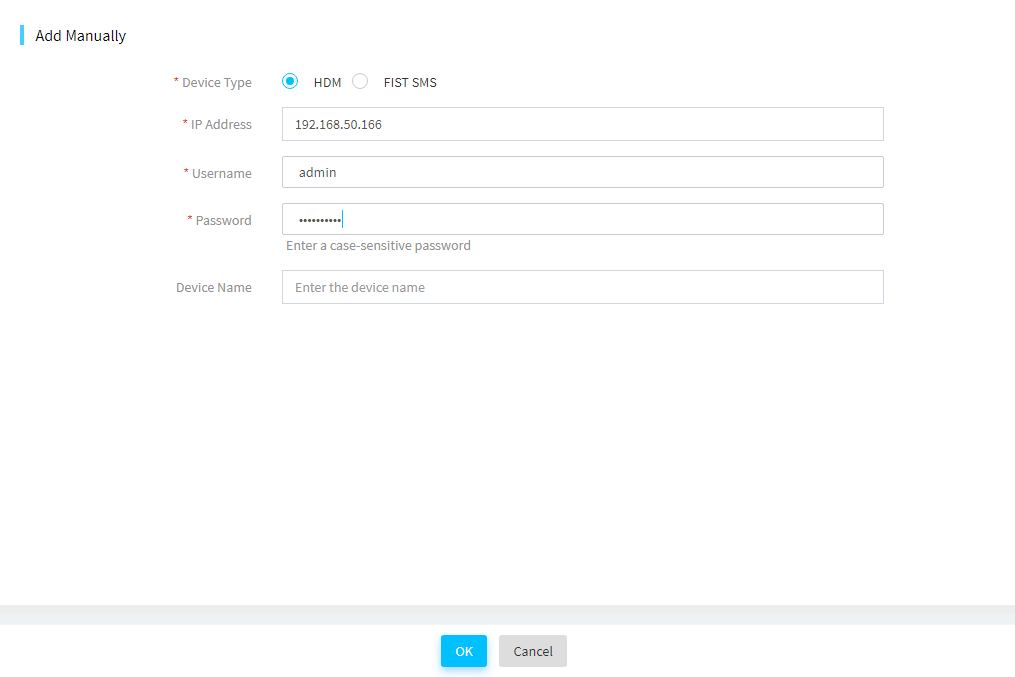

Add servers to UniSystem
This section describes the procedure for adding one server to UniSystem. For information about adding multiple devices in bulk, see UniSystem online help.
The default HDM username and password are admin and Password@_, respectively.
1. From the navigation bar, select Menu > Devices > Server List.
Figure 227 Entering the server list page
2. Click Add and select Add Manually in the Method dialog box that opens.
IMPORTANT: To add multiple servers in bulk, select Auto Discovery or Bulk import as a best practice. For more information, see the UniSystem user guide. |
3. Select HDM as the device type, enter the HDM management IP address, HDM username and password, and then click OK.
IMPORTANT: Make sure the HDM account specified by the username has the administrator role and the VMedia privilege. For more information about user privileges, see HDM online help. |

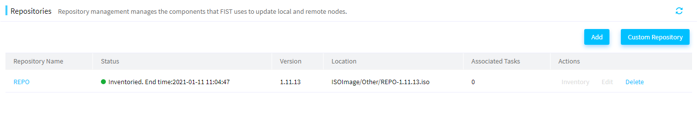

4. Click Inventory for the target repository. The system starts to inventory components.
NOTE: In UniSystem 2.00.22 or a later version, the system automatically inventories components after you add a repository. |
Figure 233 Inventory components
5. To view the check result, click the repository name.
Figure 234 Viewing the inventory result

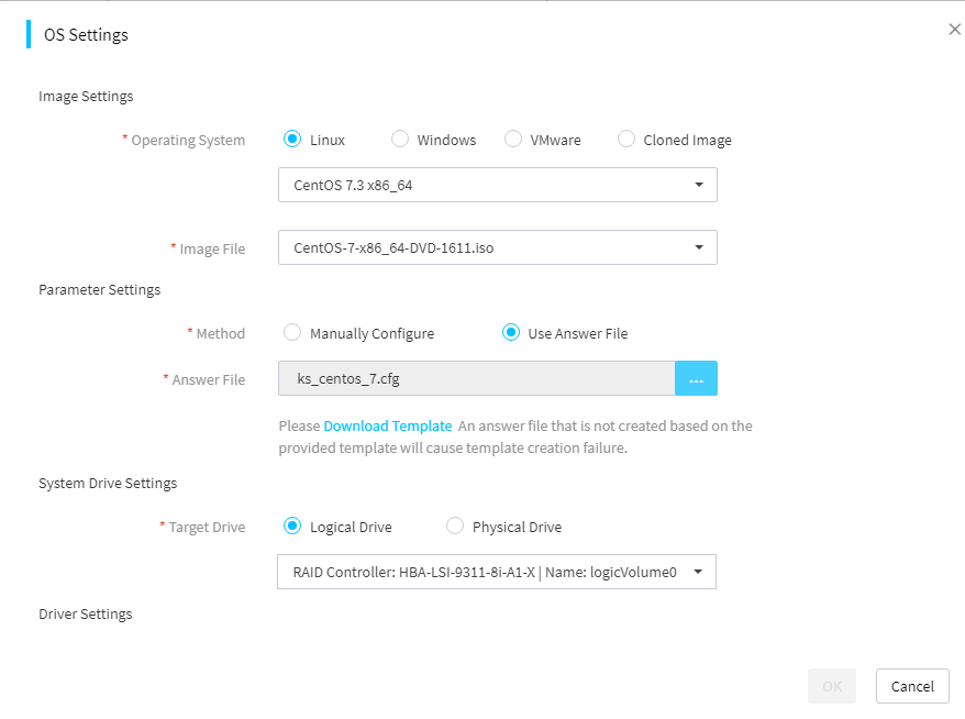

6. In the OS Settings area, click Configure.
7. On the OS Settings page that opens, select an operating system and an image file. See Figure 239.
Figure 239 Configuring system settings
8. Select a method in the Parameter Settings area.
a. If you select Use Answer File, click Download Template to obtain the answer file template for the system. Modify the answer file template as needed, and click the … icon next to Answer File to upload the answer file.
IMPORTANT: · The Use Answer File method is available only for a RedHat or CentOS OS. · As a best practice to ensure template creation success, download the answer file template instead of create a one yourself. For information about the format requirements and usage of the answer file, see the guidelines and the readme file in the template. |
Figure 240 Configuring an OS by using an answer file
b. If you select Manually Configure, configure OS-related parameters.
The available parameters vary by OS type. This document uses a Linux OS for example.
Figure 241 Manually configuring an OS
9. Select a target drive in the System Drive Settings area and select a repository in the Driver Settings area.
If you need to install a driver, select the driver file from the repository library.
Figure 242 Selecting the target drive and repository

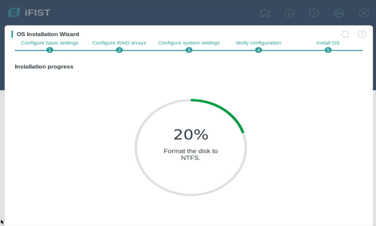

1. On the iFIST Web interface, click OS Installation Wizard.
Figure 247 Selecting OS installation wizard
2. On the Configure basic settings page that opens, select the type of media as the boot media, and then click Next.
Figure 248 Configuring basic settings
3. On the Configure RAID arrays page that opens, click the Create RAID array tab.
4. To create a RAID array:
a. Select physical drives as needed.
b. Click Create.
c. In the dialog box that opens, enter a RAID array name, select a RAID level, and then click OK.
Figure 249 Creating a RAID array
5. To view the logical drives on the server, click the Manage logical drives tab, and then click Next.
Before going to next step, iFIST examines if the OS image is mounted successfully and is supported. Otherwise, a prompt message appears and the system terminates the installation process.
Figure 250 Viewing logical drives
6. On the Configure system settings page, select drivers and configure the OS parameters.
