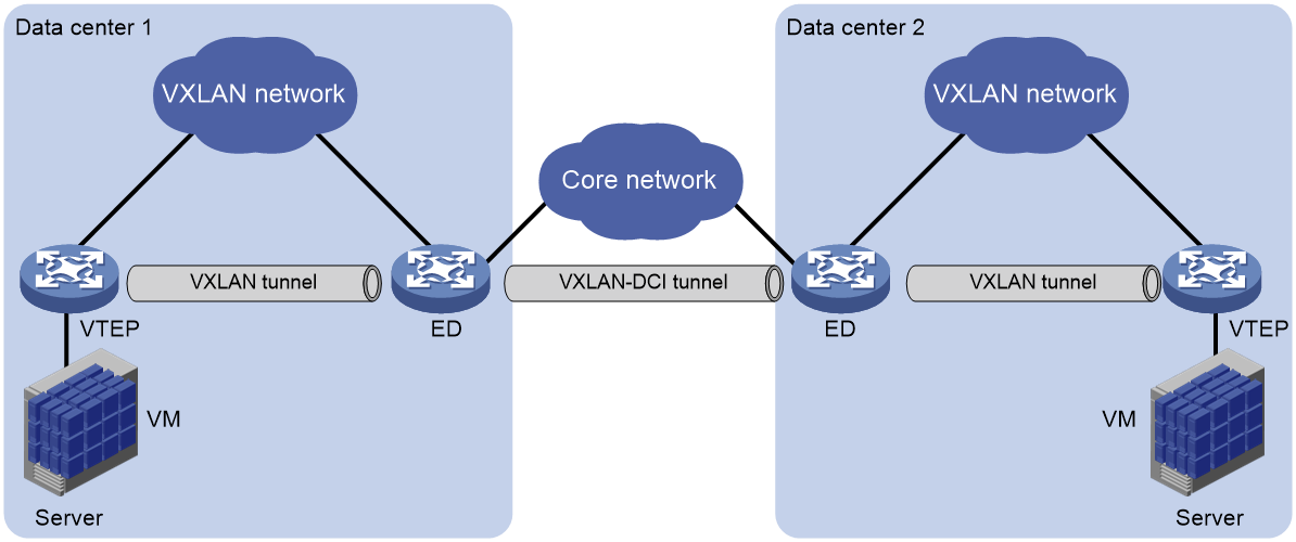

EVPN data center interconnect (EVPN-DCI) uses VXLAN-DCI tunnels to provide connectivity for data centers over an IP transport network.
EVPN-DCI network model
As shown in Figure 1, the EVPN-DCI network contains VTEPs and edge devices (EDs) located at the edge of the transport network. A VXLAN tunnel is established between a VTEP and an ED, and a VXLAN-DCI tunnel is established between two EDs. VXLAN-DCI tunnels use VXLAN encapsulation. Each ED de-encapsulates incoming VXLAN packets and re-encapsulates them based on the destination before forwarding the packets through a VXLAN or VXLAN-DCI tunnel.
Figure 1 EVPN-DCI network model
Working mechanisms
In an EVPN-DCI network, BGP EVPN peer relationships are established between EDs and between EDs and VTEPs. When advertising routes to a VTEP or another ED, an ED replaces the routes' nexthop IP address and router MAC address with its IP address and router MAC address.
In an EVPN-DCI network, a VTEP and an ED use a VXLAN tunnel to send traffic, and two EDs use a VXLAN-DCI tunnel to send traffic. An ED de-encapsulates incoming VXLAN packets and re-encapsulates them before forwarding the packets through a VXLAN or VXLAN-DCI tunnel.

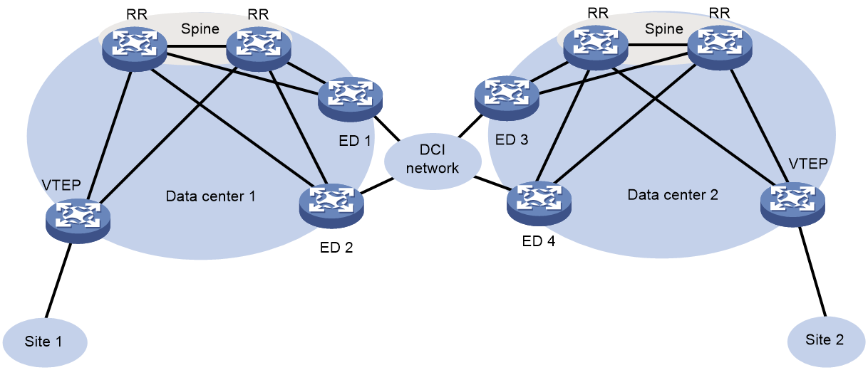

EVPN-DCI dual-homing
As shown in Figure 2, EVPN-DCI dual-homing allows you to deploy two EDs at a data center for high availability and load sharing. To virtualize the redundant EDs into one device, a virtual ED address is configured on them. The redundant EDs use the virtual ED address to establish tunnels with VTEPs and remote EDs.
Figure 2 EVPN-DCI dual-homing
The redundant EDs use their respective IP addresses as the BGP peer addresses to establish BGP EVPN neighbor relationships with VTEPs and remote EDs. The VTEPs and remote EDs send traffic destined for the virtual ED address to both of the redundant EDs through the ECMP routes provided by the underlay network.
The redundant EDs communicate with remote data centers through the transport network. Devices in the dual-homed data center are unaware of the transport network. When the transport-side link fails on one of the redundant EDs, traffic destined for remote data centers is still sent to that ED. To resolve this issue, Monitor Link is used together with EVPN-DCI dual-homing. On each redundant ED, the transport-facing physical interface is associated with the loopback interface that provides the IP address used for establishing BGP EVPN neighbor relationships. If the transport-side link fails on a redundant ED, the loopback interface is placed in down state, and all traffic is forwarded by the other redundant ED. For more information about Monitor Link, see High Availability Configuration Guide.
For link redundancy, deploy multiple RRs on the spine nodes in a data center, and connect each redundant ED to the transport network through multiple links.

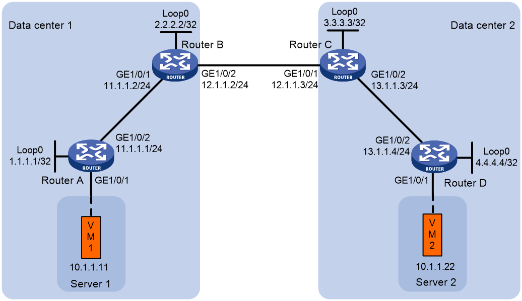

EVPN-DCI configuration examples (on routers)
Example: Configuring a basic EVPN-DCI network
As shown in Figure 4:
· Configure VXLAN 10 on Router A through Router D to provide connectivity for the VMs in the data centers.
· Configure Router A and Router D as VTEPs, and configure Router B and Router C as EDs.
1. Configure IP addresses and unicast routing settings:
# Assign IP addresses to the interfaces, as shown in Figure 4. (Details not shown.)
# Configure OSPF on the transport network for the routers to reach one another. (Details not shown.)
2. Configure Router A:
# Enable L2VPN.
<RouterA> system-view
[RouterA] l2vpn enable
# Disable remote MAC address learning.
[RouterA] vxlan tunnel mac-learning disable
# Create VXLAN 10 on VSI vpna.
[RouterA] vsi vpna
[RouterA-vsi-vpna] vxlan 10
[RouterA-vsi-vpna-vxlan-10] quit
# Create an EVPN instance on VSI vpna. Configure the router to automatically generate an RD, and manually configure a route target for the EVPN instance.
[RouterA-vsi-vpna] evpn encapsulation vxlan
[RouterA-vsi-vpna-evpn-vxlan] route-distinguisher auto
[RouterA-vsi-vpna-evpn-vxlan] vpn-target 123:456
[RouterA-vsi-vpna-evpn-vxlan] quit
[RouterA-vsi-vpna] quit
# Configure BGP to advertise BGP EVPN routes.
[RouterA] bgp 100
[RouterA-bgp-default] peer 2.2.2.2 as-number 100
[RouterA-bgp-default] peer 2.2.2.2 connect-interface loopback 0
[RouterA-bgp-default] address-family l2vpn evpn
[RouterA-bgp-default-evpn] peer 2.2.2.2 enable
[RouterA-bgp-default-evpn] quit
[RouterA-bgp-default] quit
# Map site-facing interface GigabitEthernet 1/0/1 to VSI vpna.
[RouterA] interface gigabitethernet 1/0/1
[RouterA-GigabitEthernet1/0/1] xconnect vsi vpna
[RouterA-GigabitEthernet1/0/1] quit
3. Configure Router B:
# Enable L2VPN.
<RouterB> system-view
[RouterB] l2vpn enable
[RouterB] vxlan tunnel mac-learning disable
# Enable DCI on the Layer 3 interface that connects Router B to Router C for the routers to establish a VXLAN-DCI tunnel.
[RouterB] interface gigabitethernet 1/0/2
[RouterB-GigabitEthernet1/0/2] dci enable
[RouterB-GigabitEthernet1/0/2] quit
[RouterB] vsi vpna
[RouterB-vsi-vpna] vxlan 10
[RouterB-vsi-vpna-vxlan-10] quit
[RouterB-vsi-vpna] evpn encapsulation vxlan
[RouterB-vsi-vpna-evpn-vxlan] route-distinguisher auto
[RouterB-vsi-vpna-evpn-vxlan] vpn-target 123:456
[RouterB-vsi-vpna-evpn-vxlan] quit
[RouterB-vsi-vpna] quit
# Configure BGP to advertise BGP EVPN routes. Enable nexthop replacement for routes advertised to Router A, and enable router MAC replacement for routes advertised to and received from Router C.
[RouterB] bgp 100
[RouterB-bgp-default] peer 3.3.3.3 as-number 200
[RouterB-bgp-default] peer 3.3.3.3 connect-interface loopback 0
[RouterB-bgp-default] peer 3.3.3.3 ebgp-max-hop 64
[RouterB-bgp-default] peer 1.1.1.1 as-number 100
[RouterB-bgp-default] peer 1.1.1.1 connect-interface loopback 0
[RouterB-bgp-default] address-family l2vpn evpn
[RouterB-bgp-default-evpn] peer 3.3.3.3 enable
[RouterB-bgp-default-evpn] peer 3.3.3.3 router-mac-local
[RouterB-bgp-default-evpn] peer 1.1.1.1 enable
[RouterB-bgp-default-evpn] peer 1.1.1.1 next-hop-local
[RouterB-bgp-default-evpn] quit
[RouterB-bgp-default] quit
4. Configure Router C:
# Enable L2VPN.
<RouterC> system-view
[RouterC] l2vpn enable
[RouterC] vxlan tunnel mac-learning disable
# Enable DCI on the Layer 3 interface that connects Router C to Router B for the routers to establish a VXLAN-DCI tunnel.
[RouterC] interface gigabitethernet 1/0/1
[RouterC-GigabitEthernet1/0/1] dci enable
[RouterC-GigabitEthernet1/0/1] quit
[RouterC] vsi vpna
[RouterC-vsi-vpna] vxlan 10
[RouterC-vsi-vpna-vxlan-10] quit
[RouterC-vsi-vpna] evpn encapsulation vxlan
[RouterC-vsi-vpna-evpn-vxlan] route-distinguisher auto
[RouterC-vsi-vpna-evpn-vxlan] vpn-target 123:456
[RouterC-vsi-vpna-evpn-vxlan] quit
[RouterC-vsi-vpna] quit
# Configure BGP to advertise BGP EVPN routes. Enable nexthop replacement for routes advertised to Router D, and enable router MAC replacement for routes advertised to and received from Router B.
[RouterC] bgp 200
[RouterC-bgp-default] peer 2.2.2.2 as-number 100
[RouterC-bgp-default] peer 2.2.2.2 connect-interface loopback 0
[RouterC-bgp-default] peer 2.2.2.2 ebgp-max-hop 64
[RouterC-bgp-default] peer 4.4.4.4 as-number 200
[RouterC-bgp-default] peer 4.4.4.4 connect-interface loopback 0
[RouterC-bgp-default] address-family l2vpn evpn
[RouterC-bgp-default-evpn] peer 2.2.2.2 enable
[RouterC-bgp-default-evpn] peer 2.2.2.2 router-mac-local
[RouterC-bgp-default-evpn] peer 4.4.4.4 enable
[RouterC-bgp-default-evpn] peer 4.4.4.4 next-hop-local
[RouterC-bgp-default-evpn] quit
[RouterC-bgp-default] quit
5. Configure Router D:
# Enable L2VPN.
<RouterD> system-view
[RouterD] l2vpn enable
[RouterD] vxlan tunnel mac-learning disable
[RouterD] vsi vpna
[RouterD-vsi-vpna] vxlan 10
[RouterD-vsi-vpna-vxlan-10] quit
[RouterD-vsi-vpna] evpn encapsulation vxlan
[RouterD-vsi-vpna-evpn-vxlan] route-distinguisher auto
[RouterD-vsi-vpna-evpn-vxlan] vpn-target 123:456
[RouterD-vsi-vpna-evpn-vxlan] quit
[RouterD-vsi-vpna] quit
[RouterD] bgp 200
[RouterD-bgp-default] peer 3.3.3.3 as-number 200
[RouterD-bgp-default] peer 3.3.3.3 connect-interface loopback 0
[RouterD-bgp-default] address-family l2vpn evpn
[RouterD-bgp-default-evpn] peer 3.3.3.3 enable
[RouterD-bgp-default-evpn] quit
[RouterD-bgp-default] quit
[RouterD] interface gigabitethernet 1/0/1
[RouterD-GigabitEthernet1/0/1] xconnect vsi vpna
[RouterD-GigabitEthernet1/0/1] quit
1. Verify the configuration on EDs. (This example uses Router B.)
# Verify that the ED has discovered Router A and Router C through IMET routes and has established VXLAN and VXLAN-DCI tunnels to the routers.
[RouterB] display evpn auto-discovery imet
Total number of automatically discovered peers: 3
VSI name: vpna
RD PE_address Tunnel_address Tunnel mode VXLAN ID
1:10 1.1.1.1 1.1.1.1 VXLAN 10
1:10 3.3.3.3 3.3.3.3 VXLAN-DCI 10
# Verify that the VXLAN and VXLAN-DCI tunnels on the ED are up.
[RouterB] display interface tunnel
Tunnel0
Current state: UP
Line protocol state: UP
Description: Tunnel0 Interface
Bandwidth: 64 kbps
Maximum transmission unit: 64000
Internet protocol processing: Disabled
Output queue - Urgent queuing: Size/Length/Discards 0/100/0
Output queue - Protocol queuing: Size/Length/Discards 0/500/0
Output queue - FIFO queuing: Size/Length/Discards 0/75/0
Last clearing of counters: Never
Tunnel source 2.2.2.2, destination 1.1.1.1
Tunnel protocol/transport UDP_VXLAN/IP
Last 300 seconds input rate: 0 bytes/sec, 0 bits/sec, 0 packets/sec
Last 300 seconds output rate: 0 bytes/sec, 0 bits/sec, 0 packets/sec
Input: 0 packets, 0 bytes, 0 drops
Output: 0 packets, 0 bytes, 0 drops
Tunnel1
Current state: UP
Description: Tunnel1 Interface
Bandwidth: 64 kbps
Tunnel source 2.2.2.2, destination 3.3.3.3
Tunnel protocol/transport UDP_VXLAN-DCI/IP
# Verify that the VXLAN and VXLAN-DCI tunnels have been assigned to the VXLAN.
[RouterB] display l2vpn vsi name vpna verbose
VSI Name: vpna
VSI Index : 0
VSI State : Up
MTU : 1500
Bandwidth : Unlimited
Broadcast Restrain : -
Multicast Restrain : -
Unknown Unicast Restrain: -
MAC Learning : Enabled
MAC Table Limit : -
Drop Unknown : Disabled
PW Redundancy : Slave
Flooding : Enabled
Service Class : -
Statistics : Disabled
VXLAN ID : 10
Tunnels:
Tunnel Name Link ID State Type Flood proxy
Tunnel0 0x5000000 UP Auto Disabled
Tunnel1 0x5000001 UP Auto Disabled
# Verify that the ED has generated EVPN MAC address entries for the VMs.
[RouterB] display evpn route mac
Flags: D - Dynamic B - BGP G - Gateway L - Local active M - Mapping
VSI name: vpna
MAC address Link ID/Name Flags Next hop
0001-0001-0011 Tunnel0 B 1.1.1.1
0001-0001-0033 Tunnel1 B 3.3.3.3
2. Verify that VM 1 and VM 2 can communicate. (Details not shown.)

[RouterC-vsi-vpnb-evpn-vxlan] quit
[RouterC-vsi-vpnb] quit
[RouterC] bgp 200
# Enable L2VPN.
# Create VXLAN 30 on VSI vpna.
[RouterD] vsi vpna
[RouterD-vsi-vpna] vxlan 30
[RouterD-vsi-vpna-vxlan-30] quit
# Create an EVPN instance on VSI vpna. Configure the router to automatically generate an RD and a route target for the EVPN instance.
[RouterD-vsi-vpna-evpn-vxlan] vpn-target auto
[RouterD] bgp 200
Total number of automatically discovered peers: 2
VSI name: vpna
1:500 3.3.3.3 3.3.3.3 VXLAN-DCI 500
Tunnel0
Current state: UP
Bandwidth: 64 kbps
Tunnel1
Current state: UP
Bandwidth: 64 kbps
# Verify that the VXLAN and VXLAN-DCI tunnels have been assigned to VXLAN 10, and that no tunnels are assigned to intermediate VXLAN 500.
[RouterB] display l2vpn vsi verbose
VSI Name: vpna
VSI Index : 0
VSI State : Up
MTU : 1500
MAC Table Limit : -
Flooding : Enabled
Service Class : -
VXLAN ID : 10
Tunnels:
VSI Name: vpnb
VSI Index : 1
VSI State : Down
MTU : 1500
MAC Table Limit : -
Flooding : Enabled
Service Class : -
VXLAN ID : 500
# Verify that the ED has generated EVPN MAC address entries for the VMs, and the remote MAC address entry has the M flag.
VSI name: vpna
0001-0001-0033 Tunnel1 BM 3.3.3.3

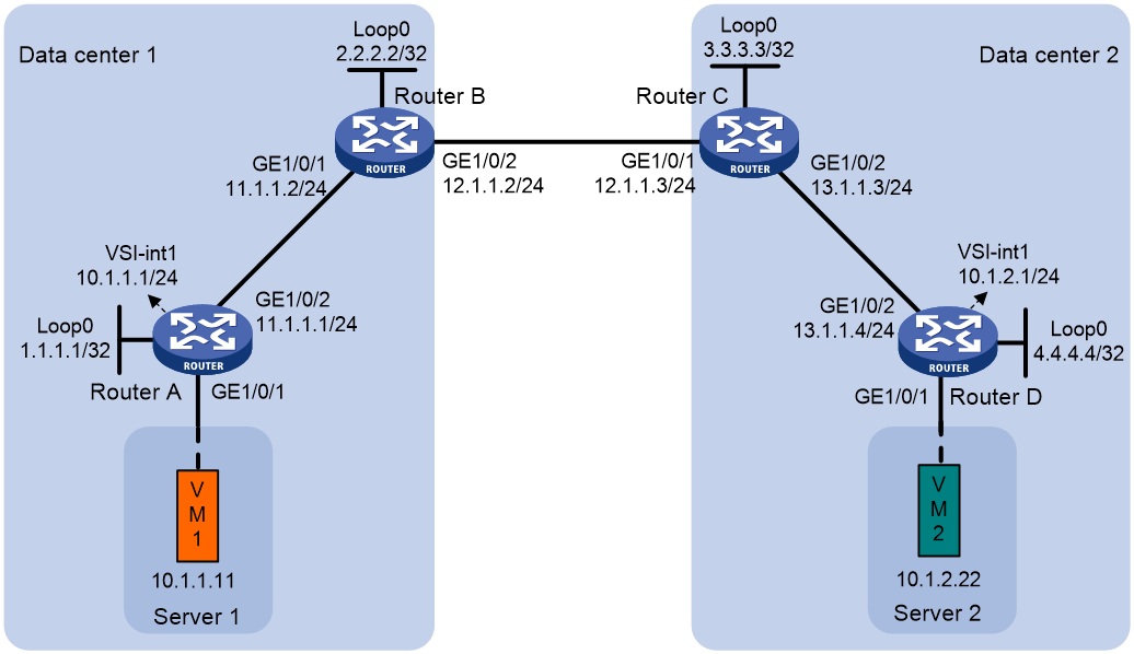

Example: Configuring EVPN-DCI Layer 3 communication
As shown in Figure 6:
· Configure VXLAN 10 for data center 1, and configure VXLAN 20 for data center 2.
· Configure Router A and Router D as distributed EVPN gateways to perform Layer 3 forwarding between VXLAN 10 and VXLAN 20.
· Configure Router B and Router C as EDs.
# On VM 1, specify 10.1.1.1 as the gateway address. On VM 2, specify 10.1.2.1 as the gateway address. (Details not shown.)
# Assign IP addresses to interfaces, as shown in Figure 6. (Details not shown.)
# Enable L2VPN.
# Disable remote MAC address learning and remote ARP learning.
[RouterA] vxlan tunnel arp-learning disable
[RouterA] vsi vpna
[RouterA-vsi-vpna-evpn-vxlan] vpn-target auto
[RouterA] bgp 100
# Configure RD and route target settings for VPN instance vpn1.
[RouterA] ip vpn-instance vpn1
[RouterA-vpn-instance-vpn1] route-distinguisher 1:1
[RouterA-vpn-instance-vpn1] address-family ipv4
[RouterA-vpn-ipv4-vpn1] vpn-target 2:2
[RouterA-vpn-ipv4-vpn1] quit
[RouterA-vpn-instance-vpn1] address-family evpn
[RouterA-vpn-evpn-vpn1] vpn-target 1:1
[RouterA-vpn-evpn-vpn1] quit
[RouterA-vpn-instance-vpn1] quit
# Configure VSI-interface 1 as a distributed gateway.
[RouterA] interface vsi-interface 1
[RouterA-Vsi-interface1] ip binding vpn-instance vpn1
[RouterA-Vsi-interface1] ip address 10.1.1.1 255.255.255.0
[RouterA-Vsi-interface1] mac-address 1-1-1
[RouterA-Vsi-interface1] distributed-gateway local
[RouterA-Vsi-interface1] quit
# Create VSI-interface 2. Associate VSI-interface 2 with VPN instance vpn1, and configure the L3 VXLAN ID as 1000 for the VPN instance.
[RouterA] interface vsi-interface 2
[RouterA-Vsi-interface2] ip binding vpn-instance vpn1
[RouterA-Vsi-interface2] l3-vni 1000
[RouterA-Vsi-interface2] quit
# Specify VSI-interface 1 as the gateway interface for VSI vpna.
[RouterA] vsi vpna
[RouterA-vsi-vpna] gateway vsi-interface 1
# Enable L2VPN.
[RouterB] vxlan tunnel arp-learning disable
[RouterB] bgp 100
[RouterB] ip vpn-instance vpn1
[RouterB-vpn-instance-vpn1] route-distinguisher 1:2
[RouterB-vpn-instance-vpn1] address-family ipv4
[RouterB-vpn-ipv4-vpn1] vpn-target 2:2
[RouterB-vpn-ipv4-vpn1] quit
[RouterB-vpn-instance-vpn1] address-family evpn
[RouterB-vpn-evpn-vpn1] vpn-target 1:1
[RouterB-vpn-evpn-vpn1] quit
[RouterB-vpn-instance-vpn1] quit
[RouterB] interface vsi-interface 2
[RouterB-Vsi-interface2] ip binding vpn-instance vpn1
[RouterB-Vsi-interface2] l3-vni 1000
[RouterB-Vsi-interface2] quit
# Enable L2VPN.
[RouterC] vxlan tunnel arp-learning disable
# Enable DCI on the Layer 3 interface that connects Router C to Router B For the routers to establish a VXLAN-DCI tunnel.
[RouterC] bgp 200
[RouterC] ip vpn-instance vpn1
[RouterC-vpn-instance-vpn1] route-distinguisher 1:3
[RouterC-vpn-instance-vpn1] address-family ipv4
[RouterC-vpn-ipv4-vpn1] vpn-target 2:2
[RouterC-vpn-ipv4-vpn1] quit
[RouterC-vpn-instance-vpn1] address-family evpn
[RouterC-vpn-evpn-vpn1] vpn-target 1:1
[RouterC-vpn-evpn-vpn1] quit
[RouterC-vpn-instance-vpn1] quit
[RouterC] interface vsi-interface 2
[RouterC-Vsi-interface2] ip binding vpn-instance vpn1
[RouterC-Vsi-interface2] l3-vni 1000
[RouterC-Vsi-interface2] quit
# Enable L2VPN.
[RouterD] vxlan tunnel arp-learning disable
# Create an EVPN instance on VSI vpnb. Configure the router to automatically generate an RD and a route target for the EVPN instance.
[RouterD] vsi vpnb
[RouterD-vsi-vpnb] evpn encapsulation vxlan
[RouterD-vsi-vpnb-evpn-vxlan] route-distinguisher auto
[RouterD-vsi-vpnb-evpn-vxlan] vpn-target auto
[RouterD-vsi-vpnb-evpn-vxlan] quit
# Create VXLAN 20 on VSI vpnb.
[RouterD-vsi-vpnb] vxlan 20
[RouterD-vsi-vpnb-vxlan-20] quit
[RouterD-vsi-vpnb] quit
[RouterD] bgp 200
# Map site-facing interface GigabitEthernet 1/0/1 to VSI vpnb.
[RouterD-GigabitEthernet1/0/1] xconnect vsi vpnb
[RouterD] ip vpn-instance vpn1
[RouterD-vpn-instance-vpn1] route-distinguisher 1:4
[RouterD] interface vsi-interface 1
[RouterD-Vsi-interface1] ip binding vpn-instance vpn1
[RouterD-Vsi-interface1] ip address 10.1.2.1 255.255.255.0
[RouterD-Vsi-interface1] mac-address 1-2-1
[RouterD-Vsi-interface1] distributed-gateway local
[RouterD-Vsi-interface1] quit
[RouterD] interface vsi-interface 2
[RouterD-Vsi-interface2] ip binding vpn-instance vpn1
[RouterD-Vsi-interface2] l3-vni 1000
[RouterD-Vsi-interface2] quit
# Specify VSI-interface 1 as the gateway interface for VSI vpnb.
[RouterD] vsi vpnb
[RouterD-vsi-vpnb] gateway vsi-interface 1
# Verify that the ED has discovered Router A and Router C through MAC/IP advertisement routes and IP prefix advertisement routes, and has established VXLAN and VXLAN-DCI tunnels to the routers.
[RouterB] display evpn auto-discovery macip-prefix
Destination IP Source IP L3VNI Tunnel mode OutgoingInterface
1.1.1.1 2.2.2.2 1000 VXLAN Vsi-interface2
3.3.3.3 2.2.2.2 1000 VXLAN-DCI Vsi-interface2
Tunnel0
Current state: UP
Bandwidth: 64 kbps
Tunnel1
Current state: UP
Bandwidth: 64 kbps
# Verify that the ED has EVPN ARP entries and EVPN routes for the VMs.
[RouterB] display arp vpn-instance vpn1
Type: S-Static D-Dynamic O-Openflow R-Rule M-Multiport I-Invalid
IP address MAC address VLAN/VSI name Interface/Link ID Aging Type
1.1.1.1 0031-1900-0000 Auto_L3VNI100 Tunnel0 -- R
0_2
3.3.3.3 0031-3900-0000 Auto_L3VNI100 Tunnel1 -- R
0_2
[RouterB] display ip routing-table vpn-instance vpn1
Destinations : 4 Routes : 4
Destination/Mask Proto Pre Cost NextHop Interface
10.1.1.0/24 BGP 255 0 1.1.1.1 Vsi2
10.1.1.11/32 BGP 255 0 1.1.1.1 Vsi2
10.1.2.0/24 BGP 255 0 3.3.3.3 Vsi2
10.1.2.22/32 BGP 255 0 3.3.3.3 Vsi2

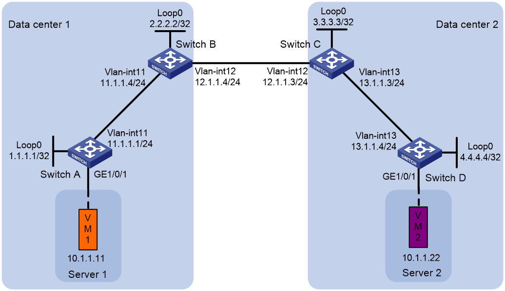

EVPN-DCI configuration examples (on switches)
As shown in Figure 8:
· Configure VXLAN 10 on Switch A through Switch D to provide connectivity for the VMs in the data centers.
· Configure Switch A and Switch D as VTEPs, and configure Switch B and Switch C as EDs.
# Assign IP addresses to interfaces, as shown in Figure 8. (Details not shown.)
# Configure OSPF on the transport network for the switches to reach one another. (Details not shown.)
2. Configure Switch A:
# Enable L2VPN.
<SwitchA> system-view
[SwitchA] l2vpn enable
[SwitchA] vxlan tunnel mac-learning disable
[SwitchA] vsi vpna
[SwitchA-vsi-vpna] vxlan 10
[SwitchA-vsi-vpna-vxlan-10] quit
# Create an EVPN instance on VSI vpna. Configure the switch to automatically generate an RD, and manually configure a route target for the EVPN instance.
[SwitchA-vsi-vpna] evpn encapsulation vxlan
[SwitchA-vsi-vpna-evpn-vxlan] route-distinguisher auto
[SwitchA-vsi-vpna-evpn-vxlan] vpn-target 123:456
[SwitchA-vsi-vpna-evpn-vxlan] quit
[SwitchA-vsi-vpna] quit
[SwitchA] bgp 100
[SwitchA-bgp-default] peer 2.2.2.2 as-number 100
[SwitchA-bgp-default] peer 2.2.2.2 connect-interface loopback 0
[SwitchA-bgp-default] address-family l2vpn evpn
[SwitchA-bgp-default-evpn] peer 2.2.2.2 enable
[SwitchA-bgp-default-evpn] quit
[SwitchA-bgp-default] quit
# On GigabitEthernet 1/0/1, create Ethernet service instance 1000 to match VLAN 100.
[SwitchA] interface gigabitethernet 1/0/1
[SwitchA-GigabitEthernet1/0/1] service-instance 1000
[SwitchA-GigabitEthernet1/0/1-srv1000] encapsulation s-vid 100
# Map Ethernet service instance 1000 to VSI vpna.
[SwitchA-GigabitEthernet1/0/1-srv1000] xconnect vsi vpna
[SwitchA-GigabitEthernet1/0/1-srv1000] quit

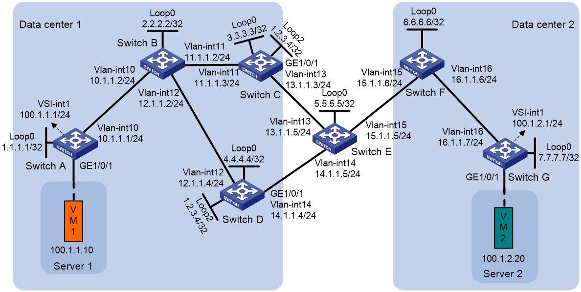

3. Configure Switch B:
# Enable L2VPN.
<SwitchB> system-view
[SwitchB] l2vpn enable
[SwitchB] vxlan tunnel mac-learning disable
# Enable DCI on the Layer 3 interface that connects Switch B to Switch C for the switches to establish a VXLAN-DCI tunnel.
[SwitchB] interface vlan-interface 12
[SwitchB-Vlan-interface12] dci enable
[SwitchB-Vlan-interface12] quit
[SwitchB] vsi vpna
[SwitchB-vsi-vpna] vxlan 10
[SwitchB-vsi-vpna-vxlan-10] quit
[SwitchB-vsi-vpna] evpn encapsulation vxlan
[SwitchB-vsi-vpna-evpn-vxlan] route-distinguisher auto
[SwitchB-vsi-vpna-evpn-vxlan] vpn-target 123:456
[SwitchB-vsi-vpna-evpn-vxlan] quit
[SwitchB-vsi-vpna] quit
# Configure BGP to advertise BGP EVPN routes. Enable nexthop replacement for routes advertised to Switch A, and enable router MAC replacement for routes advertised to and received from Switch C.
[SwitchB] bgp 100
[SwitchB-bgp-default] peer 3.3.3.3 as-number 200
[SwitchB-bgp-default] peer 3.3.3.3 connect-interface loopback 0
[SwitchB-bgp-default] peer 3.3.3.3 ebgp-max-hop 64
[SwitchB-bgp-default] peer 1.1.1.1 as-number 100
[SwitchB-bgp-default] peer 1.1.1.1 connect-interface loopback 0
[SwitchB-bgp-default] address-family l2vpn evpn
[SwitchB-bgp-default-evpn] peer 3.3.3.3 enable
[SwitchB-bgp-default-evpn] peer 3.3.3.3 router-mac-local
[SwitchB-bgp-default-evpn] peer 1.1.1.1 enable
[SwitchB-bgp-default-evpn] peer 1.1.1.1 next-hop-local
[SwitchB-bgp-default-evpn] quit
[SwitchB-bgp-default] quit
4. Configure Switch C:
# Enable L2VPN.
<SwitchC> system-view
[SwitchC] l2vpn enable
[SwitchC] vxlan tunnel mac-learning disable
# Enable DCI on the Layer 3 interface that connects Switch C to Switch B for the switches to establish a VXLAN-DCI tunnel.
[SwitchC] interface vlan-interface 12
[SwitchC-Vlan-interface12] dci enable
[SwitchC-Vlan-interface12] quit
[SwitchC] vsi vpna
[SwitchC-vsi-vpna] vxlan 10
[SwitchC-vsi-vpna-vxlan-10] quit
[SwitchC-vsi-vpna] evpn encapsulation vxlan
[SwitchC-vsi-vpna-evpn-vxlan] route-distinguisher auto
[SwitchC-vsi-vpna-evpn-vxlan] vpn-target 123:456
[SwitchC-vsi-vpna-evpn-vxlan] quit
[SwitchC-vsi-vpna] quit
# Configure BGP to advertise BGP EVPN routes. Enable nexthop replacement for routes advertised to Switch D, and enable router MAC replacement for routes advertised to and received from Switch B.
[SwitchC] bgp 200
[SwitchC-bgp-default] peer 2.2.2.2 as-number 100
[SwitchC-bgp-default] peer 2.2.2.2 connect-interface loopback 0
[SwitchC-bgp-default] peer 2.2.2.2 ebgp-max-hop 64
[SwitchC-bgp-default] peer 4.4.4.4 as-number 200
[SwitchC-bgp-default] peer 4.4.4.4 connect-interface loopback 0
[SwitchC-bgp-default] address-family l2vpn evpn
[SwitchC-bgp-default-evpn] peer 2.2.2.2 enable
[SwitchC-bgp-default-evpn] peer 2.2.2.2 router-mac-local
[SwitchC-bgp-default-evpn] peer 4.4.4.4 enable
[SwitchC-bgp-default-evpn] peer 4.4.4.4 next-hop-local
[SwitchC-bgp-default-evpn] quit
[SwitchC-bgp-default] quit
5. Configure Switch D:
# Enable L2VPN.
<SwitchD> system-view
[SwitchD] l2vpn enable

Example: Configuring EVPN-DCI dual-homing
As shown in Figure 11:
· Configure Switch A and Switch G as distributed EVPN gateways to perform Layer 3 forwarding between VXLAN 10 and VXLAN 20.
· Configure Switch C and Switch D as EDs of data center 1, and configure Switch F as the ED of data center 2.
· Configure Switch B as an RR.
# On VM 1, specify 100.1.1.1 as the gateway address. On VM 2, specify 100.1.2.1 as the gateway address. (Details not shown.)
# Assign IP addresses to the interfaces, as shown in Figure 11. (Details not shown.)
# Configure OSPF for the switches to reach one another. (Details not shown.)
# Enable L2VPN.
[SwitchA] vxlan tunnel arp-learning disable
[SwitchA] vsi vpna
# Create an EVPN instance on VSI vpna. Configure the switch to automatically generate an RD and a route target for the EVPN instance.
[SwitchA-vsi-vpna-evpn-vxlan] vpn-target auto
[SwitchA] bgp 100
[SwitchA] ip vpn-instance vpn1
[SwitchA-vpn-instance-vpn1] route-distinguisher 1:1
[SwitchA-vpn-instance-vpn1] address-family ipv4
[SwitchA-vpn-ipv4-vpn1] vpn-target 2:2
[SwitchA-vpn-ipv4-vpn1] quit
[SwitchA-vpn-instance-vpn1] address-family evpn
[SwitchA-vpn-evpn-vpn1] vpn-target 1:1
[SwitchA-vpn-evpn-vpn1] quit
[SwitchA-vpn-instance-vpn1] quit
[SwitchA] interface vsi-interface 1
[SwitchA-Vsi-interface1] ip binding vpn-instance vpn1
[SwitchA-Vsi-interface1] ip address 100.1.1.1 255.255.255.0
[SwitchA-Vsi-interface1] mac-address 1-1-1
[SwitchA-Vsi-interface1] distributed-gateway local
[SwitchA-Vsi-interface1] quit
[SwitchA] interface vsi-interface 2
[SwitchA-Vsi-interface2] ip binding vpn-instance vpn1
[SwitchA-Vsi-interface2] l3-vni 1000
[SwitchA-Vsi-interface2] quit
[SwitchA] vsi vpna
[SwitchA-vsi-vpna] gateway vsi-interface 1
3. Configure Switch B as an RR.
[SwitchB] bgp 100
[SwitchB-bgp-default] group evpn internal
[SwitchB-bgp-default] peer evpn connect-interface loopback 0
[SwitchB-bgp-default] peer 1.1.1.1 group evpn
[SwitchB-bgp-default] peer 3.3.3.3 group evpn
[SwitchB-bgp-default] peer 4.4.4.4 group evpn
[SwitchB-bgp-default-evpn] undo policy vpn-target
[SwitchB-bgp-default-evpn] peer evpn enable
[SwitchB-bgp-default-evpn] peer evpn reflect-client
# Enable L2VPN.
[SwitchC] vxlan tunnel arp-learning disable
# Enable DCI on the Layer 3 interface that connects Switch C to Switch E for automatic VXLAN-DCI tunnel establishment.
[SwitchC] interface vlan-interface 13
[SwitchC-Vlan-interface13] dci enable
[SwitchC-Vlan-interface13] quit
# Configure BGP to advertise BGP EVPN routes. Enable nexthop replacement for routes advertised to Switch B, and enable router MAC replacement for routes advertised to and received from Switch F.
[SwitchC] bgp 100
[SwitchC-bgp-default] peer 6.6.6.6 as-number 200
[SwitchC-bgp-default] peer 6.6.6.6 connect-interface loopback 0
[SwitchC-bgp-default] peer 6.6.6.6 ebgp-max-hop 64
[SwitchC-bgp-default-evpn] peer 6.6.6.6 enable
[SwitchC-bgp-default-evpn] peer 6.6.6.6 router-mac-local
[SwitchC-bgp-default-evpn] peer 2.2.2.2 next-hop-local
[SwitchC] ip vpn-instance vpn1
[SwitchC-vpn-instance-vpn1] route-distinguisher 1:2
[SwitchC-vpn-instance-vpn1] address-family ipv4
[SwitchC-vpn-ipv4-vpn1] vpn-target 2:2
[SwitchC-vpn-ipv4-vpn1] quit
[SwitchC-vpn-instance-vpn1] address-family evpn
[SwitchC-vpn-evpn-vpn1] vpn-target 1:1
[SwitchC-vpn-evpn-vpn1] quit
[SwitchC-vpn-instance-vpn1] quit
[SwitchC] interface vsi-interface 2
[SwitchC-Vsi-interface2] ip binding vpn-instance vpn1
[SwitchC-Vsi-interface2] l3-vni 1000
[SwitchC-Vsi-interface2] mac-address 1-2-3
[SwitchC-Vsi-interface2] quit
# Configure 1.2.3.4 as the virtual ED address, and assign the IP address to Loopback 2. Configure OSPF to advertise the virtual ED address.
[SwitchC] evpn edge group 1.2.3.4
[SwitchC] interface loopback 2
[SwitchC-LoopBack2] ip address 1.2.3.4 32
[SwitchC-LoopBack2] quit
[SwitchC] ospf
[SwitchC-ospf-1] area 0
[SwitchC-ospf-1-area-0.0.0.0] network 1.2.3.4 0.0.0.0
[SwitchC-ospf-1-area-0.0.0.0] quit
[SwitchC-ospf-1] quit
# Configure monitor link group 1 to associate GigabitEthernet 1/0/1 with Loopback 0. Set the switchover delay for the downlink interface to 90 seconds.
[SwitchC] undo monitor-link disable
[SwitchC] monitor-link group 1
[SwitchC-mtlk-group1] port gigabitethernet 1/0/1 uplink
[SwitchC-mtlk-group1] port loopback 0 downlink
[SwitchC-mtlk-group1] downlink up-delay 90
[SwitchC-mtlk-group1] quit
# Enable L2VPN.
[SwitchD] vxlan tunnel mac-learning disable
[SwitchD] vxlan tunnel arp-learning disable
# Enable DCI on the Layer 3 interface that connects Switch D to Switch E for automatic VXLAN-DCI tunnel establishment.
[SwitchD] interface vlan-interface 14
[SwitchD-Vlan-interface14] dci enable
[SwitchD-Vlan-interface14] quit
[SwitchD] bgp 100
[SwitchD-bgp-default] peer 6.6.6.6 as-number 200
[SwitchD-bgp-default] peer 6.6.6.6 connect-interface loopback 0
[SwitchD-bgp-default] peer 6.6.6.6 ebgp-max-hop 64
[SwitchD-bgp-default] peer 2.2.2.2 as-number 100
[SwitchD-bgp-default] peer 2.2.2.2 connect-interface loopback 0
[SwitchD-bgp-default] address-family l2vpn evpn
[SwitchD-bgp-default-evpn] peer 6.6.6.6 enable
[SwitchD-bgp-default-evpn] peer 6.6.6.6 router-mac-local
[SwitchD-bgp-default-evpn] peer 2.2.2.2 enable
[SwitchD-bgp-default-evpn] peer 2.2.2.2 next-hop-local
[SwitchD-bgp-default-evpn] quit
[SwitchD-bgp-default] quit
[SwitchD] ip vpn-instance vpn1
[SwitchD-vpn-instance-vpn1] route-distinguisher 1:2
[SwitchD-vpn-instance-vpn1] address-family ipv4
[SwitchD-vpn-ipv4-vpn1] vpn-target 2:2
[SwitchD-vpn-ipv4-vpn1] quit
[SwitchD-vpn-instance-vpn1] address-family evpn
[SwitchD-vpn-evpn-vpn1] vpn-target 1:1
[SwitchD-vpn-evpn-vpn1] quit
[SwitchD-vpn-instance-vpn1] quit
[SwitchD] interface vsi-interface 2
[SwitchD-Vsi-interface2] ip binding vpn-instance vpn1
[SwitchD-Vsi-interface2] l3-vni 1000
[SwitchD-Vsi-interface2] mac-address 1-2-3
[SwitchD-Vsi-interface2] quit
[SwitchD] evpn edge group 1.2.3.4
[SwitchD] interface loopback 2
[SwitchD-LoopBack2] ip address 1.2.3.4 32
[SwitchD-LoopBack2] quit
[SwitchD] ospf
[SwitchD-ospf-1] area 0
[SwitchD-ospf-1-area-0.0.0.0] network 1.2.3.4 0.0.0.0
[SwitchD-ospf-1-area-0.0.0.0] quit
[SwitchD-ospf-1] quit
[SwitchD] undo monitor-link disable
[SwitchD] monitor-link group 1
[SwitchD-mtlk-group1] port gigabitethernet 1/0/1 uplink
[SwitchD-mtlk-group1] port loopback 0 downlink
[SwitchD-mtlk-group1] downlink up-delay 90
[SwitchD-mtlk-group1] quit
6. Configure Switch F:
# Enable L2VPN.
<SwitchF> system-view
[SwitchF] l2vpn enable
[SwitchF] vxlan tunnel mac-learning disable
[SwitchF] vxlan tunnel arp-learning disable
# Enable DCI on the Layer 3 interface that connects Switch F to Switch E for automatic VXLAN-DCI tunnel establishment.
[SwitchF] interface vlan-interface 15
[SwitchF-Vlan-interface15] dci enable
[SwitchF-Vlan-interface15] quit
# Configure BGP to advertise BGP EVPN routes. Enable nexthop replacement for routes advertised to Switch G, and enable router MAC replacement for routes advertised to and received from Switch C and Switch D.
[SwitchF] bgp 200
[SwitchF-bgp-default] peer 3.3.3.3 as-number 100
[SwitchF-bgp-default] peer 3.3.3.3 connect-interface loopback 0
[SwitchF-bgp-default] peer 3.3.3.3 ebgp-max-hop 64
[SwitchF-bgp-default] peer 4.4.4.4 as-number 100
[SwitchF-bgp-default] peer 4.4.4.4 connect-interface loopback 0
[SwitchF-bgp-default] peer 4.4.4.4 ebgp-max-hop 64
[SwitchF-bgp-default] peer 7.7.7.7 as-number 200
[SwitchF-bgp-default] peer 7.7.7.7 connect-interface loopback 0
[SwitchF-bgp-default] address-family l2vpn evpn
[SwitchF-bgp-default-evpn] peer 3.3.3.3 enable
[SwitchF-bgp-default-evpn] peer 3.3.3.3 router-mac-local
[SwitchF-bgp-default-evpn] peer 4.4.4.4 enable
[SwitchF-bgp-default-evpn] peer 4.4.4.4 router-mac-local
[SwitchF-bgp-default-evpn] peer 7.7.7.7 enable
[SwitchF-bgp-default-evpn] peer 7.7.7.7 next-hop-local
[SwitchF-bgp-default-evpn] quit
[SwitchF-bgp-default] quit
[SwitchF] ip vpn-instance vpn1
[SwitchF-vpn-instance-vpn1] route-distinguisher 1:4
[SwitchF-vpn-instance-vpn1] address-family ipv4
[SwitchF-vpn-ipv4-vpn1] vpn-target 2:2
[SwitchF-vpn-ipv4-vpn1] quit
[SwitchF-vpn-instance-vpn1] address-family evpn
[SwitchF-vpn-evpn-vpn1] vpn-target 1:1
[SwitchF-vpn-evpn-vpn1] quit
[SwitchF-vpn-instance-vpn1] quit
[SwitchF] interface vsi-interface 2
[SwitchF-Vsi-interface2] ip binding vpn-instance vpn1
[SwitchF-Vsi-interface2] l3-vni 1000
[SwitchF-Vsi-interface2] quit
7. Configure Switch G:
# Enable L2VPN.
<SwitchG> system-view
[SwitchG] l2vpn enable
[SwitchG] vxlan tunnel mac-learning disable
[SwitchG] vxlan tunnel arp-learning disable
[SwitchG] vsi vpnb
[SwitchG-vsi-vpnb] vxlan 20
[SwitchG-vsi-vpnb-vxlan-20] quit
# Create an EVPN instance on VSI vpnb. Configure the switch to automatically generate an RD and a route target for the EVPN instance.
[SwitchG-vsi-vpnb] evpn encapsulation vxlan
[SwitchG-vsi-vpnb-evpn-vxlan] route-distinguisher auto
[SwitchG-vsi-vpnb-evpn-vxlan] vpn-target auto
[SwitchG-vsi-vpnb-evpn-vxlan] quit
[SwitchG-vsi-vpnb] quit
[SwitchG] bgp 200
[SwitchG-bgp-default] peer 6.6.6.6 as-number 200
[SwitchG-bgp-default] peer 6.6.6.6 connect-interface loopback 0
[SwitchG-bgp-default] address-family l2vpn evpn
[SwitchG-bgp-default-evpn] peer 6.6.6.6 enable
[SwitchG-bgp-default-evpn] quit
[SwitchG-bgp-default] quit
# On GigabitEthernet 1/0/1, create Ethernet service instance 2000 to match VLAN 200.
[SwitchG] interface gigabitethernet 1/0/1
[SwitchG-GigabitEthernet1/0/1] service-instance 2000
[SwitchG-GigabitEthernet1/0/1-srv2000] encapsulation s-vid 200
# Map Ethernet service instance 2000 to VSI vpnb.
[SwitchG-GigabitEthernet1/0/1-srv2000] xconnect vsi vpnb
[SwitchG-GigabitEthernet1/0/1-srv2000] quit
[SwitchG] ip vpn-instance vpn1
[SwitchG-vpn-instance-vpn1] route-distinguisher 1:4
[SwitchG-vpn-instance-vpn1] address-family ipv4
[SwitchG-vpn-ipv4-vpn1] vpn-target 2:2
[SwitchG-vpn-ipv4-vpn1] quit
[SwitchG-vpn-instance-vpn1] address-family evpn
[SwitchG-vpn-evpn-vpn1] vpn-target 1:1
[SwitchG-vpn-evpn-vpn1] quit
[SwitchG-vpn-instance-vpn1] quit
[SwitchG] interface vsi-interface 1
[SwitchG-Vsi-interface1] ip binding vpn-instance vpn1
[SwitchG-Vsi-interface1] ip address 100.1.2.1 255.255.255.0
[SwitchG-Vsi-interface1] mac-address 2-2-2
[SwitchG-Vsi-interface1] distributed-gateway local
[SwitchG-Vsi-interface1] quit
[SwitchG] interface vsi-interface 2
[SwitchG-Vsi-interface2] ip binding vpn-instance vpn1
[SwitchG-Vsi-interface2] l3-vni 1000
[SwitchG-Vsi-interface2] quit
[SwitchG] vsi vpnb
[SwitchG-vsi-vpnb] gateway vsi-interface 1
1. Verify the configuration on EDs. (This example uses Switch C.)
# Verify that the ED has discovered Switch A and Switch F through MAC/IP advertisement routes and IP prefix advertisement routes, and has established VXLAN and VXLAN-DCI tunnels to the switches.
[SwitchC] display evpn auto-discovery macip-prefix
Destination IP Source IP L3VNI Tunnel mode OutInterface
1.1.1.1 1.2.3.4 1000 VXLAN Vsi-interface2
6.6.6.6 1.2.3.4 1000 VXLAN-DCI Vsi-interface2
[SwitchC] display interface tunnel
Tunnel0
Current state: UP
Bandwidth: 64 kbps
Tunnel source 1.2.3.4, destination 1.1.1.1
Tunnel1
Current state: UP
Bandwidth: 64 kbps
Tunnel source 1.2.3.4, destination 6.6.6.6
# Verify that the ED has ARP entries and routes for the VMs.
[SwitchC] display arp vpn-instance vpn1
Type: S Type: S-Static D-Dynamic O-Openflow R-Rule M-Multiport I-Invalid
0_2
6.6.6.6 0031-3900-0000 Auto_L3VNI100 Tunnel1 -- R
0_2
[SwitchC] display ip routing-table vpn-instance vpn1
100.1.1.0/24 BGP 255 0 1.1.1.1 Vsi2
100.1.1.10/32 BGP 255 0 1.1.1.1 Vsi2
100.1.2.0/24 BGP 255 0 6.6.6.6 Vsi2
100.1.2.20/32 BGP 255 0 6.6.6.6 Vsi2
2. Verify the configuration on Switch A:
# Verify that the switch has discovered the virtual ED through MAC/IP advertisement routes and IP prefix advertisement routes, and has established a VXLAN tunnel to the virtual ED.
[SwitchA] display evpn auto-discovery macip-prefix
1.2.3.4 1.1.1.1 1000 VXLAN Vsi-interface2
# Verify that the VXLAN tunnel on the switch is up.
[SwitchA] display interface tunnel
Tunnel0
Current state: UP
Bandwidth: 64 kbps
Tunnel source 1.1.1.1, destination 1.2.3.4
# Verify that the switch has ARP entries and routes for the VMs.
[SwitchA] display arp vpn-instance vpn1
1.2.3.4 0031-1900-0001 Auto_L3VNI100 Tunnel0 -- R
0_2
[SwitchA] display ip routing-table vpn-instance vpn1
100.1.2.0/24 BGP 255 0 1.2.3.4 Vsi2
100.1.2.10/32 BGP 255 0 1.2.3.4 Vsi2
Verify that VM 1 and VM 2 can communicate when both Switch C and Switch D are working correctly and when Switch C or Switch D fails. (Details not shown.)
