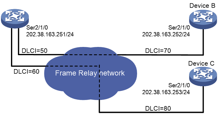

Frame Relay network components
As shown in Figure 1:
· A Frame Relay network provides data communications between user devices such as routers and hosts. The user devices are also called data terminal equipment (DTE).
· The devices that provide access to the Frame Relay network for DTEs are called data circuit-terminating equipment (DCE).
Frame Relay interfaces include the following types:
· User-to-network interface (UNI)—A DCE is connected to a DTE through UNI interfaces. UNI interfaces include the following types:
¡ DTE interface—The UNI interface on the DTE side.
¡ DCE interface—The UNI interface on the DCE side.
· Network-to-network interface (NNI)—A DCE is connected to a Frame Relay switch in the Frame Relay network through an NNI interface. The switches in the Frame Relay network are interconnected with NNI interfaces.
A DTE interface can connect only to a DCE interface, and an NNI interface can connect only to an NNI interface. On a Frame Relay switch, the Frame Relay interface type must be NNI or DCE.

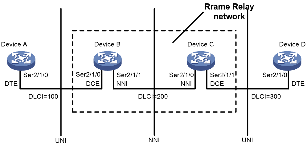

· Device B and Device C form a simple Frame Relay network.
· DTE devices Device A and Device D are attached to the network.
The interface type DTE or DCE is identified only for the UNI interfaces. A virtual circuit between two DTE devices can be assigned different DLCIs on different segments.

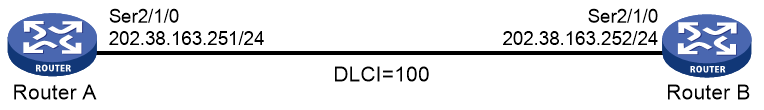

With Frame Relay, you can construct a public or private network as shown in Figure 2 and construct direct connections between data devices as shown in Figure 3.
Figure 2 Interconnecting LANs through a Frame Relay network
Figure 3 Interconnecting LANs through a dedicated line

Frame Relay configuration examples
Example: Interconnecting LANs through a dedicated line
As shown in Figure 4, configure Frame Relay so that Router A and Router B can communicate.

MFR configuration examples
Example: Configuring MFR
As shown in Figure 6, use MFR to bind the physical links between Router A and Router B into a logical link with higher bandwidth than each physical link.
