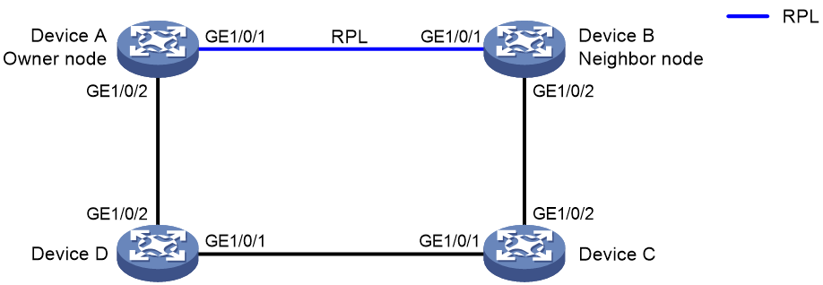

ERPS structure
Figure 1 ERPS ring structure
Rings
ERPS rings can be divided into major rings and subrings. An ERPS network consists of one major ring or multiple major rings, and multiple subrings. By default, a ring is a major ring. You can configure a ring as a subring manually.
As shown in Figure 1, a major ring is a closed ring formed by Device A, Device B, Device C, and Device D. A subring is an open ring formed by the link Device C<—>Device E<—>Device F<—>Device D.
RPL
An ERPS ring is composed of many nodes. Some nodes use ring protection links (RPLs) to prevent loops on the ERPS ring. As shown in Figure 1, the link between Device A and Device B and the link between Device E and Device F are RPLs.
Nodes
ERPS nodes include owner nodes, neighbor nodes, interconnection nodes, and normal nodes.
·     The owner node and neighbor node block and unblock ports on the RPL to prevent loops and switch traffic. An RPL connects an owner node and a neighbor node.
·     Interconnection nodes connect different rings. Interconnection nodes reside on subrings and forward service packets but not protocol packets.
·     Normal nodes forward both service packets and protocol packets.
As shown in Figure 1, on the major ring, Device A is the owner node and Device B is the neighbor node. On the subring, Device E is the owner node and Device F is the neighbor node. Devices C and D are interconnection nodes.

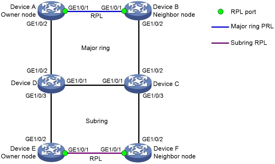

Multi-instance load balancing mechanism
Figure 4 Multi-instance load balancing mechanism
An ERPS ring topology might carry traffic from multiple VLANs. Traffic from different VLANs can be load balanced among different ERPS instances.
ERPS uses the following types of VLANs:
·     Control VLAN—Carries ERPS protocol packets. Each ERPS instance has its own control VLAN.
·     Protected VLAN—Carries data packets. Each ERPS instance has its own protected VLAN. Protected VLANs are configured by using the mappings between VLANs and MSTIs.
As shown in Figure 4, the ERPS ring is configured with instance 1 and instance 2. For instance 1, the owner node is Device A, and the RPL is the link between Device A and Device B. For instance 2, the owner node is Device C, and the RPL is the link between Device C and Device D. Traffic from different VLANs can be load balanced among different links.

Example: Configuring one ring
As shown in Figure 11, perform the following tasks to eliminate loops on the network:
·     Configure the ring as ERPS ring 1.
·     Configure VLAN 100 as the control VLAN for ERPS ring 1.
·     Configure VLANs 1 to 30 as the protected VLANs for ERPS ring 1.
·     Configure Device A as the owner node, GigabitEthernet 1/0/1 as ERPS ring member port 0 and the RPL port, and GigabitEthernet 1/0/2 as ERPS ring member port 1.
·     Configure Device B as the neighbor node, GigabitEthernet 1/0/1 as ERPS ring member port 0 and the RPL port, and GigabitEthernet 1/0/2 as ERPS ring member port 1.
·     Configure Device C and Device D as normal nodes, GigabitEthernet 1/0/1 as ERPS ring member port 0, and GigabitEthernet 1/0/2 as ERPS ring member port 1.
Figure 11 Network diagram

Example: Configuring one subring
As shown in Figure 12, perform the following tasks to eliminate loops on the network:
·     Configure VLAN 100 and VLAN 200 as the control VLANs for the major ring and the subring, respectively.
·     Configure VLANs 1 to 30 as the protected VLANs for the major ring and subring.
·     Configure Device A as the owner node for the major ring, GigabitEthernet 1/0/1 as ERPS ring member port 0 and the RPL port, and GigabitEthernet 1/0/2 as ERPS ring member port 1.
·     Configure Device B as the neighbor node for the major ring, GigabitEthernet 1/0/1 as ERPS ring member port 0 and the RPL port, and GigabitEthernet 1/0/2 as ERPS ring member port 1.
·     Configure Devices C and D as interconnection nodes, GigabitEthernet 1/0/1 as ERPS ring member port 0, GigabitEthernet 1/0/2 as ERPS ring member port 1, and GigabitEthernet 1/0/3 as the interconnection port.
·     Configure Device E as the owner node for the subring, GigabitEthernet 1/0/1 as ERPS ring member port 0 and the RPL port, and GigabitEthernet 1/0/2 as ERPS ring member port 1.
·     Configure Device F as the neighbor node for the subring, GigabitEthernet 1/0/1 as ERPS ring member port 0 and the RPL port, and GigabitEthernet 1/0/2 as ERPS ring member port 1.
Figure 12 Network diagram

Example: Configuring one-ring multi-instance load balancing
As shown in Figure 13, perform the following tasks to improve network resource utilization and implement load balancing among links:
·     Configure ERPS instances 1 and 2 on the ERPS ring.
·     For ERPS instance 1, configure the following items:
¡     Configure Device A as the owner node.
¡     Configure the link between Devices A and Device B as the RPL.
¡     Configure VLAN 100 as the control VLAN.
¡     Configure VLANs 1 to 30 as the protected VLANs.
·     For ERPS instance 2, configure the following items:
¡     Configure the link between Devices C and Device D as the RPL.
¡     Configure VLANs 31 to 60 as the protected VLANs.
Figure 13 Network diagram
