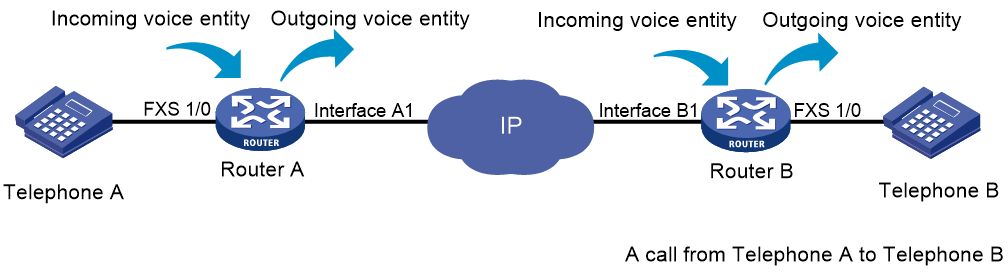

Voice entities include POTS entities, VoIP entities, and IVR entities. You can configure voice entities based on the types of connected devices.
Figure 1 Voice entities
·     POTS entity—A POTS entity connects to a local telephone or a PSTN network. When connecting to a local telephone, a POTS entity maintains local number information. When connecting to a PSTN network, a POTS entity maintains call destination information.
·     VoIP entity—Connects to the IP side. A VoIP entity uses SIP to make VoIP calls. VoIP entities include the following categories:
¡     Dynamic and static VoIP entities.
¡     Incoming and outgoing VoIP entities.
A static incoming VoIP entity maintains the called information such as called number and call destination. Other types of VoIP entities are used in SRST. For more information, see "Configuring SRST."
·     IVR entity—Sets a customizable IVR system. For more information about IVR entities, see "Configuring customizable IVR."

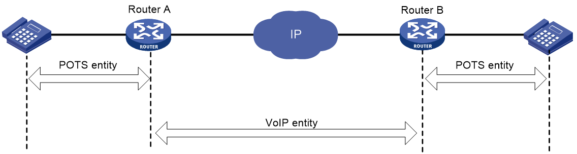

Incoming voice entities and outgoing voice entities
Each call has an incoming voice entity and an outgoing voice entity on the device.
·     Incoming voice entity—Matches incoming calls. The device selects an incoming voice entity for an incoming call based on the calling number, the called number, or the PSTN interface. Incoming voice entities are used in the call pickup service and SIP register authentication.
·     Outgoing voice entity—Matches outgoing calls. The device selects an outgoing voice entity for an outgoing call based on the called number. Outgoing voice entities are used to route calls to call destinations.
