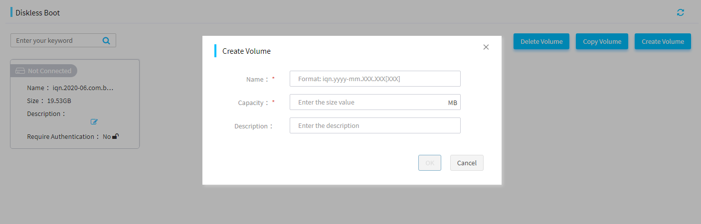

Create a storage volume
1.     Log in to UniSystem.
2.     In the navigation pane, select Menu > Templates > Diskless Boot.
3.     Click Create Volume and create a volume.
Figure 1 Creating a volume

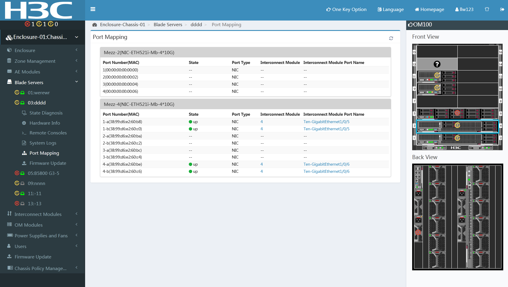

1.     Log in to OM of the server, select Blade Servers > Blade_Server > Port Mapping. Then, Identify the location of the Ethernet adapter of the server to perform diskless boot and verify that the interconnect module connected to the Ethernet adapter is present.
Figure 3 Port mapping on the OM

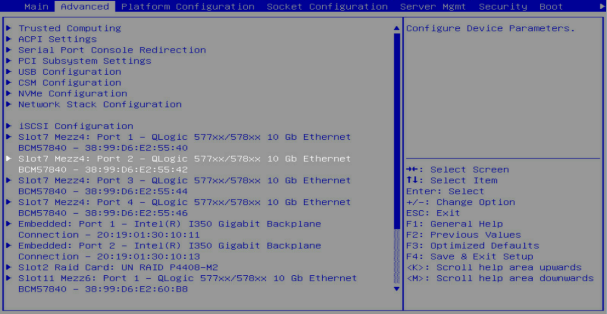

2.     Enter the BIOS setup utility, select Advanced, select the Slot x Port x entry of the Ethernet adapter, and press Enter.
Figure 4 Advanced screen

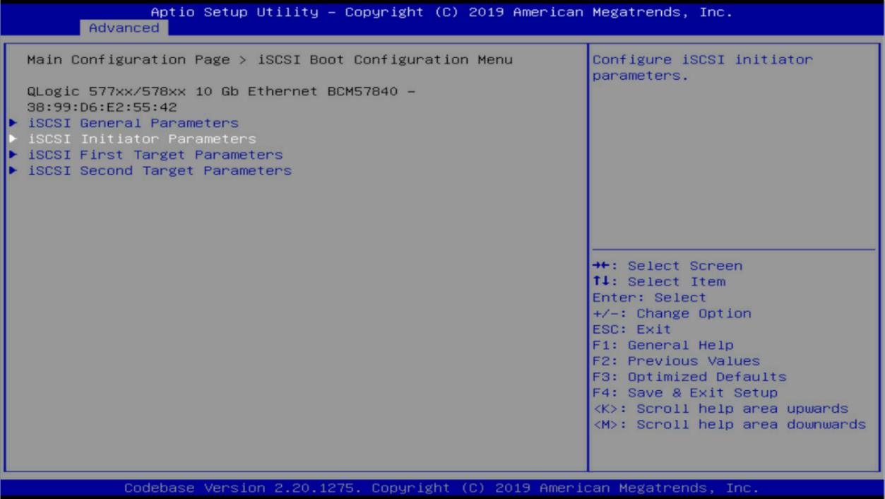

5.     Press ESC, select iSCSI Boot Configuration Menu, and press Enter.
Figure 7 Main Configuration Page menu screen

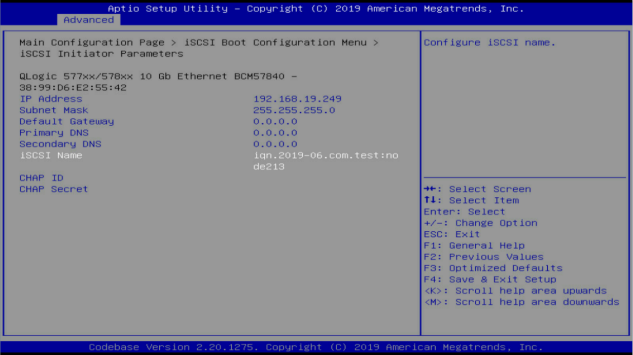

8.     Press ESC, select iSCSI Initiator Parameters, and press Enter.
Figure 10 iSCSI Boot Configuration Menu screen
9.     Configure the iSCSI initiator parameters as follows:
a.     (Optional.) Set the IP address and subnet mask if TCP/IP Parameters via DHCP is disabled. The Ethernet adapter will use the IP address to communicate with the storage volume.
b.     (Optional.) Set the default gateway and DNS settings as needed.
c.     Set the iSCSI name, the unique IQN name that the Ethernet adapter uses to connect to the storage volume.
d.     (Optional.) Set the CHAP ID and CHAP secret (the credentials of the storage volume) if CHAP authentication is enabled for the storage volume.
Each time you edit the iSCSI target parameters, you must reset the CHAP ID and CHAP secret.
Figure 11 iSCSI Initiator Parameters submenu screen

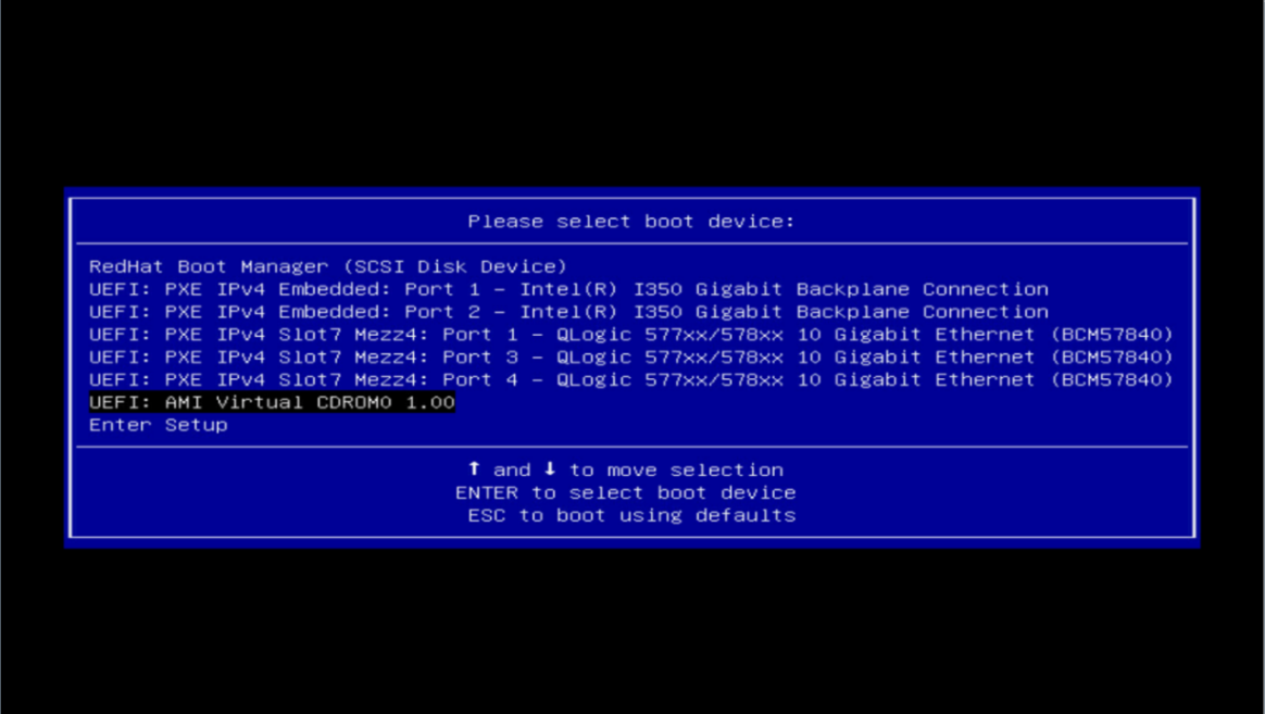

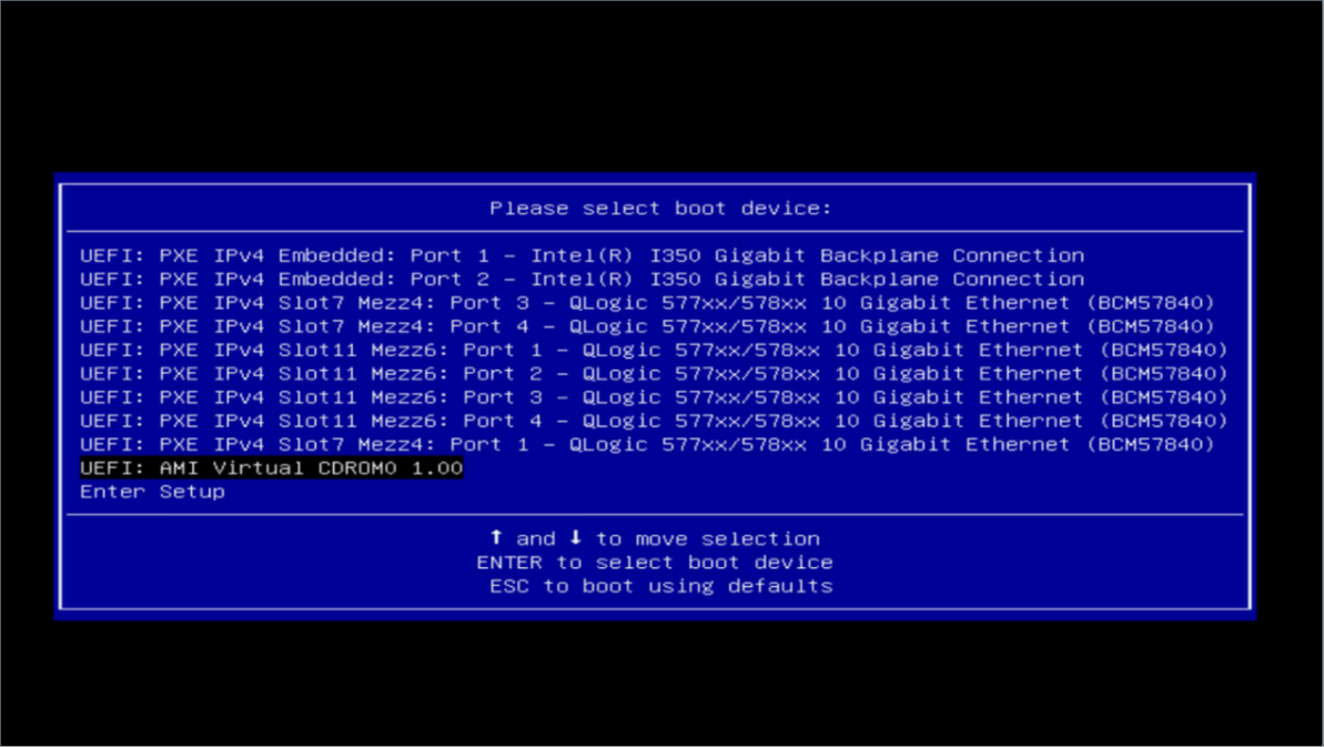

1.     Enter the BIOS setup utility of the server.
2.     Select the virtual CDROM as the boot device, and press Enter.
Figure 14 Boot menu

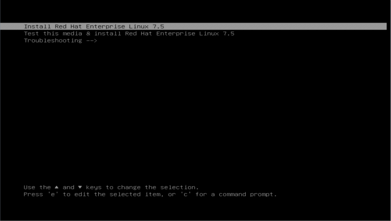

3.     On the boot splash screen, select the first or second item, and press e.
Figure 15 Boot splash screen

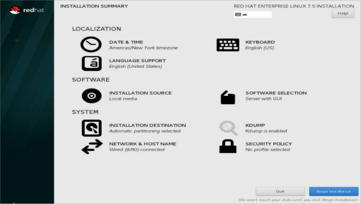

6.     On the installation summary screen, verify that the NETWORK & HOSTNAME section displays ibft0 connected, which indicates the system obtains the Ethernet adapter settings on BIOS.
Figure 18 Installation summary screen

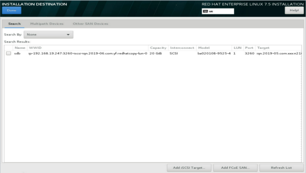

7.     Click INSTALLATION DESTINATION to select target installation drives. In this example, the storage volume created on the AE module is used.
8.     On the INSTALLATION DESTINATION screen, click Add a disk in the Specialized & Network Disks section. Do not select a local disk in Local Standard Disks.
Figure 19 INSTALLATION DESTINATION screen
9.     On the Add a disk screen, verify that the IQN name and capacity of the iSCSI storage controller are correct. Then, select this iSCSI storage controller, and click Done.
If no iSCSI storage controller is displayed, verify that the Ethernet adapter is correctly configured and the network environment is correctly set up.
Figure 20 Add a disk screen

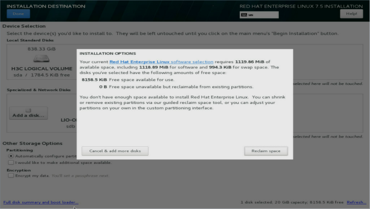

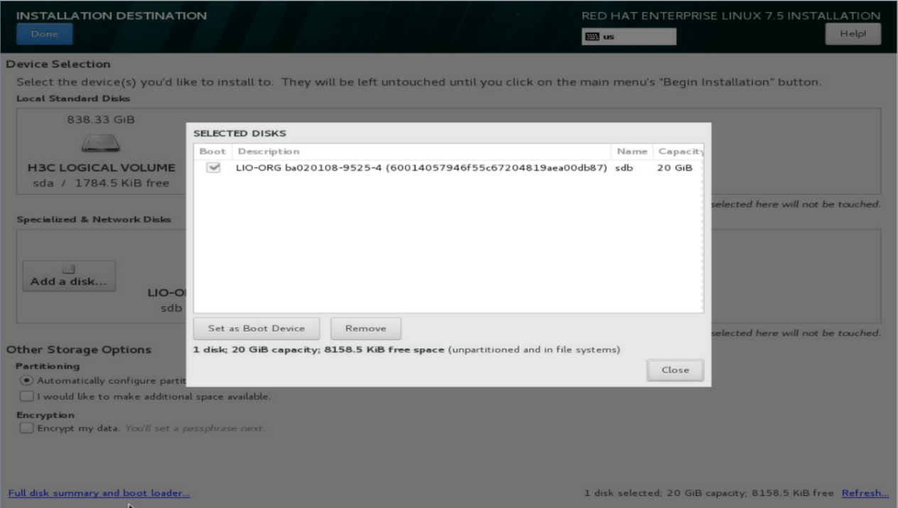

10.     On the INSTALLATION DESTINATION screen, click Full disk summary and boot loader at the bottom left corner. Then, on the dialog box that opens, verify the boot device of the iSCSI storage volume is correct, select the boot device, and click Close.
Figure 21 SELECTED DISKS dialog box
11.     Select a partition method for the Partitioning parameter in the Other Storage Options section. This example uses automatic partitioning.
If the iSCSI storage volume already has partitions, the system will prompt you to repartition. Click Reclaim space and then repartition the iSCSI storage volume.
Figure 22 INSTALLATION OPTIONS screen

Figure 23 Installation summary screen
14.     Reboot the server.
2.     Select the virtual CDROM as the boot device, and press Enter. This example uses ESXi 6.5 U2. For ESXi 6.7, the installation procedure is the same.
Figure 24 Boot menu screen

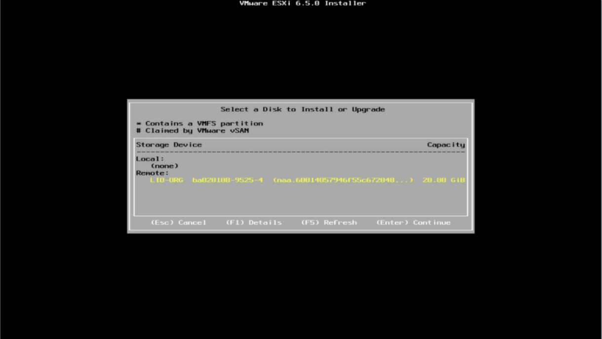

4.     On the dialog box that opens, select the iSCSI storage volume, and press Enter.
If no iSCSI storage volume is displayed, verify that the Ethernet adapter is correctly configured and the network environment is correctly set up.
Figure 26 Selecting a drive to install the OS

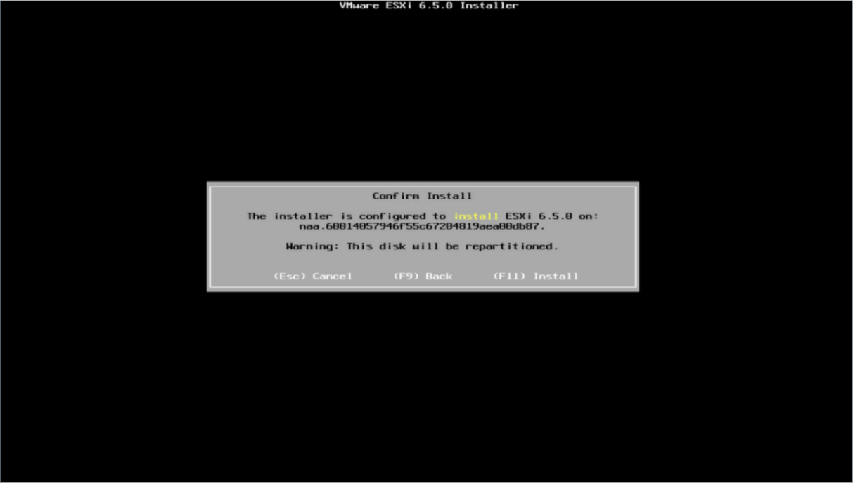

5.     (Optional.) On the Confirm Disk Selection dialog box that opens, click OK. If the iSCSI storage volume already has partitions, the system will overwrite the storage volume.
Figure 27 Overwriting the partitions on the drive
Figure 28 Repartitioning the drive

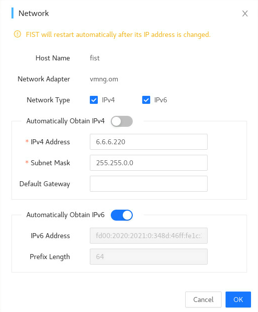

Configure the IP address of the UniSystem server
1.     Access the Web interface of UniSystem VGA.
2.     Click the Network Settings icon  in the upper right corner.
3.     In the Network window that opens, set the system IP address of the UniSystem server.
Figure 30 Configure the IP address of the UniSystem server
