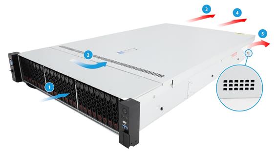

Airflow direction of the server
Figure 2 Airflow direction of the server
(1) and (2) Directions of the airflow into the chassis and power supply |
(3) Directions of the airflow out of the power supply |
(4) and (5) Direction of the airflow out of the chassis |

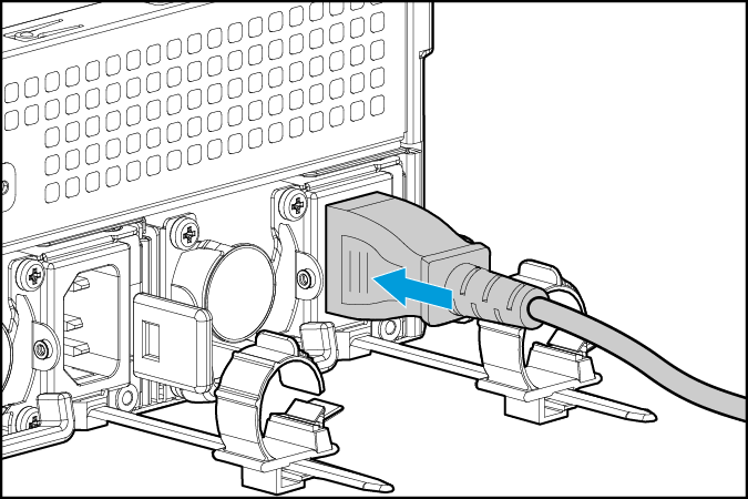

Connecting the power cord
Guidelines
WARNING! To avoid damage to the equipment or even bodily injury, use the power cord that ships with the server. |
Before connecting the power cord, make sure the server and components are installed correctly.
1. Insert the power cord plug into the power receptacle of a power supply at the rear panel, as shown in Figure 8.
Figure 8 Connecting the power cord
2. Connect the other end of the power cord to the power source, for example, the power strip on the rack.
3. Secure the power cord to avoid unexpected disconnection of the power cord.
Multiple types of wire fasteners can be used for securing the power cord. In this procedure, a cable clamp is used.
a. If the cable clamp is positioned too near the power cord that it blocks the power cord plug connection, press down the tab on the cable mount and slide the clip backward.
Figure 9 Sliding the cable clamp backward
b. Open the cable clamp, place the power cord through the opening in the cable clamp, and then close the cable clamp, as shown by callouts 1, 2, 3, and 4 in Figure 10.
Figure 10 Securing the AC power cord
c. Slide the cable clamp forward until it is flush against the edge of the power cord plug, as shown in Figure 11.
Figure 11 Sliding the cable clamp forward

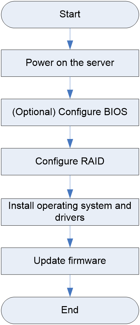

Configuration flowchart
Figure 14 Configuration flowchart
Powering on the server
1. Power on the server. For information about the procedures, see "Powering on the server."
2. Verify that the health LED on the front panel is steady green, which indicates that the system is operating correctly. For more information about the health LED status, see "LEDs and buttons."
Configuring basic BIOS settings
You can set the server boot order and the BIOS passwords from the BIOS setup utility of the server.
NOTE: The BIOS setup utility screens are subject to change without notice. |
Setting the server boot order
The server has a default boot order. You can change the server boot order from the BIOS. For the default boot order and the procedure of changing the server boot order, see the BIOS user guide for the server.
Setting the BIOS passwords
BIOS passwords include a boot password as well as an administrator password and a user password for the BIOS setup utility. By default, no passwords are set.
To prevent unauthorized access and changes to the BIOS settings, set both the administrator and user passwords for accessing the BIOS setup utility. Make sure the two passwords are different.
After setting the administrator password and user password for the BIOS setup utility, you must enter the administrator password or user password each time you access the BIOS setup utility.
· To obtain administrator privileges, enter the administrator password.
· To obtain the user privileges, enter the user password.
For the difference between the administrator and user privileges and guidelines for setting the BIOS passwords, see the BIOS user guide for the server.
Configuring RAID
Configure physical and logical drives (RAID arrays) for the server.
The supported RAID levels and RAID configuration methods vary by storage controller model. For more information, see the storage controller user guide for the server.
Installing the operating system and hardware drivers
Install a compatible operating system on the server by following the procedures described in the operating system installation guide for the server.
For the server compatibility with the operating systems, visit the component compatibility lookup tool at http://www.h3c.com/en/home/qr/default.htm?id=66.
Installing hardware drivers
IMPORTANT: To avoid hardware unavailability caused by an update failure, always back up the drivers before you update them. |
For newly installed hardware to operate correctly, the operating system must have the required hardware drivers.
To install a hardware driver, see the operating system installation guide for the server.
Updating firmware
IMPORTANT: Verify the hardware and software compatibility before firmware upgrade. For information about the hardware and software compatibility, see the software release notes. |
You can update the following firmware from FIST or HDM:
· HDM.
· BIOS.
· CPLD.
· BPCPLD.
· PSU.
· LCD.
For information about the update procedures, see the firmware update guide for the server.

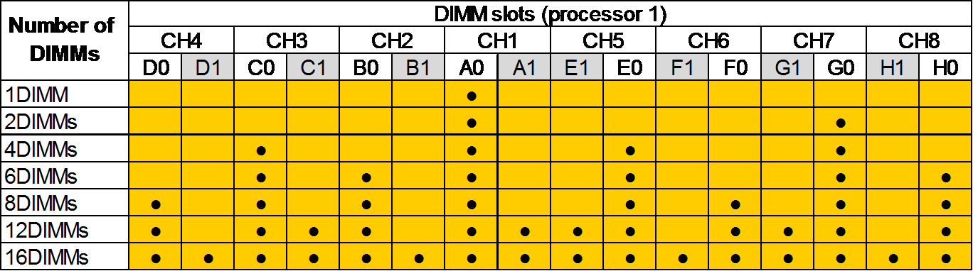

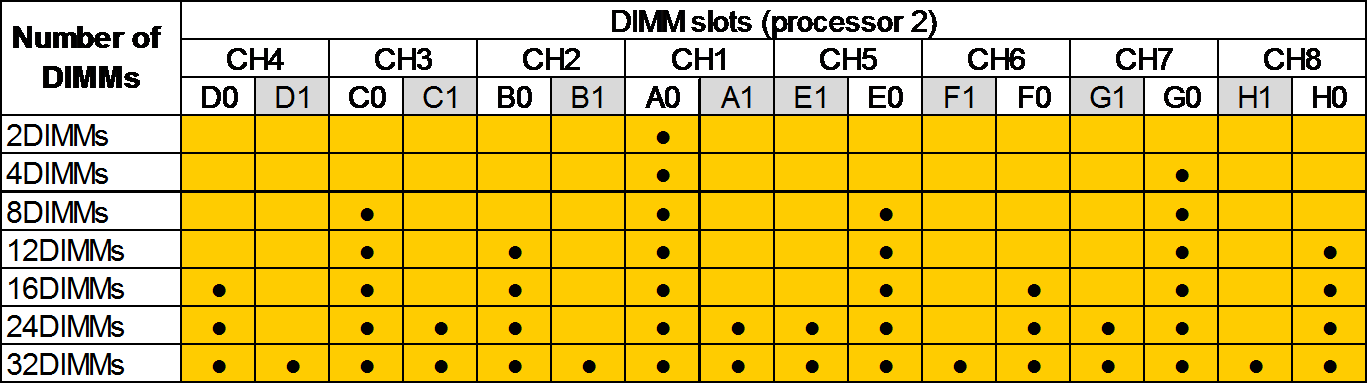

Installation guidelines
When you install only DDR5 DIMMs, follow these restrictions and guidelines:
· Make sure their corresponding processors are present before powering on the server.
· As a best practice, install DDR5 DIMMs that have the same product code and DIMM specification (type, capacity, rank, and frequency). For information about DIMM product codes, use the component compatibility lookup tool at http://www.h3c.com/en/home/qr/default.htm?id=66. To install components or replace faulty DIMMs of other specifications, contact Technical Support.
· For the configured memory mode to take effect, make sure the following installation requirements are met:

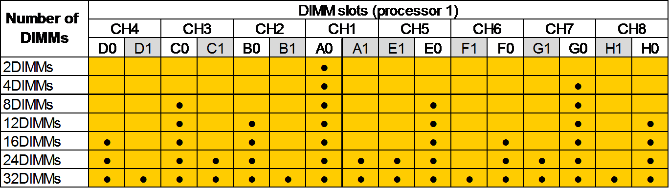

Memory mode |
DIMM population requirements |
Independent |
· If one processor is present, see Figure 15. · If two processors are present, see Figure 16 and Figure 17. |
Mirror |
· If one processor is present, this mode is supported only when 8 DIMMs or 16 DIMMs are installed. For more information, see Figure 15. · If two processors are present, this mode is supported only when 16 DIMMs or 32 DIMMs are installed. For more information, see Figure 16 and Figure 17. |
NOTE: · If the DIMM configuration does not meet the requirements for the configured memory mode, the system uses the default memory mode (Independent mode). · In Figure 15, Figure 16, and Figure 17, the black DIMM slots (for example, the D1 slot) are grey colored, and the white DIMM slots (for example, the D0 slot) are not colored. |
Figure 15 DDR5 DIMM population schemes for one processor
Figure 16 DDR5 DIMM population schemes for two processors (1)
Figure 17 DDR5 DIMM population schemes for two processors (2)

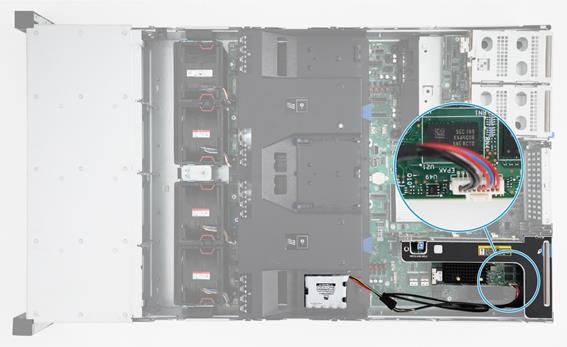

Replacing a storage controller and a power fail safeguard module
WARNING! To avoid bodily injury from hot surfaces, allow the server and its internal modules to cool before touching them. |
For some storage controllers, you can order a power fail safeguard module to prevent data loss when power outage occurs.
A power fail safeguard module provides a flash card and a supercapacitor. When a system power failure occurs, this supercapacitor can provide power for a minimum of 20 seconds. During this interval, the storage controller transfers data from DDR memory to the flash card, where the data remains indefinitely or until the controller retrieves the data.
A supercapacitor has a lifespan of 3 to 5 years. If the lifespan of a supercapacitor expires, a supercapacitor exception might occur. The system notifies users of supercapacitor exceptions by using the following methods:
· For a PMC storage controller, the status of the flash card will become Abnormal_status code. You can check the status code to identify the exception. For more information, see HDM2 online help.
· For an LSI storage controller, the status of the flash card of the power fail safeguard module will become Abnormal.
You can also review log messages from HDM2 to identify supercapacitor exceptions.
For the power fail safeguard module to take effect, replace the supercapacitor before its lifespan expires.
The supercapacitor might have a low charge after the power fail safeguard module is installed or after the server is powered up. If the system displays that the supercapacitor has low charge, no action is required. The system will charge the supercapacitor automatically. You can view the status of the supercapacitor from HDM or the BIOS.
IMPORTANT: After the supercapacitor replacement, verify that cache related settings are enabled for logical drives. For more information, see HDM2 online help. |

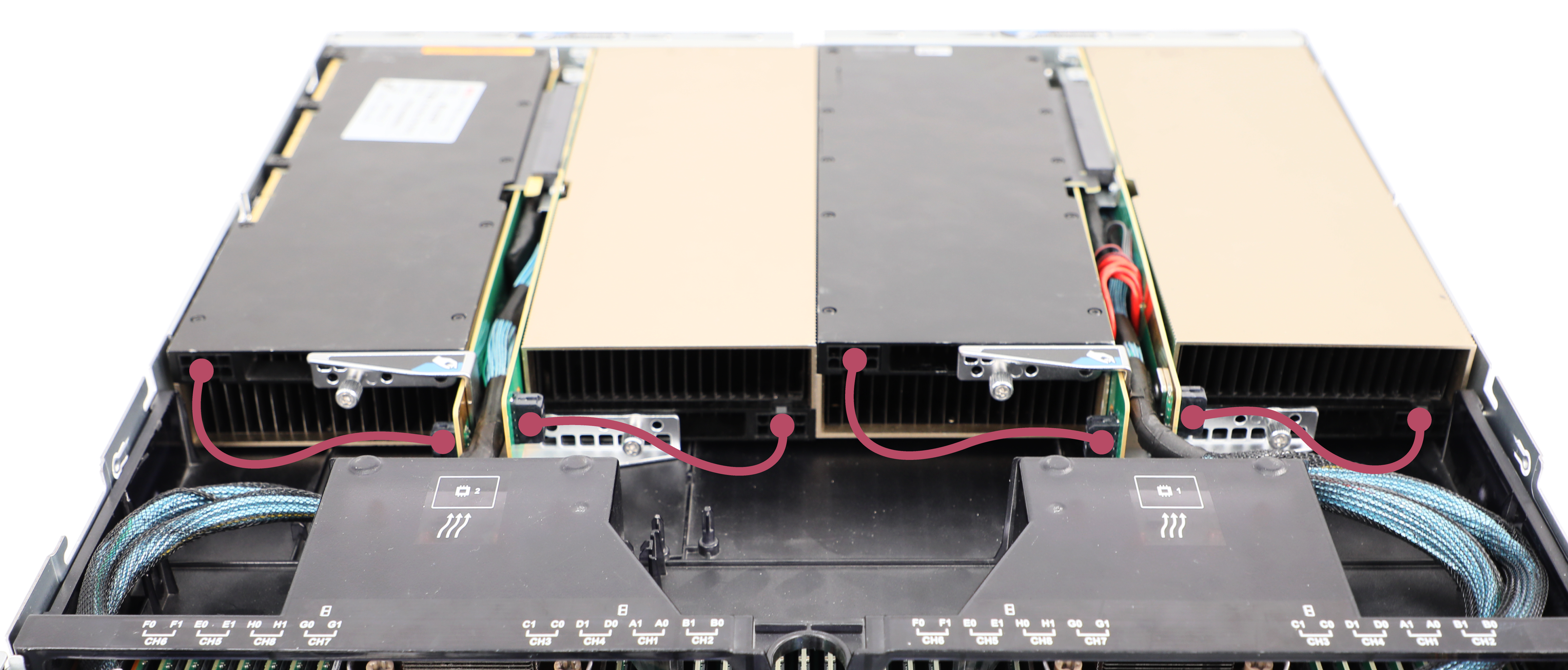

Replacing a GPU module
Guidelines
For information about configuration guides for the power cords of GPU modules, contact Technical Support.
To install FHFL dual-width GPU modules, install them to slots as shown in Table 18, as a best practice, and follow these guidelines:
· Install GPU modules in PCIe slots with x16 bus bandwidth.
· If the number of GPU modules is equal to or smaller than 2, install the GPU modules to riser cards.
· If the number of GPU modules is equal to 4, install the GPU modules to the rear 4GPU module.
To install FHFL single-width GPU, install them to slots as shown in Table 19, as a best practice, and follow these guidelines:
· If the number of GPU modules is equal to or smaller than 3, install one GPU to each riser card.
· If the number of GPU modules is equal to 4, install two RC-3FHFL-2U-G6 riser cards and install two GPU modules to each riser card as a best practice.
To install HHHL single-width GPU, install them to slots as shown in Table 20, as a best practice, and follow these guidelines:
· If the number of GPU modules is equal to or greater than 8, you can install GPU modules to PCIe slots with x8 bus bandwidth.
· In other cases, install GPU modules to PCIe slots with x16 bus bandwidth.
Table 19 FHFL dual-width GPU installation guidelines
Number of GPUs |
Recommended GPU installation locations |
1 |
Slot 5 |
2 |
Slots 2 and 5 |
4 |
Slots 11, 12, 13, and 14 |
Table 20 FHFL single-width GPU installation guidelines
Number of GPUs |
1 |
Slot 5 |
2 |
Slots 2 and 5 |
3 |
Slots 2, 5, and 7 |
4 |
Slots 1, 2, 4, and 5 |
Table 21 HHHL GPU installation guidelines
Number of GPUs |
1 |
Slot 5 |
2 |
Slots 2 and 5 |
3 |
Slots 2, 5, and 7 |
4 |
Slots 2, 3, 5, and 6 |
5 |
Slots 2, 3, 4, 5, and 6 |
6 |
Slots 1, 2, 3, 4, 5, and 6 |
7 |
Slots 1, 2, 3, 4, 5, 6, and 7 |
8 |
Slots 1, 2, 3, 4, 5, 6, 7, and 8 |
9 |
Slots 1, 2, 3, 4, 5, 6, 7, 8, and 9 |
10 |
Slots 1, 2, 3, 4, 5, 6, 7, 8, 9, and 10 |
Take the following ESD prevention measures:
· Wear antistatic clothing.
· Wear an ESD wrist strap and make sure it makes good skin contact and is reliably grounded.
· Do not wear any conductive objects, such as jewelry or watches.
When you replace a component, examine the slot and connector for damages. Make sure the pins are not damaged (bent for example) and do not contain any foreign objects.
Removing a GPU module
1. Power off the server. For more information, see "Powering off the server."
2. Remove the server from the rack. For more information, see "Removing the server from a rack."
3. Remove the access panel:
a. Press the button on the locking lever and then lift the locking lever.
The access panel automatically slides to the server rear.
b. Lift the access panel to remove it from the server.
4. Disconnect all cables that hinder the replacement, if any.
5. Remove the riser card where the GPU module resides. Holding the riser card by the notch and handle, press the unlock button and lift the riser card to remove the riser card out of the chassis.
6. Remove the GPU module from the riser card:
a. Disconnect the cable from the GPU module, if any.
b. Open the retaining latch on the riser card, and pull the GPU module out from the slot.
Replacing the chassis air baffle
Install a chassis air baffle suitable for the GPU module.
Installing a GPU module
1. Install a GPU module on the riser card:
a. Insert the GPU module into the PCIe slot along the guide rails, and then close the retaining latch on the riser card.
b. (Optional.) Connect the GPU module power cord according to the cable label.
2. Reconnect other cables to the riser card.
3. Install the riser card on the server:
a. Insert the riser card into the chassis along the slot.
b. (Optional.) Connect the riser card power cord.
4. Install the access panel:
a. Place the access panel onto the server.
b. Slide the access panel to the server front.
c. Press down the wrench on the access panel until it snaps into place.
5. Rack-mount the server. For more information, see "Rack-mounting the server."
6. Connect the power cord.
7. Power on the server. For more information, see "Powering on the server."

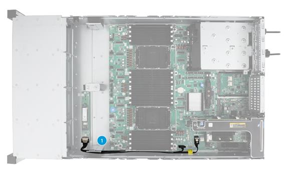

a. (Optional.) Disconnect the supercapacitor extension cable and remove the supercapacitor (if any) from the air baffle.
b. Press the tabs on the air baffle, and then lift the air baffle out of the chassis.
Installing a chassis air baffle
1. Install the chassis air baffle:
a. Place the chassis air baffle in the chassis.
b. (Optional.) Reinstall the supercapacitor on the air baffle.

3. Remove the power cord from the power supply:
a. Press the tab to disengage the ratchet from the tie mount, slide the cable clamp outward, and then release the tab.
b. Open the cable clamp and remove the power cord out of the clamp.
c. Unplug the power cord.

Replacing a rear 4GPU module
· Take the following ESD prevention measures:
¡ Wear antistatic clothing.
¡ Wear an ESD wrist strap and make sure it makes good skin contact and is reliably grounded.
¡ Do not wear any conductive objects, such as jewelry or watches.

Installing a GPU module on the rear 4GPU module
· When you replace a component, examine the slot and connector for damages. Make sure the pins are not damaged (bent for example) and do not contain any foreign objects.
Removing a rear 4GPU module
4. (Optional.) Disconnect all cables that hinder the removal, if any.
5. Remove the rear 4GPU module that is not installed with a GPU module. Lift the rear 4GPU module to remove it out of the chassis.
Installing a rear 4GPU module
1. Use a screwdriver to remove the mounting screw from a 4GPU module blank, and then remove the blank.
2. Install a GPU module on the rear 4GPU module:
a. Insert the GPU module into the PCIe slot along the guide rails.
b. Connect one end of the power cord to the GPU module based on the power cord label.
c. Connect the other end of the power cord to the 4GPU module.
3. (Optional.) Reconnect other cables to the rear 4GPU module.
4. Insert the rear 4GPU module into the chassis along the slot.
5. Install the access panel:
6. Rack-mount the server. For more information, see "Rack-mounting the server."
7. Connect the power cord.
8. Power on the server. For more information, see "Powering on the server."

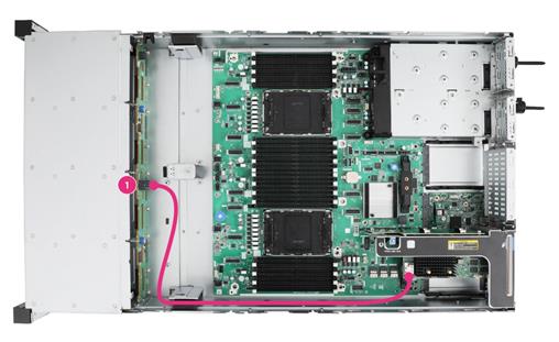

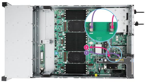

8LFF SAS/SATA drives at the front (connected to an embedded VROC controller)
1. Connect SAS/SATA data cables for the 8LFF drives at the front.
Figure 19 Connecting SAS/SATA data cables for the 8LFF drives at the front
No. |
Cable type |
Cable code |
Description |
1 |
SAS/SATA data cable |
0404A1S2 |
From connector SAS PORT on the front drive backplane to connectors SAS PORT2 and SAS PORT3 on the system board |

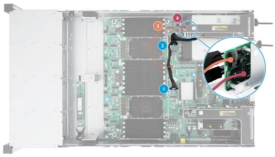

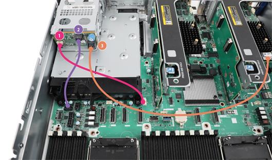

2. Connect an AUX cable and power cord for 8LFF drives at the front.
Figure 20 Connecting an AUX cable and power cord for the 8LFF drives at the front
No. |
Cable type |
Description |
1 |
Power cord |
From connector PWR on the front drive backplane to connector PWR1 on the system board |
1 |
AUX cable |
From connector AUX on the front drive backplane to connector AUX1 on the system board |

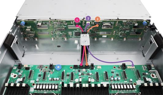

8LFF SAS/SATA drives at the front (connected to a storage controller)

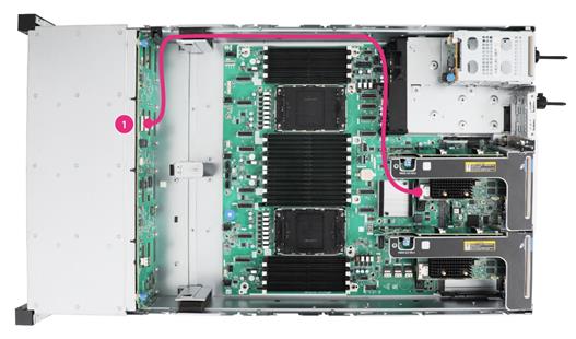

Figure 21 Connecting SAS/SATA data cables for the 8LFF drives at the front
No. |
Cable type |
Cable code |
Description |
1 |
0404A1KT |
From connector SAS PORT on the front drive backplane to connector C0 on the storage controller |
NOTE: To use this cabling scheme, you can install the storage controller in slots 1 to 8. In this example, the storage controller is installed in slot 1. |

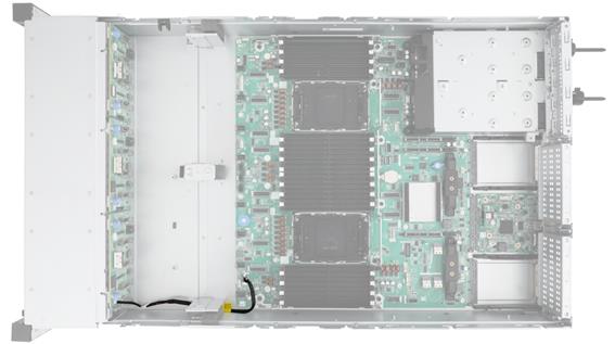

Figure 22 Connecting an AUX cable and power cord for the 8LFF drives at the front
No. |
Cable type |
Description |
1 |
Power cord |
1 |
AUX cable |

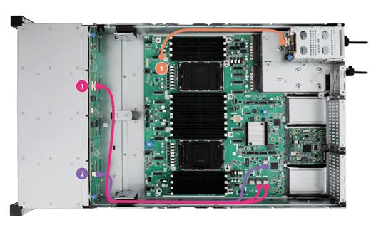

12LFF (4 SAS/SATA + 8 UniBay) drives at the front

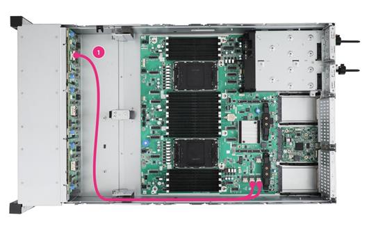

1. Connect an SAS/SATA data cable for the 12LFF drives at the front.
Figure 23 Connecting an SAS/SATA data cable for the 12LFF drives at the front
No. |
Cable type |
Cable code |
Description |
1 |
0404A1QM |
From connector SAS PORT on the front backplane to connector C0 on the storage controller |

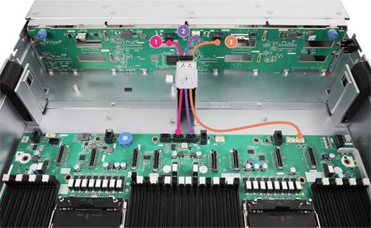

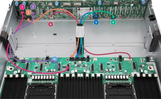

2. Connect power cords, AUX cable, and NVMe cables for 12LFF drives at the front.
Figure 24 Connecting power cords, AUX cable, and NVMe cables for 12LFF drives at the front
No. |
Cable type |
Cable code |
Description |
1 |
NVMe data cable |
0404A1WS |
From connector NVME B1/B2 on the front drive backplane to connector C1-P4A on the system board |
2 |
NVMe data cable |
0404A1WT |
From connector NVME B3/B4 on the front drive backplane to connector C1-P4C on the system board |
3 |
NVMe data cable |
0404A1PY |
From connector NVME A3/A4 on the front drive backplane to connector C1-P3C on the system board |
4 |
NVMe data cable |
0404A1WS |
From connector NVME A1/A2 on the front drive backplane to connector C1-P3A on the system board |
5 |
Power cord |
From connector PWR2 on the front drive backplane to connector PWR2 on the system board |
6 |
Power cord |
From connector PWR1 on the front drive backplane to connector PWR1 on the system board |
7 |
AUX cable |

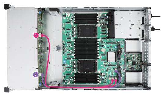

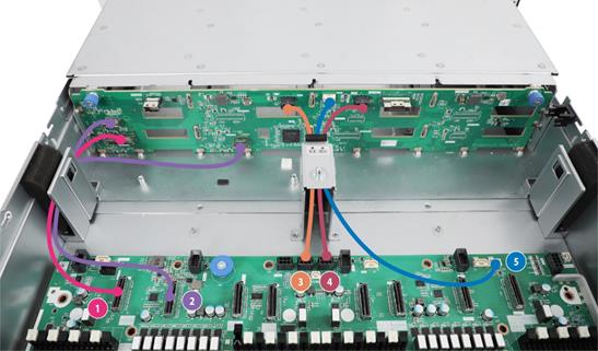

12LFF UniBay drives at the front
1. Connect SAS/SATA data cables for the 12LFF drives at the front.
Figure 25 Connecting SAS/SATA data cables for the 12LFF drives at the front
No. |
Cable type |
Cable code |
Description |
1 |
0404A1RE |
From connector SAS PORT1 on the front backplane to connectors SATA PORT2 and SATA PORT3 on the system board |
2 |
0404A1RF |
From connector SAS PORT2 on the front backplane to connector SATA PORT4 on the system board |

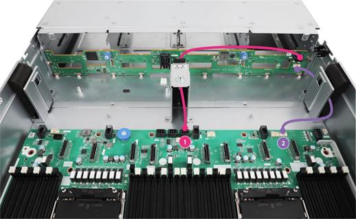

2. Connect power cords and AUX cable for 12LFF drives at the front.
Figure 26 Connecting power cords and AUX cable for 12LFF drives at the front
No. |
Cable type |
Description |
1 |
Power cord |
2 |
AUX cable |
3 |
Power cord |

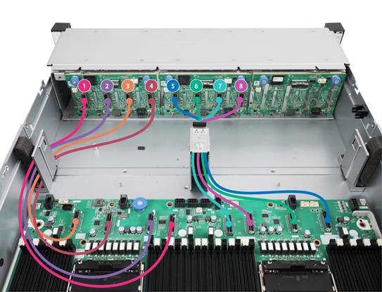

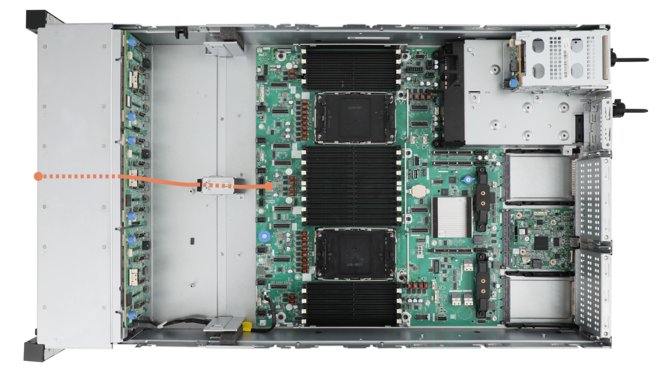

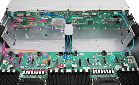

3. Connect NVMe cables for 12LFF drives at the front.
Figure 27 Connecting NVMe cables for 12LFF drives at the front
No. |
Cable type |
Cable code |
Description |
1 |
NVMe data cable |
0404A209 |
From connectors A3 and A4 on the front drive backplane to connector C1-P3C on the system board |
2 |
NVMe data cable |
0404A1WS |
3 |
NVMe data cable |
0404A1WS |
From connector NVMe-B1/B2 on the front drive backplane to connector C1-P4A on the system board |
4 |
NVMe data cable |
0404A1WT |
From connector NVMe-B3/B4 on the front drive backplane to connector C1-P4C on the system board |
5 |
NVMe data cable |
0404A207 |
From connectors C1 and C2 on the front drive backplane to connector C2-P4A on the system board |
6 |
NVMe data cable |
0404A1WS |
From connector NVME C3/C4 on the front drive backplane to connector C2-P4C on the system board |

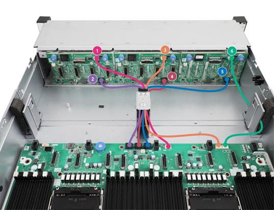

25SFF (17 SAS/SATA + 8UniBay) drives at the front
1. Connect SAS/SATA data cables for the 25SFF drives at the front.
Figure 28 Connecting SAS/SATA data cables for the 25SFF drives at the front
No. |
Cable type |
Cable code |
Description |
1 |
0404A1QM |
From connector SAS PORT1 on the front backplane to connector C0 on the storage controller |
2. Connect NVMe data cables, power cords, and AUX cable for 25SFF drives at the front.
Figure 29 Connecting NVMe data cables, power cords, and AUX cable for 25SFF drives at the front
No. |
Cable type |
Cable code |
Description |
1 |
NVMe data cable |
0404A1PY |
From connector NVME 1 on the front drive backplane to connector C1-P3A on the system board |
2 |
NVMe data cable |
0404A1PY |
From connector NVME 2 on the front drive backplane to connector C1-P3C on the system board |
3 |
Power cord |
From connector PWR3 on the front drive backplane to connector PWR3 on the system board |
4 |
AUX cable |
5 |
Power cord |
6 |
Power cord |
8SFF SAS/SATA+8SFF UniBay+8SFF UniBay drives at the front
1. Connect SAS/SATA data cables for 8SFF drives at the front.
Figure 30 Connect SAS/SATA data cables for 8SFF drives at the front
No. |
Cable type |
Cable code |
Description |
1 |
0404A1RD |
From connector SAS PORT on the drive backplane in front bay 1 to connectors SAS PORT2 and SAS PORT3 on the system board |
2. Connect power cords, AUX cables, and SAS/SATA cables for 8SFF drives at the front.
Figure 31 Connecting power cords, AUX cables, and SAS/SATA cables for 8SFF drives at the front
No. |
Cable type |
Description |
1 |
AUX cable |
From connector AUX on the drive backplane in front bay 3 to connector AUX3 on the system board |
2 |
Power cord |
From connector PWR on the drive backplane in front bay 3 to connector PWR3 on the system board |
3 |
AUX cable |
From connector AUX on the drive backplane in front bay 2 to connector AUX2 on the system board |
4 |
Power cord |
From connector PWR on the drive backplane in front bay 2 to connector PWR2 on the system board |
5 |
Power cord |
From connector PWR on the drive backplane in front bay 1 to connector PWR1 on the system board |
6 |
AUX cable |
From connector AUX on the drive backplane in front bay 1 to connector AUX1 on the system board |

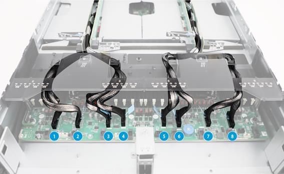

3. Connect NVMe data cables for 8SFF drives at the front.
Figure 32 Connecting NVMe data cables for 8SFF drives at the front
No. |
Cable type |
Cable code |
Description |
1 |
NVME data cable |
0404A1Q2 |
From connector NVME A1/A2 on the drive backplane in front bay 3 to connector C1-P3A on the system board |
2 |
NVME data cable |
0404A1PY |
From connector NVME A3/A4on the drive backplane in front bay 3 to connector C1-P3C on the system board |
3 |
NVME data cable |
0404A1PY |
From connector NVMEB1/B2 on the drive backplane in front bay 3 to connector C1-P4A on the system board |
4 |
NVME data cable |
0404A1PY |
From connector NVME B3/B4 on the drive backplane in front bay 3 to connector C1-P4C on the system board |
5 |
NVME data cable |
0404A1WT |
From connector NVME A1/A2 on the drive backplane in front bay 2 to connector C2-P3A on the system board |
6 |
NVME data cable |
0404A1WT |
From connector NVME A3/A4 on the drive backplane in front bay 2 to connector C2-P3C on the system board |
7 |
NVME data cable |
0404A1WT |
From connector NVME B1/B2 on the drive backplane in front bay 2 to connector C2-P4A on the system board |
8 |
NVME data cable |
0404A1WT |
From connector NVME B3/B4 on the drive backplane in front bay 2 to connector C2-P4C on the system board |
12LFF SAS/SATA drives at the front + 2SFF Unibay drives at the rear
1. Connect SAS/SATA data cables for the 12LFF drives at the front and NVMe data cables for 2SFF drives at the rear.
Figure 33 Connecting SAS/SATA data cables for the 12LFF drives at the front and NVMe data cables for 2SFF drives at the rear
No. |
Cable type |
Cable code |
Description |
1 |
0404A1RE |
From connector SAS PORT1 on the front drive backplane to connectors SATA PORT2 and SATA PORT3 on the system board |
2 |
0404A1RF |
From connector SAS PORT2 on the front drive backplane to connector SATA PORT4 on the system board |
3 |
NVMe data cable |
0404A1Q3 |
From connector NVMe on the front drive backplane to connector C2-P3A on the system board |
2. Connect an AUX cable and power cords for the 12LFF drives at the front.
Figure 34 Connecting an AUX cable and power cords for the 12LFF drives at the front
No. |
Cable type |
Description |
1 |
Power cord |
2 |
AUX cable |
3 |
Power cord |
3. Connect an AUX cable and power cord for the 2SFF drives at the rear.
Figure 35 Connecting an AUX cable and power cord for the 2SFF drives at the rear
No. |
Cable type |
Description |
1 |
AUX cable |
From connector AUX on the rear drive backplane to connector AUX5 on the system board |
2 |
Power cord |
From connector PWR on the rear drive backplane to connector PWR4 on the system board |
12LFF (8 SAS/SATA + 4 UniBay) drives at the front + 2SFF SAS/SATA drives at the rear
1. Connect an SAS/SATA cable for 12LFF drives at the front.
Figure 36 Connecting an SAS/SATA cable for 12LFF drives at the front
No. |
Cable type |
Cable code |
Description |
2 |
0404A1QM |
From connector SAS PORT1 on the front drive backplane to connector C0 on the storage controller |
NOTE: To use this cabling scheme, you can install the storage controller in slots 4 to 6. In this example, the storage controller is installed in slot 4. |
Figure 37 Connecting power cords, AUX cable, and NVMe cables for 12LFF drives at the front
No. |
Cable type |
Cable code |
Description |
1 |
NVMe data cable |
0404A209 |
From connectors NVME A3 and NVME A4 on the front drive backplane to connector C1-P4C on the system board |
2 |
NVMe data cable |
0404A1WS |
From connector NVME A1/A2 on the front drive backplane to connector C1-P4A on the system board |
3 |
Power cord |
4 |
Power cord |
5 |
AUX cable |

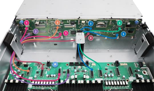

3. Connect an AUX cable, power cord, and SATA data cable for the 2SFF drives at the rear.
Figure 38 Connecting an AUX cable, power cord, and SATA data cable for the 2SFF drives at the rear
No. |
Cable type |
Cable code |
Description |
1 |
AUX cable |
2 |
Power cord |
3 |
0404A1RU |
From connector SAS PORT on the rear drive backplane to connector C0 on the storage controller |
NOTE: To use this cabling scheme, you can install the storage controller in slots 1 to 3. In this example, the storage controller is installed in slot 1. |

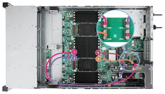

Connecting cables for the rear 4GPU module
Figure 39 Connecting data cables for the rear 4GPU module
No. |
Cable type |
Cable code |
Description |
1 |
PCIe data cable |
0404A1Y8 |
From rear GPU module S3 in slot 14 to connector C2-P3A on the system board |
2 |
PCIe data cable |
0404A1Y8 |
From rear GPU module S4 in slot 14 to connector C2-P3C on the system board |
3 |
PCIe data cable |
0404A1Y8 |
From rear GPU module S2 in slot 13 to connector C2-P4C on the system board |
4 |
PCIe data cable |
0404A1Y8 |
From rear GPU module S1 in slot 13 to connector C2-P4A on the system board |
5 |
PCIe data cable |
0404A1Y9 |
From rear GPU module S3 in slot 12 to connector C1-P3A on the system board |
6 |
PCIe data cable |
0404A1Y9 |
From rear GPU module S4 in slot 12 to connector C1-P3C on the system board |
7 |
PCIe data cable |
0404A1Y9 |
From rear GPU module S2 in slot 11 to connector C1-P4C on the system board |
8 |
PCIe data cable |
0404A1Y9 |
From GPU module S1 in slot 11 to connector C1-P4A on the system board |
