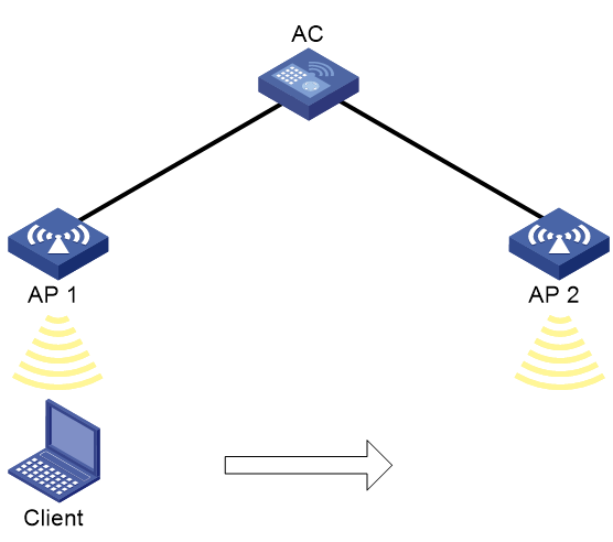

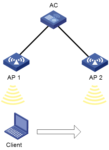

WLAN roaming enables clients to seamlessly roam among wireless services in the same ESS while retaining their IP address and authorization information during the roaming process.
WLAN roaming mechanism
As shown in Figure 1, the client roams from AP 1 to AP 2 as follows:
1. The client comes online from AP 1, and the AC creates a roaming entry for the client.
The entry records the initial SSID at association, PMKID, authentication method, security mode, and roaming VLAN.
2. The client roams to AP 2. The AC examines the roaming entry.
3. The client performs reauthentication and then comes online from AP 2.
Figure 1 WLAN roaming mechanism

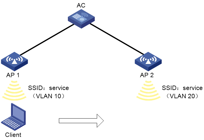

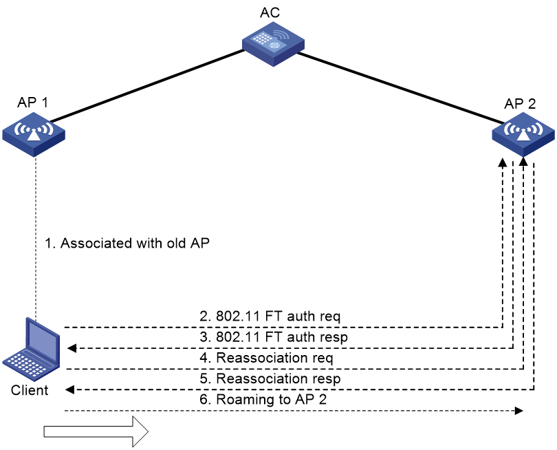

Layer 3 roaming
As shown in Figure 2, the client can roam between APs in different VLANs without special configuration. For the roaming procedure, see "WLAN roaming mechanism."

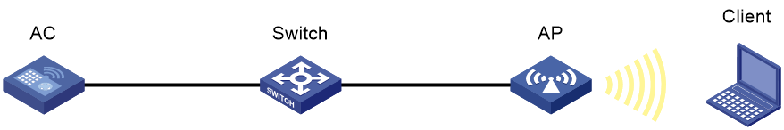

Example: Configuring intra-AC roaming
As shown in Figure 3, configure intra-AC roaming to enable the client to roam from AP 1 to AP 2. The two APs are managed by the same AC.

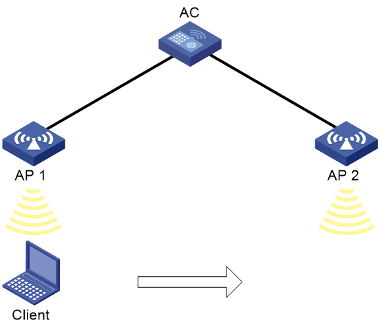

802.1X fast roaming
802.1X fast roaming mechanism
Intra-AC roaming

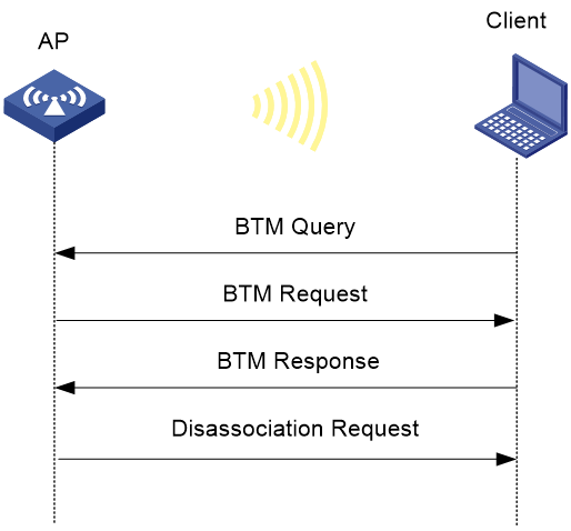

As shown in Figure 4, 802.1X fast roaming operates as follows:
1. The client comes online from AP 1 after passing RSN+802.1X authentication. AP 1 creates a roaming entry for the client.
For more information about 802.1X authentication, see "Configuring WLAN security."
2. The client roams to AP 2. The AP examines the roaming entry for the client and triggers 802.1X fast forwarding if the client carries the same PMKID as the AP.
The system uses the cached PMK to perform key negotiation and the client can associate with AP 2 without reauthentication.
NOTE: The system supports using the following methods to cache PMKID: · Sticky Key Caching (SKC)—Directly caches the PMKIDs generated during 802.1X authentication of clients. · Opportunistic Key Caching (OKC)—Uses the currently associated BSSID, client MAC address, and cached PMK to generate a PMKID. Both methods support 802.1X fast roaming without manual intervention. |
Figure 4 802.1X fast roaming (intra-AC)

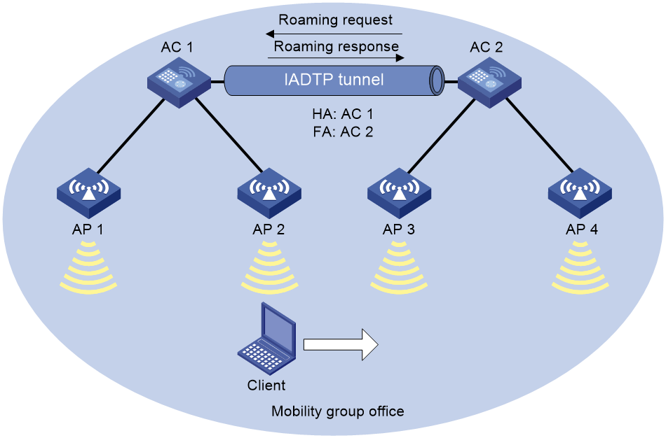

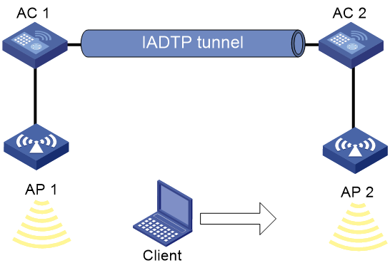

Inter-AC roaming
As shown in Figure 5, inter-AC 802.1X fast roaming operates as follows:
1. AC 1 and AC 2 form a mobility group. The client comes online from AP 1 after passing 802.1X authentication. AC 1 creates a roaming entry for the client.
For more information about 802.1X authentication, see User Access and Authentication Configuration Guide.
2. AC 1 synchronizes the roaming entry to AC 2 through the IADTP tunnel.
3. The client roams to AP 2. AC 2 examines the roaming entry for the client. If the client authentication method is RSN+802.1X and the PMKID carried in the client packet is the same as the PMKID cached on AC 2, AC 2 considers that the client has passed authentication.
The system uses the cached PMK to perform key negotiation and the client can associate with AC 2 without reauthentication.
Figure 5 802.1X fast roaming (inter-AC)

2. The client roams to AP 2. AP 2 examines the roaming entry for the client and triggers MAC authentication if fast-connect is enabled.
The client comes online from AP 2 without being reauthenticated.
Figure 6 MAC fast roaming
Restrictions and guidelines: MAC fast forwarding
802.1X fast roaming supports only roaming between APs managed by the same AC.

802.11r
About 802.11r
802.11r fast BSS transition (FT) minimizes the delay when a client roams from a BSS to another BSS within the same ESS. During 802.11r FT, a client needs to exchange messages with the target AP.
FT supports over-the-air message exchanging method, allowing clients to communicate directly with the target AP for pre-roaming authentication.
Over-the-air FT
As shown in Figure 7, the client is associated with AP 1. Intra-AC roaming through over-the-air FT uses the following process:
1. The client sends an FT authentication request to AP 2.
2. AP 2 sends an FT authentication response to the client.
3. The client sends a reassociation request to AP 2.
4. AP 2 sends a reassociation response to the client.
5. The client roams to AP 2.

Example: Configuring over-the-air FT and PSK authentication
As shown in Figure 8, configure intra-AC roaming through over-the-air FT to enable the client to roam between AP 1 and AP 2. Configure PSK as the authentication and key management mode.
# Create service template acstname.
<AC> system-view
[AC] wlan service-template acstname
# Set the SSID to service.
[AC-wlan-st-acstname] ssid service
# Set the authentication and key management mode to PSK, and configure simple string 12345678 as the PSK.
[AC-wlan-st-acstname] akm mode psk
[AC-wlan-st-acstname] preshared-key pass-phrase simple 12345678
# Enable the RSN IE in the beacon and probe responses.
[AC-wlan-st-acstname] cipher-suite ccmp
[AC-wlan-st-acstname] security-ie rsn
# Enable FT.
[AC-wlan-st-acstname] ft enable
# Set the reassociation timeout timer to 50 seconds.
[AC-wlan-st-acstname] ft reassociation-timeout 50
# Enable the service template.
[AC-wlan-st-acstname] service-template enable
[AC-wlan-st-acstname] quit
# Create AP 1, and bind service template acstname to radio 1 of the AP.
[AC] wlan ap 1 model WA6320
[AC-wlan-ap-1] serial-id 219801A28N819CE0002T
[AC-wlan-ap-1] radio 1
[AC-wlan-ap-1-radio-1] service-template acstname
[AC-wlan-ap-1-radio-1] radio enable
[AC-wlan-ap-1-radio-1] quit
[AC-wlan-ap-1] quit
# Create AP 2, and bind service template acstname to radio 1 of the AP.
[AC] wlan ap 2 model WA6320
[AC-wlan-ap-2] serial-id 219801A28N819CE0003T
[AC-wlan-ap-2] radio 1
[AC-wlan-ap-2-radio-1] service-template acstname
[AC-wlan-ap-2-radio-1] radio enable
[AC-wlan-ap-2-radio-1] quit
[AC-wlan-ap-2] quit
# Verify the following information:
· RSN IE is enabled.
· The AKM mode is PSK.
· The cipher suite is CCMP.
· The FT status is Active.

802.11v defines BSS transition management (BTM), which enables clients to roam to the optimal AP if the signal strength of the current AP is low or if a better AP is discovered.
As shown in Figure 9, BTM operates as follows:
1. If the RSSI of the currently associated AP is too low or the client discovered a better AP, the client sends a BTM query to the associated AP. Upon receiving the query, the AP responds with a BTM request.
A BTM request contains information about recommended BSSs.
2. Upon receiving the BTM request, the client determines whether to disconnect from the current AP and roam to a recommended AP.
3. If the client determines to perform a roaming, it sends a BTM response to the AP. If the client fails to leave the current BSS before the disassociation timer expires, the AP sends a disassociation request to the client and logs off the client.
Restrictions and guidelines: 802.11v configuration
802.11v supports only intra-AC roaming in the current software version.

Example: Configuring 802.11v
As shown in Figure 10, configure 802.11v for the AP to guide the client to an optimal AP.
# Create service template service.
<AC> system-view
[AC] wlan service-template service
[AC-wlan-st-service] ssid service
# Enable BTM.
[AC-wlan-st-service] bss transition-management enable
# Specify the BTM disassociation timeout as 45 seconds.
[AC-wlan-st-service] bss transition-management disassociation recommended timer 45
[AC-wlan-st-service] service-template enable
[AC-wlan-st-service] quit
# Create AP ap1, specify the AP model and serial ID, enable the AP to obtain BSS candidate information, and bind service template service to radio 1 of AP ap1.
[AC] wlan ap ap1 model WA6320
[AC-wlan-ap-ap1] serial-id 219801A28N819CE0002T
[AC-wlan-ap-ap1] radio 1
[AC-wlan-ap-ap1-radio-1] sacp roam-optimize bss-candidate-list enable
[AC-wlan-ap-ap1-radio-1] service-template service
[AC-wlan-ap-ap1-radio-1] radio enable
[AC-wlan-ap-ap1-radio-1] quit
[AC-wlan-ap-ap1] quit
# Verify that BTM has been enabled.
[AC] display wlan service-template service verbose
Service template name : service
Description : Not configured
SSID : service
SSID-hide : Disabled
User-isolation : Disabled
Service template status : Disabled
Maximum clients per BSS : Not configured
Frame format : Dot3
Seamless roam status : Disabled
Seamless roam RSSI threshold : 50
Seamless roam RSSI gap : 20
VLAN ID : 1
AKM mode : Not configured
Security IE : Not configured
Cipher suite : Not configured
TKIP countermeasure time : 0 sec
PTK lifetime : 43200 sec
PTK rekey : Enabled
GTK rekey : Enabled
GTK rekey method : Time-based
GTK rekey time : 86400 sec
GTK rekey client-offline : Disabled
WPA3 status : Disabled
PPSK : Disabled
PPSK Fail Permit : Enabled
User authentication mode : Bypass
Intrusion protection : Disabled
Intrusion protection mode : Temporary-block
Temporary block time : 180 sec
Temporary service stop time : 20 sec
Fail VLAN ID : Not configured
802.1X handshake : Disabled
802.1X handshake secure : Disabled
802.1X domain : Not configured
MAC-auth domain : Not configured
Max 802.1X users per BSS : 512
Max MAC-auth users per BSS : 512
802.1X re-authenticate : Disabled
Authorization fail mode : Online
Accounting fail mode : Online
Authorization : Permitted
Key derivation : SHA1
PMF status : Disabled
Hotspot policy number : Not configured
Forwarding policy status : Disabled
Forwarding policy name : Not configured
Forwarder : AC
FT status : Disabled
QoS trust : Port
QoS priority : 0
BTM status : Enabled
# Verify that the client has come online.
<AC> display wlan client
Total number of clients: 3
MAC address Username AP name R IP address VLAN
4581-61ac-885a N/A ap1 1 192.168.66.230 1
# Verify that the client has been logged off 45 seconds after the AP recommends an optimal AP for the client. (Details not shown.)
Cooperative roaming
About cooperative roaming
Cooperative roaming is defined by H3C to provide AP- and wireless client-guided roaming of wireless clients in an ESS by using IEEE802.11k, IEEE802.11r, and IEEE802.11v.
· 802.11k defines Beacon radio measurement, allowing monitoring of channel quality and resource performance on both 2.4 GHz and 5 GHz channels.
· 802.11r defines Fast BSS Transition (FT) to shorten transmission delay during client roaming, reducing disconnection rate and improving the roaming service quality.
· 802.11v defines BSS Transition Management (BTM) to guide 802.11v clients to the optimal AP, improving the access service quality.
Cooperative roaming also supports using APs to monitor 802.11v client signal strength and can proactively guide clients to better services.
Restrictions and guidelines: Cooperative roaming configuration
Cooperative roaming supports only intra-AC roaming in the current software version.
To use cooperative roaming, make sure the APs support Wi-Fi 6.

Mobility group mechanism
A mobility group enables clients to roam among APs that are managed by different ACs. These ACs must be in the same mobility group and have established an IADTP tunnel with each other.
Figure 11 Mobility group mechanism
As shown in Figure 11, inter-AC roaming uses the following procedure:
1. The client comes online from AP 2. AC 1 creates a roaming entry for the client and sends the information to AC 2 through the IADTP tunnel.
2. The client roams to AP 3. AC 2 examines the roaming entry for the client and determines whether to perform fast roaming.
If the client uses RSN + 802.1X authentication and carries the same PMKID as the AC, fast roaming is used, and the client can associate with AP 3 without reauthentication If it is not, the client must be reauthenticated before associating with AP 3.
3. The client associates with AP 3. AC 2 sends a roaming request to AC 1.
4. AC 1 verifies the roaming request and performs either of the following operations:
¡ Sends a roaming response that indicates roaming failure to AC 2 if the request is invalid. AC 2 logs off the client.
¡ Saves the roaming trace and roam-out information and sends a roaming response that indicates roaming success to AC 2 if the request is valid. AC 2 saves roaming-in information for the client.

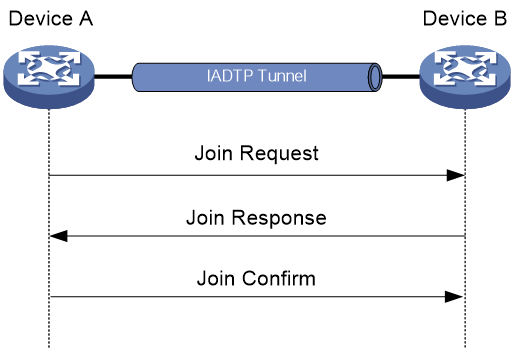

IADTP tunnel establishment
A device in a mobility group can act as a client to initiate connection requests or act as a server to listen for and respond to the connection requests.
Figure 12 Establishing an IADTP tunnel
As shown in Figure 12, two devices establish an IADTP tunnel by using the following procedure:
1. Device A sends a join request to Device B.
2. Upon receiving the join request, Device B uses the local configuration and packet content to identify whether Device A is in the same mobility group.
¡ If they are in the same mobility group, Device B returns a join response with a result code representing success.
¡ If they are in different mobility groups, Device B returns a join response with a result code representing failure.
3. Upon receiving the join response, Device A examines the result code in the response.
¡ If the result code represents failure, Device A does not return any packets.
¡ If the result code represents success, Device A sends a join confirm to Device B.
4. Upon receiving the join confirm, Device B establishes an IADTP tunnel with Device A.

As shown in Figure 13, configure a mobility group to enable the client to roam from AP 2 to AP 3 that are managed by different ACs.
1. Configure AC 1:
# Create a service template named service, set the SSID to office, and enable the service template.
[AC1] wlan service-template service
[AC1-wlan-st-test] ssid office
[AC1-wlan-st-test] service-template enable
[AC1-wlan-st-test] quit
# Create a manual AP named ap1, and specify the AP model and serial ID.
[AC1] wlan ap ap1 model WA6320
[AC1-wlan-ap-ap1] serial-id 219801A28N819CE0002T
# Bind the service template to radio 1 of AP 1.
[AC1-wlan-ap-ap1] radio 1
[AC1-wlan-ap-ap1-radio-1] radio enable
[AC1-wlan-ap-ap1-radio-1] service-template service
[AC1-wlan-ap-ap1-radio-1] quit
[AC1-wlan-ap-ap1] quit
# Create a manual AP named ap2, and specify the AP model and serial ID.
[AC1] wlan ap ap2 model WA6320
[AC1-wlan-ap-ap2] serial-id 219801A28N819CE0003T
# Bind the service template to radio 1 of AP 2.
[AC1-wlan-ap-ap2-radio-1] radio enable
[AC1-wlan-ap-ap2-radio-1] service-template service
[AC1-wlan-ap-ap2-radio-1] quit
[AC1-wlan-ap-ap2] quit
# Create a mobility group named office.
[AC1] wlan mobility group office
# Specify the IP address type for IADTP tunnels as IPv4.
[AC1-wlan-mg-office] tunnel-type ipv4
# Specify the source IP address for establishing IADTP tunnels as 10.1.4.22.
[AC1-wlan-mg-office] source ip 10.1.4.22
# Add AC 2 to the mobility group.
[AC1-wlan-mg-office] member ip 10.1.4.23
# Enable the mobility group.
[AC1-wlan-mg-office] group enable
[AC1-wlan-mg-office] quit
2. Configure AC 2:
# Create a service template named service, specify the SSID as office, and enable the service template.
[AC2] wlan service-template service
[AC2-wlan-st-service] ssid office
[AC2-wlan-st-service] service-template enable
[AC2-wlan-st-service] quit
# Create a manual AP named ap3, and specify the AP model and serial ID.
[AC2] wlan ap ap3 model WA6320
[AC2-wlan-ap-ap3] serial-id 219801A28N819CE0004T
# Bind the service template to radio 1 of AP 3.
[AC2-wlan-ap-ap3-radio-1] radio enable
[AC2-wlan-ap-ap3-radio-1] service-template service
[AC2-wlan-ap-ap3-radio-1] quit
[AC2-wlan-ap-ap3] quit
# Create a manual AP named ap4, and specify the AP model and serial ID.
[AC2] wlan ap ap4 model WA6320
[AC2-wlan-ap-ap4] serial-id 219801A28N819CE0005T
# Bind the service template to radio 1 of AP 4.
[AC2-wlan-ap-ap4] radio 1
[AC2-wlan-ap-ap4-radio-1] radio enable
[AC2-wlan-ap-ap4-radio-1] service-template service
[AC2-wlan-ap-ap4-radio-1] quit
[AC2-wlan-ap-ap4] quit
[AC2] wlan mobility group office
[AC2-wlan-mg-office] tunnel-type ipv4
# Specify the source IP address for establishing IADTP tunnels as 10.1.4.23.
[AC2-wlan-mg-office] source ip 10.1.4.23
[AC2-wlan-mg-office] member ip 10.1.4.22
[AC2-wlan-mg-office] group enable
[AC2-wlan-mg-office] quit
# Verify that a mobility group has been created on AC 1.
[AC1] display wlan mobility group
Mobility group name: office
Tunnel type: IPv4
Source IPv4: 10.1.4.22
Source IPv6: Not configured
Authentication method: Not configured
Mobility group status: Enabled
Member entries: 1
IP address State Online time
10.1.4.23 Up 00hr 00min 12sec
# Verify that a mobility group has been created on AC 2.
[AC2] display wlan mobility group
Tunnel type: IPv4
Source IPv4: 10.1.4.23
Member entries: 1
10.1.4.22 Up 00hr 00min 05sec
# Get the client online on AP 2 and then make the client roam to AP 3. (Details not shown.)
# Display client roaming information on AC 1 to verify that the client came online from AP 2 and roamed to AP 3.
[AC1] display wlan mobility roam-track mac-address 9cd3-6d9e-6778
Total entries: 2
BSSID Created at Online time AC IP address RID AP name
000f-e203-8889 2016-06-14 11:12:28 00hr 06min 56sec 10.1.4.23 1 ap3
000f-e203-7777 2016-06-14 11:11:28 00hr 03min 30sec 127.0.0.1 1 ap2
# On AC 1, verify that the client has roamed to AC 2.
<AC1> display wlan mobility roam-out
Total entries: 1
MAC address BSSID VLAN ID Online time FA IP address
9cd3-6d9e-6778 000f-e203-8889 1 00hr 01min 59sec 10.1.4.23
# On AC 2, verify that the client has associated with AP 3, and the roaming status is Inter-AC roam.
<AC2> display wlan client verbose
Total number of clients: 1
MAC address : 9cd3-6d9e-6778
IPv4 address : 10.1.1.114
IPv6 address : N/A
Username : N/A
AID : 1
AP ID : 3
AP name : ap3
Radio ID : 1
Channel : 36
SSID : 1
BSSID : 000f-e203-8889
VLAN ID : 1
Sleep count : 242
Wireless mode : 802.11ac
Channel bandwidth : 80MHz
SM power save : Enabled
SM power save mode : Dynamic
Short GI for 20MHz : Supported
Short GI for 40MHz : Supported
Short GI for 80MHz : Supported
Short GI for 160/80+80MHz : Not supported
STBC RX capability : Not supported
STBC TX capability : Not supported
LDPC RX capability : Not supported
SU beamformee capability : Not supported
MU beamformee capability : Not supported
Beamformee STS capability : N/A
Block Ack : TID 0 In
Supported VHT-MCS set : NSS1 0, 1, 2, 3, 4, 5, 6, 7, 8
NSS2 0, 1, 2, 3, 4, 5, 6, 7, 8
Supported HT MCS set : 0, 1, 2, 3, 4, 5, 6, 7,
8, 9, 10, 11, 12, 13, 14,
15, 16, 17, 18, 19, 20,
21, 22, 23
Supported rates : 6, 9, 12, 18, 24, 36,
48, 54 Mbps
QoS mode : WMM
Listen interval : 10
RSSI : 62
Rx/Tx rate : 130/11
Authentication method : Open system
Security mode : PRE-RSNA
Cipher suite : N/A
Authorization ACL ID : 3001(Not effective)
Authorization user profile : N/A
Authorization CAR : N/A
Roam status : Inter-AC roam
PMF status : Enabled
Forward policy name : Not configured
Online time : 0days 0hours 5minutes 13seconds
FT status : Inactive
# Verify that the client has roamed from AC 1 to AC 2.
<AC2> display wlan mobility roam-in
Total entries: 1
MAC address BSSID VLAN ID HA IP address
9cd3-6d9e-6778 000f-e203-8889 1 10.1.4.22
