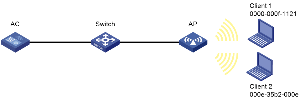

WLAN access process
A wireless client can access a WLAN only when it completes the scanning, link layer authentication, association, and WLAN authentication processes.

Figure 1 WLAN access process

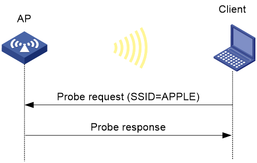

A wireless client periodically scans surrounding wireless networks by sending probe requests. It obtains network information from received probe responses. Based on whether a probe request carries an SSID, active scanning can be divided into the following types:
·     Active scanning of all wireless networks.

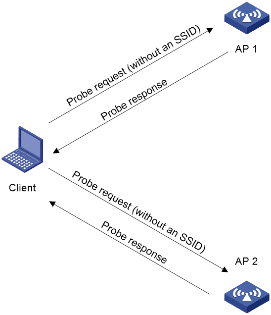

As shown in Figure 2, the client periodically sends a probe request on each of its supported channels to scan wireless networks. APs that receive the probe request send a probe response that carries the available wireless network information. The client associates with the optimal AP.
Figure 2 Scanning all wireless networks

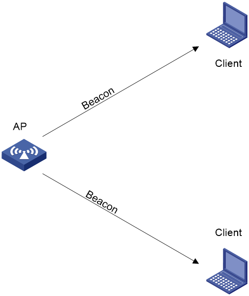

·     Active scanning of a specific wireless network.
As shown in Figure 3, the client periodically sends a probe request carrying the specified SSID or the SSID of the wireless network it has been associated with. When an AP that can provide wireless services with the specified SSID receives the probe request, it sends a probe response.
Figure 3 Scanning a specific wireless network

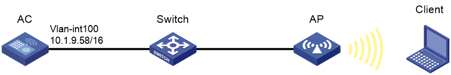

Passive scanning
As shown in Figure 4, the clients periodically listen for beacon frames sent by APs on their supported channels to get information about surrounding wireless networks. Then the clients select an AP for association. Passive scanning is used when clients want to save power.
Figure 4 Passive scanning

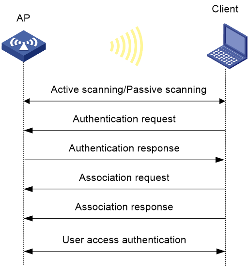

AP group-based access control

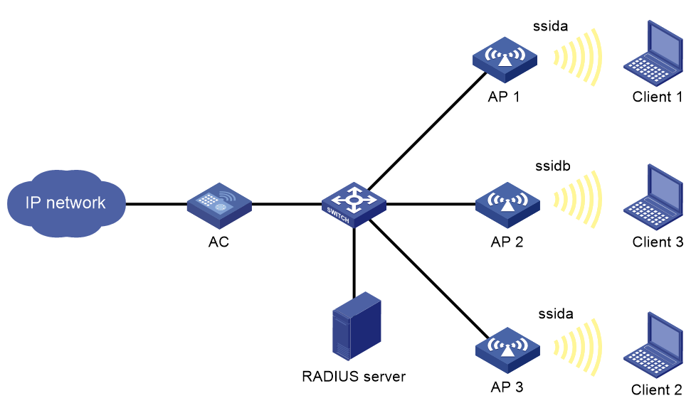

As shown in Figure 5, for AP group-based access control, configure AP group 1 as the permitted AP group for Client 1 and Client 2, and configure AP group 2 as the permitted AP group for Client 3.
When a client passes authentication, the server sends the related user profile to the AC. The AC examines whether the AP with which the client associates is in the permitted AP group. If it is, the client is allowed to access the WLAN. If it is not, the AC logs off the client.
Figure 5 AP group-based access control

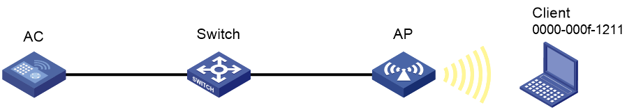

SSID-based access control

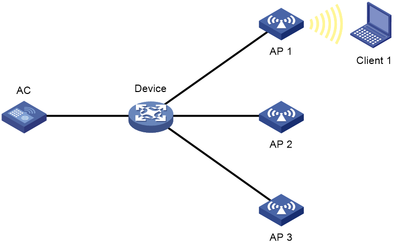

As shown in Figure 6, for SSID-based access control, configure ssida as the permitted SSID for Client 1 and Client 2, and configure ssidb as the permitted SSID for Client 3.
When a client passes authentication, the server sends the related user profile to the AC. The AC examines whether the associated SSID of the client is the permitted SSID. If it is, the client is allowed to access the WLAN. If it is not, the AC logs off the client.
Figure 6 SSID-based access control

WLAN access configuration examples
Example: Configuring WLAN access
As shown in Figure 8, the switch acts as the DHCP server to assign IP addresses to the AP and the client. The AP provides wireless services with the SSID trade-off.
Figure 8 Network diagram
1.     Create VLAN 100, and assign an IP address to VLAN-interface 100.
<AC> system-view
[AC] vlan 100
[AC-vlan100]quit
[AC] interface vlan-interface 100
[AC-Vlan-interface100] ip address 10.1.9.58 16
2.     Create the manual AP ap1, and specify the AP model and serial ID.
[AC] wlan ap ap1 model WA6320
[AC-wlan-ap-ap1] serial-id 219801A28N819CE0002T
3.     Configure a service template and bind it to the AP radio:
# Create the service template service1, set the SSID to trade-off, assign clients coming online through the service template to VLAN 100, and enable the service template.
<AC> system-view
[AC] wlan service-template service1
[AC-wlan-st-service1] ssid trade-off
[AC-wlan-st-service1] vlan 100
[AC-wlan-st-service1] service-template enable
[AC-wlan-st-service1] quit
# Bind the service template service1 to radio 1.
[AC] wlan ap ap1
[AC-wlan-ap-ap1] radio 1
[AC-wlan-ap-ap1-radio-1] radio enable
[AC-wlan-ap-ap1-radio-1] service-template service1
# Verify that the SSID is trade-off, and the service template is enabled.
[AC] display wlan service-template verbose
Service template name          : service1
Description                    : Not configured
SSID                           : trade-off
SSID-hide                      : Disabled
User-isolation                 : Disabled
Service template status        : Enabled
Maximum clients per BSS        : 64
Frame format                   : Dot3
Seamless roam status           : Disabled
Seamless roam RSSI threshold   : 50
Seamless roam RSSI gap         : 20
VLAN ID                        : 100
AKM mode                       : Not configured
Security IE                    : Not configured
Cipher suite                   : Not configured
TKIP countermeasure time       : 0 sec
PTK life time                  : 43200 sec
PTK rekey                      : Enabled
GTK rekey                      : Enabled
GTK rekey method               : Time-based
GTK rekey time                 : 86400 sec
GTK rekey client-offline       : Disabled
WPA3 status                    : Disabled
User authentication mode       : Bypass
Intrusion protection           : Disabled
Intrusion protection mode      : Temporary-block
Temporary block time           : 180 sec
Temporary service stop time    : 20 sec
Fail VLAN ID                   : 1
Critical VLAN ID               : Not configured
802.1X handshake               : Enabled
802.1X handshake secure        : Disabled
802.1X domain                  : my-domain
MAC-auth domain                : Not configured
Max 802.1X users per BSS       : 4096
Max MAC-auth users per BSS     : 4096
802.1X re-authenticate         : Enabled
Authorization fail mode        : Online
Accounting fail mode           : Online
Authorization                  : Permitted
Key derivation                 : N/A
PMF status                     : Disabled
Hotspot policy number          : Not configured
Forwarding policy status       : Disabled

Example: Configuring whitelist-based access control
As shown in Figure 9, configure the whitelist to permit only the client whose MAC address is 0000-000f-1211 to access the WLAN.
Figure 9 Network diagram
# Add the MAC address 0000-000f-1211 to the whitelist.
<AC> system-view
[AC] wlan whitelist mac-address 0000-000f-1211
# Verify that the MAC address 0000-000f-1211 is in the whitelist.
[AC] display wlan whitelist
Total number of clients: 1
 MAC addresses:
  0000-000f-1211
Example: Configuring static blacklist-based access control
As shown in Figure 10, configure the static blacklist to forbid the client whose MAC address is 0000-000f-1211 to access the WLAN.
Figure 10 Network diagram
# Add the MAC address 0000-000f-1211 to the static blacklist.
<AC> system-view
[AC] wlan static-blacklist mac-address 0000-000f-1211
# Verify that the MAC address 0000-000f-1211 is in the static blacklist.
[AC] display wlan blacklist static
 MAC addresses:
  0000-000f-1211
Example: Configuring ACL-based access control
As shown in Figure 11, configure ACL-based access control to allow Client 1 and clients with the same OUI as Client 2 to access the WLAN.
Figure 11 Network diagram
# Create Layer 2 ACL 4000, and create ACL rules to permit Client 1 and clients with the same OUI as Client 2.
<Sysname> system-view
[Sysname] acl mac 4000
[Sysname-acl-mac-4000] rule 0 permit source-mac 0000-000f-1121 ffff-ffff-ffff
[Sysname-acl-mac-4000] rule 1 permit source-mac 000e-35b2-000e ffff-ff00-0000
[Sysname-acl-mac-4000] quit
# Bind ACL 4000 to service template service1.
[Sysname] wlan service service1
[Sysname-wlan-st-service1] access-control acl 4000
# Execute the display wlan client command to verify that only Client 1 and clients with the same OUI as Client 2 (including Client 2) can access the WLAN.
[AC] display wlan client
Total number of clients: 2
MAC address    Username         AP name       RID   IPv4 address        VLAN
0000-000f-1121 N/A              ap           1      192.168.100.12      1
000e-35b2-000e N/A              ap           1      192.168.100.13      1
