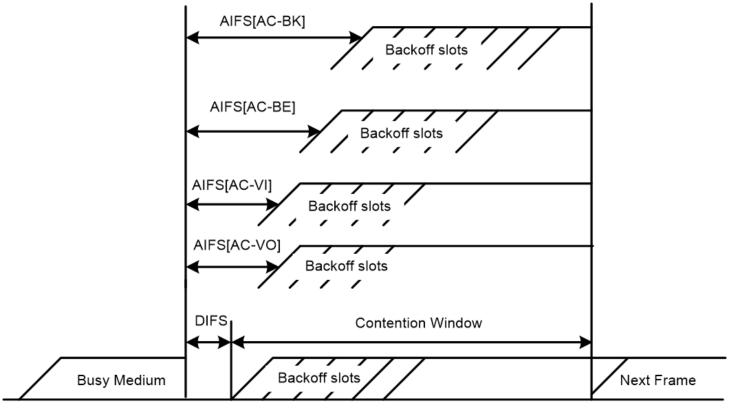

EDCA parameters
·     Arbitration inter-frame spacing number—In 802.11-based WLAN, each client has the same idle duration (DIFS), but WMM defines an idle duration for each AC. The idle duration increases as the AIFSN increases.
·     Exponent form of CWmin/Exponent form of CWmax—ECWmin/ECWmax determines the backoff slots, which increase as the two values increase.
·     Transmission opportunity limit—TXOP limit specifies the maximum time that a client can hold the channel after a successful contention. A larger value represents a longer time. If the value is 0, a client can send only one packet each time it holds the channel.
Figure 1 EDCA parameters

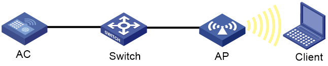

Example: Configuring basic WMM
As shown in Figure 2, enable WMM on the AC so that the AP and the client can prioritize the traffic.
Figure 2 Network diagram
# Create a service template named market, set the SSID to market, and enable the service template.

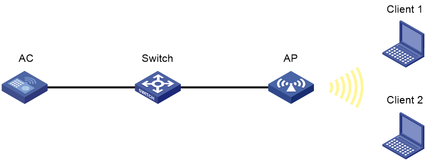

Example: Configuring CAC
As shown in Figure 3, configure CAC to allow a maximum of 10 clients to use the AC-VO and AC-VI queues.
Figure 3 Network diagram
1.     Create a service template named market, set the SSID to market, and enable the service template.
