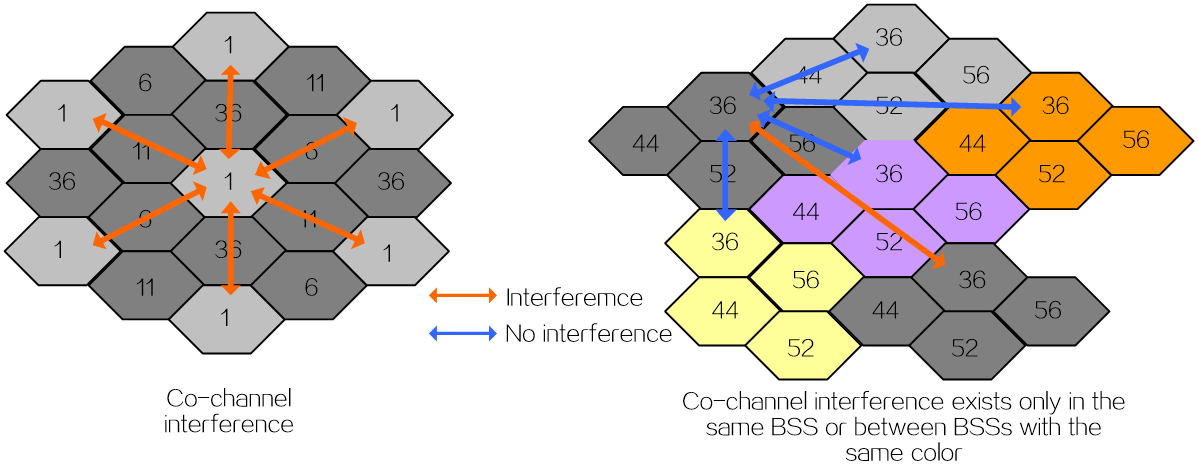

Channel
A channel is a range of frequencies with a specific bandwidth.
The 2.4 GHz band has 14 channels. The bandwidth for each channel is 20 MHz and each two channels are spaced 5 MHz apart. Among the 14 channels, four groups of non-overlapping channels exist and the most commonly used one contains channels 1, 6, and 11.
The 5 GHz band can provide higher rates and is more immune to interference. There are 24 non-overlapping channels designated to the 5 GHz band. The channels are spaced 20 MHz apart with a bandwidth of 20 MHz. The available channels vary by country.

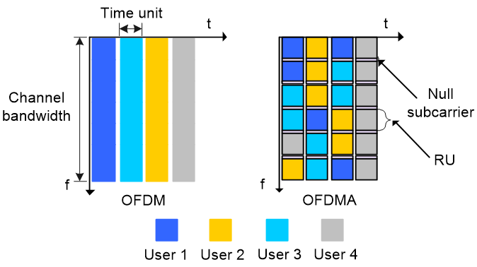

OFDMA
802.11a, 802.11g, 802.11n, and 802.11ac use Orthogonal Frequency Division Multiplexing (OFDM) in data transmission to enable a single user to transmit data on all subcarriers at a given period of time. Based on OFDM, Orthogonal Frequency Division Multiple Access (OFDMA) splits a channel into sub-channels, known as resource units (RUs), with specific subcarriers (tones), and assigns different RUs to different users for simultaneous transmission. This increases the data rate and reduces transmission latency.
802.11ax uses OFDMA and reserves some null subcarriers to reduce inter-subcarrier interference on RUs.
Figure 1 OFDM and OFDMA working modes

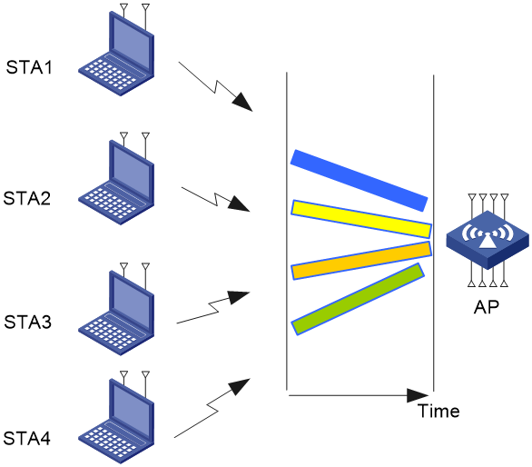

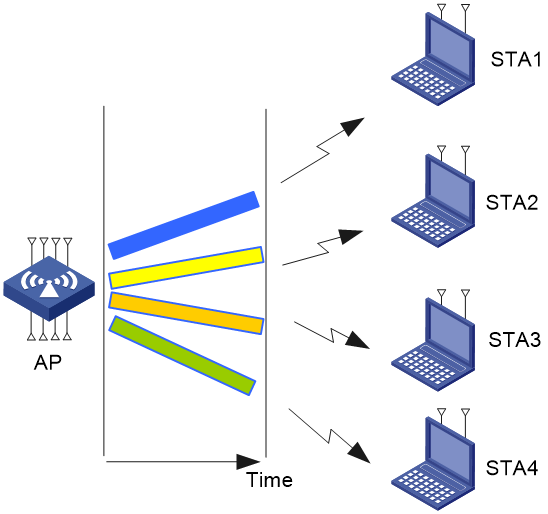

MU-MIMO
Multi-user multiple-input multiple-output (MU-MIMO) splits bandwidth into individual streams to enable simultaneous receiving and transmission of data for multiple users. 802.11ac supports only downlink MU-MIMO with a maximum of 4 streams, and 802.11ax supports both uplink and downlink MU-MIMO with a maximum of 8 streams. This greatly improves data transmission efficiency.
·     In downlink MU-MIMO, APs use beamforming to direct packets to wireless clients at different locations for the clients to receive data from an AP at the same time.
Figure 2 Downlink MU-MIMO
·     In uplink MU-MIMO, the system uses the orthogonality of different client locations to achieve spatial separation and beamforming exchanges are avoided.
Figure 3 Uplink MU-MIMO
Spatial reuse
Spatial reuse helps wireless clients to identify signals from overlapping Basic Service Sets (OBSS) and use specific information to avoid radio conflicts and manage interference. It can effectively improve system performance and spectrum resource usage in high density environments.
802.11ax assigns a non-unique ID (in the range of 1 to 63), called a BSS color, per BSS to help identify whether a packet is from the same BSS as the client.
After receiving an 802.11ax packet, a client first examines the color in the packet header. If the color is the same as the color of the associated AP's BSS, the client determines that the packet is an intra-BSS packet. If the color is different from the color of the associated AP's BSS, the client determines that the packet is an inter-BSS packet. Clients process only intra-BSS packets and ignore inter-BSS packets.
Figure 4 BSS coloring

Configuring OFDMA
OFDMA can provide the following benefits if enabled in a high density environment where small data packets are transmitted:
·     Concurrent transmission to multiple users.
·     Improved radio usage.
·     Shortened transmission latency.
·     Reduced conflict backoff.

Configuring uplink MU-MIMO
Uplink MU-MIMO enables an AP to receive data packets from multiple clients concurrently. With this feature enabled, an AP sends an HE_Trig message to all associated clients to inform the transmission time, frequency, sampling clock, and power requirements. Upon receiving the message, clients send data packets to the AP as required at the same time.
This feature is applicable to scenarios that have a large number of clients and high AP bandwidth usage and transmission latency requirements.
This feature is configurable only for 802.11ax radios.
2.     Enter AP view/an AP group's AP model view.
¡     Enter AP view.
wlan ap ap-name
¡     Execute the following commands in sequence to enter an AP group's AP model view:
wlan ap-group group-name
ap-model ap-model
3.     Enter radio view.
radio radio-id
4.     Configure uplink MU-MIMO.
ul-mu-mimo { disable | enable }
By default:
¡     In radio view, the configuration in an AP group's radio view is used.
¡     In an AP group's radio view, uplink MU-MIMO is disabled.

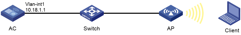

As shown in Figure 7, create a manual AP and set the radio mode, working channel, and maximum transmit power to 802.11ax, channel 40, and 19 dBm, respectively.
Figure 7 Network diagram

Figure 8 Network diagram
# Create manual AP ap1, and specify its model and serial ID.
<AC> system-view
[AC] wlan ap ap1 model WA6320
[AC-wlan-ap-ap1] serial-id 219801A28N819CE0002T
# Enter radio view of radio 1 on AP 1, and specify the radio as an 802.11an radio.
[AC-wlan-ap-ap1] radio 1
[AC-wlan-ap-ap1-radio-1] type dot11an
# Enable the A-MPDU and A-MSDU aggregation methods.
[AC-wlan-ap-ap1-radio-1] a-mpdu enable
[AC-wlan-ap-ap1-radio-1] a-msdu enable
# Enable radio 1.
[AC-wlan-ap-ap1-radio-1] radio enable
[AC-wlan-ap-ap1-radio-1] return
