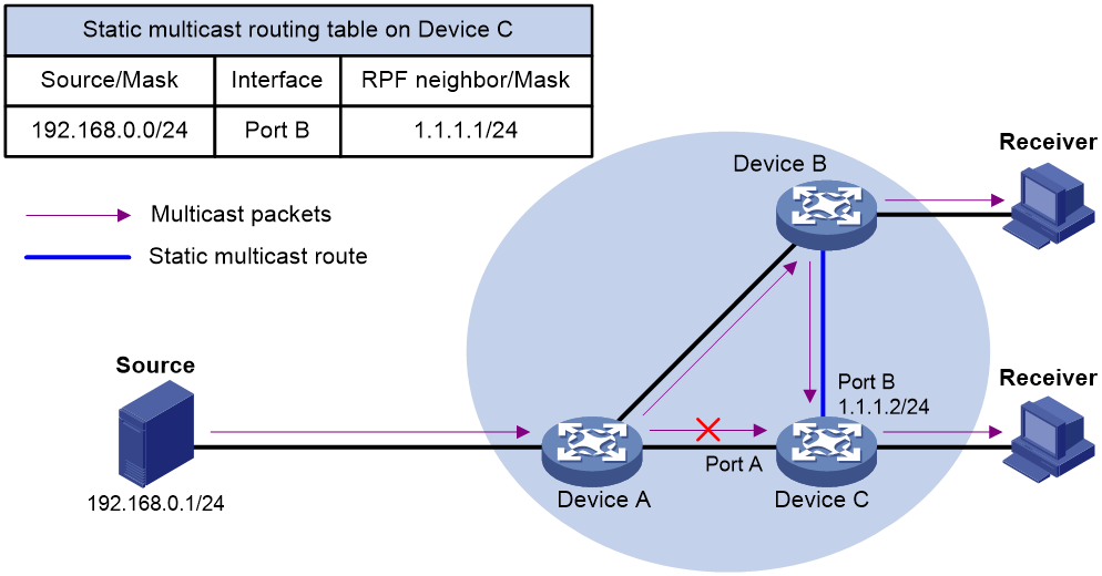

A static multicast route can change an RPF route or create an RPF route.
Changing an RPF route
Typically, the topology structure of a multicast network is the same as that of a unicast network, and multicast traffic follows the same transmission path as unicast traffic does. You can configure a static multicast route for a multicast source to change the RPF route. As a result, the device creates a transmission path for multicast traffic that is different from the transmission path for unicast traffic.
Figure 2 Changing an RPF route
As shown in Figure 2, when no static multicast route is configured, Device C's RPF neighbor on the path back to the source is Device A. The multicast data from the source travels through Device A to Device C. You can configure a static multicast route on Device C and specify Device B as Device C's RPF neighbor on the path back to the source. The multicast data from the source travels along the path: Device A to Device B and then to Device C.

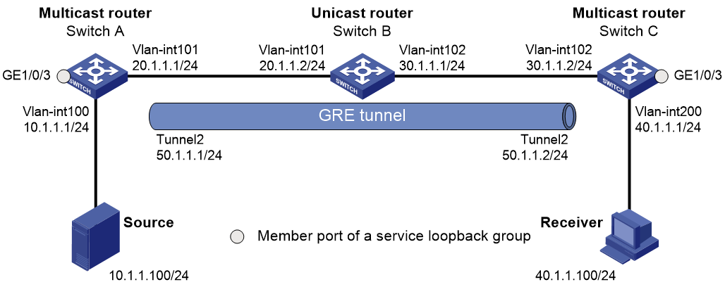

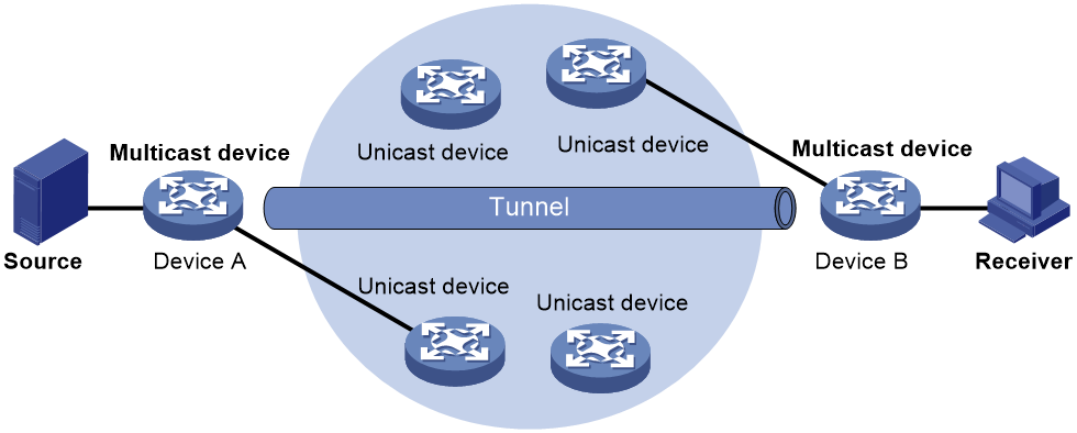

Multicast forwarding across unicast subnets
Multicast data transmission over a 6to4 tunnel is not supported in the current software version.
Devices forward the multicast data from a multicast source hop by hop along the forwarding tree, but some devices might not support multicast protocols in a network. When the multicast data is forwarded to a device that does not support IP multicast, the forwarding path is blocked. In this case, you can enable multicast forwarding across two unicast subnets by establishing a tunnel between the devices at the edges of the two unicast subnets.
Figure 4 Multicast data transmission through a tunnel
As shown in Figure 4, a tunnel is established between Device A and Device B. Device A encapsulates the multicast data in unicast IP packets, and forwards them to Device B across the tunnel through unicast devices. Then, Device B strips off the unicast IP header and continues to forward the multicast data to the receiver.
To use this tunnel only for multicast traffic, configure the tunnel as the outgoing interface only for multicast routes.

Example: Changing an RPF route
As shown in Figure 5:
·     PIM-DM runs on the network.
·     All switches on the network support multicast.
·     Switch A, Switch B and Switch C run OSPF.
·     Typically, the receiver host can receive the multicast data from the source through the path: Switch A to Switch B, which is the same as the unicast route.
Configure the switches so that the multicast data from the source travels to the receiver through the path: Switch A to Switch C to Switch B. This is different from the unicast route.

The output shows that the current RPF route on Switch B is contributed by a unicast routing protocol and the RPF neighbor is Switch A.
3.     Configure a static multicast route on Switch B and specify Switch C as its RPF neighbor on the route to the source.
[SwitchB] ip rpf-route-static 50.1.1.0 24 20.1.1.2
# Display RPF information for the source on Switch B.
[SwitchB] display multicast rpf-info 50.1.1.100
 RPF information about source 50.1.1.100:
     RPF interface: Vlan-interface101, RPF neighbor: 20.1.1.2
     Referenced route/mask: 50.1.1.0/24
     Referenced route type: multicast static
     Route selection rule: preference-preferred
     Load splitting rule: disable
     Source AS: 0
     C-multicast route target: 0x0000000000000000
The output shows the following information:
·     The RPF route on Switch B is the configured static multicast route.
·     The RPF neighbor of Switch B is Switch C.

Example: Configuring multicast forwarding over a GRE tunnel
As shown in Figure 7:
·     Multicast routing and PIM-DM are enabled on Switch A and Switch C.
·     Switch B does not support multicast.
·     Switch A, Switch B, and Switch C run OSPF.
Configure the switches so that the receiver host can receive the multicast data from the source.
Figure 7 Network diagram
Assign an IP address and subnet mask for each interface as shown in Figure 7, and configure OSPF on all switches.

3.     On Switch C, configure a static multicast route to the source and specify Switch A as the RPF neighbor.
[SwitchC] ip rpf-route-static 50.1.1.0 24 50.1.1.1
# Send an IGMP report from Receiver to join multicast group 225.1.1.1. (Details not shown.)
# Send multicast data from the source to multicast group 225.1.1.1. (Details not shown.)
# Display PIM routing entries on Switch C.
[SwitchC] display pim routing-table
 Total 1 (*, G) entry; 1 (S, G) entry
 (*, 225.1.1.1)
     Protocol: pim-dm, Flag: WC
     UpTime: 00:04:25
     Upstream interface: NULL
         Upstream neighbor: NULL
         RPF prime neighbor: NULL
     Downstream interface(s) information:
     Total number of downstreams: 1
         1: Vlan-interface200
             Protocol: igmp, UpTime: 00:04:25, Expires: -
 (10.1.1.100, 225.1.1.1)
     Protocol: pim-dm, Flag: ACT
     UpTime: 00:06:14
     Upstream interface: Tunnel2
         Upstream neighbor: 50.1.1.1
         RPF prime neighbor: 50.1.1.1
             Protocol: pim-dm, UpTime: 00:04:25, Expires: -
The output shows that Switch A is the RPF neighbor of Switch C and the multicast data from Switch A is delivered over the GRE tunnel to Switch C.
