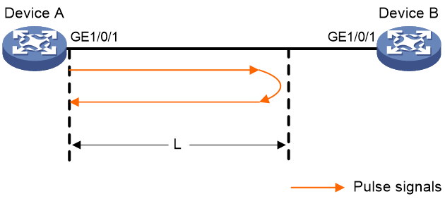

Forcibly bringing up a fiber port
As shown in Figure 2, a fiber port uses separate fibers for transmitting and receiving packets. The physical state of the fiber port is up only when both transmit and receive fibers are physically connected. If one of the fibers is disconnected, the fiber port does not work.
To enable a fiber port to forward traffic over a single link, you can use the port up-mode command. This command forcibly brings up a fiber port, even when no fiber links or transceiver modules are present for the fiber port. When one fiber link is present and up, the fiber port can forward packets over the link unidirectionally.
Figure 2 Forcibly bring up a fiber port
Only GE fiber ports and 10-GE fiber ports support this feature. Copper ports and combo interfaces do not support this feature.
The port up-mode, shutdown, and loopback commands are mutually exclusive.
A fiber port does not support this feature if the port is shut down by a protocol or by using the shutdown command.
A fiber port forcibly brought up stays physically up whether or not a transceiver module or a fiber link is present for the port.
A GE or 10-GE fiber port forcibly brought up cannot correctly forward traffic if it is installed with a fiber-to-copper converter, 100/1000-Mbps transceiver module, or 100-Mbps transceiver module. To solve the problem, use the undo port up-mode command on the fiber port.
