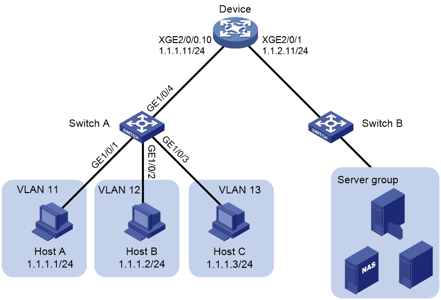

Inter-VLAN communication
Hosts in different VLANs cannot directly communicate with each other. You can use Layer 3 routing to allow all VLANs to communicate.
As shown in Figure 1, Host A and Host B are in different VLANs. For the two hosts to communicate with each other, perform the following tasks:
1.     Specify 1.1.1.1/24 and 1.1.2.1/24 as the gateway IP address for Host A and Host B, respectively.
2.     On the device, configure Dot1q termination on Layer 3 Ethernet subinterfaces Subinterface A.2 and Subinterface A.3.
Figure 1 Inter-VLAN communication through Layer 3 subinterfaces

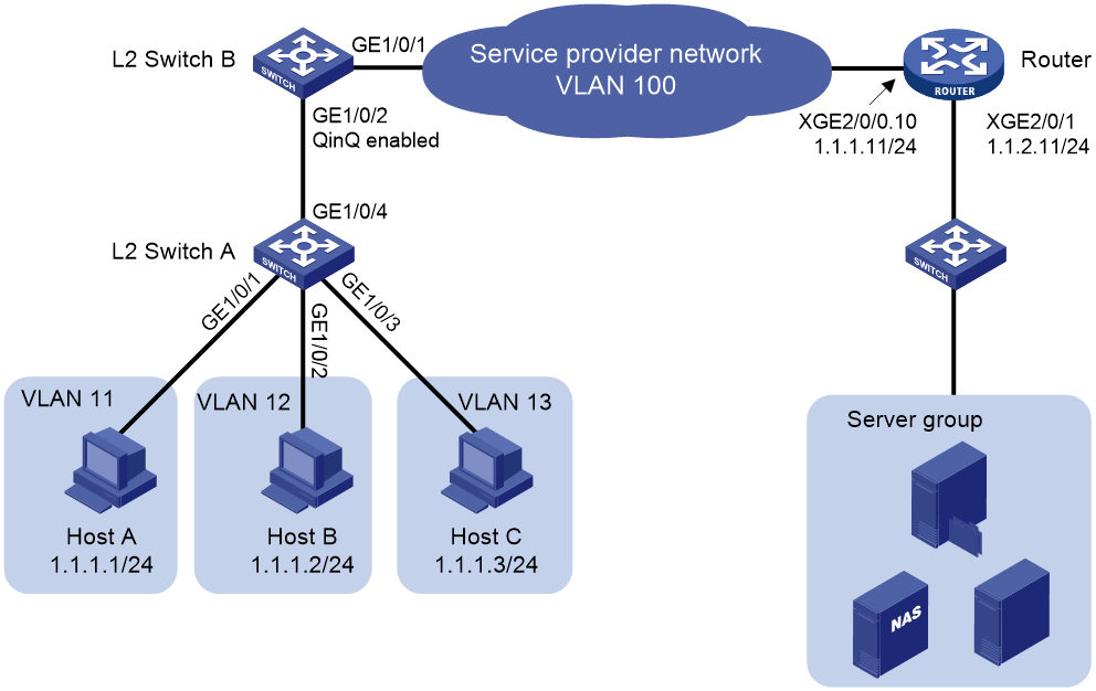

LAN-WAN communication
Typically, WAN protocols  do not recognize VLAN-tagged packets from LANs. Before packets are sent to a WAN, the sending port must locally record the VLAN information and remove VLAN tags from the packets.
As shown in Figure 2, a host is located on a customer network and wants to access the WAN network through a PPPoE connection. CVLAN and SVLAN represent the VLAN on the customer network and service provider network, respectively.
To access the WAN network, a packet originating from the host is processed as follows:
1.     Layer 2 Switch A adds a CVLAN tag to the packet and sends the packet.
2.     Layer 2 Switch B adds an SVLAN tag to the packet on the QinQ-enabled port.
3.     The packet is forwarded on the service provider network based on the SVLAN tag.
4.     The gateway removes the two layers of VLAN tags from the packet and adds new VLAN tags on the QinQ termination-enabled port.
5.     The gateway sends the packet to the WAN.
Figure 2 VLAN termination enables LAN-WAN communication

Example: Configuring ambiguous Dot1q termination
As shown in Figure 3, configure ambiguous Dot1q termination so that hosts in different VLANs can communicate with the server group.
Figure 3 Network diagram
In this example, L2 Switch B uses the factory configuration.
1.     Configure Host A, Host B, and Host C:
# Assign 1.1.1.1/24, 1.1.1.2/24, and 1.1.1.3/24 to Host A, Host B, and Host C, respectively. (Details not shown.)
# Specify 1.1.1.11/24 as the gateway IP address for the hosts. (Details not shown.)

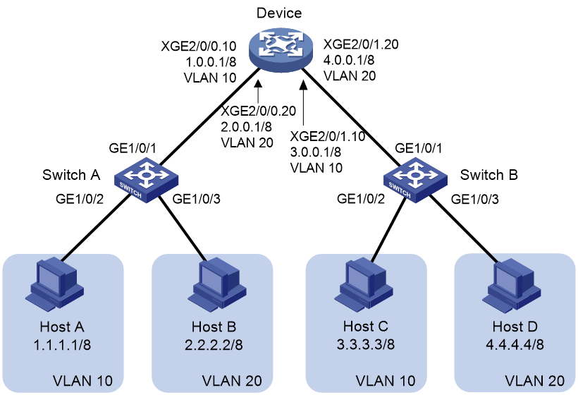

Example: Configuring unambiguous Dot1q termination
As shown in Figure 4, configure unambiguous Dot1q termination on subinterfaces of the device to implement intra-VLAN and inter-VLAN communications between hosts.
Figure 4 Network diagram
1.     Configure Host A, Host B, Host C, and Host D:
# On Host A, specify 1.1.1.1/8 and 1.0.0.1/8 as its IP address and gateway IP address, respectively. (Details not shown.)
# On Host B, specify 2.2.2.2/8 and 2.0.0.1/8 as its IP address and gateway IP address, respectively. (Details not shown.)
# On Host C, specify 3.3.3.3/8 and 3.0.0.1/8 as its IP address and gateway IP address, respectively. (Details not shown.)
# On Host D, specify 4.4.4.4/8 and 4.0.0.1/8 as its IP address and gateway IP address, respectively. (Details not shown.)

Example: Configuring ambiguous QinQ termination
As shown in Figure 5, QinQ is enabled on GigabitEthernet 1/0/2 of Layer 2 Switch B.
Configure ambiguous QinQ termination, so that hosts can communicate with the server group.
Figure 5 Network diagram
In this example, Layer 2 Switch C uses the factory configuration.
# Assign the IP addresses 1.1.1.1/24, 1.1.1.2/24, and 1.1.1.3/24 to Host A, Host B, and Host C, respectively. (Details not shown.)
# Specify 1.1.1.11/24 as the gateway address for the hosts. (Details not shown.)

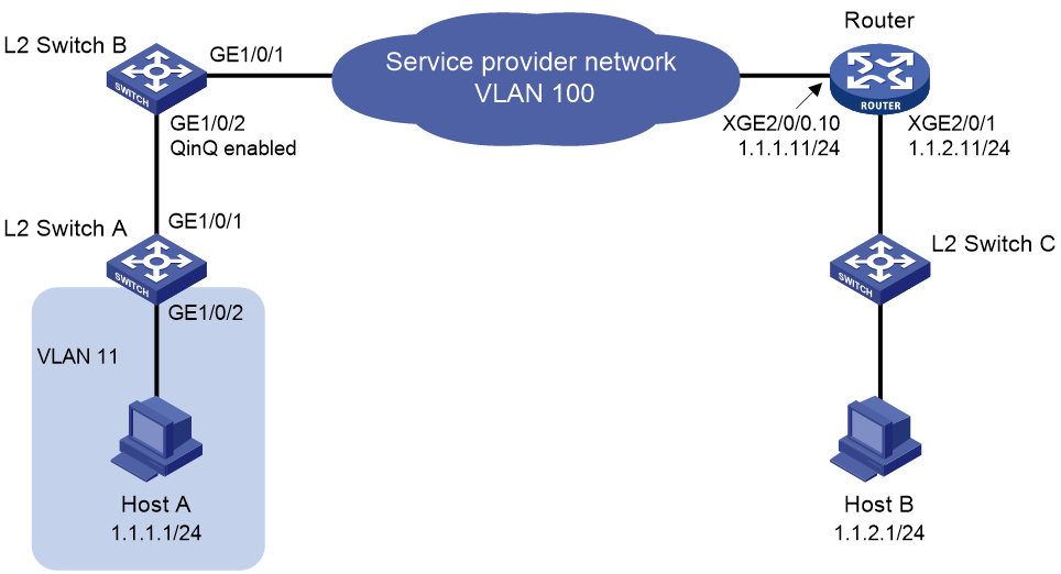

Example: Configuring unambiguous QinQ termination
As shown in Figure 6:
·     Layer 2 Switch C supports only single VLAN-tagged packets.
·     On Layer 2 Switch B, GigabitEthernet 1/0/2 is enabled with QinQ to add an SVLAN tag 100 to the packets with CVLAN ID 11.
Configure unambiguous QinQ termination so that Host A can communicate with Host B.
Figure 6 Network diagram
1.     Configure Host A and Host B:
# On Host A, specify 1.1.1.1/24 and 1.1.1.11/24 as its IP address and gateway IP address, respectively. (Details not shown.)
# On Host B, specify 1.1.2.1/24 and 1.1.2.11/24 as its IP address and gateway IP address, respectively. (Details not shown.)
