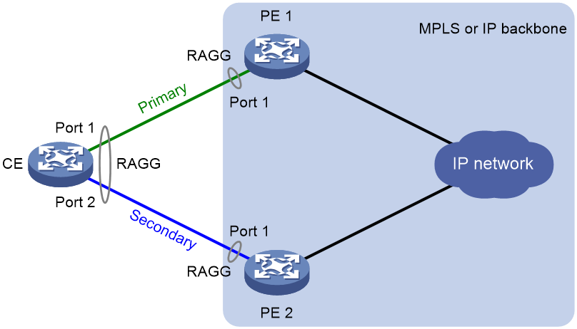

Configuring a 1+1 backup aggregation group
About 1+1 backup link aggregation
As shown in Figure 4, a 1+1 backup aggregation group is used on a CE that is dualhomed to PEs for high availability of services. A 1+1 backup aggregation group is a static Layer 3 aggregation group that contains one primary member port and one secondary member port. The primary member port is placed in Selected state to forward all traffic, and the secondary member port is placed in Unselected state as a standby.
Figure 4 Application scenarios for 1+1 backup link aggregation
1+1 backup link aggregation tasks at a glance
