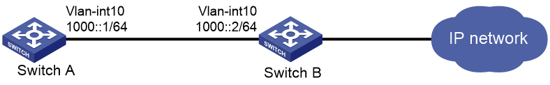

uRPF configuration examples
Example: Configuring uRPF for interfaces
As shown in Figure 3, perform the following tasks:
·     Configure strict uRPF check on VLAN-interface 10 of Switch B.
·     Configure strict uRPF check on VLAN-interface 10 of Switch A.
Figure 3 Network diagram
1.     Configure Switch B:
# Create VLAN 10.
[SwitchB] vlan 10
[SwitchB-vlan10] quit
# Specify an IP address for VLAN-interface 10.
[SwitchB] interface vlan-interface 10
[SwitchB-Vlan-interface10] ip address 1.1.1.2 255.255.255.0
# Configure strict uRPF check on VLAN-interface 10.
[SwitchB-Vlan-interface10] ip urpf strict
2.     Configure Switch A:
# Create VLAN 10.
<SwitchA> system view
[SwitchA] vlan 10
[SwitchA-vlan10] quit
[SwitchA-Vlan-interface10] ip address 1.1.1.1 255.255.255.0
[SwitchA-Vlan-interface10] ip urpf strict
