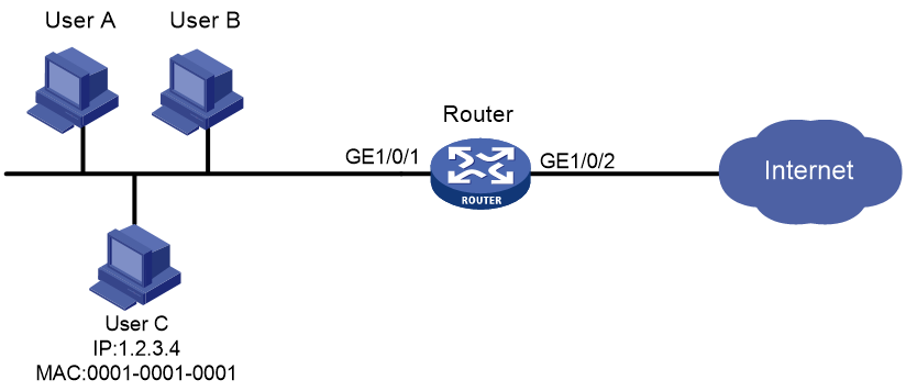

Attack detection and prevention configuration examples
Example: Configuring interface-based attack detection and prevention
As shown in Figure 1, configure an attack defense policy and apply the policy to VLAN-interface 3 to meet the following requirements:
·     Provide low-level scanning attack detection for internal hosts and servers.
·     Protect internal hosts and servers against smurf attacks. If a smurf attack is detected, log the attack.
Figure 1 Network diagram
# Configure IP addresses for the interfaces on the switch. (Details not shown.)
# Create attack defense policy a1.
[Device] attack-defense policy a1
# Configure signature detection for smurf attacks, and specify logging as the prevention action.
[Device-attack-defense-policy-a1] signature detect smurf action logging
# Configure low-level scanning attack detection and specify logging as the prevention action.
[Device-attack-defense-policy-a1] scan detect level low action logging
# Apply attack defense policy a1 to VLAN-interface 3.
[Device] interface vlan-interface 3
[Device-Vlan-interface3] attack-defense apply policy a1
[Device-Vlan-interface3] quit

# Verify that the attack detection and prevention takes effect on VLAN-interface 3.
[Device] display attack-defense statistics interface Vlan-interface 3
Attack policy name: a1
Scan attack defense statistics:
 AttackType                          AttackTimes Dropped
 Port scan                           2           0
 IP sweep                            3           0
 Distribute port scan                1           0
Flood attack defense statistics:
 No flood attacks detected.
Signature attack defense statistics:
 Smurf                               1           0

Example: Configuring IP blacklist
As shown in Figure 3, configure the IP blacklist feature on the router to block packets from the attacker Host D permanently and from Host C for 50 minutes.
Figure 3 Network diagram
# Configure IP addresses for the interfaces on the router. (Details not shown.)
# Enable the global blacklist feature.
<Router> system-view
[Router] blacklist global enable
# Add an IPv4 blacklist entry for Host D.
[Router] blacklist ip 5.5.5.5
# Add an IPv4 blacklist entry for Host C and set the blacklist entry aging time to 50 minutes.
[Router] blacklist ip 192.168.1.4 timeout 50
# Verify that the IPv4 blacklist entries are successfully added.
<Router> display blacklist ip
IP address      VPN instance   DS-Lite tunnel peer  Type    TTL(sec)
5.5.5.5         --             --                   Manual  Never
192.168.1.4     --             --                   Manual  2989
# Verify that the router drops packets from Host D. (Details not shown.)
# Execute the undo blacklist ip 5.5.5.5 command and verify that the router forwards packets from Host D. (Details not shown.)
# Verify that the router drops packets from Host C for 50 minutes and forwards packets from Host C after 50 minutes. (Details not shown.)
