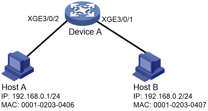

As shown in Figure 1, IPSG forwards only the packets that match an IPSG binding.
Figure 1 IPSG application

IPSG configuration examples
Example: Configuring static IPv4SG
As shown in Figure 2, all hosts use static IP addresses.
Configure static IPv4SG bindings on Device A and Device B to meet the following requirements:
·     All interfaces of Device A allow IP packets from Host A to pass.
·     Ten-GigabitEthernet 3/0/1 of Device A allows IP packets from Host B to pass.
Figure 2 Network diagram
