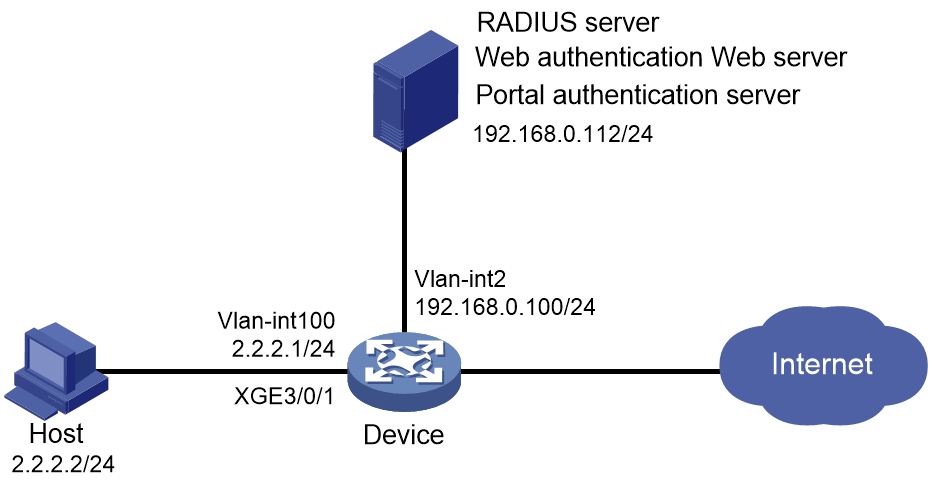

Web authentication system
A typical Web authentication system consists of four basic components: authentication client, access device, Web server for Web authentication, and AAA server.
Figure 1 Web authentication system using the local portal server
Authentication client
An authentication client is a Web browser that runs HTTP or HTTPS on the user endpoint.
Access device
An access device has the following functions:
·     Redirects all user HTTP or HTTPS requests that do not match authentication-free rules to the Web authentication page before authentication.
·     Interacts with the AAA server to complete authentication, authorization, and accounting. For more information about AAA, see "Configuring AAA."
·     Allows users that pass authentication to access authorized network resources.
A Web server pushes the Web authentication page to authentication clients and obtains user authentication information (username and password).
A Web server for Web authentication can be a local Web server or a remote Web server. A local Web server is usually integrated into the access device. A remote Web server is a portal Web server.
Portal authentication server
Web authentication uses a portal authentication server as the authentication server, which exchanges client authentication information with the access device.
AAA server
An AAA server interacts with the access device to implement user authentication, authorization, and accounting. A RADIUS server can perform authentication, authorization, and accounting for Web authentication users. An LDAP server can perform authentication for Web authentication users.

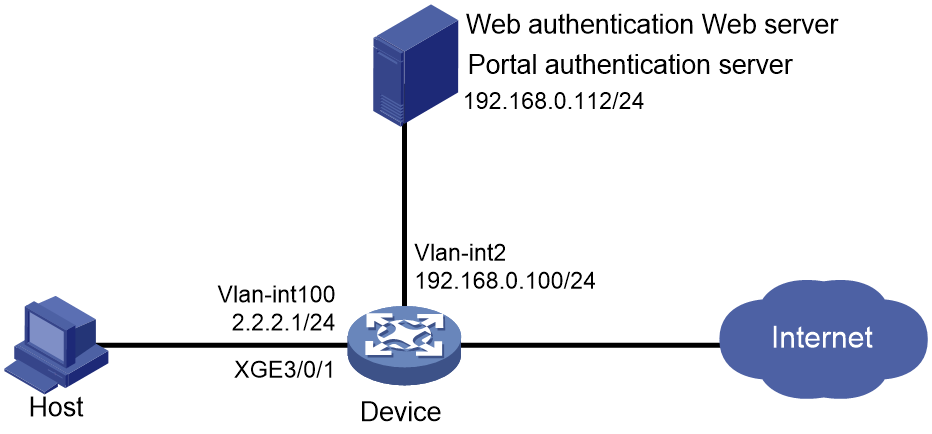

Web authentication process
Figure 2 Web authentication process
The Web authentication process is as follows:
1.     An unauthenticated user sends an HTTP or HTTPS request. When the access device receives the HTTP or HTTPS request on a Layer 2 Ethernet interface enabled with Web authentication, the request, it redirects the request to the Web authentication page. The user enters the username and password on the Web authentication page.
If the user requests the Web authentication page or free Web resources, the access device permits the request. No Web authentication is performed.
2.     The Web server for Web authentication sends the user information to the portal authentication.
3.     The portal authentication server and the access device interact with each other to perform CHAP authentication. This step is skipped if PAP authentication is used. The authentication interaction type is determined by the portal authentication server.
4.     The portal authentication sends an authentication request that contains the username and password of the user to the access device and starts a timer to wait for an authentication response.
5.     The access device and the AAA server exchange RADIUS packets to authenticate the user.
6.     The access device sends an authentication response indicating authentication success or failure to the portal authentication server.
7.     The portal authentication server notifies the authentication result to the client.
8.     If the user passes RADIUS authentication, the portal authentication server also sends an authentication-ACK packet to the access device.

Web authentication configuration examples
Example: Configuring local Web authentication by using the AAA local authentication method
As shown in Figure 5, the host is directly connected to the device through Ten-GigabitEthernet 3/0/1.

Example: Configuring remote Web authentication by using the AAA local authentication method
As shown in Figure 7, the host is directly connected to the device through Ten-GigabitEthernet 3/0/1.
Configure remote Web authentication on Ten-GigabitEthernet 3/0/1, and configure the device to perform local authentication and authorization for the remote Web authentication users.
The remote Web server pushes Web authentication pages to users.
Figure 7 Network diagram
Configure the portal authentication server properly to provide normal portal functions for users.
Create VLANs, assign IP addresses to the VLAN interfaces, and assign interfaces to the VLANs. Make sure the host, the RADIUS server, and the device can reach each other.

Example: Configuring remote Web authentication by using the AAA remote authentication method
As shown in Figure 8, the host is directly connected to the device through Ten-GigabitEthernet 3/0/1.
Configure remote Web authentication on Ten-GigabitEthernet 3/0/1, and use a remote RADIUS server to perform authentication, authorization, and accounting for the remote Web authentication users.
Figure 8 Network diagram
Configure the RADIUS server properly to provide authentication, authorization, and accounting functions for users. In this example, the username is configured as user1 on the RADIUS server.
