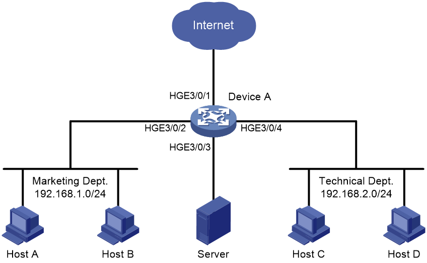

Figure 1 Local port mirroring implementation
As shown in Figure 1, the source port (Port A) and the monitor port (Port B) reside on the same device. Packets received on Port A are copied to Port B. Port B then forwards the packets to the data monitoring device for analysis.

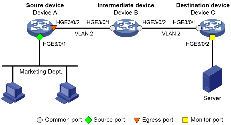

In Layer 2 remote port mirroring that uses the reflector port method, packets are mirrored as follows:
1.     The source device copies packets received on the mirroring sources to the reflector port.
2.     The reflector port broadcasts the mirrored packets in the remote probe VLAN.
3.     The intermediate devices transmit the mirrored packets to the destination device through the remote probe VLAN.
4.     Upon receiving the mirrored packets, the destination device determines whether the ID of the mirrored packets is the same as the remote probe VLAN ID. If the two VLAN IDs match, the destination device forwards the mirrored packets to the data monitoring device through the monitor port.
Figure 2 Layer 2 remote port mirroring implementation through the reflector port method

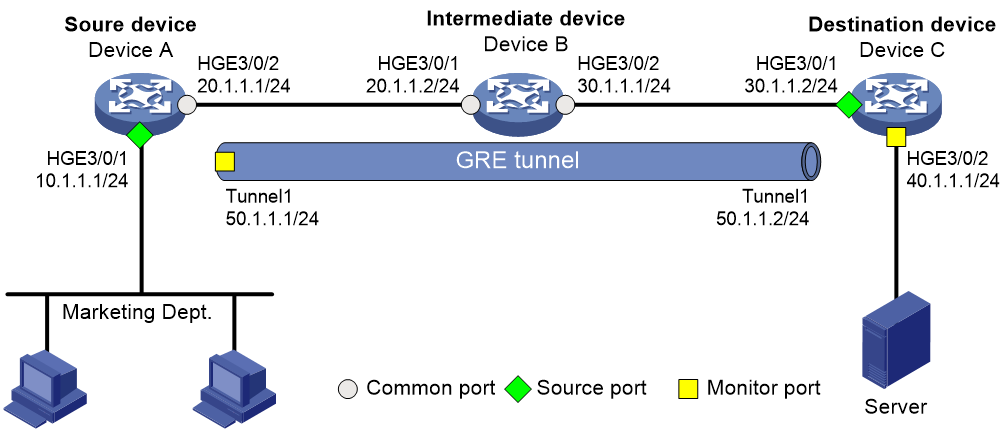

Egress port method
In Layer 2 remote port mirroring that uses the egress port method, packets are mirrored as follows:
1.     The source device copies packets received on the mirroring sources to the egress port.
2.     The egress port forwards the mirrored packets to the intermediate devices.
3.     The intermediate devices flood the mirrored packets in the remote probe VLAN and transmit the mirrored packets to the destination device.
Figure 3 Layer 2 remote port mirroring implementation through the egress port method

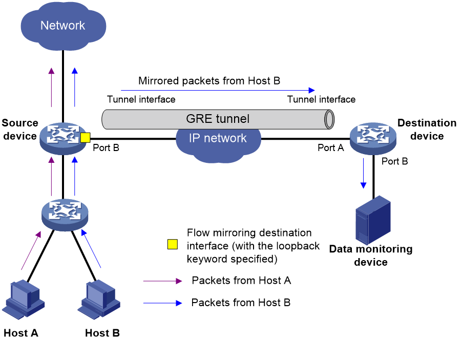

For example, in a network as shown in Figure 4, Layer 3 remote port mirroring in tunnel mode works as follows:
1.     The source device sends one copy of a packet received on the source port (Port A) to the tunnel interface.
The tunnel interface acts as the monitor port in the local mirroring group created on the source device.
2.     The tunnel interface on the source device forwards the mirrored packet to the tunnel interface on the destination device through the GRE tunnel.
3.     The destination device receives the mirrored packet from the physical interface of the tunnel interface.
The tunnel interface acts as the source port in the local mirroring group created on the destination device.
4.     The physical interface of the tunnel interface sends one copy of the packet to the monitor port (Port B).
5.     The monitor port (Port B) forwards the packet to the data monitoring device.
For more information about GRE tunnels and tunnel interfaces, see Layer 3—IP Services Configuration Guide.
Figure 4 Layer 3 remote port mirroring in tunnel mode

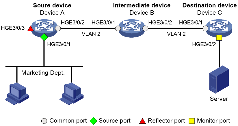

As shown in Figure 5, Layer 3 remote port mirroring in encapsulation parameter mode works as follows:
1.     The source device copies a packet passing through a source port.
2.     The source device encapsulates the copied packet with the specified encapsulation parameters, monitoring device IP as destination IP and monitor port IP as source IP.
3.     The encapsulated packet is routed to the monitoring device through the IP network.
4.     The monitoring device decapsulates the packet and analyzes the packet contents.
The packet sent to the monitoring device through Layer 3 remote port mirroring in encapsulation parameter mode is encapsulated. In this mode, make sure the monitoring device supports decapsulating packets.
Figure 5 Layer 3 remote port mirroring in encapsulation parameter mode

Layer 2 remote port mirroring with configurable reflector port configuration task list
Configuring the destination device
1.     Creating a remote destination group
2.     Configuring the monitor port
3.     Configuring the remote probe VLAN
4.     Assigning the monitor port to the remote probe VLAN
Configuring the source device
1.     Creating a remote source group
2.     Configuring mirroring sources
¡     Configuring source ports
¡     Configuring source CPUs
3.     Configuring the reflector port
4.     Configuring the remote probe VLAN
Layer 2 remote port mirroring with egress port configuration task list
3.     Configuring the egress port
Restrictions and guidelines for egress port configuration
Perform this task on the source device only.
Disable the following features on the egress port:
·     Spanning tree.
·     802.1X.
·     IGMP snooping.
·     Static ARP.
·     MAC address learning.
A port of an existing mirroring group cannot be configured as an egress port.
A mirroring group supports only one egress port.
Configuring the egress port in system view
2.     Configure the egress port for a remote source group.
mirroring-group group-id monitor-egress interface-type interface-number
By default, no egress port is configured for a remote source group.
3.     Enter the egress port view.
4.     Assign the egress port to the remote probe VLAN.
¡     Assign a trunk port to the remote probe VLAN.
port trunk permit vlan vlan-id
¡     Assign a hybrid port to the remote probe VLAN.
port hybrid vlan vlan-id { tagged | untagged }
For more information about the port trunk permit vlan and port hybrid vlan commands, see Layer 2—LAN Switching Command Reference.

Configuring Layer 3 remote port mirroring
Restrictions and guidelines for Layer 3 remote port mirroring configuration
To implement Layer 3 remote port mirroring, you must configure a unicast routing protocol on the intermediate devices to ensure Layer 3 reachability between the source and destination devices.
Layer 3 remote port mirroring tasks at a glance
1.     Configuring local mirroring groups
3.     Configuring the monitor port
Prerequisites for Layer 3 remote port mirroring
Before configuring Layer 3 remote mirroring in tunnel mode, complete the following tasks:
·     Create a tunnel interface and a GRE tunnel.
·     Configure the source and destination addresses of the tunnel interface as the IP addresses of the physical interfaces on the source and destination devices, respectively.
For more information about tunnel interfaces, see Layer 3—IP Services Configuration Guide.
Configure a local mirroring group on both the source device and the destination device.
2.     Create a local mirroring group.
mirroring-group group-id local
By default, no local mirroring group exists.

Example: Configuring local port mirroring (SPAN in source port mode)
As shown in Figure 6, configure local port mirroring in source port mode to enable the server to monitor the bidirectional traffic of the two departments.
Figure 6 Network diagram
# Create local mirroring group 1.
<Device> system-view
[Device] mirroring-group 1 local
# Configure HundredGigE 3/0/1 and HundredGigE 3/0/2 as source ports for local mirroring group 1.
[Device] mirroring-group 1 mirroring-port hundredgige 3/0/1 hundredgige 3/0/2 both
# Configure HundredGigE 3/0/3 as the monitor port for local mirroring group 1.
[Device] mirroring-group 1 monitor-port hundredgige 3/0/3
# Disable the spanning tree feature on the monitor port (HundredGigE 3/0/3).
[Device] interface hundredgige 3/0/3
[Device-HundredGigE3/0/3] undo stp enable
[Device-HundredGigE3/0/3] quit
# Verify the mirroring group configuration.
[Device] display mirroring-group all
Mirroring group 1:
    Type: Local
    Status: Active
    Mirroring port:
        HundredGigE3/0/1  Both
        HundredGigE3/0/2  Both
    Monitor port: HundredGigE3/0/3

Example: Configuring Layer 2 remote port mirroring (RSPAN with reflector port configurable)
As shown in Figure 8, configure Layer 2 remote port mirroring to enable the server to monitor the bidirectional traffic of the Marketing Department.
Figure 8 Network diagram
1.     Configure Device C (the destination device):
# Configure HundredGigE 3/0/1 as a trunk port, and assign the port to VLAN 2.
<DeviceC> system-view
[DeviceC] interface hundredgige 3/0/1
[DeviceC-HundredGigE3/0/1] port link-type trunk
[DeviceC-HundredGigE3/0/1] port trunk permit vlan 2
[DeviceC-HundredGigE3/0/1] quit
# Create a remote destination group.
[DeviceC] mirroring-group 2 remote-destination
# Create VLAN 2.
[DeviceC] vlan 2
# Disable MAC address learning for VLAN 2.
[DeviceC-vlan2] undo mac-address mac-learning enable
[DeviceC-vlan2] quit
# Configure VLAN 2 as the remote probe VLAN for the mirroring group.
[DeviceC] mirroring-group 2 remote-probe vlan 2
# Configure HundredGigE 3/0/2 as the monitor port for the mirroring group.
[DeviceC] interface hundredgige 3/0/2
[DeviceC-HundredGigE3/0/2] mirroring-group 2 monitor-port
# Disable the spanning tree feature on HundredGigE 3/0/2.
[DeviceC-HundredGigE3/0/2] undo stp enable
# Assign HundredGigE 3/0/2 to VLAN 2.
[DeviceC-HundredGigE3/0/2] port access vlan 2
[DeviceC-HundredGigE3/0/2] quit
2.     Configure Device B (the intermediate device):
# Create VLAN 2.
<DeviceB> system-view
[DeviceB] vlan 2
[DeviceB-vlan2] undo mac-address mac-learning enable
[DeviceB-vlan2] quit
[DeviceB] interface hundredgige 3/0/1
[DeviceB-HundredGigE3/0/1] port link-type trunk
[DeviceB-HundredGigE3/0/1] port trunk permit vlan 2
[DeviceB-HundredGigE3/0/1] quit
# Configure HundredGigE 3/0/2 as a trunk port, and assign the port to VLAN 2.
[DeviceB] interface hundredgige 3/0/2
[DeviceB-HundredGigE3/0/2] port link-type trunk
[DeviceB-HundredGigE3/0/2] port trunk permit vlan 2
[DeviceB-HundredGigE3/0/2] quit
3.     Configure Device A (the source device):
# Create a remote source group.
<DeviceA> system-view
[DeviceA] mirroring-group 1 remote-source
# Create VLAN 2.
[DeviceA] vlan 2
[DeviceA-vlan2] undo mac-address mac-learning enable
[DeviceA-vlan2] quit
[DeviceA] mirroring-group 1 remote-probe vlan 2
# Configure HundredGigE 3/0/1 as a source port for the mirroring group.
[DeviceA] mirroring-group 1 mirroring-port hundredgige 3/0/1 both
# Configure HundredGigE 3/0/3 as the reflector port for the mirroring group.
[DeviceA] mirroring-group 1 reflector-port hundredgige 3/0/3
This operation may delete all settings made on the interface. Continue? [Y/N]: y
[DeviceA] interface hundredgige 3/0/2
[DeviceA-HundredGigE3/0/2] port link-type trunk
[DeviceA-HundredGigE3/0/2] port trunk permit vlan 2
[DeviceA-HundredGigE3/0/2] quit
# Verify the mirroring group configuration on Device C.
[DeviceC] display mirroring-group all
Mirroring group 2:
    Type: Remote destination
    Status: Active
    Monitor port: HundredGigE3/0/2
    Remote probe VLAN: 2
# Verify the mirroring group configuration on Device A.
[DeviceA] display mirroring-group all
Mirroring group 1:
    Type: Remote source
    Status: Active
    Mirroring port:
    Reflector port: HundredGigE3/0/3
Example: Configuring Layer 2 remote port mirroring (RSPAN with egress port)
On the Layer 2 network shown in Figure 9, configure Layer 2 remote port mirroring to enable the server to monitor the bidirectional traffic of the Marketing Department.
Figure 9 Network diagram
# Create VLAN 2.
[DeviceC] vlan 2
# Assign HundredGigE 3/0/2 to VLAN 2 as an access port.
# Create VLAN 2.
[DeviceB] vlan 2
# Create VLAN 2.
[DeviceA] vlan 2
# Configure VLAN 2 as the remote probe VLAN of the mirroring group.
# Configure HundredGigE 3/0/2 as the egress port for the mirroring group.
[DeviceA] mirroring-group 1 monitor-egress hundredgige 3/0/2
# Disable the spanning tree feature on the port.
[DeviceA-HundredGigE3/0/2] undo stp enable
Mirroring group 2:
    Status: Active
Mirroring group 1:
    Type: Remote source
    Status: Active
    Mirroring port:
    Monitor egress port: HundredGigE3/0/2
Example: Configuring Layer 3 remote port mirroring (ERSPAN in tunnel mode)
On a Layer 3 network shown in Figure 10, configure Layer 3 remote port mirroring in tunnel mode to enable the server to monitor the bidirectional traffic of the Marketing Department.
Figure 10 Network diagram
1.     Configure IP addresses for the tunnel interfaces and related ports on the devices. (Details not shown.)
2.     Configure Device A (the source device):
# Create service loopback group 1 and specify the unicast tunnel service for the group.
[DeviceA] service-loopback group 1 type tunnel
# Assign HundredGigE 3/0/3 to service loopback group 1.
[DeviceA] interface hundredgige 3/0/3
[DeviceA-HundredGigE3/0/3] port service-loopback group 1
All configurations on the interface will be lost. Continue?[Y/N]:y
[DeviceA-HundredGigE3/0/3] quit
# Create tunnel interface Tunnel 1 that operates in GRE mode, and configure an IP address and subnet mask for the interface.
[DeviceA] interface tunnel 1 mode gre
[DeviceA-Tunnel1] ip address 50.1.1.1 24
# Configure source and destination IP addresses for Tunnel 1.
[DeviceA-Tunnel1] source 20.1.1.1
[DeviceA-Tunnel1] destination 30.1.1.2
[DeviceA-Tunnel1] quit
# Enable the OSPF protocol.
[DeviceA] ospf 1
[DeviceA-ospf-1] area 0
[DeviceA-ospf-1-area-0.0.0.0] network 10.1.1.0 0.0.0.255
[DeviceA-ospf-1-area-0.0.0.0] network 20.1.1.0 0.0.0.255
[DeviceA-ospf-1-area-0.0.0.0] quit
[DeviceA-ospf-1] quit
[DeviceA] mirroring-group 1 local
# Configure HundredGigE 3/0/1 as a source port and Tunnel 1 as the monitor port of local mirroring group 1.
[DeviceA] mirroring-group 1 monitor-port tunnel 1
3.     Enable the OSPF protocol on Device B (the intermediate device).
[DeviceB] ospf 1
[DeviceB-ospf-1] area 0
[DeviceB-ospf-1-area-0.0.0.0] network 20.1.1.0 0.0.0.255
[DeviceB-ospf-1-area-0.0.0.0] network 30.1.1.0 0.0.0.255
[DeviceB-ospf-1-area-0.0.0.0] quit
[DeviceB-ospf-1] quit
4.     Configure Device C (the destination device):
[DeviceC] service-loopback group 1 type tunnel

·     Flow mirroring SPAN—Flow-mirrors traffic to a local interface.
·     Flow mirroring RSPAN—Flow-mirrors traffic to an interface, and then forwards traffic to a remote Layer 2 interface based on the VLAN of the mirrored traffic or through QoS traffic redirecting.
·     Flow mirroring ERSPAN—Encapsulates traffic in GRE packets with protocol number 0x88BE and routes the traffic to a remote monitoring device at Layer 3.
Flow mirroring SPAN or RSPAN
For flow mirroring SPAN, configure a QoS policy on the source device. Configure the QoS policy as follows:
1.     Configure a traffic class to match packets.
2.     Configure a traffic behavior to flow-mirror traffic to an interfacewithout specifying the destination-ip or source-ip keyword.
3.     Associate the traffic class with the traffic behavior.
When the device receives a matching packet, the device sends one copy of the packet to the interface specified by the traffic behavior. The interface forwards the mirrored packet to the monitoring device.
Figure 11 Flow mirroring SPAN
To implement RSPAN, forward the mirrored packet to a remote Layer 2 interface based on the VLAN of the mirrored packet or through QoS traffic redirecting.
Flow mirroring ERSPAN can be implemented in loopback mode and encapsulation parameter mode.
In the current software version, the device supports only flow mirroring ERSPAN in encapsulation parameter mode. The information about flow mirroring ERSPAN in loopback mode is for your information only.
On all devices from source to destination, configure a unicast routing protocol to ensure Layer 3 reachability between the devices.
Loopback mode
As shown in Figure 12, configure flow mirroring ERSPAN in loopback mode as follows:
1.     On the source device, apply a QoS policy to the source interface as follows:
a.     Configure a traffic class to match packets.
b.     Configure a traffic behavior to mirror packets to Port B and specify the loopback keyword.
c.     Create a QoS policy, and associate the traffic class with the traffic behavior.
d.     Apply the QoS policy to the source interface.
2.     On the source device, apply a QoS policy to Port B as follows:
b.     Configure a traffic behavior to redirect packets to a tunnel interface.
d.     Apply the QoS policy to Port B.
3.     The destination device receives mirrored packets on the tunnel interface and decapsulates the packets. Then, the destination device forwards the packets based on the destination IP address of the original packets.
Make sure the destination device has the route and ARP entry to the destination IP address.
Figure 12 Flow mirroring ERSPAN in loopback mode
Encapsulation parameter mode
In this mode, configure a QoS policy on the source device. Configure the QoS policy as follows:
2.     Configure a traffic behavior to flow-mirror traffic to an interface.
You can configure flow-mirroring traffic to an interface in one of the following modes:
·     Directly specifying an outgoing interface—In this mode, specify both the outgoing interface and encapsulation parameters. The device encapsulates packets with the specified parameters and then forwards packets out of the specified interface.
·     Specifying an outgoing interface through route lookup—In this mode, specify only encapsulation parameters without specifying an outgoing interface. The device looks up a route for the encapsulated mirrored packets based on the source IP address and destination IP address of the encapsulated packets. The outgoing interface of the route is a destination interface of the mirrored packets.
In this mode, you can use the load sharing function of a routing protocol to forward mirrored packets to multiple destination interfaces.
As shown in Figure 13, flow mirroring ERSPAN in encapsulation parameter mode works as follows:
1.     The source device copies a matching packet.
2.     The source device encapsulates the packet with the specified ERSPAN encapsulation parameters.
3.     The source device forwards the packet in either of the following methods:
¡     Forwards the mirrored packets out of the specified outgoing interface.
¡     Looks up a route for the encapsulated mirrored packet based on the source IP address and destination IP address of the encapsulated packet.
4.     The encapsulated packet is routed to the monitoring device.
5.     The monitoring device decapsulates the packet and analyzes the packet contents.
The packet sent to the monitoring device through flow mirroring in this mode is encapsulated. In this mode, make sure the monitoring device supports decapsulating packets.
Figure 13 Flow mirroring ERSPAN in encapsulation parameter mode

As shown in Figure 14, configure flow mirroring so that the server can monitor the following traffic:
·     All traffic that the Technical Department sends to access the Internet.
·     IP traffic that the Technical Department sends to the Marketing Department during working hours (8:00 to 18:00) on weekdays.
Figure 14 Network diagram
# Create working hour range work, in which working hours are from 8:00 to 18:00 on weekdays.
[Device] time-range work 8:00 to 18:00 working-day
# Create IPv4 advanced ACL 3000 to allow packets from the Technical Department to access the Internet and the Marketing Department during working hours.
[Device] acl advanced 3000
[Device-acl-ipv4-adv-3000] rule permit tcp source 192.168.2.0 0.0.0.255 destination-port eq www
[Device-acl-ipv4-adv-3000] rule permit ip source 192.168.2.0 0.0.0.255 destination 192.168.1.0 0.0.0.255 time-range work
[Device-acl-ipv4-adv-3000] quit
# Create traffic class tech_c, and configure the match criterion as ACL 3000.
[Device] traffic classifier tech_c
[Device-classifier-tech_c] if-match acl 3000
[Device-classifier-tech_c] quit
# Create traffic behavior tech_b, configure the action of mirroring traffic to HundredGigE 3/0/3.
[Device] traffic behavior tech_b
[Device-behavior-tech_b] mirror-to interface hundredgige 3/0/3
[Device-behavior-tech_b] quit
# Create QoS policy tech_p, and associate traffic class tech_c with traffic behavior tech_b in the QoS policy.
[Device] qos policy tech_p
[Device-qospolicy-tech_p] classifier tech_c behavior tech_b
[Device-qospolicy-tech_p] quit
# Apply QoS policy tech_p to the incoming packets of HundredGigE 3/0/4.
[Device] interface hundredgige 3/0/4
[Device-HundredGigE3/0/4] qos apply policy tech_p inbound
[Device-HundredGigE3/0/4] quit
# Verify that the server can monitor the following traffic:
·     All traffic sent by the Technical Department to access the Internet.
·     IP traffic that the Technical Department sends to the Marketing Department during working hours on weekdays.
