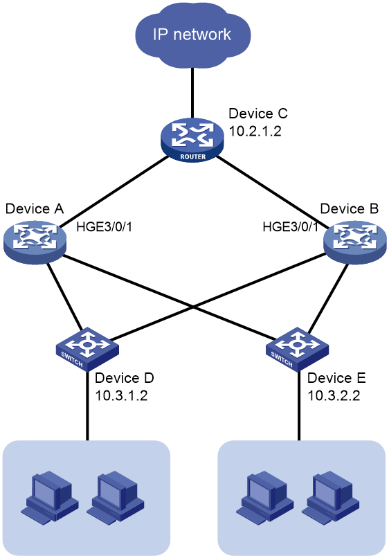

EAA framework includes a set of event sources, a set of event monitors, a real-time event manager (RTM), and a set of user-defined monitor policies, as shown in Figure 1.
Figure 1 EAA framework

Figure 3 Network diagram
# Specify 163.com as the email server domain name. Set the email username to test and password to 123.
<Sysname> system-view
[Sysname] rtm email domain 163.com
[Sysname] rtm email username test password simple 123
# Create CLI-defined policy test and enter its view.
[Sysname] rtm cli-policy test
# Create a periodic event and set the interval to 60 minutes.
[Sysname-rtm-test] event period 60
# Add a CLI action to the policy, enabling the system to display brief interface information when the event occurs.
[Sysname-rtm-test] action 1 cli display interface brief
# Add an email sending action to the policy, enabling the system to send an email with subject "Interface information", content "This is the interface brief information.", and an attachment file that contains brief interface information to mailto:[email protected] and mailto:[email protected] when the event occurs.
[Sysname-rtm-test] action 2 email receiver [email protected],[email protected] subject interface content "This is the interface brief information."
# Enable the policy.
[Sysname-rtm-test] commit
# Execute the display rtm policy registered command to verify that a CLI-defined policy named test with event type PERIOD is displayed in the command output.
[Sysname-rtm-test] display rtm policy registered
Total number: 1
Type  Event      TimeRegistered       PolicyName
CLI   PERIOD     Sep 21 11:43:09 2019 test
# Verify that the receivers receive the emails after the interval expires.
# Verify that logs are output after the interval expires indicating that the device succeeded in sending the email and the policy was executed successfully.
