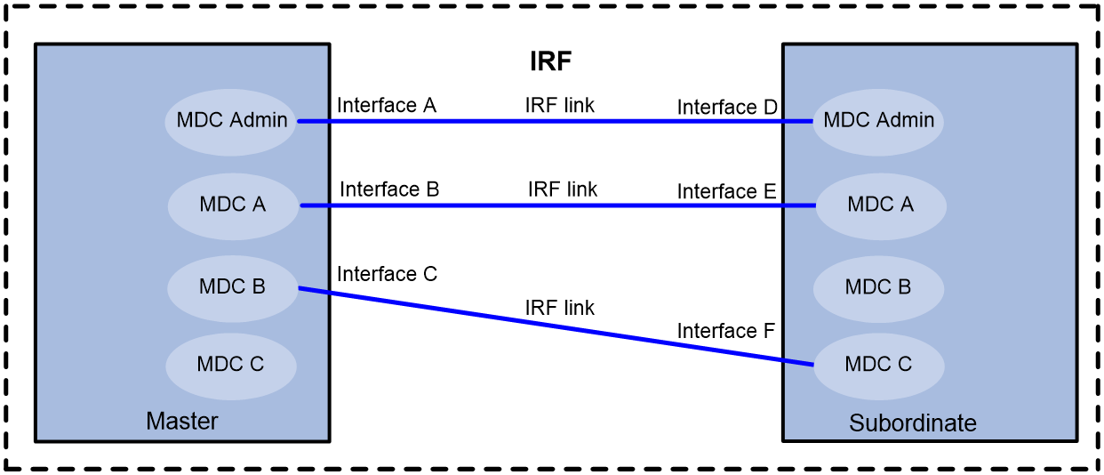

Restrictions and guidelines specific for IRF mode
·     MDCs created on an IRF fabric cannot form an IRF fabric.
·     To configure MDCs for a device that you want to add to an IRF fabric, add the device to the IRF fabric before configuring MDCs. After a device joins an IRF fabric, it reboots and loads the master's configuration instead of its own. All its settings except IRF port settings are lost.
·     For IRF link availability, establish a minimum of two IRF links that use different LPUs on each member device. To avoid IRF fabric split, make sure each member device always has a minimum of one IRF link in up state while you are configuring MDCs.
·     The administrator of a non-default MDC can change the settings of an IRF physical interface that is assigned to the MDC. As a best practice, leave IRF physical interfaces to the default MDC. If you have to assign IRF physical interfaces to a non-default MDC, the two IRF physical interfaces of an IRF link can belong to the same MDC or different MDCs, as shown in Figure 1.
Figure 1 IRF links for MDCs
·     To remove an LPU that holds the IRF physical interface of a non-default MDC, first complete the following tasks:
a.     Remove the IRF physical interface configuration for the LPU.
b.     Use the save command to save the running configuration.
·     To assign an IRF physical interface to or reclaim it from an MDC, you must first shut it down and then remove its binding to the IRF port. Save the running configuration after assigning or reclaim the interface.

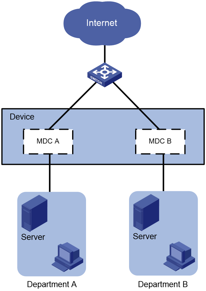

Example: Configuring MDCs in standalone mode
As shown in Figure 2, two departments need to use the device to access the Internet.
Configure two MDCs on the device to meet the Internet access requirements of two departments. Assign Ten-GigabitEthernet 2/0/1 through Ten-GigabitEthernet 2/0/24 to MDCA and Ten-GigabitEthernet 2/0/25 through Ten-GigabitEthernet 2/0/48 to MDCB.
Figure 2 Network diagram
Hardware
Software version
S12500G-AF
Release 8053P05 and later
S12500CR
S10500X-G
Release 7753P05 and later
S7500X-G (Only the S7506X-G and S7510X-G switches)
Procedures

<MDCA> display current-configuration
Configuration files
·     Device:
mdc Admin id 1
 undo location slot 2
mdc MDCA id 2
 location slot 2
 limit-resource cpu weight 5
 mdc start
 allocate interface ten-gigabitethernet 2/0/1 to ten-gigabitethernet 2/0/24
mdc MDCB id 3
 location slot 2
 mdc start
 allocate interface ten-gigabitethernet 2/0/25 to ten-gigabitethernet 2/0/48
To configure MDCs, you must follow the procedures. This configuration file records only the commands executed on the physical device.
·     MDCA:
 sysname MDCA
 telnet server enable
interface M-GigabitEthernet0/0/0
 ip address 192.168.1.251 255.255.255.0
line vty 0 63
 authentication-mode none
 user-role mdc-admin
 user-role mdc-operator
·     MDCB:
 sysname MDCB
 ip address 192.168.2.252 255.255.255.0
line vty 0 63
 user-role mdc-admin
