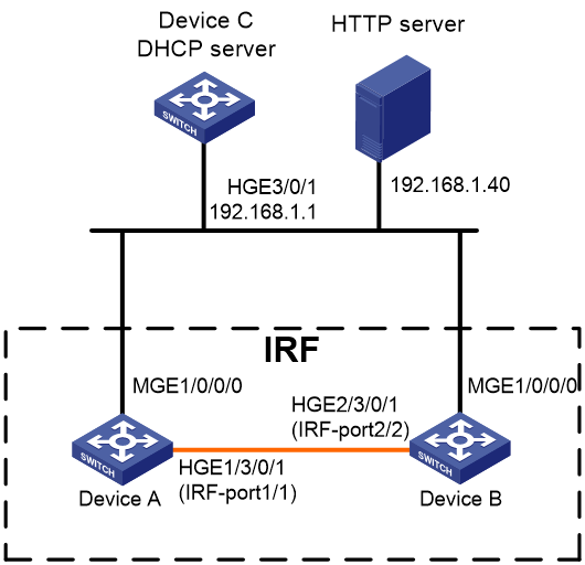

Example: Using Python script to set up an IRF fabric automatically
As shown in Figure 1, the administrator has only remote access to Device A and Device B, which have been physically connected for IRF setup. To have the two devices automatically configured into an IRF fabric:
·     Edit a Python script file to configure Device A and Device B as follows:
¡     Enable the devices to merge into an IRF fabric automatically.
¡     Enable Telnet access to the IRF fabric, and configure password authentication on VTY lines.
·     Store the Python file on an HTTP file server.
·     Issue the Python script file to the devices through a DHCP server.
Figure 1 Network diagram

When you set up an IRF fabric by using Python script, follow these restrictions and guidelines:
·     To do a successful automatic IRF setup, make sure the network environment has been set up as planned before you power on the candidate IRF member devices.
In this example, make sure the network has been set up as shown in Figure 1 before you power on Device A and Device B.

2.     Create a configuration file for each device and save the configuration files to the HTTP server.
Name the configuration files in serial_number.cfg format, where the serial_number argument represents the serial number of the device.
In the configuration files, specify the configuration for IRF setup and parameters for device login (telnet in this example), including login authentication settings.
To obtain the serial number, use one of the following methods:
·     Examine the label on the chassis rear panel.
·     Execute the display device manuinfo command.
This example uses the following configuration files:
¡     210235A045B05B0004354.cfg:
telnet server enable
 irf mac-address persistent timer

3.     Create the sn.txt file to store serial number and member ID mappings for the member devices, and then save the file to the HTTP server. The device will run the python script to parse the sn.txt file, change its member ID as configured, and then self-configure with the settings for that member ID.
sn                         Irf group                  Irf number
210235A045B05B0004354          100                           1
210235A045B05B0004350          100                           2

Configuring Device C (the DHCP server)
# Enable DHCP. Configure an address pool to assign IP addresses to the subnet that contains the member switches. This example uses the 192.168.1.0/24 subnet.
<DeviceC> system-view
[DeviceC] dhcp enable
[DeviceC] dhcp server ip-pool 1
[DeviceC-dhcp-pool-1] network 192.168.1.0 24
# Specify the URL of the script file for the clients.
[DeviceC-dhcp-pool-1] bootfile-name http://192.168.1.40/device.py
[DeviceC-dhcp-pool-1] quit
Configuring the HTTP server
# Configure the HTTP server and enable HTTP service, as described in the HTTP server user guide. (Details not shown.)
Telnet to any one of the IRF member devices to verify the IRF setup. In this example, telnet to a port on Device A.

# Verify that Device A and Device B have formed an IRF fabric.
<DeviceA> display irf
MemberID  Slot  Role    Priority  CPU-Mac         Description
   1      1     Standby 1         00e0-fc0f-8c02  ---
 *+2      1     Master  1         00e0-fc0f-8c14  ---
 * indicates the device is the master.
 + indicates the device through which the user logs in.
 The Bridge MAC of the IRF is: 000c-1000-1111

 ip address 192.168.0.63 255.255.255.0
line vty 0 63
 user-role network-admin
 set authentication password hash $h$6$40hhbS6PeVJORuQu$X/9nQ9PSpPbtGDukVYGOW2Ao
9yJaekVbzovWv23pEKCVwzqqRP8Elnm1qRm4TEIbAetmwQG5gWyREMC3zRCOaQ==
·     DHCP server:
 dhcp enable
 network 192.168.1.0 mask 255.255.255.0
