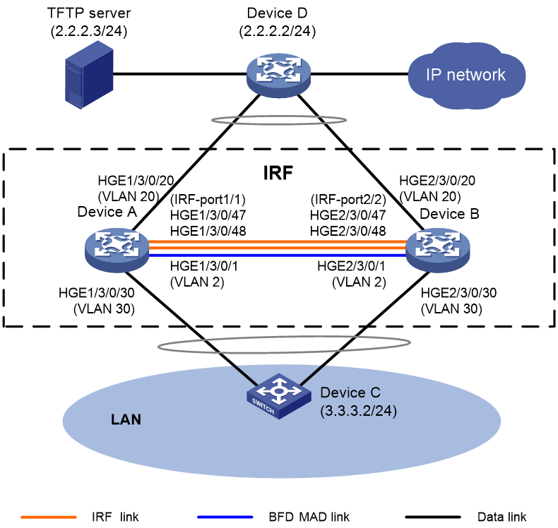

As shown in Figure 1, Device A and Device B are S10500X-G switches. They have set up an IRF fabric. Device A is the master device and its member ID is 1, and Device B is the standby device and its member ID is 2. BFD MAD is used for multi-active collision detection.
The current software version of the IRF fabric is R7753P05. Upgrade the software version to R7753P07. After software upgrade, Device A is still the master device.
Figure 1 Network diagram

To upgrade software on an IRF fabric from the CLI by using the boot loader method:
1.     Shut down all uplink and downlink service interfaces on the master device (Device A) in bulk to switch traffic from Device A to Device B. To enter interface range view, use the interface rang command.
2.     Upgrade software on Device A from the CLI by using the boot loader method and reboot the device. During the reboot, shut down IRF physical interfaces HundredGigE 2/3/0/47 and HundredGigE 2/3/0/48 on Device B. The IRF fabric splits.
CAUTION
CAUTION:
To prevent configuration loss from affecting interface status and causing IRF merge failure or service traffic interruption, do not save the running configuration on any IRF member device when the IRF fabric splits.
To split an IRF fabric, you can remove cables from IRF physical interfaces or shut down all IRF physical interfaces on the standby device. The latter method is simpler. In this example, the latter method is used.
3.     Shut down all uplink and downlink service interfaces on the standby device (Device B) in bulk. Bring up all uplink and downlink service interfaces on Device A to switch service traffic back to Device A.
4.     Upgrade software on Device B. After Device B reboots, Device A and Device B automatically form an IRF fabric.
