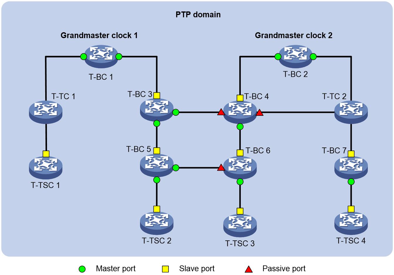

Clock node and PTP port (ITU-T G.8275.1)
A node in a PTP domain is a clock node. A port enabled with PTP is a PTP port.
ITU-T G.8275.1 defines the following types of basic clock nodes:
·     Telecom boundary clock (T-BC)—A clock node with more than one PTP port in a PTP domain for time synchronization. It uses one of the ports to synchronize time to its upstream clock node and uses the other ports to distribute time to the downstream clock nodes. If a T-BC operates as the clock source, it distributes time through multiple PTP ports to its downstream clock nodes.
·     Telecom transparent Clock (T-TC)—A clock code that forwards non-P2P PTP messages in the network. The forwarding duration will be included in calculation of the entire link delay.
·     Telecom time slave clock (T-TSC) —An OC clock node (as defined in IEEE 1588 version 2 and IEEE 802.1AS) that can act only as a member clock.
Figure 1 shows the positions of these basic clock nodes in a PTP domain.
Figure 2 Clock nodes and PTP ports in a PTP domain (ITU-T G.8275.1)

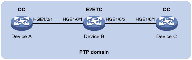

<DeviceA> system-view
[DeviceA] ptp profile 1588v2
# Specify the OC clock node type.
[DeviceA] ptp mode oc
# Create a PTP domain.
[DeviceA] ptp domain 0
# Specify PTP for obtaining the time.
[DeviceA] clock protocol ptp
# Enable PTP on HundredGigE 1/0/1.
[DeviceA] interface hundredgige 1/0/1
[DeviceA-HundredGigE1/0/1] ptp enable
[DeviceA-HundredGigE1/0/1] quit
2.     Configure Device B:
# Specify the IEEE 1588 version 2 PTP profile.
<DeviceB> system-view
[DeviceB] ptp profile 1588v2
# Specify the E2ETC clock node type.
[DeviceB] ptp mode e2etc
[DeviceB] ptp domain 0
[DeviceB] clock protocol ptp
[DeviceB] interface hundredgige 1/0/1
[DeviceB-HundredGigE1/0/1] ptp enable
[DeviceB-HundredGigE1/0/1] quit
# Enable PTP on HundredGigE 1/0/2.
[DeviceB] interface hundredgige 1/0/2
[DeviceB-HundredGigE1/0/2] ptp enable
[DeviceB-HundredGigE1/0/2] quit
3.     Configure Device C:
<DeviceC> system-view
[DeviceC] ptp profile 1588v2
[DeviceC] ptp mode oc
[DeviceC] ptp domain 0
[DeviceC] clock protocol ptp
[DeviceC] interface hundredgige 1/0/1
[DeviceC-HundredGigE1/0/1] ptp enable
[DeviceC-HundredGigE1/0/1] quit
When the network is stable, perform the following tasks to verify that Device A is elected as the GM, HundredGigE1/0/1 on Device A is the master port, and Device B has synchronized to Device A:
·     Use the display ptp clock command to display PTP clock information.
·     Use the display ptp interface brief command to display brief PTP running information for all PTP interfaces.
# Display PTP clock information on Device A.
[DeviceA] display ptp clock
PTP profile         : IEEE 1588 Version 2
PTP mode            : OC
Slave only          : No
Sync uncertain      : Disabled
Clock state         : Disabled
Clock ID            : 000FE2-FFFE-FF0000
Clock type          : Local
Clock domain        : 0
Number of PTP ports : 1
Priority1     : 128
Priority2     : 128
Clock quality :
 Class                 : 248
 Accuracy              : 254
 Offset (log variance) : 65535
Offset from master : 0 (ns)
Mean path delay    : 0 (ns)
Steps removed      : 0
Local clock time   : Sun Jan 15 20:57:29 2019
Clock source info:
 Clock   Pri1 Pri2 Accuracy Class TimeSrc Direction In-Status Offset(log variance)
 Local   128  128  254      248   160     N/A       N/A       65535
 ToD0    128  128  32       6     32      N/A       Inactive  65535
 ToD1    128  128  32       6     32      N/A       Inactive  65535
# Display brief PTP running information for all PTP interfaces on Device A.
[DeviceA] display ptp interface brief
State         Delay mechanism  Clock step  Asymmetry correction  Name
Master        E2E              Two         0                     HGE1/0/1
# Display PTP clock information on Device B.
[DeviceB] display ptp clock
PTP mode            : E2ETC
Slave only          : No
Clock ID            : 000FE2-FFFE-FF0001
Clock type          : Local
Clock domain        : 0
Number of PTP ports : 2
Priority1     : 128
Priority2     : 128
Clock quality :
 Class                 : 248
 Accuracy              : 254
Offset from master  : N/A
Mean path delay     : N/A
Steps removed       : N/A
Clock source info:
# Display brief PTP running information for all PTP interfaces on Device B.
[DeviceB] display ptp interface brief
N/A           E2E              Two         0                     HGE1/0/1
N/A           E2E              Two         0                     HGE1/0/2

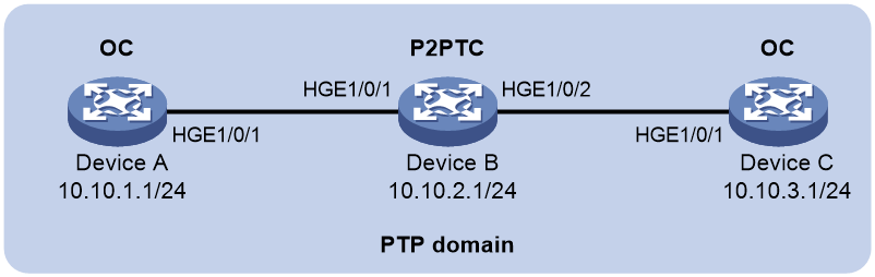

Example: Configuring PTP (IEEE 1588 version 2, IPv4 UDP transport, multicast transmission)
As shown in Figure 6, a PTP domain contains Device A, Device B, and Device C.
·     Configure all devices to use the IEEE 1588 version 2 PTP profile.
·     Configure the source IP address for multicast PTP messages transmitted over IPv4 UDP.
·     Specify the OC clock node type for Device A and Device C, and the P2PTC clock node type for Device B. All clock nodes elect a GM through BMC based on their respective default GM attributes.
·     Configure the peer delay measurement mechanism (p2p) for Device A and Device C.
Figure 6 Network diagram
1.     Configure Device A:
# Configure the source IP address for multicast PTP messages transmitted over IPv4 UDP.
[DeviceA] ptp source 10.10.1.1
# On HundredGigE 1/0/1, specify the IPv4 UDP transport protocol for PTP messages, specify the delay measurement mechanism as p2p, and enable PTP.
[DeviceA-HundredGigE1/0/1] ptp transport-protocol udp [DeviceA-HundredGigE1/0/1] ptp delay-mechanism p2p
# Specify the P2PTC clock node type.
[DeviceB] ptp mode p2ptc
# Configure the source IP address for multicast PTP messages transmitted over UDP.
[DeviceB] ptp source 10.10.2.1
# On HundredGigE 1/0/1, specify the IPv4 UDP transport protocol for PTP messages and enable PTP.
DeviceB-HundredGigE1/0/1] ptp transport-protocol udp
# On HundredGigE 1/0/2, specify the IPv4 UDP transport protocol for PTP messages and enable PTP.
[DeviceB-HundredGigE1/0/2] ptp transport-protocol udp
[DeviceC] ptp source 10.10.3.1
[DeviceC-HundredGigE1/0/1] ptp transport-protocol udp [DeviceC-HundredGigE1/0/1] ptp delay-mechanism p2p
PTP mode            : OC
Slave only          : No
Clock type          : Local
Clock domain        : 0
Priority1     : 128
Priority2     : 128
Clock quality :
 Class                 : 248
 Accuracy              : 254
Steps removed      : 0
Clock source info:
Master        P2P              Two         0                     HGE1/0/1
PTP mode            : P2PTC
Slave only          : No
Clock type          : Local
Clock domain        : 0
Priority1     : 128
Priority2     : 128
Clock quality :
 Class                 : 248
 Accuracy              : 254
Steps removed       : N/A
Clock source info:
N/A           P2P              Two         0                     HGE1/0/1
N/A           P2P              Two         0                     HGE1/0/2

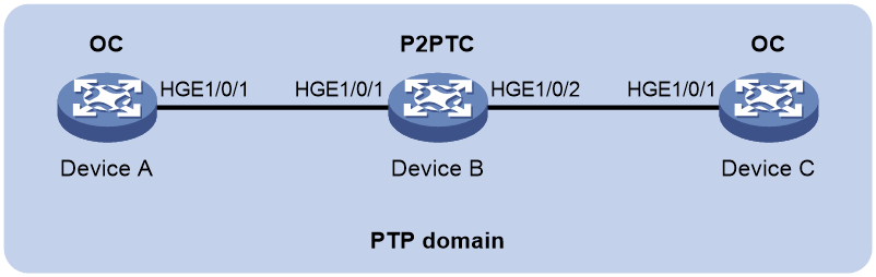

Example: Configuring PTP (IEEE 802.1AS, IEEE 802.3/Ethernet transport, multicast transmission)
As shown in Figure 8, a PTP domain contains Device A, Device B, and Device C.
·     Configure all devices to use the IEEE 802.1AS PTP profile.
·     Use the default peer delay measurement mechanism on all clock nodes in the PTP domain.
Figure 8 Network diagram
IMPORTANT
IMPORTANT:
The IEEE 802.1AS PTP profile transports PTP messages over IEEE 802.3/Ethernet rather than IPv4 UDP and in multicast rather than unicast mode.
# Specify the IEEE 802.1AS PTP profile.
[DeviceA] ptp profile 802.1AS
[DeviceB] ptp profile 802.1AS
# Specify the IEEE 1588 802.1AS PTP profile.
[DeviceC] ptp profile 802.1AS
PTP profile         : IEEE 802.1AS
PTP mode            : OC
Slave only          : No
Clock type          : Local
Clock domain        : 0
Priority1     : 246
Priority2     : 248
Clock quality :
 Class                 : 248
 Accuracy              : 254
 Offset (log variance) : 16640
Steps removed      : 0
Clock source info:
PTP mode            : P2PTC
Slave only          : No
Clock type          : Local
Clock domain        : 0
Priority1     : 246
Priority2     : 248
Clock quality :
 Class                 : 248
 Accuracy              : 254
Steps removed       : N/A
Clock source info:
Example: Configuring PTP (SMPTE ST 2059-2, IPv4 UDP transport, multicast transmission)
As shown in Figure 9, Device A, Device B, and Device C are in a PTP domain. Configure PTP (SMPTE ST 2059-2, multicast transmission) on the three devices as follows for time synchronization:
·     Configure the devices to use the SMPTE ST 2059-2 PTP profile.
·     Use the peer delay measurement mechanism on all clock nodes in the PTP domain.
Figure 9 Network diagram
IMPORTANT
IMPORTANT:
The SMPTE ST 2059-2 PTP profile transports PTP messages over IPv4 UDP rather than IEEE 802.3/Ethernet and in multicast rather than unicast mode.
# Specify the SMPTE ST 2059-2 PTP profile.
[DeviceA] ptp profile st2059-2
# On HundredGigE 1/0/1, specify the delay measurement mechanism as p2p and enable PTP.
[DeviceB] ptp profile st2059-2
# On HundredGigE 1/0/1, enable PTP.
# On HundredGigE 1/0/2, enable PTP.
[DeviceC] ptp profile st2059-2
When the network is stable, perform the following tasks to verify the PTP configuration:
PTP profile         : SMPTE ST 2059-2
PTP mode            : OC
Slave only          : No
Clock type          : Local
Clock domain        : 0
Priority1     : 128
Priority2     : 128
Clock quality :
 Class                 : 248
 Accuracy              : 254
Offset from master  : 106368539000 (ns)
Mean path delay     : 2791000 (ns)
Steps removed       : 1
Clock source info:
PTP mode            : P2PTC
Slave only          : No
Clock type          : Local
Clock domain        : 0

Example: Configuring PTP (SMPTE ST 2059-2, IPv4 UDP transport, unicast transmission)
As shown in Figure 10, configure PTP (SMPTE ST 2059-2, IPv4 UDP transport, unicast transmission) to enable Device A, Device B, Device C, and the base station to synchronize time with the ToD clock source .
·     Specify the SMPTE ST 2059-2 PTP profile and unicast IPv4 UDP transport of PTP messages for Device A, Device B, and Device C.
·     Assign Device A, Device B, Device C, and the base station to PTP domain 0. Specify the BC clock node type for Device A, Device B, and Device C.
·     Connect Device A to the ToD clock source and Device C to the base station.
·     Use the default Request_Response delay measurement mechanism on all clock nodes in the PTP domain.
Figure 10 Network diagram
IMPORTANT
IMPORTANT:
1.     Assign IP addresses to the interfaces, and make sure the devices can reach each other, as shown in Figure 10. (Details not shown.)
2.     Configure Device A:
# Specify the BC clock node type.
[DeviceA] ptp mode bc
# Configure the device to receive ToD 0 clock signals and set the delay correction value to 1000 nanoseconds.
[DeviceA] ptp tod0 input delay 1000
# Set priority 1 to 0 for the ToD 0 clock.
[DeviceA] ptp priority clock-source tod0 priority1 0
# On HundredGigE 1/0/1, configure the destination IP address for unicast PTP messages and enable PTP. (The SMPTE ST 2059-2 PTP profile uses IPv4 UDP transport of PTP messages by default.)
[DeviceA-HundredGigE1/0/1] ptp unicast-destination 10.10.10.2
3.     Configure Device B:
[DeviceB-HundredGigE1/0/1] ptp unicast-destination 10.10.10.1
# On HundredGigE 1/0/2, configure the destination IP address for unicast PTP messages and enable PTP. (The SMPTE ST 2059-2 PTP profile uses IPv4 UDP transport of PTP messages by default.)
[DeviceB-HundredGigE1/0/2] ptp unicast-destination 11.10.10.1
4.     Configure Device C:
[DeviceC] ptp mode bc
[DeviceC-HundredGigE1/0/1] ptp unicast-destination 11.10.10.2
# On HundredGigE1/0/2, configure the destination IP address for unicast PTP messages and enable PTP. (The SMPTE ST 2059-2 PTP profile uses IPv4 UDP transport of PTP messages by default.)
[DeviceC] interface hundredgige 1/0/2
[DeviceC-HundredGigE1/0/2] ptp unicast-destination 12.10.10.1
[DeviceC-HundredGigE1/0/2] ptp enable
[DeviceC-HundredGigE1/0/2] quit
5.     Configure the base station.
# Specify PTP domain 0.
# Specify IPv4 UDP transport of PTP messages.
# Set the destination IP address of unicast PTP messages to 12.10.10.2.
# Specify the Request_Response delay measurement mechanism.
For more information, see the configuration guide for the base station.
·     Use the display ptp interface brief command to display brief PTP running information.
