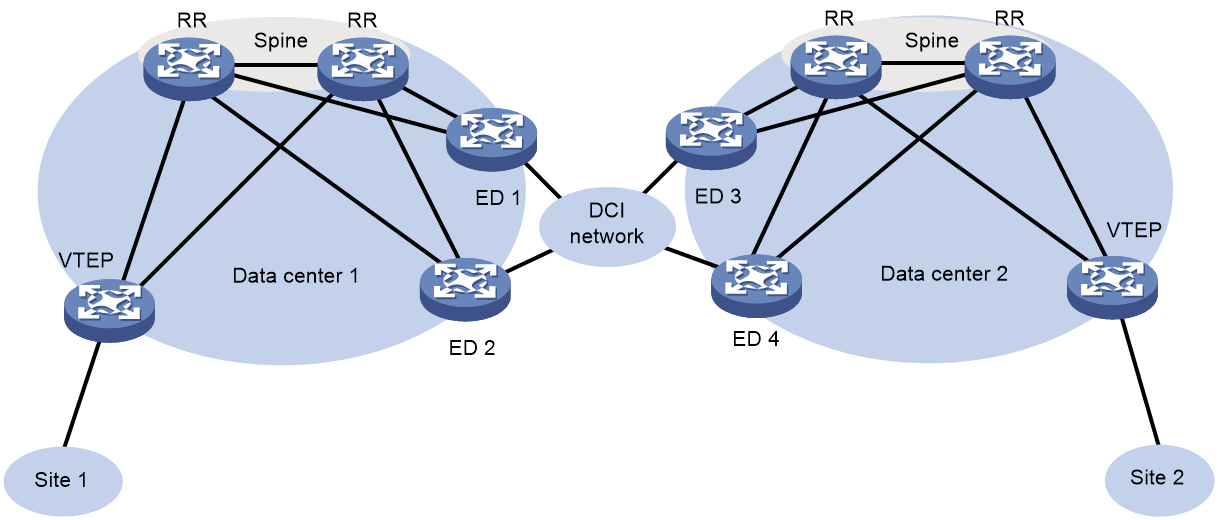

EVPN-DCI network model
As shown in Figure 1, the EVPN-DCI network contains VTEPs and edge devices (EDs) located at the edge of the transport network. A VXLAN tunnel is established between a VTEP and an ED, and a VXLAN-DCI tunnel is established between two EDs. VXLAN-DCI tunnels use VXLAN encapsulation. Each ED de-encapsulates incoming VXLAN packets and re-encapsulates them based on the destination before forwarding the packets through a VXLAN or VXLAN-DCI tunnel.
Figure 1 EVPN-DCI network model

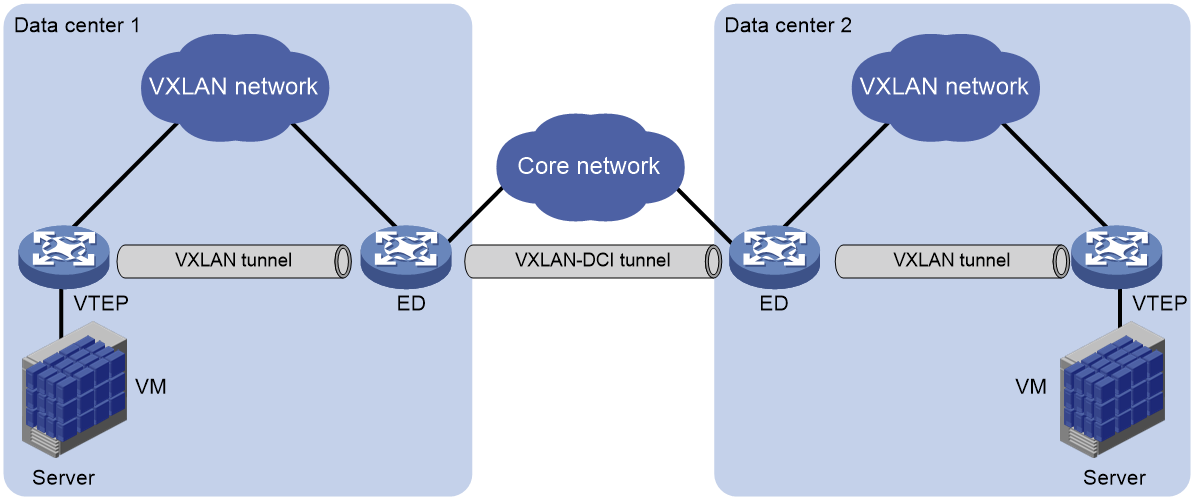

Working mechanisms
In an EVPN-DCI network, BGP EVPN peer relationships are established between EDs and between EDs and VTEPs. When advertising routes to a VTEP or another ED, an ED replaces the routes' nexthop IP address and router MAC address with its IP address and router MAC address.
In an EVPN-DCI network, a VTEP and an ED use a VXLAN tunnel to send traffic, and two EDs use a VXLAN-DCI tunnel to send traffic. An ED de-encapsulates incoming VXLAN packets and re-encapsulates them before forwarding the packets through a VXLAN or VXLAN-DCI tunnel.

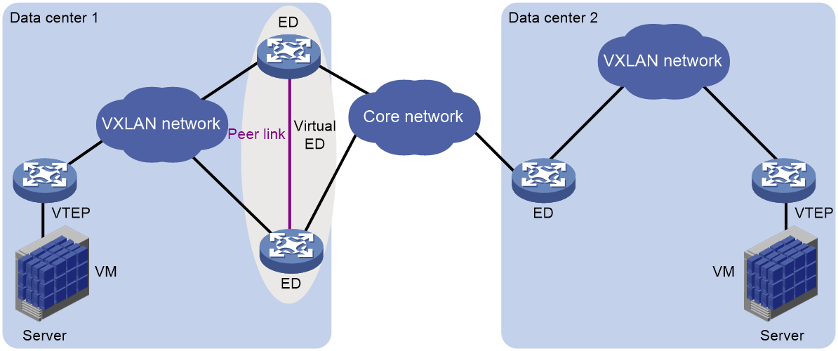

As shown in Figure 3, you can use M-LAG to virtualize two physical EDs of a data center into a virtual ED to prevent single points of failure from interrupting traffic. For more information about M-LAG, see Layer 2—LAN Switching Configuration Guide.
Figure 3 EVPN-DCI M-LAG
EVPN-DCI M-LAG uses the following mechanisms:
·     VM reachability information synchronization—To ensure VM reachability information consistency in the M-LAG system, the member EDs synchronize MAC address entries and ARP or ND information with each other over the peer link. The peer link can only be an Ethernet aggregate link.
·     Virtual ED address—The member EDs use a virtual ED address to set up VXLAN tunnels or VXLAN-DCI tunnels with VTEPs or remote EDs.
·     Independent BGP neighbor relationship establishment—The member EDs use different BGP peer addresses to establish neighbor relationships with remote devices. For load sharing and link redundancy, a neighbor sends traffic destined for the virtual ED address to both of the member EDs through ECMP routes of the underlay network.
The member EDs in an M-LAG system communicate with remote data centers through the transport network. Devices in the dual-homed data center are unaware of the transport network. When the transport-side link fails on one of the member EDs, traffic destined for remote data centers is still sent to that ED. To resolve this issue, Monitor Link is used together with EVPN-DCI M-LAG.

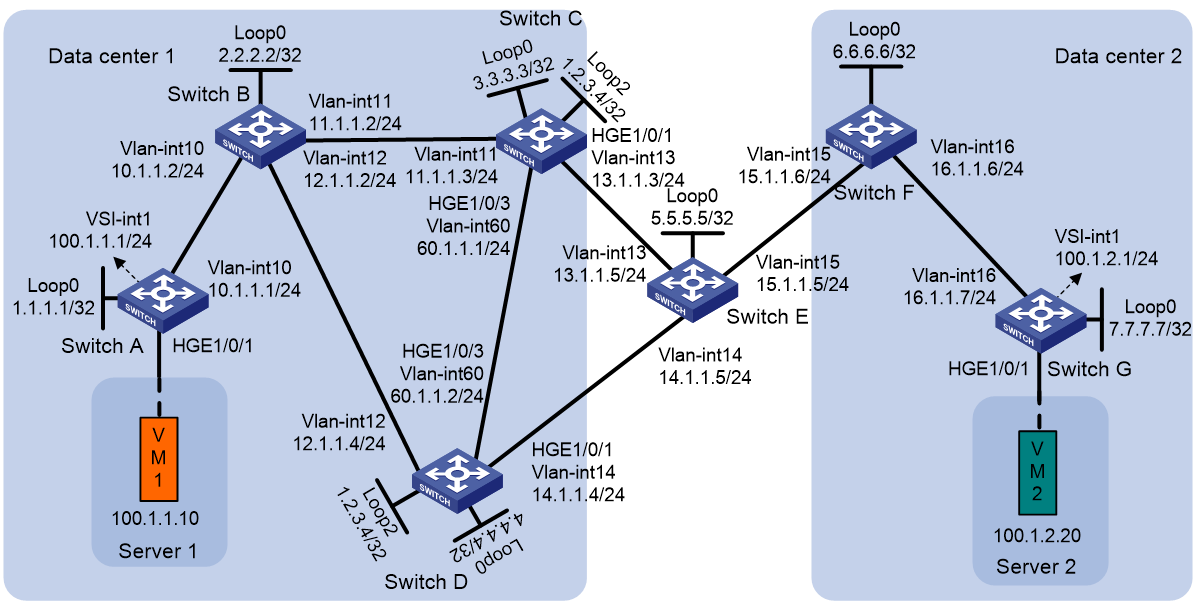

When data centers are interconnected through an MPLS L3VPN network, EVPN EDs also act as MPLS L3VPN PEs. To enable communication between the data centers, you must perform the following tasks on the EDs:
·     Configure both MPLS L3VPN and EVPN.
·     Configure the BGP EVPN address family and the BGP VPNv4 or VPNv6 address family to exchange routes.
Figure 4 Data centers interconnected through an MPLS L3VPN network

Configuring EVPN-DCI dual-homing
For high availability and load sharing, you can deploy two EDs at a data center. To virtualize the redundant EDs into one device, you must configure the same virtual ED address on them.
Do not configure a virtual ED address on the only ED of a data center.
On a redundant ED, the virtual ED address must be the IP address of a loopback interface, and it cannot be the BGP peer IP address of the ED.
Redundant EDs cannot provide access service for local VMs. They can act only as EDs. For correct communication, do not redistribute external routes on only one of the redundant EDs. However, you can redistribute the same external routes on both EDs.
EVPN-DCI dual-homing is mutually exclusive with EVPN distributed relay. Do not use the evpn edge group and evpn m-lag group commands together.
To use EVPN-DCI dual-homing, make sure the overlay and undelay networks are both IPv4 networks or both IPv6 networks.

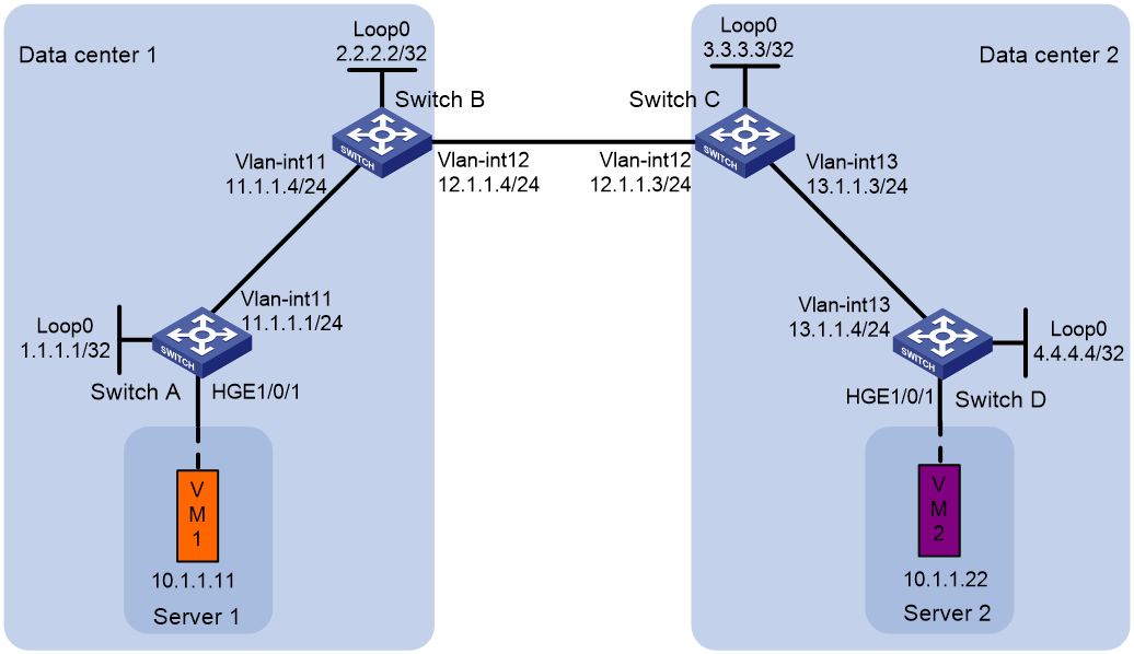

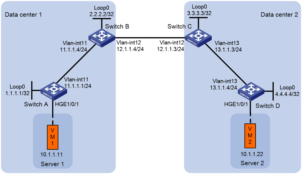

Example: Configuring a basic EVPN-DCI network
As shown in Figure 5:
·     Configure VXLAN 10 on Switch A through Switch D to provide connectivity for the VMs in the data centers.
·     Configure Switch A and Switch D as VTEPs, and configure Switch B and Switch C as EDs.
Figure 5 Network diagram
IMPORTANT
IMPORTANT:
By default, interfaces on the device operate in Layer 3 mode. In this example, you must use the port link-mode command to configure the interfaces that host Ethernet service instances to operate in Layer 2 mode.

Example: Configuring EVPN-DCI intermediate VXLAN mapping
As shown in Figure 6:
·     Configure VXLAN 10 on VTEP Switch A and ED Switch B, and configure VXLAN 30 on VTEP Switch D and ED Switch C.
·     Configure intermediate VXLAN mapping for VXLAN 10 and VXLAN 30 to have Layer 2 connectivity:
¡     Map VXLAN 10 to intermediate VXLAN 500 on Switch B.
¡     Map VXLAN 30 to intermediate VXLAN 500 on Switch C.
Figure 6 Network diagram
IMPORTANT
IMPORTANT:
1.     Configure IP addresses and unicast routing settings:
# Assign IP addresses to interfaces, as shown in Figure 6. (Details not shown.)
# Configure OSPF on the transport network for the switches to reach one another. (Details not shown.)

# Map local VXLAN 10 to intermediate VXLAN 500.
[SwitchB-vsi-vpna-evpn-vxlan] mapping vni 500
[SwitchB-vsi-vpna-evpn-vxlan] quit
[SwitchB-vsi-vpna] quit
# Create VXLAN 500 on VSI vpnb. The switch will replace the VXLAN ID of VXLAN 10's traffic with VXLAN ID 500 when performing Layer 2 forwarding.
[SwitchB] vsi vpnb
[SwitchB-vsi-vpnb] vxlan 500
[SwitchB-vsi-vpnb-vxlan-500] quit
# Create an EVPN instance on VSI vpnb. Configure the switch to automatically generate an RD, and manually configure a route target for the EVPN instance.
[SwitchB-vsi-vpnb] evpn encapsulation vxlan
[SwitchB-vsi-vpnb-evpn-vxlan] route-distinguisher auto
[SwitchB-vsi-vpnb-evpn-vxlan] vpn-target 123:456
[SwitchB-vsi-vpnb-evpn-vxlan] quit
[SwitchB-vsi-vpnb] quit
# Configure BGP to advertise BGP EVPN routes. Enable nexthop replacement for routes advertised to Switch A, and enable router MAC replacement for routes advertised to and received from Switch C.
[SwitchB] bgp 100
[SwitchB-bgp-default] peer 3.3.3.3 as-number 200
[SwitchB-bgp-default] peer 3.3.3.3 connect-interface loopback 0
[SwitchB-bgp-default] peer 3.3.3.3 ebgp-max-hop 64
[SwitchB-bgp-default] peer 1.1.1.1 as-number 100
[SwitchB-bgp-default] peer 1.1.1.1 connect-interface loopback 0
[SwitchB-bgp-default] address-family l2vpn evpn
[SwitchB-bgp-default-evpn] peer 3.3.3.3 enable
[SwitchB-bgp-default-evpn] peer 3.3.3.3 router-mac-local dci
[SwitchB-bgp-default-evpn] peer 1.1.1.1 enable
[SwitchB-bgp-default-evpn] peer 1.1.1.1 next-hop-local
[SwitchB-bgp-default-evpn] quit
[SwitchB-bgp-default] quit
4.     Configure Switch C:
# Enable L2VPN.
<SwitchC> system-view
[SwitchC] l2vpn enable
# Disable remote MAC address learning.
[SwitchC] vxlan tunnel mac-learning disable
# Create VXLAN 30 on VSI vpna.
[SwitchC] vsi vpna
[SwitchC-vsi-vpna] vxlan 30
[SwitchC-vsi-vpna-vxlan-30] quit
# Create an EVPN instance on VSI vpna. Configure the switch to automatically generate an RD and a route target for the EVPN instance.
[SwitchC-vsi-vpna] evpn encapsulation vxlan
[SwitchC-vsi-vpna-evpn-vxlan] route-distinguisher auto
[SwitchC-vsi-vpna-evpn-vxlan] vpn-target auto
# Map local VXLAN 30 to intermediate VXLAN 500.
[SwitchC-vsi-vpna-evpn-vxlan] mapping vni 500
[SwitchC-vsi-vpna-evpn-vxlan] quit
[SwitchC-vsi-vpna] quit
# Create VXLAN 500 on VSI vpnb. The switch will replace the VXLAN ID of VXLAN 30's traffic with VXLAN ID 500 when performing Layer 2 forwarding.
[SwitchC] vsi vpnb
[SwitchC-vsi-vpnb] vxlan 500
[SwitchC-vsi-vpnb-vxlan-500] quit
[SwitchC-vsi-vpnb] evpn encapsulation vxlan
[SwitchC-vsi-vpnb-evpn-vxlan] route-distinguisher auto
[SwitchC-vsi-vpnb-evpn-vxlan] vpn-target 123:456
[SwitchC-vsi-vpnb-evpn-vxlan] quit
[SwitchC-vsi-vpnb] quit
# Configure BGP to advertise BGP EVPN routes. Enable nexthop replacement for routes advertised to Switch D, and enable router MAC replacement for routes advertised to and received from Switch B.
[SwitchC] bgp 200
[SwitchC-bgp-default] peer 2.2.2.2 as-number 100
[SwitchC-bgp-default] peer 2.2.2.2 connect-interface loopback 0
[SwitchC-bgp-default] peer 2.2.2.2 ebgp-max-hop 64
[SwitchC-bgp-default] peer 4.4.4.4 as-number 200
[SwitchC-bgp-default] peer 4.4.4.4 connect-interface loopback 0
[SwitchC-bgp-default] address-family l2vpn evpn
[SwitchC-bgp-default-evpn] peer 2.2.2.2 enable
[SwitchC-bgp-default-evpn] peer 2.2.2.2 router-mac-local dci
[SwitchC-bgp-default-evpn] peer 4.4.4.4 enable
[SwitchC-bgp-default-evpn] peer 4.4.4.4 next-hop-local
[SwitchC-bgp-default-evpn] quit
[SwitchC-bgp-default] quit
5.     Configure Switch D:
# Enable L2VPN.
<SwitchD> system-view
[SwitchD] l2vpn enable
[SwitchD] vxlan tunnel mac-learning disable
[SwitchD] vsi vpna
[SwitchD-vsi-vpna] vxlan 30
[SwitchD-vsi-vpna-vxlan-30] quit
[SwitchD-vsi-vpna] evpn encapsulation vxlan
[SwitchD-vsi-vpna-evpn-vxlan] route-distinguisher auto
[SwitchD-vsi-vpna-evpn-vxlan] vpn-target auto
[SwitchD-vsi-vpna-evpn-vxlan] quit
[SwitchD-vsi-vpna] quit
[SwitchD] bgp 200
[SwitchD-bgp-default] peer 3.3.3.3 as-number 200
[SwitchD-bgp-default] peer 3.3.3.3 connect-interface Loopback 0
[SwitchD-bgp-default] address-family l2vpn evpn
[SwitchD-bgp-default-evpn] peer 3.3.3.3 enable
[SwitchD-bgp-default-evpn] quit
[SwitchD-bgp-default] quit
# On HundredGigE 1/0/1, create Ethernet service instance 1000 to match VLAN 200.
[SwitchD] interface hundredgige 1/0/1
[SwitchD-HundredGigE1/0/1] service-instance 1000
[SwitchD-HundredGigE1/0/1-srv1000] encapsulation s-vid 200
# Map Ethernet service instance 1000 to VSI vpna.
[SwitchD-HundredGigE1/0/1-srv1000] xconnect vsi vpna
[SwitchD-HundredGigE1/0/1-srv1000] quit
1.     Verify the configuration on EDs. (This example uses Switch B.)
# Verify that the ED has discovered Switch A and Switch C through IMET routes and has established VXLAN and VXLAN-DCI tunnels to the switches.
[SwitchB] display evpn auto-discovery imet

2.     Verify that VM 1 and VM 2 can communicate. (Details not shown.)
Example: Configuring EVPN-DCI IPv4 Layer 3 communication
As shown in Figure 7:
·     Configure VXLAN 10 for data center 1, and configure VXLAN 20 for data center 2.
·     Configure Switch A and Switch D as distributed EVPN gateways to perform Layer 3 forwarding between VXLAN 10 and VXLAN 20.
·     Configure Switch B and Switch C as EDs.
Figure 7 Network diagram
IMPORTANT
IMPORTANT:
# On VM 1, specify 10.1.1.1 as the gateway address. On VM 2, specify 10.1.2.1 as the gateway address. (Details not shown.)
# Assign IP addresses to interfaces, as shown in Figure 7. (Details not shown.)
2.     Configure Switch A:
# Enable L2VPN.
<SwitchA> system-view
[SwitchA] l2vpn enable
# Disable remote MAC address learning and remote ARP learning.
[SwitchA] vxlan tunnel mac-learning disable
[SwitchA] vxlan tunnel arp-learning disable
# Create VXLAN 10 on VSI vpna.
[SwitchA] vsi vpna
[SwitchA-vsi-vpna] vxlan 10
[SwitchA-vsi-vpna-vxlan-10] quit
[SwitchA-vsi-vpna] evpn encapsulation vxlan
[SwitchA-vsi-vpna-evpn-vxlan] route-distinguisher auto
[SwitchA-vsi-vpna-evpn-vxlan] vpn-target auto
[SwitchA-vsi-vpna-evpn-vxlan] quit
[SwitchA-vsi-vpna] quit
[SwitchA] bgp 100
[SwitchA-bgp-default] peer 2.2.2.2 as-number 100
[SwitchA-bgp-default] peer 2.2.2.2 connect-interface loopback 0
[SwitchA-bgp-default] address-family l2vpn evpn
[SwitchA-bgp-default-evpn] peer 2.2.2.2 enable
[SwitchA-bgp-default-evpn] quit
[SwitchA-bgp-default] quit
# On HundredGigE 1/0/1, create Ethernet service instance 1000 to match VLAN 100.
[SwitchA] interface hundredgige 1/0/1
[SwitchA-HundredGigE1/0/1] service-instance 1000
[SwitchA-HundredGigE1/0/1-srv1000] encapsulation s-vid 100
[SwitchA-HundredGigE1/0/1-srv1000] xconnect vsi vpna
[SwitchA-HundredGigE1/0/1-srv1000] quit
# Configure RD and route target settings for VPN instance vpn1.
[SwitchA] ip vpn-instance vpn1
[SwitchA-vpn-instance-vpn1] route-distinguisher 1:1
[SwitchA-vpn-instance-vpn1] address-family ipv4
[SwitchA-vpn-ipv4-vpn1] vpn-target 2:2
[SwitchA-vpn-ipv4-vpn1] quit
[SwitchA-vpn-instance-vpn1] address-family evpn
[SwitchA-vpn-evpn-vpn1] vpn-target 1:1
[SwitchA-vpn-evpn-vpn1] quit
[SwitchA-vpn-instance-vpn1] quit
# Configure VSI-interface 1 as a distributed gateway.
[SwitchA] interface vsi-interface 1
[SwitchA-Vsi-interface1] ip binding vpn-instance vpn1
[SwitchA-Vsi-interface1] ip address 10.1.1.1 255.255.255.0
[SwitchA-Vsi-interface1] mac-address 1-1-1
[SwitchA-Vsi-interface1] distributed-gateway local
[SwitchA-Vsi-interface1] quit
# Create VSI-interface 2. Associate VSI-interface 2 with VPN instance vpn1, and configure the L3 VXLAN ID as 1000 for the VPN instance.
[SwitchA] interface vsi-interface 2
[SwitchA-Vsi-interface2] ip binding vpn-instance vpn1
[SwitchA-Vsi-interface2] l3-vni 1000
[SwitchA-Vsi-interface2] quit
# Specify VSI-interface 1 as the gateway interface for VSI vpna.
[SwitchA] vsi vpna
[SwitchA-vsi-vpna] gateway vsi-interface 1
3.     Configure Switch B:

Example: Configuring EVPN-DCI dual-homing
As shown in Figure 8:
·     Configure Switch A and Switch G as distributed EVPN gateways to perform Layer 3 forwarding between VXLAN 10 and VXLAN 20.
·     Configure Switch C and Switch D as EDs of data center 1, and configure Switch F as the ED of data center 2.
·     Configure Switch B as an RR.
This example provides configuration of IPv4 sites over an IPv4 underlay network. The configuration procedure does not differ between IPv4 and IPv6 sites or underlay networks.
Figure 8 Network diagram
# On VM 1, specify 100.1.1.1 as the gateway address. On VM 2, specify 100.1.2.1 as the gateway address. (Details not shown.)
# Assign IP addresses to the interfaces, as shown in Figure 8. (Details not shown.)
# Configure OSPF for the switches to reach one another. (Details not shown.)
# Enable L2VPN.
[SwitchA] vsi vpna
[SwitchA] bgp 100
[SwitchA-Vsi-interface1] ip address 100.1.1.1 255.255.255.0
[SwitchA] vsi vpna
3.     Configure Switch B as an RR.
<SwitchB> system-view
[SwitchB] bgp 100
[SwitchB-bgp-default] group evpn internal
[SwitchB-bgp-default] peer evpn connect-interface loopback 0
[SwitchB-bgp-default] peer 1.1.1.1 group evpn
[SwitchB-bgp-default] peer 3.3.3.3 group evpn
[SwitchB-bgp-default] peer 4.4.4.4 group evpn
[SwitchB-bgp-default-evpn] undo policy vpn-target
[SwitchB-bgp-default-evpn] peer evpn enable
[SwitchB-bgp-default-evpn] peer evpn reflect-client
# Enable L2VPN.
[SwitchC] vxlan tunnel arp-learning disable
# Configure BGP to advertise BGP EVPN routes. Enable nexthop replacement for routes advertised to Switch B, and enable router MAC replacement for routes advertised to and received from Switch F.
[SwitchC] bgp 100
[SwitchC-bgp-default] peer 6.6.6.6 as-number 200
[SwitchC-bgp-default] peer 6.6.6.6 connect-interface loopback 0
[SwitchC-bgp-default] peer 6.6.6.6 ebgp-max-hop 64
[SwitchC-bgp-default-evpn] peer 6.6.6.6 enable
[SwitchC-bgp-default-evpn] peer 6.6.6.6 router-mac-local dci
[SwitchC-bgp-default-evpn] peer 2.2.2.2 next-hop-local
[SwitchC] ip vpn-instance vpn1
[SwitchC-vpn-instance-vpn1] route-distinguisher 1:2
[SwitchC-vpn-instance-vpn1] address-family ipv4
[SwitchC-vpn-ipv4-vpn1] vpn-target 2:2
[SwitchC-vpn-ipv4-vpn1] quit
[SwitchC-vpn-instance-vpn1] address-family evpn
[SwitchC-vpn-evpn-vpn1] vpn-target 1:1
[SwitchC-vpn-evpn-vpn1] quit
[SwitchC-vpn-instance-vpn1] quit
[SwitchC] interface vsi-interface 2
[SwitchC-Vsi-interface2] ip binding vpn-instance vpn1
[SwitchC-Vsi-interface2] l3-vni 1000
[SwitchC-Vsi-interface2] mac-address 1-2-3
[SwitchC-Vsi-interface2] quit
# Configure 1.2.3.4 as the virtual ED address, and assign the IP address to Loopback 2. Configure OSPF to advertise the virtual ED address.
[SwitchC] evpn edge group 1.2.3.4
[SwitchC] interface loopback 2
[SwitchC-LoopBack2] ip address 1.2.3.4 32
[SwitchC-LoopBack2] quit
[SwitchC] ospf
[SwitchC-ospf-1] area 0
[SwitchC-ospf-1-area-0.0.0.0] network 1.2.3.4 0.0.0.0
[SwitchC-ospf-1-area-0.0.0.0] quit
[SwitchC-ospf-1] quit
# Configure monitor link group 1 to associate HundredGigE 1/0/1 with Loopback 0 and Loopback 2. Set the switchover delay for the downlink interface to 90 seconds.
[SwitchC] undo monitor-link disable
[SwitchC] monitor-link group 1
[SwitchC-mtlk-group1] port hundredgige 1/0/1 uplink
[SwitchC-mtlk-group1] port loopback 0 downlink
[SwitchC-mtlk-group1] port loopback 2 downlink
[SwitchC-mtlk-group1] downlink up-delay 90

Example: Configuring EVPN-DCI M-LAG
As shown in Figure 9:
·     For data center 1, configure Switch C and Switch D as EDs and use M-LAG to virtualize them into one device.
·     For data center 2, configure Switch F as an ED.
Figure 9 Network diagram
# Assign IP addresses to interfaces, as shown in Figure 9. (Details not shown.)
[SwitchA] vsi vpna
[SwitchB] bgp 100
# Enable L2VPN.
# Specify the virtual VTEP address as 1.2.3.4.
[SwitchA] evpn m-lag group 1.2.3.4
# Configure M-LAG system parameters.
[SwitchC] m-lag system-mac 0001-0001-0001
[SwitchC] m-lag system-number 1
[SwitchC] m-lag system-priority 10
[SwitchC] m-lag keepalive ip destination 60.1.1.1 source 60.1.1.2
[SwitchC] m-lag restore-delay 180
# Create Layer 2 dynamic aggregate interface Bridge-Aggregation 3.
[SwitchC] interface bridge-aggregation 3
[SwitchC-Bridge-Aggregation3] link-aggregation mode dynamic
[SwitchC-Bridge-Aggregation3] quit
# Assign HundredGigE 1/0/3 to aggregation group 3.
[SwitchC] interface hundredgige 1/0/3
[SwitchC-HundredGigE1/0/3] port link-aggregation group 3
[SwitchC-HundredGigE1/0/3] quit
# Specify Bridge-Aggregation 3 as the peer-link interface.
[SwitchC-Bridge-Aggregation3] port m-lag peer-link 1
[SwitchC] bgp 100
[SwitchC-bgp-default-evpn] nexthop evpn-m-lag group-address
[SwitchC-mtlk-group1] quit
# Enable L2VPN.
[SwitchD] vxlan tunnel arp-learning disable
[SwitchD] evpn m-lag group 1.2.3.4
[SwitchD] m-lag system-mac 0001-0001-0001
[SwitchD] m-lag system-number 2
[SwitchD] m-lag system-priority 10
[SwitchD] m-lag keepalive ip destination 60.1.1.1 source 60.1.1.2
[SwitchD] m-lag restore-delay 180
[SwitchD] interface bridge-aggregation 3
[SwitchD-Bridge-Aggregation3] link-aggregation mode dynamic
[SwitchD-Bridge-Aggregation3] quit
# Assign HundredGigE 1/0/3 to link aggregation group 3.
[SwitchD] interface hundredgige 1/0/3
[SwitchD-HundredGigE1/0/3] port link-aggregation group 3
[SwitchD-HundredGigE1/0/3] quit
[SwitchD-Bridge-Aggregation3] port m-lag peer-link 1
[SwitchD] bgp 100
[SwitchD-bgp-default] peer 6.6.6.6 as-number 200
[SwitchD-bgp-default] peer 6.6.6.6 connect-interface loopback 0
[SwitchD-bgp-default] peer 6.6.6.6 ebgp-max-hop 64
[SwitchD-bgp-default] peer 2.2.2.2 as-number 100
[SwitchD-bgp-default] peer 2.2.2.2 connect-interface loopback 0
[SwitchD-bgp-default-evpn] nexthop evpn-m-lag group-address
[SwitchD-bgp-default-evpn] peer 6.6.6.6 enable
[SwitchD-bgp-default-evpn] peer 6.6.6.6 router-mac-local dci
[SwitchD-bgp-default-evpn] peer 2.2.2.2 enable
[SwitchD-bgp-default-evpn] peer 2.2.2.2 next-hop-local
[SwitchD] ip vpn-instance vpn1
[SwitchD-vpn-instance-vpn1] route-distinguisher 1:2
[SwitchD-vpn-instance-vpn1] address-family ipv4
[SwitchD-vpn-ipv4-vpn1] vpn-target 2:2
[SwitchD-vpn-ipv4-vpn1] quit
[SwitchD-vpn-instance-vpn1] address-family evpn
[SwitchD-vpn-evpn-vpn1] vpn-target 1:1
[SwitchD-vpn-evpn-vpn1] quit
[SwitchD-vpn-instance-vpn1] quit
[SwitchD] interface vsi-interface 2
[SwitchD-Vsi-interface2] ip binding vpn-instance vpn1
[SwitchD-Vsi-interface2] l3-vni 1000
[SwitchD-Vsi-interface2] mac-address 1-2-3
[SwitchD-Vsi-interface2] quit
[SwitchD] undo monitor-link disable
[SwitchD] monitor-link group 1
[SwitchD-mtlk-group1] port hundredgige 1/0/1 uplink
[SwitchD-mtlk-group1] port loopback 0 downlink
[SwitchD-mtlk-group1] port loopback 2 downlink
[SwitchD-mtlk-group1] downlink up-delay 90
[SwitchD-mtlk-group1] quit
6.     Configure Switch F:
# Enable L2VPN.
<SwitchF> system-view
[SwitchF] l2vpn enable
[SwitchF] vxlan tunnel mac-learning disable
[SwitchF] vxlan tunnel arp-learning disable
# Configure BGP to advertise BGP EVPN routes. Enable nexthop replacement for routes advertised to Switch G, and enable router MAC replacement for routes advertised to and received from Switch C and Switch D.
[SwitchF] bgp 200
[SwitchF-bgp-default] peer 3.3.3.3 as-number 100
[SwitchF-bgp-default] peer 3.3.3.3 connect-interface loopback 0
[SwitchF-bgp-default] peer 3.3.3.3 ebgp-max-hop 64
[SwitchF-bgp-default] peer 4.4.4.4 as-number 100
[SwitchF-bgp-default] peer 4.4.4.4 connect-interface loopback 0
[SwitchF-bgp-default] peer 4.4.4.4 ebgp-max-hop 64
[SwitchF-bgp-default] peer 7.7.7.7 as-number 200
[SwitchF-bgp-default] peer 7.7.7.7 connect-interface loopback 0
[SwitchF-bgp-default] address-family l2vpn evpn
[SwitchF-bgp-default-evpn] peer 3.3.3.3 enable
[SwitchF-bgp-default-evpn] peer 3.3.3.3 router-mac-local dci
[SwitchF-bgp-default-evpn] peer 4.4.4.4 enable
[SwitchF-bgp-default-evpn] peer 4.4.4.4 router-mac-local dci
[SwitchF-bgp-default-evpn] peer 7.7.7.7 enable
[SwitchF-bgp-default-evpn] peer 7.7.7.7 next-hop-local
[SwitchF-bgp-default-evpn] quit
[SwitchF-bgp-default] quit
[SwitchF] ip vpn-instance vpn1
[SwitchF-vpn-instance-vpn1] route-distinguisher 1:4
[SwitchF-vpn-instance-vpn1] address-family ipv4
[SwitchF-vpn-ipv4-vpn1] vpn-target 2:2
[SwitchF-vpn-ipv4-vpn1] quit
[SwitchF-vpn-instance-vpn1] address-family evpn
[SwitchF-vpn-evpn-vpn1] vpn-target 1:1
[SwitchF-vpn-evpn-vpn1] quit
[SwitchF-vpn-instance-vpn1] quit
[SwitchF] interface vsi-interface 2
[SwitchF-Vsi-interface2] ip binding vpn-instance vpn1
[SwitchF-Vsi-interface2] l3-vni 1000
[SwitchF-Vsi-interface2] quit
7.     Configure Switch G:
# Enable L2VPN.
<SwitchG> system-view
[SwitchG] l2vpn enable
[SwitchG] vxlan tunnel mac-learning disable
[SwitchG] vxlan tunnel arp-learning disable
# Create VXLAN 20 on VSI vpnb.
[SwitchG] vsi vpnb
[SwitchG-vsi-vpnb] vxlan 20
[SwitchG-vsi-vpnb-vxlan-20] quit
# Create an EVPN instance on VSI vpnb. Configure the switch to automatically generate an RD and a route target for the EVPN instance.
[SwitchG-vsi-vpnb] evpn encapsulation vxlan
[SwitchG-vsi-vpnb-evpn-vxlan] route-distinguisher auto
[SwitchG-vsi-vpnb-evpn-vxlan] vpn-target auto
[SwitchG-vsi-vpnb-evpn-vxlan] quit
[SwitchG-vsi-vpnb] quit
[SwitchG] bgp 200
[SwitchG-bgp-default] peer 6.6.6.6 as-number 200
[SwitchG-bgp-default] peer 6.6.6.6 connect-interface loopback 0
[SwitchG-bgp-default] address-family l2vpn evpn
[SwitchG-bgp-default-evpn] peer 6.6.6.6 enable
[SwitchG-bgp-default-evpn] quit
[SwitchG-bgp-default] quit
# On HundredGigE 1/0/1, create Ethernet service instance 2000 to match VLAN 200.
[SwitchG] interface hundredgige 1/0/1
[SwitchG-HundredGigE1/0/1] service-instance 2000
[SwitchG-HundredGigE1/0/1-srv2000] encapsulation s-vid 200
# Map Ethernet service instance 2000 to VSI vpnb.
[SwitchG-HundredGigE1/0/1-srv2000] xconnect vsi vpnb
[SwitchG-HundredGigE1/0/1-srv2000] quit
[SwitchG] ip vpn-instance vpn1
[SwitchG-vpn-instance-vpn1] route-distinguisher 1:4
[SwitchG-vpn-instance-vpn1] address-family ipv4
[SwitchG-vpn-ipv4-vpn1] vpn-target 2:2
[SwitchG-vpn-ipv4-vpn1] quit
[SwitchG-vpn-instance-vpn1] address-family evpn
[SwitchG-vpn-evpn-vpn1] vpn-target 1:1
[SwitchG-vpn-evpn-vpn1] quit
[SwitchG-vpn-instance-vpn1] quit
[SwitchG] interface vsi-interface 1
[SwitchG-Vsi-interface1] ip binding vpn-instance vpn1
[SwitchG-Vsi-interface1] ip address 100.1.2.1 255.255.255.0
[SwitchG-Vsi-interface1] mac-address 2-2-2
[SwitchG-Vsi-interface1] distributed-gateway local
[SwitchG-Vsi-interface1] quit
[SwitchG] interface vsi-interface 2
[SwitchG-Vsi-interface2] ip binding vpn-instance vpn1
[SwitchG-Vsi-interface2] l3-vni 1000
[SwitchG-Vsi-interface2] quit
# Specify VSI-interface 1 as the gateway interface for VSI vpnb.
[SwitchG] vsi vpnb
[SwitchG-vsi-vpnb] gateway vsi-interface 1
1.     Verify the configuration on EDs. (This example uses Switch C.)
# Verify that the ED has discovered Switch A and Switch F through MAC/IP advertisement routes and IP prefix advertisement routes, and has established VXLAN and VXLAN-DCI tunnels to the switches.
[SwitchC] display evpn auto-discovery macip-prefix
Destination IP  Source IP       L3VNI           Tunnel mode OutInterface
1.1.1.1         3.3.3.3         1000            VXLAN       Vsi-interface2
6.6.6.6         3.3.3.3         1000            VXLAN-DCI   Vsi-interface2
# Verify that the VXLAN and VXLAN-DCI tunnels on the ED are up.
[SwitchC] display interface tunnel
Tunnel0
Current state: UP
Line protocol state: UP
Description: Tunnel0 Interface
Bandwidth: 64 kbps
Maximum transmission unit: 1464
Internet protocol processing: Disabled
Output queue - Urgent queuing: Size/Length/Discards 0/100/0
Output queue - Protocol queuing: Size/Length/Discards 0/500/0
Output queue - FIFO queuing: Size/Length/Discards 0/75/0
Last clearing of counters: Never
Tunnel source 1.2.3.4, destination 1.1.1.1
Tunnel protocol/transport UDP_VXLAN/IP
Last 300 seconds input rate: 0 bytes/sec, 0 bits/sec, 0 packets/sec

# Verify that the ED has ARP entries and routes for the VMs.
[SwitchC] display ip routing-table vpn-instance vpn1
Destinations : 4        Routes : 4
Destination/Mask   Proto   Pre Cost        NextHop         Interface
100.1.1.0/24       BGP     255 0           1.1.1.1         Vsi2
100.1.1.10/32      BGP     255 0           1.1.1.1         Vsi2
100.1.2.0/24       BGP     255 0           6.6.6.6         Vsi2
100.1.2.20/32      BGP     255 0           6.6.6.6         Vsi2
2.     Verify the configuration on Switch A:
# Verify that the switch has discovered the virtual ED through MAC/IP advertisement routes and IP prefix advertisement routes, and has established a VXLAN tunnel to the virtual ED.
[SwitchA] display evpn auto-discovery macip-prefix
1.2.3.4         1.1.1.1         1000            VXLAN       Vsi-interface2
# Verify that the VXLAN tunnel on the switch is up.
[SwitchA] display interface tunnel
Tunnel0
Current state: UP
Bandwidth: 64 kbps
Tunnel source 1.1.1.1, destination 1.2.3.4
Last 300 seconds output rate: 0 bytes/sec, 0 bits/sec, 0 packets/sec
Input: 0 packets, 0 bytes, 0 drops
Output: 0 packets, 0 bytes, 0 drops
# Verify that the switch has ARP entries and routes for the VMs.
[SwitchA] display ip routing-table vpn-instance vpn1
100.1.2.0/24       BGP     255 0           1.2.3.4         Vsi2
100.1.2.10/32      BGP     255 0           1.2.3.4         Vsi2
3.     Verify that VM 1 and VM 2 can communicate when both Switch C and Switch D are working correctly and when Switch C or Switch D fails. (Details not shown.)
