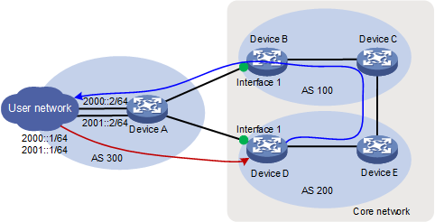

Benefits
As shown in Figure 1, asymmetric routing might occur in an IPv6 multiple-access network. The outgoing interface for a return packet might be different from the incoming interface of the original packet. You can enable strict uRPF check on interface 1 of Device B to prevent attacks with spoofed source IPv6 addresses. However, strict uRPF check might determine that a valid packet from the LAN as an attack packet based on local routing information, which causes unexpected packet drop.
Compared with uRPF, SAVA can not only prevent source IPv6 address spoofing attacks but also avoid mistaken packet drop caused by asymmetric routing. When SAVA is enabled on interface 1 of both Device A and Device B, the devices can create SAVA entries based on local routes and remote routes synchronized from other routing protocols. In this way, both the devices have consistent SAVA entries. This ensures that packets of valid users will not be mistakenly dropped on either a asymmetric network or a symmetric network with asymmetric routing.

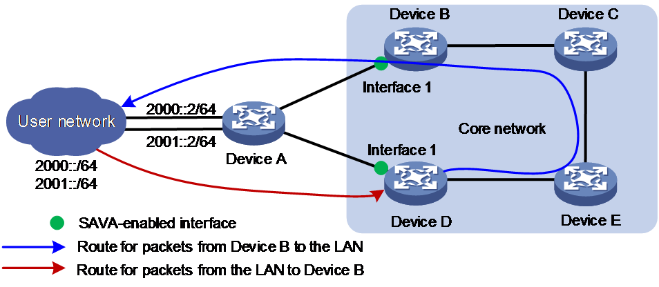

Deployed on intra-AS border devices indirectedly connected to the LAN
As shown in Figure 3, asymmetric traffic exists between Device D and the LAN after route convergence. Traffic from Device D to the LAN will traverse Device E, Device C, Device B, and Device A. Traffic from the LAN to Device D will traverse only Device A.
You can configure SAVA on interface 1 of both Device B and Device D. Device B and Device D synchronize routes with each other, obtain prefix information of the LAN based on the synchronized remote routes, and then create SAVA entries. Upon receiving a packet from a user in the LAN, Device C will permit the packet because a matching SAVA entry exists.
Figure 3 SAVA deployed on intra-AS border devices indirectly connected to the LAN

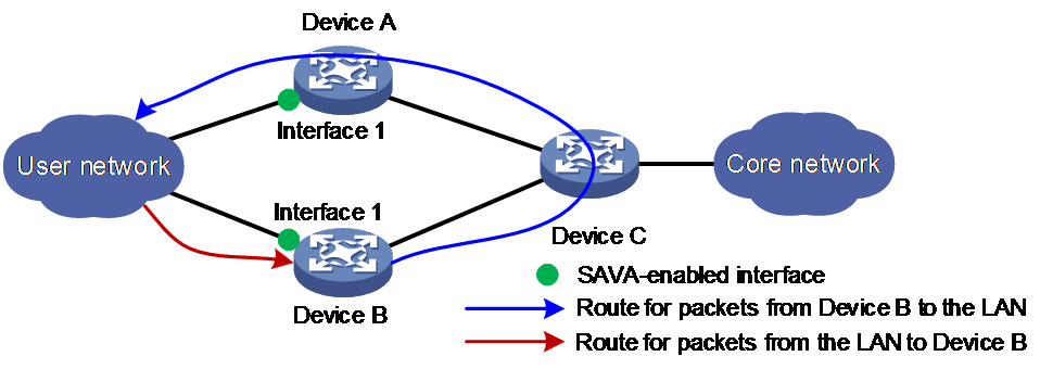

Deployed on inter-AS border devices indirectedly connected to the LAN
As shown in Figure 4, asymmetric traffic exists between Device D and the LAN after route convergence. Traffic from Device D to the LAN will traverse Device E, Device C, Device B, and Device A. Traffic from the LAN to Device D will traverse only Device A.
You can configure SAVA on interface 1 of both Device B and Device D. Device B and Device C in AS 100 as well as Device D and Device E in AS 200 synchronize local routes with each other through an IGP protocol (OSPFv3, for example). Then, Device C in AS 100 and Device E in AS 200 synchronize routes with each other through BGP. Upon receiving a packet from a user in the LAN, Device C will permit the packet because a matching SAVA entry exists.
Figure 4 SAVA deployed on inter-AS border devices indirectly connected to the LAN

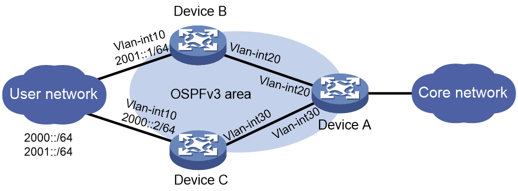

SAVA configuration examples
Configuring SAVA on border devices directly connected the LAN
As shown in Figure 5, legal users in the LAN use prefixes 2000::/64 and 2001::/64. Configure SAVA on VLAN-interface 10 of Device B and Device C to meet the following requirements:
Device C creates a SAVA entry upon receiving an IPv6 route with prefix 2001::/64.
The LAN-side interface on Device C filters packets from users in the LAN based on SAVA entries.
Figure 5 Network diagram

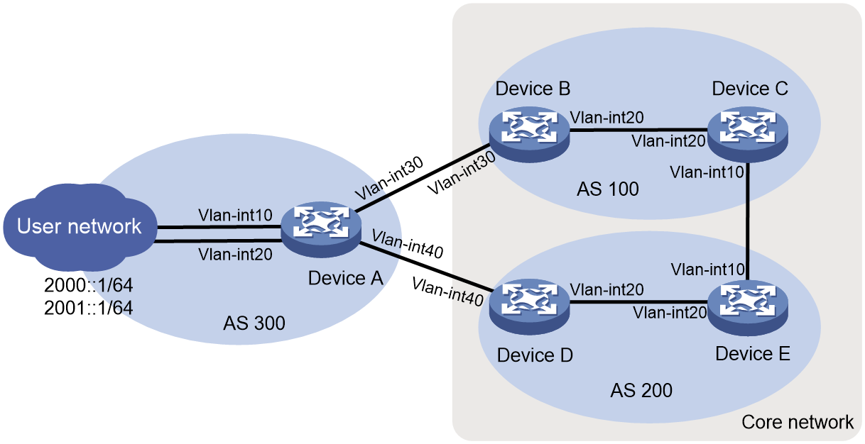

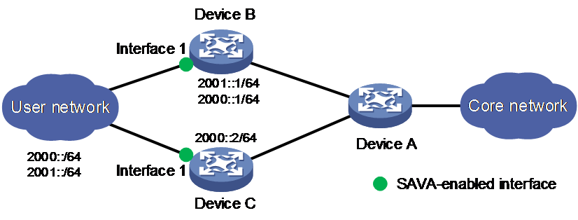

Configuring SAVA on border devices indirectly connected the LAN (OSPFv3)
As shown in Figure 6, OSPFv3 runs on the core network. Configure the devices to meet the following requirements:
Enable SAVA on VLAN-interface 30 of Device B and VLAN-interface 40 on Device D to filter packets based on SAVA entries.
On Device C, configure a static route to the LAN with next-hop device Device A. Enable OSPFv3 link tag inheritance to statically tag routes to the LAN.
Configure OSPFv3 on Device B and Device A to synchronize routes to the LAN. Enable OSPFv3 link tag inheritance and set the OSPFv3 link tag to dynamically tag routes to the LAN.
Figure 6 Network diagram

[DeviceA-Vlan-interface130] quit
2.     Configure Device B:
# Configure OSPFv3.
<DeviceB> system-view
[DeviceB] ospfv3 1
[DeviceB-ospfv3-1] router-id 2.2.2.2
[DeviceB-ospfv3-1] quit
[DeviceB] interface vlan-interface 30
[DeviceB-Vlan-interface30] ospfv3 1 area 0.0.0.0
[DeviceB-Vlan-interface30] quit
[DeviceB] interface vlan-interface 20
[DeviceB- Vlan-interface20] ospfv3 1 area 0.0.0.0
[DeviceB- Vlan-interface20] quit
# Enable OSPFv3 link tag inheritance.
[DeviceB] ospfv3 1
[DeviceB-ospfv3-1] link-tag inherit enable
# Set the OSPFv3 link tag for VLAN-interface 30 to 100.
[DeviceB-Vlan-interface30] ospfv3 link-tag 100
# Enable SAVA on VLAN-interface 30.
[DeviceB-Vlan-interface30] ipv6 sava enable
# Configure VLAN-interface 30 to redistribute remote routes with route tag 100.
[DeviceB-Vlan-interface30] ipv6 sava import remote-route-tag 100
3.     Configure Device D:
# Configure a static route, whose destination address is 2000:: /64, next hop address is FE80::1 (a link-local IPv6 address on Device A), and tag value is 100.
<DeviceD> system-view
[DeviceD] ipv6 route-static 2000:: 64 vlan-interface 40 FE80::1 tag 100
# Configure routing policy named sava, configure node 10 in permit mode to permit routes with the output interface VLAN-interface 40.
[DeviceD] route-policy sava permit node 10
[DeviceD-route-policy-sava-10] if-match interface vlan-interface 40
[DeviceD-route-policy-sava-10] quit
# Configure OSPFv3.
[DeviceD] ospfv3 1
[DeviceD-ospfv3-1] router-id 4.4.4.4
[DeviceD-ospfv3-1] quit
[DeviceD] interface vlan-interface 20
[DeviceD-Vlan-interface20] ospfv3 1 area 0.0.0.0
[DeviceD- Vlan-interface20] quit
# Configure OSPFv3 process 1 to redistribute direct routes permitted by routing policy sava.
[DeviceD] ospfv3 1
[DeviceD-ospfv3-1] import-route static route-policy sava
[DeviceD-ospfv3-1] link-tag inherit enable
# Enable SAVA on VLAN-interface 40.
[DeviceD] interface vlan-interface 40
[DeviceD-Vlan-interface40] ipv6 sava enable
# Configure VLAN-interface 40 to redistribute remote routes with route tag 100.
[DeviceD-Vlan-interface40] ipv6 sava import remote-route-tag 100
[DeviceD-Vlan-interface40] quit
4.     Configure Device C:
# Configure OSPFv3.
<DeviceC> system-view
[DeviceC] ospfv3 1
[DeviceC-ospfv3-1] router-id 3.3.3.3
[DeviceC-ospfv3-1] quit
[DeviceC] interface vlan-interface 40
[DeviceC-Vlan-interface40] ospfv3 1 area 0.0.0.0
[DeviceC-Vlan-interface40] quit
[DeviceC] interface vlan-interface 10
[DeviceC-Vlan-interface10] ospfv3 1 area 0.0.0.0
[DeviceC-Vlan-interface10] quit
5.     Configure Device E:
# Configure OSPFv3.
<DeviceE> system-view
[DeviceE] ospfv3 1
[DeviceE-ospfv3-1] router-id 5.5.5.5
[DeviceE-ospfv3-1] quit
[DeviceE] interface vlan-interface 20
[DeviceE-Vlan-interface20] ospfv3 1 area 0.0.0.0
[DeviceE-Vlan-interface20] quit
[DeviceE] interface vlan-interface 10
[DeviceE-Vlan-interface10] ospfv3 1 area 0.0.0.0
[DeviceE-Vlan-interface10] quit
# Display SAVA entries on Device D.
[DeviceD] display ipv6 sava
IPv6 SAVA entry count: 4
Destination:192:168::12:0                                  Prefix length: 120
Interface: Vlan-int40                                      Flags: R
Destination:192:168::22:0                                  Prefix length: 120
Interface: Vlan-int40                                      Flags: L
Destination: 2000::                                        Prefix length: 64
Destination: 2001::                                        Prefix length: 64
The output shows that Device D created SAVA entries with prefix 2000:: and 2001::. When Device D receives an IPv6 packet with prefix 2000:: or 2001:: on VLAN-interface 40, it will forward the packet.

Configuring SAVA on border devices indirectly connected the LAN (IPv6 IS-IS)
As shown in Figure 7, IPv6 IS-IS runs on the core network. Configure the devices to meet the following requirements:
Enable SAVA on VLAN-interface 30 of Device B and VLAN-interface 40 of Dervice D to filter packets based on SAVA entries.
On Device C, configure a static route to the LAN with next-hop device Device A. Enable IPv6 IS-IS link tag inheritance to statically tag routes to the LAN.
Configure IPv6 IS-IS on Device B and Device A to synchronize routes to the LAN. Enable IPv6 IS-IS link tag inheritance and set the IPv6 IS-IS link tag to dynamically tag routes to the LAN.
Figure 7 Network diagram
Table 3 Interface and IP address assignment
Device
Interface
IP address
Device
Interface
IP address
Device A
Vlan-int10
2001::2/64
Device B
Vlan-int30
192:168::12:2/120
Device A
Vlan-int20
2000::2/64
Device B
Vlan-int20
192:168::34:3/120
Device A
Vlan-int30
192:168::12:1/120
Device A
Vlan-int40
192:168::22:1/120
Device C
Vlan-int20
192:168::34:4/120
Device D
Vlan-int40
192:168::22:2/120
Device C
Vlan-int10
192:168::46:4/120
Device D
Vlan-int20
192:168::56:5/120
Device E
Vlan-int20
192:168::56:6/120
Device E
Vlan-int10
192:168::46:6/120
Assign IPv6 addresses to interfaces on the devices.
2.     Configure Device D:
# Configure a static route, whose destination address is 2000:: 64, next hop address is FE80::1 (a link-local IPv6 address on Device A), and tag value is 100.
# Configure OSPFv3.
[DeviceD] ospfv3 1
[DeviceD-Vlan-interface20] quit
# Configure OSPFv3 process 1 to redistribute remote routes permitted by routing policy sava.
[DeviceD] ospfv3 1
3.     Configure Device C:
# Configure routing policy named sava-exp, configure node 0 in permit mode to permit routes with tag 100 and to set the 10:10 community attribute for BGP.
[DeviceC] route-policy sava-exp permit node 0
[DeviceC-route-policy-sava-exp-0] if-match tag 100
[DeviceC-route-policy-sava-exp-0] apply community 10:10
[DeviceC-route-policy-sava-exp-0] quit
# Enable BGP to exchange routing information for IPv6 address family with peer 192:168::34:4 in AS 200.
[DeviceC] bgp 100
[DeviceC-bgp-default] router-id 3.3.3.3
[DeviceC-bgp-default] peer 192:168::34:4 as 200
[DeviceC-bgp-default] address-family ipv6
[DeviceC-bgp-default-ipv6] peer 192:168::34:4 enable
[DeviceC-bgp-default-ipv6] peer 192:168::34:4 advertise-community
# Configure BGP to redistribute routes from OSPFv3 process 1, and apply routing policy sava-exp to routes outgoing to peer 192:168::34:4.
[DeviceC-bgp-default-ipv6] import-route ospfv3 1
[DeviceC-bgp-default-ipv6] peer 192:168::34:4 route-policy sava-exp export
[DeviceC-bgp-default-ipv6] quit
[DeviceC-bgp-default] quit
# Configure basic community list 1 to permit routes with the 10:10 community attribute.
[DeviceC] ip community-list 1 permit 10:10
# Configure a routing policy named sava-imp, and configure node 10 in permit mode for the routing policy to use community list 1 to match BGP routes and to set the tag to 100.
[DeviceC] route-policy sava-imp permit node 0
[DeviceC-route-policy-sava-imp-0] if-match community 1
[DeviceC-route-policy-sava-imp-0] apply tag 100
[DeviceC-route-policy-sava-imp-0] quit
# Apply routing policy sava-imp to routes incoming from peer 192:168::34:4.
[DeviceC] bgp 100
[DeviceC-bgp-default-ipv6] peer 192:168::34:4 route-policy sava-imp import
# Configure OSPFv3.
[DeviceC] ospfv3 1
[DeviceC] interface vlan-interface 20
[DeviceC-Vlan-interface20] ospfv3 1 area 0.0.0.0
[DeviceC-Vlan-interface20] quit
# Configure OSPFv3 process 1 to redistribute routes from IPv6 BGP.
[DeviceC] ospfv3 1
[DeviceC-ospfv3-1] import-route bgp4+
4.     Configure Device E:
[DeviceE] route-policy sava-exp permit node 0
[DeviceE-route-policy-sava-exp-0] if-match tag 100
[DeviceE-route-policy-sava-exp-0] apply community 10:10
[DeviceE-route-policy-sava-exp-0] quit
# Enable BGP to exchange routing information for IPv6 address family with peer 192:168::34:3 in AS 100.
[DeviceE] bgp 200
[DeviceE-bgp-default] router-id 5.5.5.5
[DeviceE-bgp-default] peer 192:168::34:3 as 100
[DeviceE-bgp-default] address-family ipv6
[DeviceE-bgp-default-ipv6] peer 192:168::34:3 enable
[DeviceE-bgp-default-ipv6] peer 192:168::34:3 advertise-community
# Configure BGP to redistribute routes from OSPFv3 process 1, and apply routing policy sava-exp to routes outgoing to peer 192:168::34:3.
[DeviceE-bgp-default-ipv6] import-route ospfv3
[DeviceE-bgp-default-ipv6] peer 192:168::34:3 route-policy sava-exp export
[DeviceE-bgp-default-ipv6] quit
[DeviceE-bgp-default] quit
[DeviceE] ip community-list 1 permit 10:10
[DeviceE] route-policy sava-imp permit node 0
[DeviceE-route-policy-sava-imp-0] if-match community 1
[DeviceE-route-policy-sava-imp-0] apply tag 100
[DeviceE-route-policy-sava-imp-0] quit
[DeviceE] bgp 200
[DeviceE-bgp-default-ipv6] peer 192:168::34:3 route-policy sava-imp import
# Configure OSPFv3.
[DeviceE] ospfv3 1
[DeviceE- Vlan-interface20] quit
[DeviceE] ospfv3 1
[DeviceE-ospfv3-1] import-route bgp4+
IPv6 SAVA entry count: 3
# Display SAVA entries on Device B.
[DeviceB] display ipv6 sava
Interface: Vlan-int30                                      Flags: L
Interface: Vlan-int30                                      Flags: R
The output shows that Device B created SAVA entries with prefix 2000:: and 2001::. When Device B receives an IPv6 packet with prefix 2000:: or 2001:: on VLAN-interface 30, it will forward the packet.
