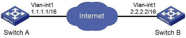

Encapsulation modes
IPsec supports the following encapsulation modes:
·     Transport mode—The security protocols protect the upper layer data of an IP packet. Only the transport layer data is used to calculate the security protocol headers. The calculated security protocol headers and the encrypted data (only for ESP encapsulation) are placed after the original IP header. You can use the transport mode when end-to-end security protection is required (the secured transmission start and end points are the actual start and end points of the data). The transport mode is typically used for protecting host-to-host communications, as shown in Figure 1.
Figure 1 IPsec protection in transport mode

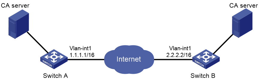

·     Tunnel mode—The security protocols protect the entire IP packet. The entire IP packet is used to calculate the security protocol headers. The calculated security protocol headers and the encrypted data (only for ESP encapsulation) are encapsulated in a new IP packet. In this mode, the encapsulated packet has two IP headers. The inner IP header is the original IP header. The outer IP header is added by the network device that provides the IPsec service. You must use the tunnel mode when the secured transmission start and end points are not the actual start and end points of the data packets (for example, when two gateways provide IPsec but the data start and end points are two hosts behind the gateways). The tunnel mode is typically used for protecting gateway-to-gateway communications, as shown in Figure 2.
Figure 2 IPsec protection in tunnel mode

Main mode IKE with pre-shared key authentication configuration example
Network requirements
As shown in Figure 8, configure an IKE-based IPsec tunnel between Switch A and Switch B to secure the communication in between.
Configure Switch A and Switch B to use the default IKE proposal for the IKE negotiation to set up the IPsec SAs. Configure the two switches to use the pre-shared key authentication method for the IKE negotiation phase 1.
Figure 8 Network diagram
Configuration procedure
1.     Configure Switch A:
# Configure an IP address for VLAN-interface 1.
<SwitchA> system-view
[SwitchA] interface vlan-interface 1
[SwitchA-vlan-interface1] ip address 1.1.1.1 255.255.0.0
[SwitchA-vlan-interface1] quit
# Configure ACL 3101 to identify traffic between Switch A and Switch B.
[SwitchA] acl advanced 3101
[SwitchA-acl-ipv4-adv-3101] rule 0 permit ip source 1.1.1.1 0 destination 2.2.2.2 0
[SwitchA-acl-ipv4-adv-3101] quit
# Create an IPsec transform set named tran1.
[SwitchA] ipsec transform-set tran1
# Set the packet encapsulation mode to tunnel.
[SwitchA-ipsec-transform-set-tran1] encapsulation-mode tunnel
# Use the ESP protocol for the IPsec transform set.
[SwitchA-ipsec-transform-set-tran1] protocol esp
# Specify the encryption and authentication algorithms.
[SwitchA-ipsec-transform-set-tran1] esp encryption-algorithm aes-cbc-128
[SwitchA-ipsec-transform-set-tran1] esp authentication-algorithm sha1
[SwitchA-ipsec-transform-set-tran1] quit
# Create an IKE keychain named keychain1.
[SwitchA] ike keychain keychain1
# Specify 123456TESTplat&! in plain text as the pre-shared key to be used with the remote peer at 2.2.2.2.
[SwitchA-ike-keychain-keychain1] pre-shared-key address 2.2.2.2 255.255.0.0 key simple 123456TESTplat&!
[SwitchA-ike-keychain-keychain1] quit
# Create an IKE profile named profile1.
[SwitchA] ike profile profile1
# Specify IKE keychain keychain1.
[SwitchA-ike-profile-profile1] keychain keychain1
# Configure the local ID with the identity type as IP address and the value as 1.1.1.1.
[SwitchA-ike-profile-profile1] local-identity address 1.1.1.1
# Configure a peer ID with the identity type as IP address and the value as 2.2.2.2/24.
[SwitchA-ike-profile-profile1] match remote identity address 2.2.2.2 255.255.0.0
[SwitchA-ike-profile-profile1] quit
# Create an IKE-based IPsec policy entry. Specify the policy name as map1 and set the sequence number to 10.
[SwitchA] ipsec policy map1 10 isakmp
# Specify the remote IP address 2.2.2.2 for the IPsec tunnel.
[SwitchA-ipsec-policy-isakmp-map1-10] remote-address 2.2.2.2
# Specify ACL 3101 to identify the traffic to be protected.
[SwitchA-ipsec-policy-isakmp-map1-10] security acl 3101
# Specify IPsec transform set tran1 for the IPsec policy.
[SwitchA-ipsec-policy-isakmp-map1-10] transform-set tran1
# Specify IKE profile profile1 for the IPsec policy.
[SwitchA-ipsec-policy-isakmp-map1-10] ike-profile profile1
[SwitchA-ipsec-policy-isakmp-map1-10] quit
# Apply IPsec policy map1 to VLAN-interface 1.
[SwitchA-Vlan-interface1] ipsec apply policy map1
# Specify a traffic processing slot for VLAN-interface 1.
[SwitchA-Vlan-interface1] service slot 3
[SwitchA-Vlan-interface1] quit
2.     Configure Switch B:
<SwitchB> system-view
[SwitchB] interface Vlan-interface1
[SwitchB-Vlan-interface1] ip address 2.2.2.2 255.255.0.0
[SwitchB-Vlan-interface1] quit
# Configure ACL 3101 to identify traffic between Switch B and Switch A.
[SwitchB] acl advanced 3101
[SwitchB-acl-ipv4-adv-3101] rule 0 permit ip source 2.2.2.2 0 destination 1.1.1.1 0
[SwitchB-acl-ipv4-adv-3101] quit
[SwitchB] ipsec transform-set tran1
[SwitchB-ipsec-transform-set-tran1] encapsulation-mode tunnel
[SwitchB-ipsec-transform-set-tran1] protocol esp
[SwitchB-ipsec-transform-set-tran1] esp encryption-algorithm aes-cbc-128
[SwitchB-ipsec-transform-set-tran1] esp authentication-algorithm sha1
[SwitchB-ipsec-transform-set-tran1] quit
[SwitchB]ike keychain keychain1
# Specify 123456TESTplat&! in plain text as the pre-shared key to be used with the remote peer at 1.1.1.1.
[SwitchB-ike-keychain-keychain1] pre-shared-key address 1.1.1.1 255.255.0.0 key simple 123456TESTplat&!
[SwitchB-ike-keychain-keychain1] quit
[SwitchB] ike profile profile1
[SwitchB-ike-profile-profile1] keychain keychain1
# Configure the local ID with the identity type as IP address and the value as 2.2.2.2.
[SwitchB-ike-profile-profile1] local-identity address 2.2.2.2
# Configure a peer ID with the identity type as IP address and the value as 1.1.1.1/24.
[SwitchB-ike-profile-profile1] match remote identity address 1.1.1.1 255.255.0.0
[SwitchB-ike-profile-profile1] quit
# Create an IKE-based IPsec policy entry. Specify the policy name as use1 and set the sequence number to 10.
[SwitchB] ipsec policy use1 10 isakmp
# Specify the remote IP address 1.1.1.1 for the IPsec tunnel.
[SwitchB-ipsec-policy-isakmp-use1-10] remote-address 1.1.1.1
[SwitchB-ipsec-policy-isakmp-use1-10] security acl 3101
[SwitchB-ipsec-policy-isakmp-use1-10] transform-set tran1
[SwitchB-ipsec-policy-isakmp-use1-10] ike-profile profile1
[SwitchB-ipsec-policy-isakmp-use1-10] quit
# Apply IPsec policy use1 to VLAN-interface 1.
[SwitchB] interface vlan-interface 1
[SwitchB-Vlan-interface1] ipsec apply policy use1
[SwitchB-Vlan-interface1] service slot 3

Aggressive mode with RSA signature authentication configuration example
This configuration example is not available when the device is operating in FIPS mode.
As shown in Figure 9, configure an IKE-based IPsec tunnel between Switch A and Switch B to secure the communication in between.
Configure Switch A and Switch B to use aggressive mode for IKE negotiation phase 1 and use RSA signature authentication.
Figure 9 Network diagram
# Configure IP addresses for interfaces. (Details not shown.)
# Configure ACL 3101 to identify data flows from 10.1.1.0/24 to 10.1.2.0/24.
[SwitchA-acl-ipv4-adv-3101] rule permit ip source 10.1.1.0 0.0.0.255 destination 10.1.2.0 0.0.0.255
[SwitchA-ipsec-transform-set-tran1] esp encryption-algorithm des-cbc
# Create a PKI entity named entity1.
[SwitchA] pki entity entity1
# Set the common name to switcha for the PKI entity.
[SwitchA-pki-entity-entity1] common-name switcha
[SwitchA-pki-entity-entity1] quit
# Create a PKI domain named domain1.
[SwitchA] pki domain domain1
# Set the certificate request mode to auto and set the password to 123 for certificate revocation.
[SwitchA-pki-domain-domain1] certificate request mode auto password simple 123
# Set an MD5 fingerprint for verifying the validity of the CA root certificate.
[SwitchA-pki-domain-domain1] root-certificate fingerprint md5 50c7a2d282ea710a449eede6c56b102e
# Specify the trusted CA 8088.
[SwitchA-pki-domain-domain1] ca identifier 8088
# Specify the URL of the registration server for certificate request through the SCEP protocol. This example uses http://192.168.222.1:446/eadbf9af4f2c4641e685f7a6021e7b298373feb7.
[SwitchA-pki-domain-domain1] certificate request url http://192.168.222.1:446/eadbf9af4f2c4641e685f7a6021e7b298373feb7
# Specify the CA to accept certificate requests.
[SwitchA-pki-domain-domain1] certificate request from ca
# Specify the PKI entity for certificate request as entity1.
[SwitchA-pki-domain-domain1] certificate request entity entity1
# Specify the RSA key pair rsa1 with the general purpose for certificate request.
[SwitchA-pki-domain-domain1] public-key rsa general name rsa1
[SwitchA-pki-domain-domain1] quit
# Specify PKI domain domain1 for the IKE profile.
[SwitchA-ike-profile-profile1] certificate domain domain1
# Specify that IKE negotiation operates in aggressive mode.
[SwitchA-ike-profile-profile1] exchange-mode aggressive
# Set the local identity to the FQDN name www.switcha.com.
[SwitchA-ike-profile-profile1] local-identity fqdn www.switcha.com
# Configure a peer ID with the identity type of FQDN name and the value of www.switchb.com.
[SwitchA-ike-profile-profile1] match remote identity fqdn www.switchb.com
# Create an IKE proposal named 10.
[SwitchA] ike proposal 10
# Specify the authentication algorithm as HMAC-MD5.
[SwitchA-ike-proposal-10] authentication-algorithm md5
# Specify the RSA authentication method.
[SwitchA-ike-proposal-10] authentication-method rsa-signature
[SwitchA-ike-proposal-10] quit
# Configure ACL 3101 to identify data flows from10.1.2.0/24 to 10.1.1.0/24.
[SwitchB-acl-ipv4-adv-3101] rule permit ip source 10.1.2.0 0.0.0.255 destination 10.1.1.0 0.0.0.255
[SwitchB-ipsec-transform-set-tran1] esp encryption-algorithm des-cbc

Figure 10 IKEv2 Initial exchange process

IKEv2 configuration examples
IKEv2 with pre-shared key authentication configuration example
As shown in Figure 11, configure an IKE-based IPsec tunnel between Switch A and Switch B to secure the communication between them.
·     Configure Switch A and Switch B to use the default IKEv2 proposal and the default IKEv2 policy in IKEv2 negotiation to set up IPsec SAs.
·     Configure the two switches to use the pre-shared key authentication method in IKEv2 negotiation.
Figure 11 Network diagram
Configuration procedures
# Assign an IP address to VLAN-interface 1.
# Configure IPv4 advanced ACL 3101 to identify the traffic between Switch A and Switch B.

# Initiate a connection between Switch A and Switch B to trigger IKEv2 negotiation. After IPsec SAs are successfully negotiated by IKEv2, traffic between the switches is IPsec protected.
IKEv2 with RSA signature authentication configuration example
As shown in Figure 12, configure an IKE-based IPsec tunnel between Switch A and Switch B to secure the communication between them.
Configure Switch A and Switch B to use IKEv2 negotiation and RSA signature authentication.
Figure 12 Network diagram
[SwitchB-pki-domain-domain2] certificate request from ca
# Specify the PKI entity for certificate request as entity2.
[SwitchB-pki-domain-domain2] certificate request entity entity2
[SwitchB-pki-domain-domain2] public-key rsa general name rsa1
[SwitchB-pki-domain-domain2] quit
# Create an IKEv2 profile named profile2.
[SwitchB] ikev2 profile profile2
# Specify the local authentication method as RSA signatures.
[SwitchB-ikev2-profile-profile2] authentication-method local rsa-signature
# Specify the remote authentication method as RSA signatures.
[SwitchB-ikev2-profile-profile2] authentication-method remote rsa-signature
# Set the local identity to the FQDN name www.switchb.com.
[SwitchB-ikev2-profile-profile2] identity local fqdn www.switchb.com
# Specify the peer ID that the IKEv2 profile matches. The peer ID is the FQDN name www.switcha.com.
[SwitchB-ikev2-profile-profile2] match remote identity fqdn www.switcha.com
[SwitchB-ikev2-profile-profile2] quit
# Create an IKEv2 proposal named 10.
[SwitchB] ikev2 proposal 10
# Specify the integrity protection algorithm as HMAC-MD5.
[SwitchB-ikev2-proposal-10] integrity md5
# Specify the encryption algorithm as 3DES-CBC.
[SwitchB-ikev2-proposal-10] encryption 3des-cbc
# Specify the DH group as Group 1.
[SwitchB-ikev2-proposal-10] dh group1
# Specify the PRF algorithm as HMAC-MD5.
[SwitchB-ikev2-proposal-10] prf md5
[SwitchB-ikev2-proposal-10] quit
# Create an IKEv2 policy named 1.
[SwitchB] ikev2 policy 1
# Specify IKEv2 proposal 10 for the IKEv2 policy.
[SwitchB-ikev2-policy-1] proposal 10
[SwitchB-ikev2-policy-1] quit
# Create an IPsec policy template entry. Specify the template name as template1 and set the sequence number to 1.
[SwitchB] ipsec policy-template template1 1
[SwitchB-ipsec-policy-template-template1-1] remote-address 1.1.1.1
[SwitchB-ipsec-policy-template-template1-1] security acl 3101
# Specify IPsec transform set tran1 for the IPsec policy template.
[SwitchB-ipsec-policy-template-template1-1] transform-set tran1
# Specify IKEv2 profile profile2 for the IPsec policy template.
[SwitchB-ipsec-policy-template-template1-1] ikev2-profile profile2
[SwitchB-ipsec-policy-template-template1-1] quit
# Create an IKE-based IPsec policy entry by using IPsec policy template template1. Specify the policy name as use1 and set the sequence number to 1.
[SwitchB] ipsec policy use1 1 isakmp template template1
