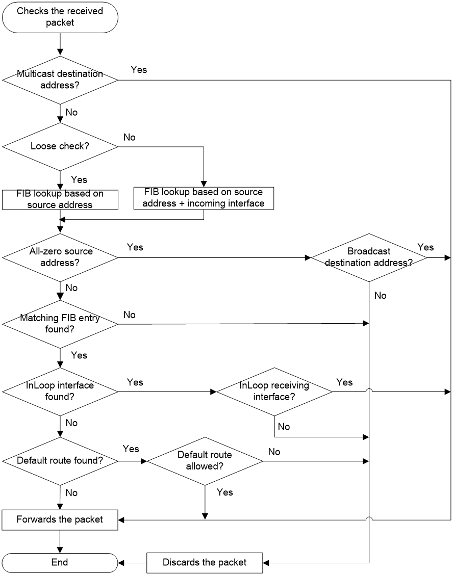

uRPF operation
Figure 2 shows how uRPF works.
Figure 2 uRPF work flow
1.     uRPF checks whether the received packet carries a multicast destination address:
¡     If yes, uRPF permits the packet.
¡     If no, uRPF proceeds to step 2.
2.     uRPF checks whether the uRPF check mode is loose:
¡     If yes, uRPF performs FIB lookup based on the source IP address and then proceeds to step 3.
¡     If no, uRPF performs FIB lookup based on the source IP address and the receiving interface and then proceeds to step 3.
3.     uRPF checks whether the source IP address is an all-zero address:
¡     If yes, uRPF checks whether the destination address of the packet is a broadcast address.
-     If yes, uRPF permits the packet.
-     If no, uRPF discards the packet.
¡     If no, uRPF proceeds to step 4.
4.     uRPF checks whether the source address matches a unicast route:
¡     If yes, uRPF proceeds to step 5.
¡     If no, uRPF discards the packet.
5.     uRPF checks whether the matching route is to the host itself (whether the output interface of the matching route is an InLoop interface):
¡     If yes, uRPF checks whether the receiving interface of the packet is an InLoop interface.
¡     If no, uRPF proceeds to step 6.
6.     uRPF checks whether the matching route is a default route:
¡     If yes, uRPF checks whether the allow-default-route keyword is configured to allow using the default route.
-     If yes, uPRF forwards the packet.
-     If no, uPRF discards the packet.
¡     If no, uRPF forwards the packet.

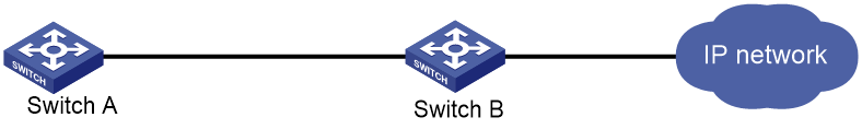

uRPF configuration example
Network requirements
As shown in Figure 4, configure strict uRPF check on Switch B.
Configure strict uRPF check on Switch A and allow using the default route for uRPF check.
Figure 4 Network diagram
Configuration procedure
1.     Configure strict uRPF check on Switch B.
<SwitchB> system-view
[SwitchB] ip urpf strict
2.     Configure strict uRPF check on Switch A and allow using the default route for uRPF check.
<SwitchA> system-view
[SwitchA] ip urpf strict allow-default-route

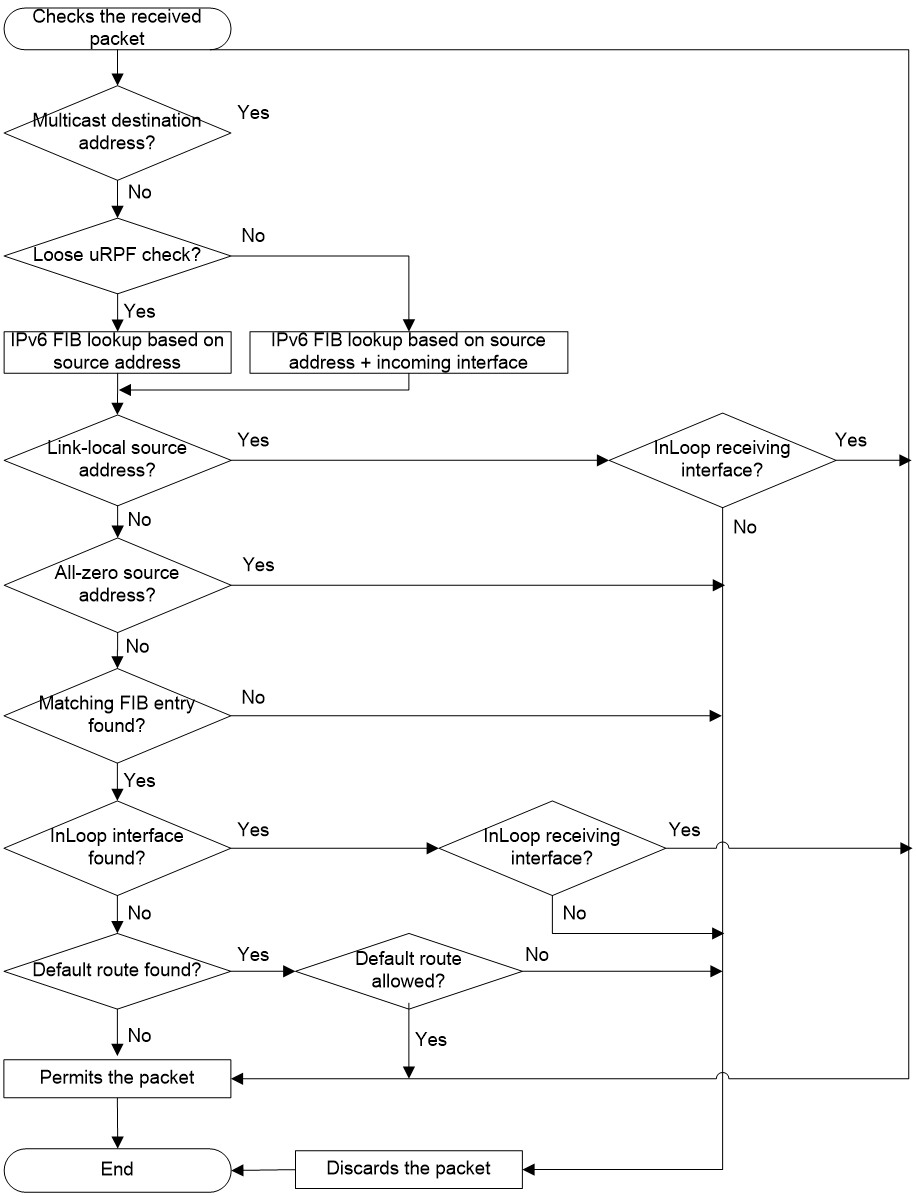

IPv6 uRPF operation
Figure 6 shows how IPv6 uRPF works.
Figure 6 IPv6 uRPF work flow
1.     IPv6 uRPF checks whether the received packet carries a multicast destination address:
¡     If yes, IPv6 uRPF permits the packet.
¡     If no, IPv6 uRPF proceeds to step 2.
2.     IPv6 uRPF checks whether the IPv6 uRPF check mode is loose:
¡     If yes, IPv6 uRPF performs IPv6 FIB lookup based on the source IPv6 address and then proceeds to step 3.
¡     If no, IPv6 uRPF performs IPv6 FIB lookup based on the source IPv6 address and the receiving interface and then proceeds to step 3.
3.     IPv6 uRPF checks whether the source address is a link-local address:
¡     If yes, IPv6 uRPF checks whether the receiving interface is a InLoop interface.
-     If yes, IPv6 uRPF permits the packet.
-     If not, IPv6 uRPF discards the packet.
¡     If no, IPv6 uRPF proceeds to step 4.
4.     IPv6 uRPF checks whether the source address is an all-zero address:
¡     If yes, IPv6 uRPF discards the packet.
¡     If no, IPv6 uRPF proceeds to step 5.
5.     IPv6 uRPF checks whether the source address matches a unicast route:
¡     If yes, IPv6 uRPF proceeds to step 6.
¡     If no, IPv6 uRPF discards the packet.
6.     IPv6 uRPF checks whether the matching route is to the host itself (whether the output interface of the matching route is an InLoop interface):
¡     If yes, IPv6 uRPF checks whether the receiving interface of the packet is an InLoop interface.
-     If no, IPv6 uRPF discards the packet.
¡     If no, IPv6 uRPF proceeds to step 7.
7.     IPv6 uRPF checks whether the matching route is a default route:
¡     If yes, IPv6 uRPF checks whether the allow-default-route keyword is configured to allow using the default route.
-     If yes, the packet is forwarded.
¡     If no, the packet is forwarded.
As shown in Figure 8, configure strict IPv6 uRPF check on Switch B.
Configure strict IPv6 uRPF check on Switch A and allow using the default route for IPv6 uRPF check.
Figure 8 Network diagram
1.     Configure strict IPv6 uRPF check on Switch B.
[SwitchB] ipv6 urpf strict
2.     Configure strict uRPF check on Switch A and allow using the default route for IPv6 uRPF check.
[SwitchA] ipv6 urpf strict allow-default-route
