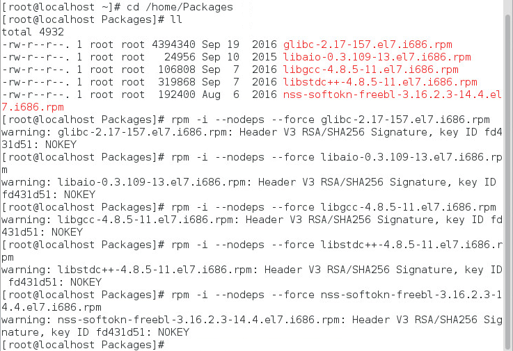

Installing the required software packages
Install the following software packages in the Red Hat Enterprise Linux 7.3 environment, as shown in Figure 1.
·     glibc-2.17-157.el7.i686.rpm
·     libaio-0.3.109-13.el7.i686.rpm
·     libgcc-4.8.5-11.el7.i686.rpm
·     libstdc++-4.8.5-11.el7.i686.rpm
·     nss-softokn-freebl-3.16.2.3-14.4.el7.i686.rpm
To ensure that these 32-bit software packages can be installed successfully in the 64-bit Linux system, run the following commands as a root user:
rpm –i –-nodeps –-force glibc-2.17-157.el7.i686.rpm
rpm –i –-nodeps –-force libaio-0.3.109-13.el7.i686.rpm
rpm –i –-nodeps –-force libgcc-4.8.5-11.el7.i686.rpm
rpm –i --nodeps –-force libstdc++-4.8.5-11.el7.i686.rpm
rpm -i --nodeps –-force nss-softokn-freebl-3.16.2.3-14.4.el7.i686.rpm
Figure 1 Installing the required software packages

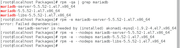

Before you install the MySQL 5.7 database, you must remove the built-in MariaDB built in Red Hat Enterprise Linux 7.3, as shown in Figure 2.
1.     Query the installed MariaDB and related programs.
rpm –qa | grep mariadb
2.     Remove the software packages.
rpm –e mariadb-server-5.5.52-1.el7.x86_64
rpm –e mariadb-5.5.52-1.el7.x86_64
rpm –e mariadb-libs-5.5.52-1.el7.x86_64
3.     Remove the dependent packages if you receive a mariadb-server-5.5.52-1.el7.x86_64 and rpm –e mariadb-libs-5.5.52-1.el7.x86_64 package dependency message.
rpm –e -–nodeps mariadb-server-5.5.52-1.el7.x86_64
rpm –e -–nodeps mariadb-5.5.52-1.el7.x86_64
rpm –e -–nodeps mariadb-libs-5.5.52-1.el7.x86_64
Figure 2 Removing the built-in MariaDB

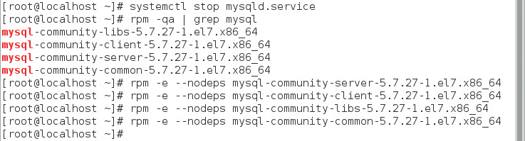

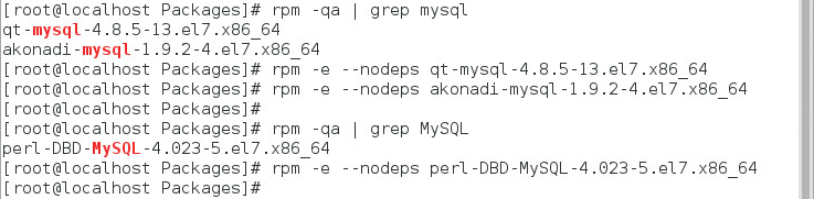

4.     Query the installed MySQL database and related programs.
rpm –qa | grep mysql
rpm –qa | grep MySQL
5.     Remove the software package.
rpm –e ––nodeps qt-mysql-4.8.5-13.e17.x86_64
rpm –e ––nodeps akonadi-mysql-1.9.2-4.e17.x86_64
rpm –e ––nodeps perl –DBD-MySQL-4.023-5.el7.x86_64
Figure 3 Removing programs related with the MySQL database

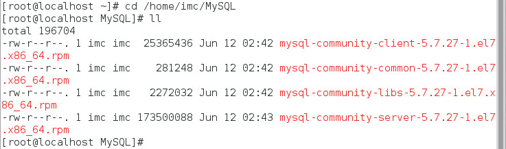

Copying the installation programs to the Linux server
Before installing the MySQL database, copy the installation programs to the Linux server.
This document uses the installation programs mysql-community-server-5.7.27-1.el7.x86_64.rpm and mysql-community-client-5.7.27-1.el7.x86_64.rpm, as shown in Figure 4.
Figure 4 MySQL installation programs on Linux
Because mysql-community-client-5.7.27-1.el7.x86_64.rpm depends on mysql-community-common-5.7.27-1.el7.x86_64.rpm and mysql-community-libs-5.7.27-1.el7.x86_64.rpm, you must install programs in the following order:
1.     mysql-community-common-5.7.27-1.el7.x86_64.rpm.
2.     mysql-community-libs-5.7.27-1.el7.x86_64.rpm.
3.     mysql-community-client-5.7.27-1.el7.x86_64.rpm.

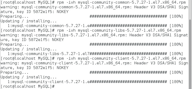

Installing the MySQL client
The MySQL client provides tools for MySQL management and user interaction, for example, mysqladmin and mysql. You must install the MySQL client on the IMC server to communicate with the MySQL server (locally or remotely).
Go to the directory where the MySQL installation programs are located and install the MySQL client, as shown in Figure 5.
rpm –ivh mysql-community-common-5.7.27-1.el7.x86_64.rpm,
rpm –ivh mysql-community-libs-5.7.27-1.el7.x86_64.rpm
rpm –ivh mysql-community-client-5.7.27-1.el7.x86_64.rpm,
Figure 5 Installing the MySQL client

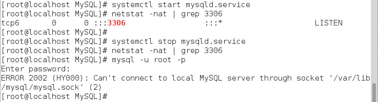

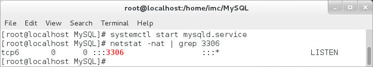

2.     Start the MySQL service after the installation is complete.
systemctl start mysqld.service
3.     Verify that the MySQL service has started (3306 is the default port).
netstat –nat | grep 3306
Figure 7 shows that the MySQL service has started.
Figure 7 Checking the MySQL service status

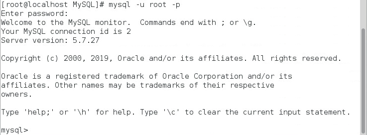

The MySQL server is installed on the IMC server. Run the following command and enter the root user password at the prompt Enter password:
mysql –u root –p
The root user password is randomly generated during the MySQL server installation. To view the password, see "Changing the MySQL password."
If the MySQL command line interface is displayed, the MySQL client was installed successfully, as shown in Figure 8.
Figure 8 Verifying the MySQL client installation

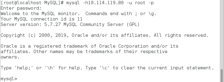

IMC with a remote database
The IMC server is installed with the MySQL client only. Run the following command and enter the new root user password at the prompt Enter password:
mysql -h 10.114.119.80 –u root -p
Before verifying the MySQL client installation, make sure a remote root user account has been created on the MySQL server. For information about how to create a remote root user account, see "Creating a remote root user account."
Figure 9 Verifying the connection between the MySQL client and server
In the output, 10.114.119.80 is the IP address of the MySQL server, and root is the remote root user account. The root user password is randomly generated during the MySQL server installation. To view the password, see "Changing the MySQL password."
The prompt mysql indicates that the client has connected successfully to the MySQL server.

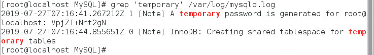

The MySQL server randomly generates a temporary password for the root user during the installation and stores the password in the /var/log//mysqld.log file. At the first startup of the MySQL service, you must modify the password. Otherwise, the MySQL service cannot run correctly.
To modify the password:
1.     Query the temporary password in the log file, as shown in Figure 10.
grep ‘temporary’ /var/log/mysqld.log
Figure 10 Opening the log file

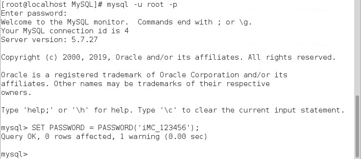

2.     Log in to the database with the temporary password.
mysql –u root –p
3.     Enter the temporary password at the prompt Enter password.
The prompt mysql is displayed, as shown in Figure 11.
Figure 11 Entering the MySQL command line interface
4.     Change the root user password. This example uses iMC_123456 as the new password.
SET PASSWORD = PASSWORD('iMC_123456');
Figure 12 shows that the password has been changed successfully.
Figure 12 Changing the root user password

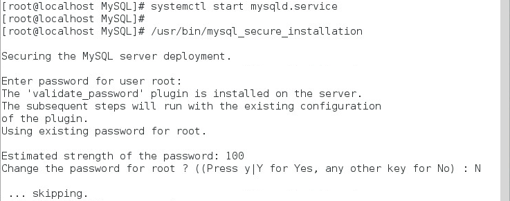

1.     Run the mysql_secure_installation program.
/usr/bin/mysql_secure_installation
2.     Enter the root user password to set security options, such as setting a root user password, removing anonymous users, and removing a test database, as shown in Figure 14.
Figure 14 Setting the root user password
3.     Enter N when the system asks you to change the root password, as shown in Figure 15.
Figure 15 Choosing not to change the root user password

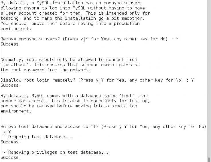

4.     Remove anonymous users and the database named test, as shown in Figure 16.
If you want to use IMC with a local database, you must disable remote root login.
Figure 16 Configuring anonymous users, remote access, and the test database

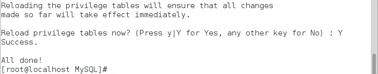

6.     Reload the privilege tables to make the changes take effect, as shown in Figure 17.
Figure 17 Reloading the privilege tables

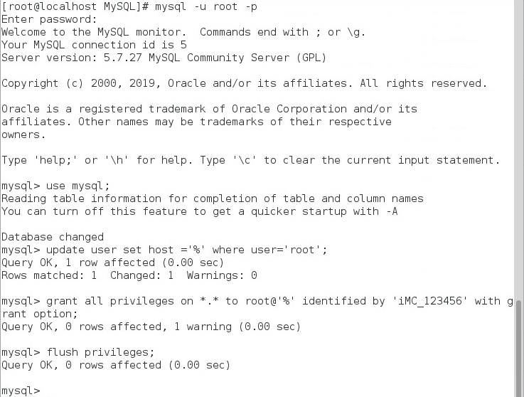

By default, the MySQL server has only one local root user account. If you want to use IMC with a remote database, install MySQL client and configure a remote root user account on the database server.
To create a remote root user account:
1.     Log in to MySQL.
mysql –u root –p
2.     Enter the new MySQL password.
3.     Read database tables.
use mysql
4.     Update database users.
update user set host='%' where user='root'
5.     Create a remote root user account.
grant all privileges on *.* to root@'%’ identified by ‘iMC_123456’ with grant option;
6.     Refresh privileges.
flush privileges
Figure 18 Creating a remote root user account

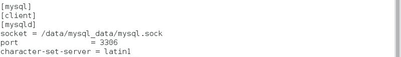

Configuring parameters in the my.cnf file
The default configuration file /etc/my.cnf determines the performance and behavior of the MySQL server and defines the path for saving MySQL files. Before you configure the my.cnf file, stop the MySQL service. Restart the MySQL service after you finish the file configuration.
To configure parameters in the my.cnf file:
1.     Stop the MySQL service and open the my.cnf file, as shown in Figure 19.
Figure 19 Opening the my.cnf file

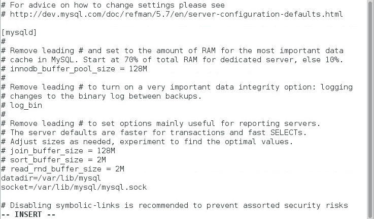

2.     Enter i to enter edit mode, as shown in Figure 20.
Figure 20 Entering edit mode

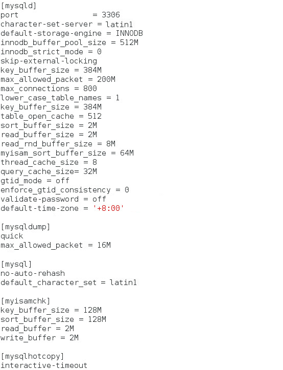

3.     Add parameters under [mysqld], as shown in Figure 21. Table 1 describes the parameters that you can configure in the my.cnf file.
IMPORTANT
IMPORTANT:
Before installing iMC PLAT 7.3 (E0703), you must disable password detection by setting validate-password=off. This setting is not required for E0705 and later versions.
[mysqld]
port= 3306
character-set-server = latin1
default-storage-engine = INNODB
innodb_buffer_pool_size = 512M
innodb_strict_mode = 0
skip-external-locking
key_buffer_size = 384M
max_allowed_packet = 200M
max_connections = 800
lower_case_table_names = 1
table_open_cache = 512
sort_buffer_size = 2M
read_buffer_size = 2M
read_rnd_buffer_size = 8M
myisam_sort_buffer_size = 64M
thread_cache_size = 8
query_cache_size= 32M
gtid_mode = off
enforce_gtid_consistency = 0
validate-password = off
default-time-zone = '+8:00'
[mysqldump]
quick
[mysql]
no-auto-rehash
default_character_set = latin1
[myisamchk]
key_buffer_size = 128M
sort_buffer_size = 128M
read_buffer = 2M
write_buffer = 2M
[mysqlhotcopy]
interactive-timeout
Figure 21 Adding parameters under [mysqld]

·     0—InnoDB ignores conflicting clauses and creates the table or index, with only a warning in the message log.
·     1—InnoDB returns errors rather than warnings for certain conditions.
Indicates whether a table name is case sensitive.
·     0—Yes
·     1—No
max_allowed_packet
Maximum allowed size for a packet.
gtid_mode
Controls whether GTID based logging is enabled and what type of transactions the logs can contain.
Specifies whether to allow transactions to violate GTID consistency. 0 means all transactions are allowed to violate GTID consistency. 1 means no transaction is allowed to violate GTID consistency.
validate-password
Specifies the method to load the validate_password plugin upon server startup. The password detection plugin is enabled by default.
default-time-zone
Sets the default server time zone. Named time zones can be used only if the time zone information tables in the MySQL database have been created and populated, for example, Europe/Helsinki.
transaction_isolation
Transaction isolation level.
Check whether the transaction_isolation parameter exists under [mysqld] when installing EIA:
·     If that parameter does not exist, add transaction_isolation=READ-COMMITTED under [mysqld].
·     If that parameter exists, change the value to READ-COMMITTED.
Changing the log and database file directory
Change the log and database file directory as needed.
1.     Stop the MySQL service.
systemctl stop mysqld.service
2.     Create a path for storing logs and database files. The directory is /data/mysql_data in this example.
mkdir –p /data/mysql_data
3.     Copy all files from the default directory to the new directory, and then change the access permissions of the files.
cp –R /var/lib/mysql/* /data/mysql_data/
chmod -R 777 /data/mysql_data/
4.     Add the new directory to the [mysqld] section in the my.cnf file of the MySQL database.
vi /etc/my.cnf
datadir=/data/mysql_data
5.     Add parameters above and below the [mysqld] section to specify the socket file for logging in to the MySQL database, as shown in Figure 22.
Above the [mysqld] section:
[mysql]
[client]
Below the [mysqld] section:
socket = /data/mysql_data/mysql.sock
Figure 22 Specifying the socket file
6.     Save the my.cnf file, and then quit the vi editor.
7.     Start the MySQL service.
2.     Uninstall the MySQL database, as shown in Figure 23.
rpm -qa | grep mysql
rpm –e –-nodeps mysql-community -server-5.7.27-1.el7.x86_64
rpm –e –-nodeps mysql-community -client-5.7.27-1.el7.x86_64
rpm –e –-nodeps mysql-community -libs-5.7.27-1.el7.x86_64
rpm –e –-nodeps mysql-community -common-5.7.27-1.el7.x86_64
You can use the following command to query the component name:
Figure 23 Uninstalling the MySQL database
3.     Manually remove the database files in the default directory /var/lib/mysql after uninstallation.
rm -rf /var/lib/mysql
After the directory is removed, the MySQL database is removed successfully.

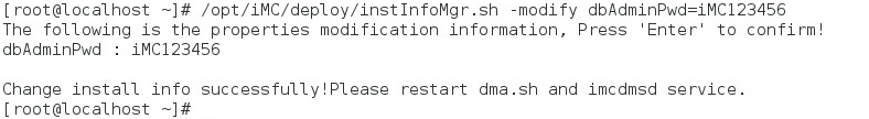

How do I update the database password for the IMC server?
If the password of the account that IMC uses to connect to a database is changed, the IMC server will fail to connect to the database. To resolve this problem, modify the database user password saved in IMC:
1.     Execute the /opt/iMC/deploy/instInfoMgr.sh –modify dbAdminPwd=yourpassword command to modify the database password on the IMC server. For example, change the password to iMC123456, as shown in Figure 25.
Figure 25 Changing the database password on the IMC server
2.     Click the Environment tab in the Intelligent Deployment Monitoring Agent window, and then click Refresh in the Database Space Usage area.
