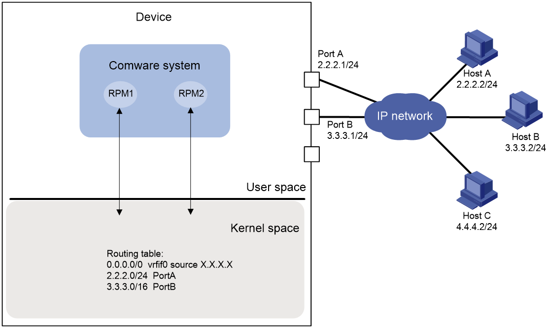

Communication between RPM applications
RPM applications on one device use an internal interface to communicate with each other.
No source IP address is used for RPM applications on different devices on the same subnet to communicate. The destination device must be reachable from the Comware system.
For RPM applications to communicate with indirectly connected networks, you must configure a source IP address for the RPM applications. They use the IP address of the specified interface as the source IP address for packets that they generate, and a connection must be available between the interface and the destination device.
As shown in Figure 1, the system kernel creates a default route and one direct route for each interface in up state. Because Host A and Port A reside on the same subnet, Host A can use IP address 2.2.2.1 to communicate with the applications RPM1 and RPM2. The similar is true for Host B. Because Host C resides on a different subnet than the device, Host C must use the source IP address specified for the applications to communicate with the applications RPM1 and RPM2.
Figure 1 Network diagram for RPM applications
