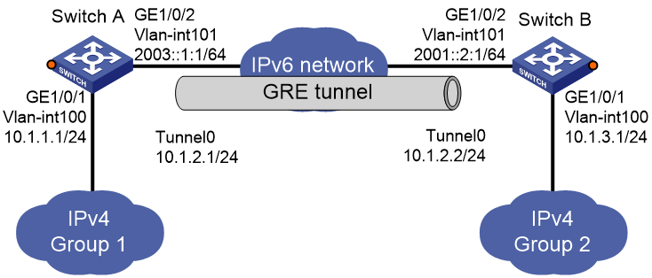

As shown in Figure 6, Group 1 and Group 2 are two private IPv4 networks. The two networks both use private network addresses and belong to the same VPN. Establish a GRE tunnel between Switch A and Switch B to interconnect the two private IPv4 networks Group 1 and Group 2.
Before performing the following configuration, configure an IP address for each interface, and make sure Switch A and Switch B can reach each other.
1. Configure Switch A:
# Enter system view.
<SwitchA> system-view
# Create a tunnel interface Tunnel 1, and specify the tunnel mode as GRE/IPv4.
[SwitchA] interface tunnel 1 mode gre
# Configure an IP address for the tunnel interface.
[SwitchA-Tunnel1] ip address 10.1.2.1 255.255.255.0
# Configure the source address of tunnel interface as the IP address of VLAN-interface 101 on Switch A.
[SwitchA-Tunnel1] source 1.1.1.1
# Configure the destination address of the tunnel interface as the IP address of VLAN-interface 101 on Switch B.
[SwitchA-Tunnel1] destination 2.2.2.2
[SwitchA-Tunnel1] quit
# Configure a static route from Switch A through the tunnel interface to Group 2.
[SwitchA] ip route-static 10.1.3.0 255.255.255.0 tunnel 1
2. Configure Switch B:
<SwitchB> system-view
[SwitchB] interface tunnel 1 mode gre
[SwitchB-Tunnel1] ip address 10.1.2.2 255.255.255.0
# Configure the source address of tunnel interface as the IP address of VLAN-interface 101 on Switch B.
[SwitchB-Tunnel1] source 2.2.2.2
# Configure the destination address of the tunnel interface as the IP address of VLAN-interface 101 on Switch A.
[SwitchB-Tunnel1] destination 1.1.1.1
[SwitchB-Tunnel1] quit
# Configure a static route from Switch B through the tunnel interface to Group 1.
[SwitchB] ip route-static 10.1.1.0 255.255.255.0 Tunnel 1
# Display tunnel interface information on Switch A.
[SwitchA] display interface tunnel 1

Example: Configuring an IPv4 over IPv6 GRE tunnel
As shown in Figure 7, two IPv4 subnets Group 1 and Group 2 are connected to an IPv6 network. Create a GRE/IPv6 tunnel between Switch A and Switch B, so the two IPv4 subnets can communicate with each other through the GRE tunnel over the IPv6 network.
# Create a tunnel interface Tunnel 0, and specify the tunnel mode as GRE/ IPv6.
[SwitchA] interface tunnel 0 mode gre ipv6
[SwitchA-Tunnel0] ip address 10.1.2.1 255.255.255.0
# Configure the source address of the tunnel interface as the IPv6 address of VLAN-interface 101 on Switch A.
[SwitchA-Tunnel0] source 2003::1:1
# Configure the destination address of the tunnel interface as the IPv6 address of VLAN-interface 101 on Switch B.
[SwitchA-Tunnel0] destination 2001::2:1
[SwitchA-Tunnel0] quit
[SwitchA] ip route-static 10.1.3.0 255.255.255.0 tunnel 0
# Create a tunnel interface Tunnel 0, and specify the tunnel mode as GRE/IPv6.
[SwitchB] interface tunnel 0 mode gre ipv6
[SwitchB-Tunnel0] ip address 10.1.2.2 255.255.255.0
# Configure the source address of tunnel interface as the IPv6 address of VLAN-interface 101 on Switch B.
[SwitchB-Tunnel0] source 2001::2:1
# Configure the destination address of the tunnel interface as the IPv6 address of VLAN-interface 101 on Switch A.
[SwitchB-Tunnel0] destination 2003::1:1
[SwitchB-Tunnel0] quit
[SwitchB] ip route-static 10.1.1.0 255.255.255.0 tunnel 0
[SwitchA] display interface tunnel 0
Tunnel0
Current state: UP
Line protocol state: UP
Description: Tunnel0 Interface
Bandwidth: 64kbps
Maximum transmission unit: 1456
Internet address: 10.1.2.1/24 (primary)
Tunnel source 2003::1:1, destination 2001::2:1
Tunnel TTL 255
Tunnel protocol/transport GRE/IPv6
GRE key disabled
Checksumming of GRE packets disabled
Last clearing of counters: Never
Last 300 seconds input rate: 0 bytes/sec, 0 bits/sec, 0 packets/sec
Last 300 seconds output rate: 0 bytes/sec, 0 bits/sec, 0 packets/sec
Input: 0 packets, 0 bytes, 0 drops
Output: 0 packets, 0 bytes, 0 drops
# Display tunnel interface information on Switch B.
[SwitchB] display interface tunnel 0
Tunnel0
Current state: UP
Bandwidth: 64kbps
Internet address: 10.1.2.2/24 (primary)
Tunnel source 2001::2:1, destination 2003::1:1
Tunnel TTL 255
GRE key disabled
# From Switch B, ping the IP address of VLAN-interface 100 on Switch A.
[SwitchB] ping -a 10.1.3.1 10.1.1.1
Ping 10.1.1.1 (10.1.1.1) from 10.1.3.1: 56 data bytes, press CTRL+C to break
56 bytes from 10.1.1.1: icmp_seq=0 ttl=255 time=2.000 ms
56 bytes from 10.1.1.1: icmp_seq=1 ttl=255 time=1.000 ms
56 bytes from 10.1.1.1: icmp_seq=2 ttl=255 time=1.000 ms
56 bytes from 10.1.1.1: icmp_seq=3 ttl=255 time=0.000 ms
56 bytes from 10.1.1.1: icmp_seq=4 ttl=255 time=1.000 ms
--- Ping statistics for 10.1.1.1 ---
round-trip min/avg/max/std-dev = 0.000/1.000/2.000/0.632 ms
The output shows that Switch B can successfully ping Switch A.
