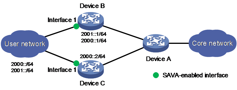

As shown in Figure 2, users in the LAN connect to the backbone network through Device B and Device C. Device B is configured with two gateways addresses (2000::1/64 and 2001::1/64). Device C is configured with the gateway address (2000::2/64).
You can configure SAVA on interface 1 of both Device B and Device C. When Device C receives an IPv6 route with prefix 2001::/64 from Device B, it creates an SAVA entry with this prefix. Then, upon receiving an IPv6 packet from a user at 2001::/64, Device C will permit the packet because a matching SAVA entry exists.
Figure 2 SAVA deployed on border devices directly connected to the LAN

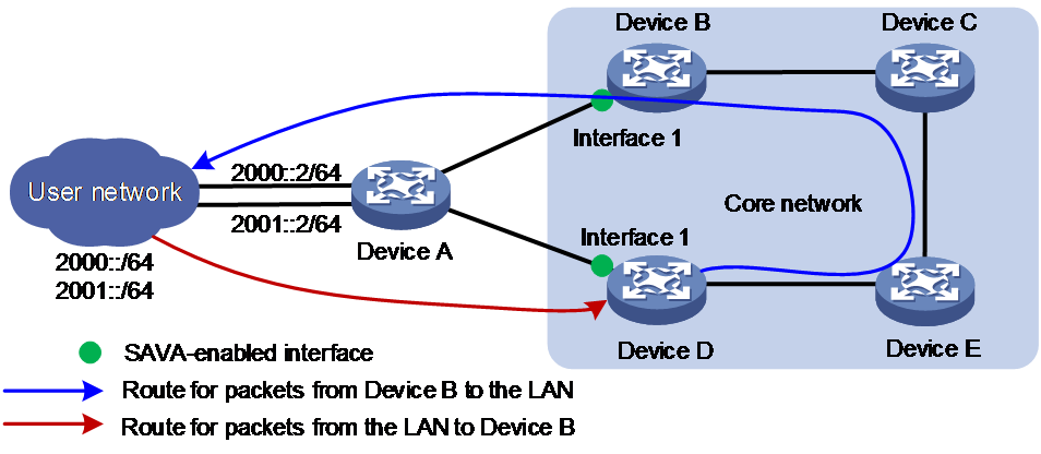

Deployed on intra-AS border devices indirectedly connected to the LAN
As shown in Figure 3, asymmetric traffic exists between Device D and the LAN after route convergence. Traffic from Device D to the LAN will traverse Device E, Device C, Device B, and Device A. Traffic from the LAN to Device D will traverse only Device A.
You can configure SAVA on interface 1 of both Device B and Device D. Device B and Device D synchronize routes with each other, obtain prefix information of the LAN based on the synchronized remote routes, and then create SAVA entries. Upon receiving a packet from a user in the LAN, Device C will permit the packet because a matching SAVA entry exists.
Figure 3 SAVA deployed on intra-AS border devices indirectly connected to the LAN

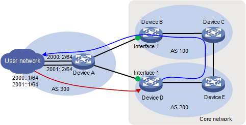

Delpoyed on inter-AS border devices indirectedly connected to the LAN
As shown in Figure 4, asymmetric traffic exists between Device D and the LAN after route convergence. Traffic from Device D to the LAN will traverse Device E, Device C, Device B, and Device A. Traffic from the LAN to Device D will traverse only Device A.
You can configure SAVA on interface 1 of both Device B and Device D. Device B and Device C in AS 100 as well as Device D and Device E in AS 200 synchronize local routes with each other through an IGP protocol (OSPFv3, for example). Then, Device C in AS 100 and Device E in AS 200 synchronize routes with each other through BGP. Upon receiving a packet from a user in the LAN, Device C will permit the packet because a matching SAVA entry exists.
Figure 4 SAVA deployed on inter-AS border devices indirectly connected to the LAN

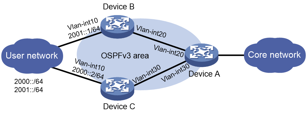

Example: Configuring SAVA on border devices indirectly connected the LAN (OSPFv3)
As shown in Figure 6, OSPFv3 runs on the core network. Configure the devices to meet the following requirements:
Enable SAVA on VLAN-interface 30 of Device B and VLAN-interface 40 on Device D to filter packets based on SAVA entries.
On Device C, configure a static route to the LAN with next-hop device Device A. Enable OSPFv3 link tag inheritance to statically tag routes to the LAN.
Configure OSPFv3 on Device B and Device A to synchronize routes to the LAN. Enable OSPFv3 link tag inheritance and set the OSPFv3 link tag to dynamically tag routes to the LAN.
Figure 6 Network diagram

Example: Configuring SAVA on border devices indirectly connected the LAN (IPv6 IS-IS)
As shown in Figure 7, IPv6 IS-IS runs on the core network. Configure the devices to meet the following requirements:
Enable SAVA on VLAN-interface 30 of Device B and VLAN-interface 40 of Dervice D to filter packets based on SAVA entries.
On Device C, configure a static route to the LAN with next-hop device Device A. Enable IPv6 IS-IS link tag inheritance to statically tag routes to the LAN.
Configure IPv6 IS-IS on Device B and Device A to synchronize routes to the LAN. Enable IPv6 IS-IS link tag inheritance and set the IPv6 IS-IS link tag to dynamically tag routes to the LAN.
Figure 7 Network diagram
Table 3 Interface and IP address assignment

Assign IPv6 addresses to interfaces on the devices.

Example: Configuring SAVA on inter-AS border devices indirectly connected the LAN
As shown in Figure 8, configure the devices to meet the following requirements:
Configure SAVA VLAN-interface 30 of Device B and VLAN-interface 40 of Dervice D to filter packets based on SAVA entries.
Configure remote route tagging. Device B and Device C in AS 100 and Device D and Device E in AS 200 exchange routes through IGP (for example, OSPFv3). Device C and Device E in different ASs exchange routes through BGP. The devices create SAVA entries based on the synchronized remote routes.
Figure 8 Network diagram
Table 4 Interface and IP address assignment

# Configure VLAN-interface 40 to redistribute remote routes with route tag 100.
[DeviceD-Vlan-interface40] ipv6 sava import remote-route-tag 100
[DeviceD-Vlan-interface40] quit
3.     Configure Device C:
# Configure routing policy named sava-exp, configure node 0 in permit mode to permit routes with tag 100 and to set the 10:10 community attribute for BGP.
[DeviceC] route-policy sava-exp permit node 0
[DeviceC-route-policy-sava-exp-0] if-match tag 100
[DeviceC-route-policy-sava-exp-0] apply community 10:10
[DeviceC-route-policy-sava-exp-0] quit
# Enable BGP to exchange routing information for IPv6 address family with peer 192:168::34:4 in AS 200.
[DeviceC] bgp 100
[DeviceC-bgp-default] router-id 3.3.3.3
[DeviceC-bgp-default] peer 192:168::34:4 as 200
[DeviceC-bgp-default] address-family ipv6
[DeviceC-bgp-default-ipv6] peer 192:168::34:4 enable
[DeviceC-bgp-default-ipv6] peer 192:168::34:4 advertise-community
# Configure BGP to redistribute routes from OSPFv3 process 1, and apply routing policy sava-exp to routes outgoing to peer 192:168::34:4.
[DeviceC-bgp-default-ipv6] import-route ospfv3 1
[DeviceC-bgp-default-ipv6] peer 192:168::34:4 route-policy sava-exp export
[DeviceC-bgp-default-ipv6] quit
[DeviceC-bgp-default] quit
# Configure basic community list 1 to permit routes with the 10:10 community attribute.
[DeviceC] ip community-list 1 permit 10:10
# Configure a routing policy named sava-imp, and configure node 10 in permit mode for the routing policy to use community list 1 to match BGP routes and to set the tag to 100.
[DeviceC] route-policy sava-imp permit node 0
[DeviceC-route-policy-sava-imp-0] if-match community 1
[DeviceC-route-policy-sava-imp-0] apply tag 100
[DeviceC-route-policy-sava-imp-0] quit
# Apply routing policy sava-imp to routes incoming from peer 192:168::34:4.
[DeviceC] bgp 100
[DeviceC-bgp-default-ipv6] peer 192:168::34:4 route-policy sava-imp import
# Configure OSPFv3.
[DeviceC] ospfv3 1
[DeviceC-ospfv3-1] router-id 3.3.3.3
[DeviceC-ospfv3-1] quit
[DeviceC] interface vlan-interface 20
[DeviceC-Vlan-interface20] ospfv3 1 area 0.0.0.0
[DeviceC-Vlan-interface20] quit
# Configure OSPFv3 process 1 to redistribute routes from IPv6 BGP.
[DeviceC] ospfv3 1
[DeviceC-ospfv3-1] import-route bgp4+
4.     Configure Device E:
[DeviceE] route-policy sava-exp permit node 0
[DeviceE-route-policy-sava-exp-0] if-match tag 100
[DeviceE-route-policy-sava-exp-0] apply community 10:10
[DeviceE-route-policy-sava-exp-0] quit
# Enable BGP to exchange routing information for IPv6 address family with peer 192:168::34:3 in AS 100.
[DeviceE] bgp 200
[DeviceE-bgp-default] router-id 5.5.5.5
[DeviceE-bgp-default] peer 192:168::34:3 as 100
[DeviceE-bgp-default] address-family ipv6
[DeviceE-bgp-default-ipv6] peer 192:168::34:3 enable
[DeviceE-bgp-default-ipv6] peer 192:168::34:3 advertise-community
# Configure BGP to redistribute routes from OSPFv3 process 1, and apply routing policy sava-exp to routes outgoing to peer 192:168::34:3.
[DeviceE-bgp-default-ipv6] import-route ospfv3
[DeviceE-bgp-default-ipv6] peer 192:168::34:3 route-policy sava-exp export
[DeviceE-bgp-default-ipv6] quit
[DeviceE-bgp-default] quit
[DeviceE] ip community-list 1 permit 10:10
[DeviceE] route-policy sava-imp permit node 0
[DeviceE-route-policy-sava-imp-0] if-match community 1
[DeviceE-route-policy-sava-imp-0] apply tag 100
[DeviceE-route-policy-sava-imp-0] quit
[DeviceE] bgp 200
[DeviceE-bgp-default-ipv6] peer 192:168::34:3 route-policy sava-imp import
# Configure OSPFv3.
[DeviceE] ospfv3 1
[DeviceE-ospfv3-1] router-id 5.5.5.5
[DeviceE-ospfv3-1] quit
[DeviceE] interface vlan-interface 20
[DeviceE-Vlan-interface20] ospfv3 1 area 0.0.0.0
[DeviceE- Vlan-interface20] quit
[DeviceE] ospfv3 1
[DeviceE-ospfv3-1] import-route bgp4+
# Display SAVA entries on Device D.
[DeviceD] display ipv6 sava
IPv6 SAVA entry count: 3
Destination:192:168::22:0                                  Prefix length: 120
Interface: Vlan-int40                                      Flags: L
Destination: 2000::                                        Prefix length: 64
Destination: 2001::                                        Prefix length: 64
Interface: Vlan-int40                                      Flags: R
The output shows that Device D created SAVA entries with prefix 2000:: and 2001::. When Device D receives an IPv6 packet with prefix 2000:: or 2001:: on VLAN-interface 40, it will forward the packet.
# Display SAVA entries on Device B.
[DeviceB] display ipv6 sava
Destination:192:168::12:0                                  Prefix length: 120
Interface: Vlan-int30                                      Flags: L
Interface: Vlan-int30                                      Flags: R
The output shows that Device B created SAVA entries with prefix 2000:: and 2001::. When Device B receives an IPv6 packet with prefix 2000:: or 2001:: on VLAN-interface 30, it will forward the packet.
