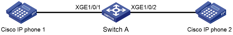

Example: Configuring CDP-compatible LLDP
As shown in Figure 6, Ten-GigabitEthernet 1/0/1 and Ten-GigabitEthernet 1/0/2 of Switch A are each connected to a Cisco IP phone, which sends tagged voice traffic.
Configure voice VLAN 2 on Switch A. Enable CDP compatibility of LLDP on Switch A to allow the Cisco IP phones to automatically configure the voice VLAN. The voice VLAN feature performs the following operations:
· Confines the voice traffic to the voice VLAN.
· Isolates the voice traffic from other types of traffic.
1. Configure a voice VLAN on Switch A:
# Create VLAN 2.
<SwitchA> system-view
[SwitchA] vlan 2
[SwitchA-vlan2] quit
# Set the link type of Ten-GigabitEthernet 1/0/1 and Ten-GigabitEthernet 1/0/2 to trunk, and enable voice VLAN on them.
[SwitchA] interface ten-gigabitethernet 1/0/1
[SwitchA-Ten-GigabitEthernet1/0/1] port link-type trunk
[SwitchA-Ten-GigabitEthernet1/0/1] voice-vlan 2 enable
[SwitchA-Ten-GigabitEthernet1/0/1] quit
[SwitchA] interface ten-gigabitethernet 1/0/2
[SwitchA-Ten-GigabitEthernet1/0/2] port link-type trunk
[SwitchA-Ten-GigabitEthernet1/0/2] voice-vlan 2 enable
[SwitchA-Ten-GigabitEthernet1/0/2] quit
2. Configure CDP-compatible LLDP on Switch A:
# Enable LLDP globally, and enable CDP compatibility globally.
[SwitchA] lldp global enable
[SwitchA] lldp compliance cdp
# Enable LLDP on Ten-GigabitEthernet 1/0/1. By default, LLDP is enabled on ports.
[SwitchA-Ten-GigabitEthernet1/0/1] lldp enable
# Configure LLDP to operate in TxRx mode on Ten-GigabitEthernet 1/0/1.
[SwitchA-Ten-GigabitEthernet1/0/1] lldp admin-status txrx
# Configure CDP-compatible LLDP to operate in TxRx mode on Ten-GigabitEthernet 1/0/1.
[SwitchA-Ten-GigabitEthernet1/0/1] lldp compliance admin-status cdp txrx
# Enable LLDP on Ten-GigabitEthernet 1/0/2. By default, LLDP is enabled on ports.
[SwitchA-Ten-GigabitEthernet1/0/2] lldp enable
# Configure LLDP to operate in TxRx mode on Ten-GigabitEthernet 1/0/2.
[SwitchA-Ten-GigabitEthernet1/0/2] lldp admin-status txrx
# Configure CDP-compatible LLDP to operate in TxRx mode on Ten-GigabitEthernet 1/0/2.
[SwitchA-Ten-GigabitEthernet1/0/2] lldp compliance admin-status cdp txrx
# Verify that Switch A has completed the following operations:
· Discovering the IP phones connected to Ten-GigabitEthernet 1/0/1 and Ten-GigabitEthernet 1/0/2.
· Obtaining IP phone information.
[SwitchA] display lldp neighbor-information
CDP neighbor-information of port 1[Ten-GigabitEthernet1/0/1]:
LLDP agent nearest-bridge:
CDP neighbor index : 1
Chassis ID : SEP00141CBCDBFE
Port ID : Port 1
CDP neighbor-information of port 2[Ten-GigabitEthernet1/0/2]:
CDP neighbor index : 2
Chassis ID : SEP00141CBCDBFF
Port ID : Port 1

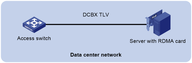

DCBX application scenario
Figure 7 DCBX application scenario
DCBX enables lossless packet transmission on DCE networks.
As shown in Figure 7, DCBX applies to an RoCE-based data center network, and operates on an access switch. DCBX enables the switch to control the server or storage adapter, and simplifies the configuration and guarantees configuration consistency. DCBX extends LLDP by using the IEEE 802.1 organizationally specific TLVs (DCBX TLVs) to transmit DCBX data, including:
· In DCBX Rev 1.00 and DCBX Rev 1.01:
¡ Application Protocol (APP).
¡ Enhanced Transmission Selection (ETS).
¡ Priority-based Flow Control (PFC).
· In IEEE Std 802.1Qaz-2011:
¡ ETS Configuration.
¡ ETS Recommendation.
¡ PFC.
¡ APP.
H3C devices can send these types of DCBX information to a server or storage adapter. However, H3C devices cannot accept these types of DCBX information.

DCBX configuration examples
Example: Configuring DCBX
As shown in Figure 8, Ten-GigabitEthernet 1/0/1 of the access switch (Switch A) connects to the RDMA adapter of the data center server (DC server).
Configure Switch A to implement lossless RoCE frame transmission to DC server.
NOTE: In this example, both Switch A and the DC server support DCBX Rev 1.01. |
1. Enable LLDP and DCBX TLV advertising:
# Enable LLDP globally.
# Enable LLDP and DCBX TLV advertising on Ten-GigabitEthernet 1/0/1.
[SwitchA-Ten-GigabitEthernet1/0/1] lldp tlv-enable dot1-tlv dcbx
2. Set the DCBX version to Rev. 1.01 on Ten-GigabitEthernet 1/0/1.
[SwitchA-Ten-GigabitEthernet1/0/1] dcbx version rev101
3. Enable byte-count WRR queuing on Ten-GigabitEthernet 1/0/1, and configure queue 3 on the interface to use SP queuing.
[SwitchA-Ten-GigabitEthernet1/0/1] qos wrr byte-count
[SwitchA-Ten-GigabitEthernet1/0/1] qos wrr 3 group sp
4. Configure PFC:
# Enable PFC in auto mode on Ten-GigabitEthernet 1/0/1.
[SwitchA-Ten-GigabitEthernet1/0/1] priority-flow-control auto
# Enable PFC for 802.1 priority 3.
[SwitchA-Ten-GigabitEthernet1/0/1] priority-flow-control no-drop dot1p 3
The DC server does not detect any packet loss during RoCE frame transmission.
