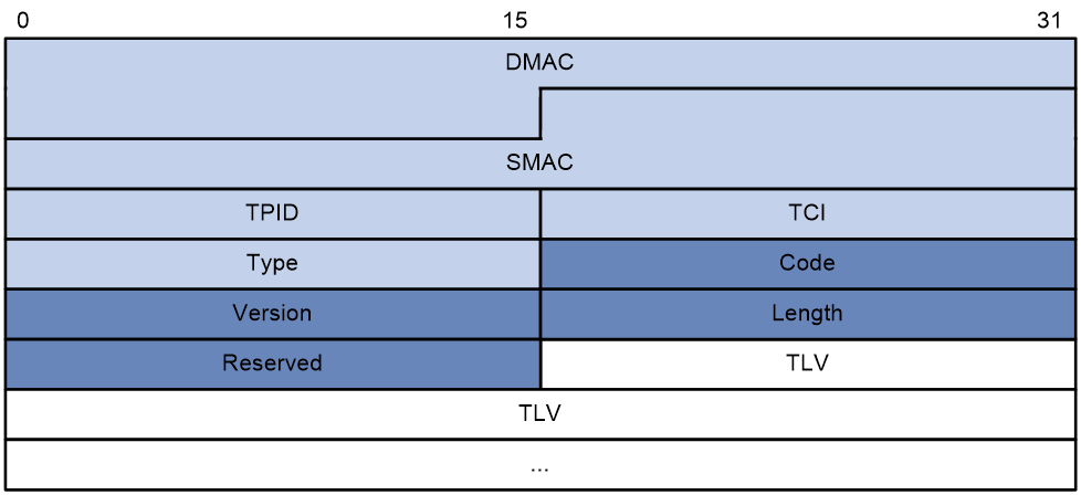

Figure 1 Ethernet frame header for loop detection
The Ethernet frame header of a loop detection packet contains the following fields:
·     DMACDestination MAC address of the frame, which is the multicast MAC address 010f-e200-0007. When a loop detection-enabled device receives a frame with this destination MAC address, it performs the following operations:
¡     Sends the frame to the CPU.
¡     Floods the frame in the VLAN from which the frame was originally received.
·     SMACSource MAC address of the frame, which is the bridge MAC address of the sending device.
·     TPIDType of the VLAN tag, with the value of 0x8100.
·     TCIInformation of the VLAN tag, including the priority and VLAN ID.
·     TypeProtocol type, with the value of 0x8918.
Figure 2 Inner frame header for loop detection
The inner frame header of a loop detection packet contains the following fields:
·     CodeProtocol sub-type, which is 0x0001, indicating the loop detection protocol.
·     VersionProtocol version, which is always 0x0000.
·     LengthLength of the frame. The value includes the inner header, but excludes the Ethernet header.
·     ReservedThis field is reserved.
Frames for loop detection are encapsulated as TLV triplets.

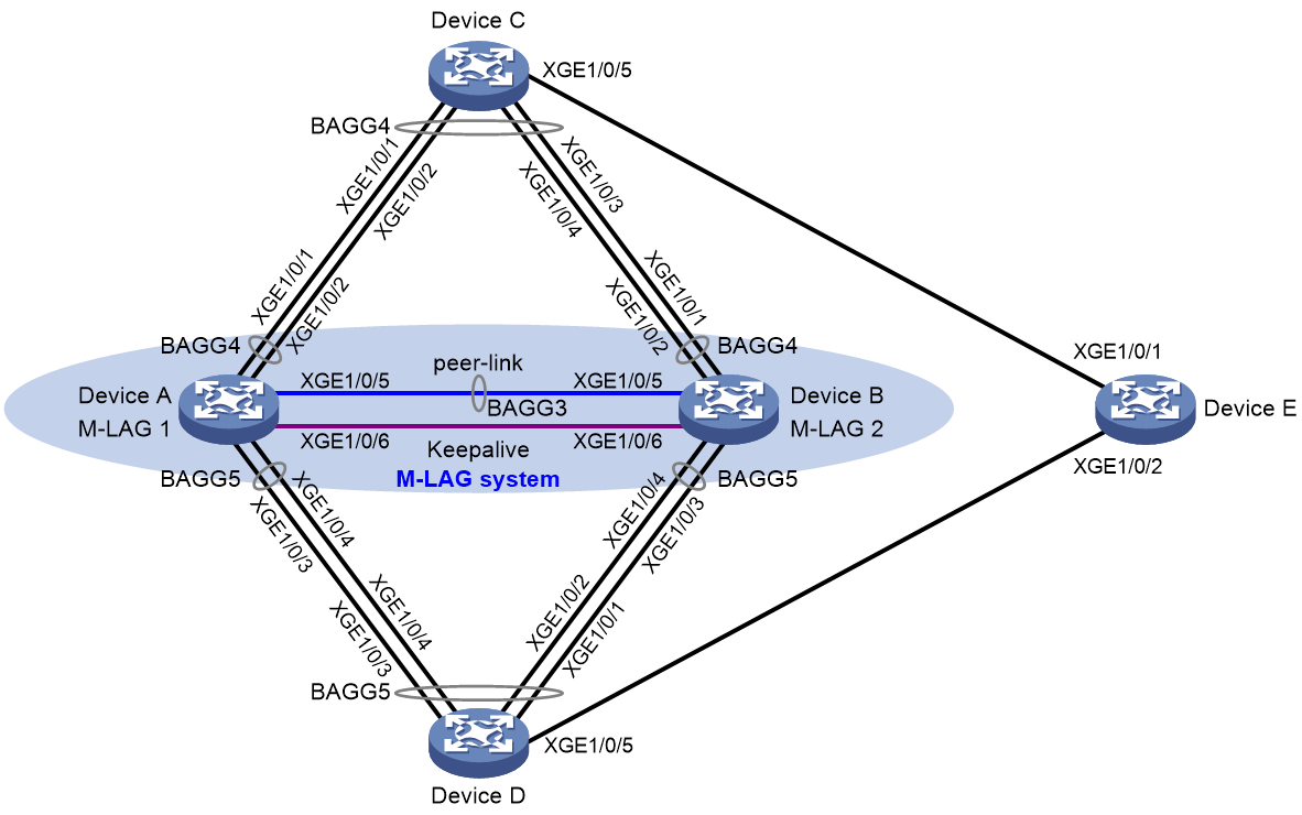

Example: Configuring loop detection on an M-LAG system
As shown in Figure 4, configure loop detection on the M-LAG system formed by Device A and Device B to meet the following requirements:
·     Generates a log as a notification.
·     Automatically shuts down the interface on which a loop is detected.

# View the system logs on Device A.
[DeviceA]
%Aug  1 03:28:48:110 2019 DeviceA LPDT/4/LPDT_LOOPED: A loop was detected on
 Bridge-Aggregation4.
%Aug  1 03:28:48:191 2019 DeviceA LPDT/4/LPDT_VLAN_LOOPED: A loop was detect
ed on Bridge-Aggregation4 in VLAN 100.
%Aug  1 03:28:48:194 2019 DeviceA LPDT/4/LPDT_LOOPED: A loop was detected on
 Bridge-Aggregation5.
%Aug  1 03:28:48:288 2019 DeviceA LPDT/4/LPDT_VLAN_LOOPED: A loop was detect
ed on Bridge-Aggregation5 in VLAN 100.
%Aug  1 03:28:48:290 2019 DeviceA LPDT/5/LPDT_VLAN_RECOVERED: A loop was rem
oved on Bridge-Aggregation4 in VLAN 100.
%Aug  1 03:28:48:291 2019 DeviceA LPDT/5/LPDT_RECOVERED: All loops were remo
ved on Bridge-Aggregation4.
%Aug  1 03:28:48:302 2019 DeviceA LPDT/5/LPDT_VLAN_RECOVERED: A loop was rem
oved on Bridge-Aggregation5 in VLAN 100.
%Aug  1 03:28:48:304 2019 DeviceA LPDT/5/LPDT_RECOVERED: All loops were remo
ved on Bridge-Aggregation5.
The output shows the following information:
·     Device A detected loops on Bridge-Aggregation 4 and Bridge-Aggregation 5 within a loop detection interval.
·     Loops on Bridge-Aggregation 4 and Bridge-Aggregation 5 were removed.
# Use the display loopback-detection command to display the loop detection configuration and status on Device A.
[DeviceA] display loopback-detection
Loop detection is enabled.
Global loop detection interval is 35 second(s).
Loop is detected on following interfaces:
  Interface                       Action mode     VLANs/VSI
  Bridge-Aggregation4             Shutdown        100
  Bridge-Aggregation5             Shutdown        100
The output shows that the device has removed the loops from Bridge-Aggregation 4 and Bridge-Aggregation 5 according to the shutdown action.
# Verify that Bridge-Aggregation 4 has been shut down by loop detection.
[DeviceA] display interface Bridge-Aggregation 4
Bridge-Aggregation4
The interface has assigned a M-LAG group.
Current state: DOWN (Loopback detection down)
# Verify that Bridge-Aggregation 5 has been shut down by loop detection.
[DeviceA] display interface Bridge-Aggregation 5
Bridge-Aggregation5
# Verify that loops have been removed on Device B. (Details not shown.)

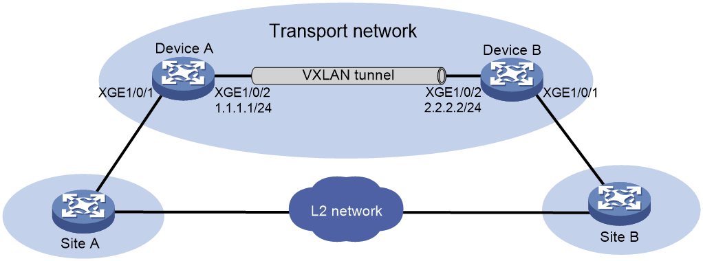

Configuring loop detection in a VXLAN network
About loop detection in a VXLAN network
Loop detection periodically checks for Layer 2 loops in a VXLAN network. The mechanism immediately generates a log when a loop occurs so that you are promptly notified to adjust network connections and configurations. You can configure loop detection to block a looped attachment circuit (AC). Logs are maintained in the information center. For more information, see Network Management and Monitoring Configuration Guide.
Application scenario

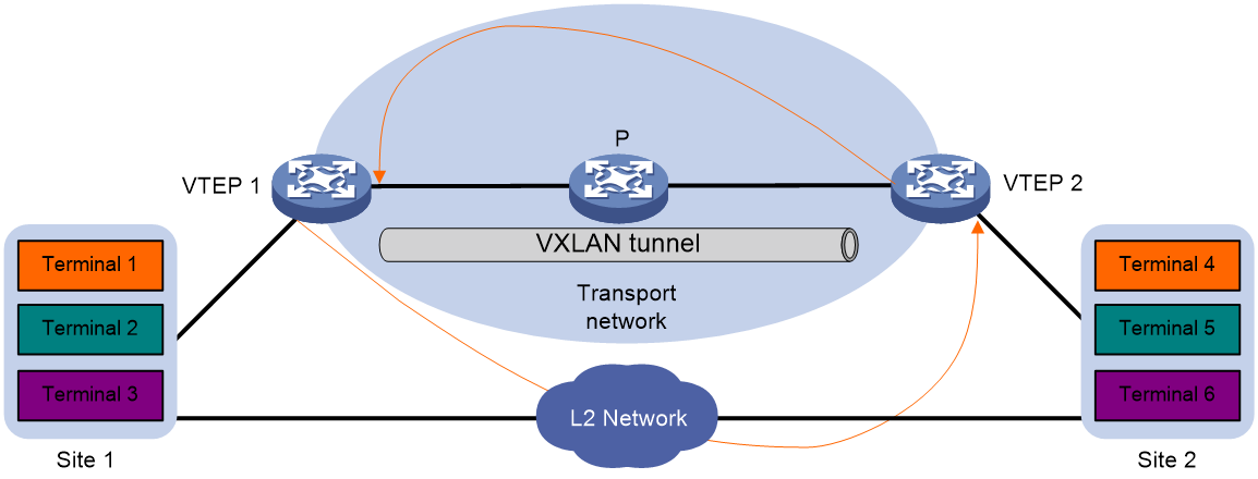

As shown in Figure 5, two VTEPs provide data transmission services for site 1 and site 2. Because the sites also have Layer 2 connectivity, broadcast storms can spread across the sites.
To remove loops from the VXLAN network, configure loop detection on the VTEPs. When a VTEP detects a loop on an AC, it blocks the AC to remove the loop.

Loop detection frame format
As shown in Figure 6, a loop detection frame contains the Ethernet header, loop detection header, and loop detection TLVs.
Figure 6 Loop detection frame format
The Ethernet frame header of a loop detection frame contains the following fields:
·     DMAC—Destination MAC address of the frame, which is the multicast MAC address 010f-e200-0007. When a loop detection-enabled device receives a frame with this destination MAC address, it performs the following operations:
¡     Floods the frame in the VLAN from which the frame was received.
·     SMAC—Source MAC address of the frame, which is the bridge MAC address of the sending device.
·     TPID—Type of the VLAN tag, with the default value of 0x8100.
·     TCI—Tag control information, including the priority and VLAN ID.
·     Type—Protocol type, with the value of 0x8918.
The loop detection header of a loop detection frame contains the following fields:
·     Code—Protocol sub-type, which is 0x0001, indicating the loop detection type.
·     Version—Protocol version, which is reserved. This field is fixed at 0x0000.
·     Length—Length of the frame. The value includes the loop detection header, but excludes the Ethernet header.
·     Reserved—This field is reserved.
Payload of a loop detection frame is encapsulated as TLV triplets.

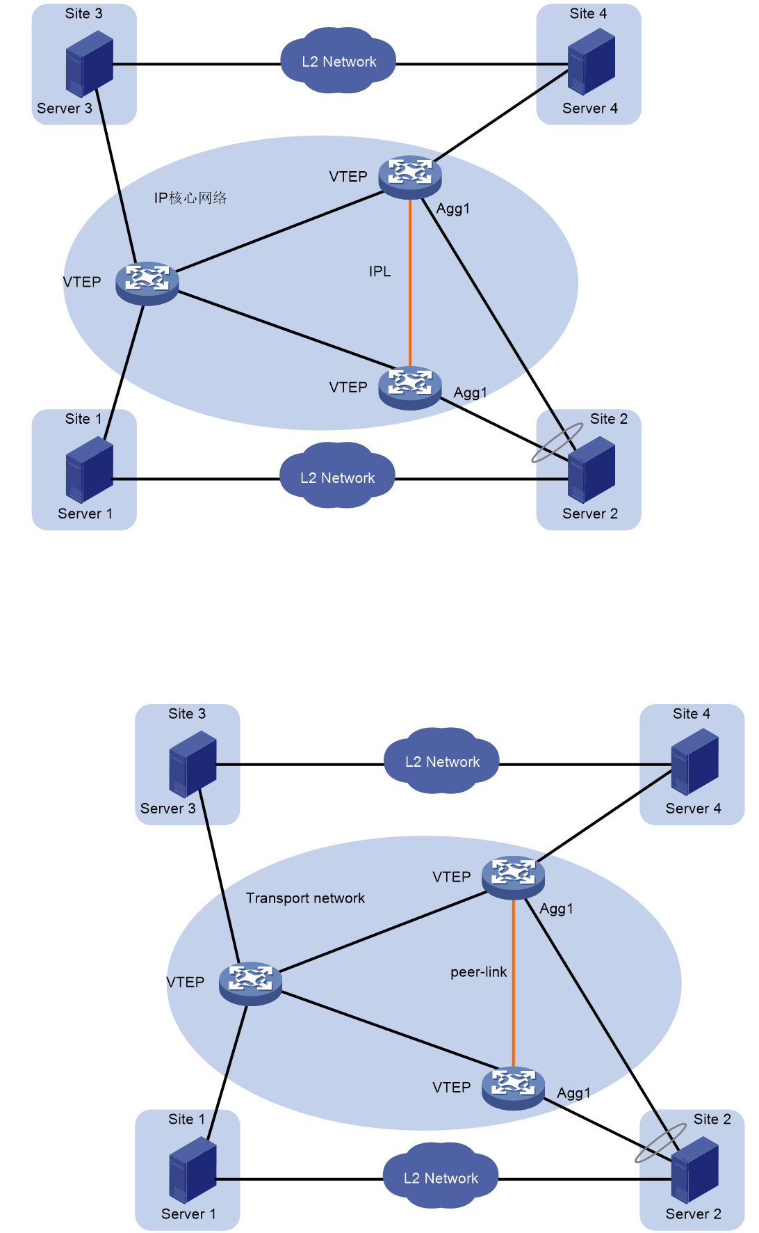

In a VXLAN network, M-LAG can virtualize two VTEPs into an M-LAG system that connects to the remote aggregation system through a multichassis aggregate link. To the remote aggregation system, the M-LAG system is one device. This prevents single points of failure from interrupting traffic forwarding and ensures high availability of the VXLAN network. For more information about M-LAG, see "Configuring M-LAG."
Figure 7 Network diagram
As shown in Figure 7, if an endpoint is dualhomed to the M-LAG system, you must enable loop detection on both VTEPs in the M-LAG system. Loop detection works as follows on the VTEPs:
1.     The VTEPs send loop detection frames out of the ACs configured on the M-LAG interfaces facing the endpoint. The loop detection frames contain the same source MAC address, VLAN tag, loop detection interval, and loop detection priority. The source MAC address is the M-LAG system MAC address.
2.     When receiving loop detection frames on a local M-LAG interface, a VTEP sends the loop detection frames to the peer VTEP over the peer link. This synchronization mechanism ensures that a VTEP can receive loop detection frames in case of link or interface failure.
3.     If a VTEP receives a self-sent loop detection frame from an AC, the VTEP compares the loop detection priority of the AC with that in the frame and acts as follows:
¡     If the loop detection priority in the frame is higher, the VTEP performs the loop protection action on all ACs configured for the M-LAG group that accommodates the looped M-LAG interface.
¡     If the loop detection priority of the AC is higher, the system only records the loop information.
If an endpoint is singlehomed to one VTEP in the M-LAG system, enable loop detection only on that VTEP. Loop detection works as follows on the VTEP:
1.     The VTEP sends loop detection frames out of the ACs configured on the M-LAG interface facing the endpoint. The source MAC address is the M-LAG system MAC address.
2.     If the VTEP receives a self-sent loop detection frame from an AC, the VTEP compares the loop detection priority of the AC with that in the frame and acts as follows:
¡     If the loop detection priority in the frame is higher, the VTEP performs the loop protection action on the looped AC.

Example: Configuring local site loop detection
As shown in Figure 8, Device A and Device B provide user traffic transmission service for site 1 and site 2, and the sites have Layer 2 connectivity in VLAN 10. Configure loop detection on Device A and Device B so that they can block ACs if loops exist.
Figure 8 Network diagram
