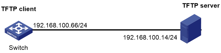

Example: Using the switch as a TFTP client to upgrade software
As shown in Figure 1, use TFTP to download a software upgrade file from a TFTP server to upgrade the switch.
Figure 1 Network diagram

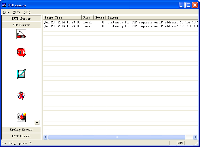

1.     Configure the TFTP server:
# Assign the IP address 192.168.100.14/24 to the TFTP server. (Details not shown.)
# Start the TFTP server and specify a working directory. This example uses the 3CDaemon TFTP server. (Details not shown.)
Figure 2 Configuring the TFTP server

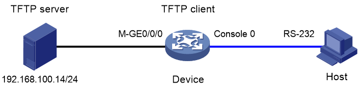

Example: Using the switch as an FTP client to upgrade software
As shown in Figure 3, use FTP to download a software upgrade file from an FTP server to upgrade the switch.
Figure 3 Network diagram

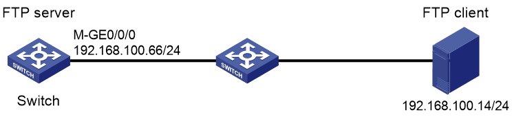

Example: Using the switch as an FTP server to upgrade software
As shown in Figure 5:
·     Enable the FTP server on the switch.
·     Use FTP to upload a software upgrade file from an FTP client to upgrade the switch.
Figure 5 Network diagram

[Switch-luser-abc] service-type ftp
[Switch-luser-abc] quit
# Enable the FTP server.
[Switch] ftp server enable
[Switch] quit
# Save the configuration.
<Switch> save
The current configuration will be written to the device. Are you sure? [Y/N]:y
Please input the file name(*.cfg)[flash:/startup.cfg]
(To leave the existing filename unchanged, press the enter key):
flash:/startup.cfg exists, overwrite? [Y/N]:y
Validating file. Please wait...
Saved the current configuration to mainboard device successfully.

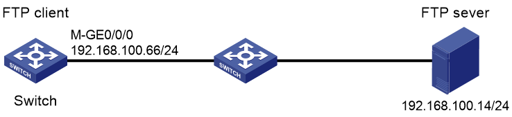

Example: Using the device as a TFTP client to upgrade software
As shown in Figure 6, the device cannot start up.
Use TFTP to upgrade the device from the BootWare menu.
Figure 6 Network diagram

Example: Upgrading a feature
As shown in Figure 6, use TFTP to download feature-t0001016.ipe from the TFTP server to the TFTP client and use it to upgrade the Feature feature from T0001015 to T0001016.
Figure 7 Network diagram
Figure 8 Configuring the TFTP server

<Sysname> install add flash:/feature-t0001016.ipe flash:
Verifying the file flash:/feature-t0001016.ipe on slot 1...Done.
Decompressing file feature-t0001016.bin to flash:/feature-t0001016.bin.......................Done.
# Display active software images.
<Sysname> display install active
Active packages on slot 1:
  flash:/boot-t0001015.bin
  flash:/system-t0001015.bin
  flash:/feature-t0001015.bin
# Identify the recommended ISSU methods and possible impact of the upgrade.
<Sysname> install activate feature flash:/feature-t0001016.bin slot 1 test
Verifying the file flash:/feature1-t0001016.bin on slot 1...Done.
Upgrade summary according to following table:
  Running Version             New Version
  Test 0001015                Test 0001016
Upgrade Way: Service Upgrade
Influenced service according to following table on slot 1:
         Feature
The output shows that an incremental upgrade is recommended and the Feature module will be rebooted during the upgrade.
# Activate the new Feature image to upgrade the Feature feature.
Verifying the file flash:/feature-t0001016.bin on slot 1...Done.
Upgrading software images to compatible versions. Continue? [Y/N]:y
This operation might take several minutes, please wait...Done.
# Verify that the switch is running the new Feature image.
# Commit the software changes.
<Sysname> install commit
This operation will take several minutes, please wait...........................Done.
The current software images have been saved as the startup software images.
Current software images on slot 1:
Configuration files
The system does not save the commands used in this procedure to a configuration file.
