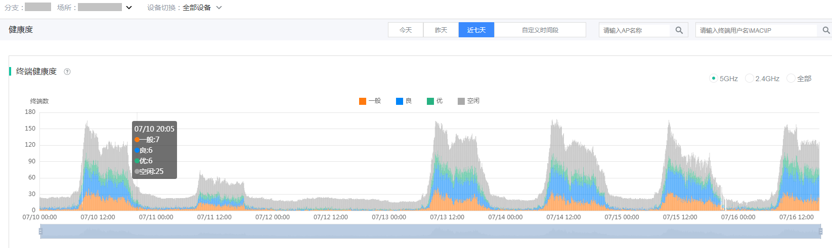

# View the health status of clients to identify whether the number of clients with a health score of excellent and good has increased.
Figure 2 Client health status

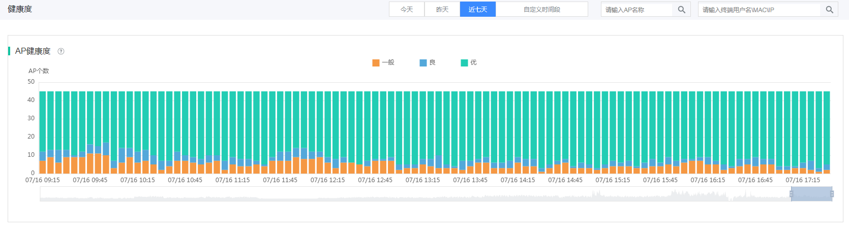

# View the health status of APs to identify whether the number of APs with a health score of excellent and good has increased.
Figure 3 AP health status
