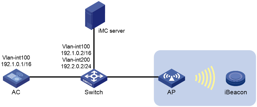

As shown in Figure 1, configure the AP to manage the iBeacon device. The AP collects BLE information and sends the information to the location server on the IMC server for calculation. Then, users can obtain information including electric quantity and RSSI of the iBeacon device. The AP also assigns management orders from the server to the iBeacon device.
Use the actual serial ID of an AP to uniquely identify that AP.

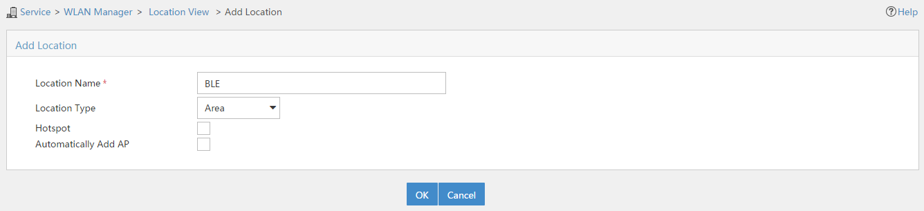

1. Add a location:
a. Click the Service tab.
b. From the navigation tree, select WLAN Manager > Location View.
c. Click Add.
The Add Location page opens.
d. Configure the following parameters, as shown in Figure 2:
- Enter BLE in the Location Name field.
- Use the default settings for other parameters.
e. Click OK.
Figure 2 Adding a location

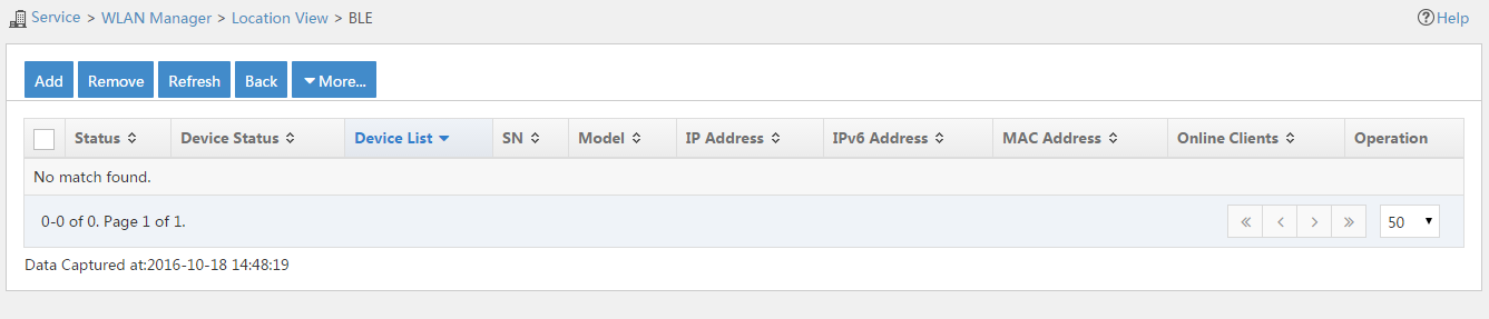

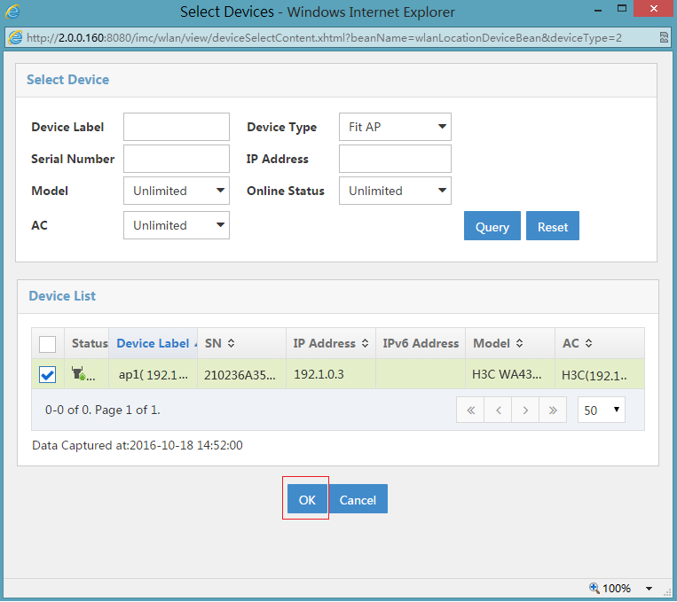

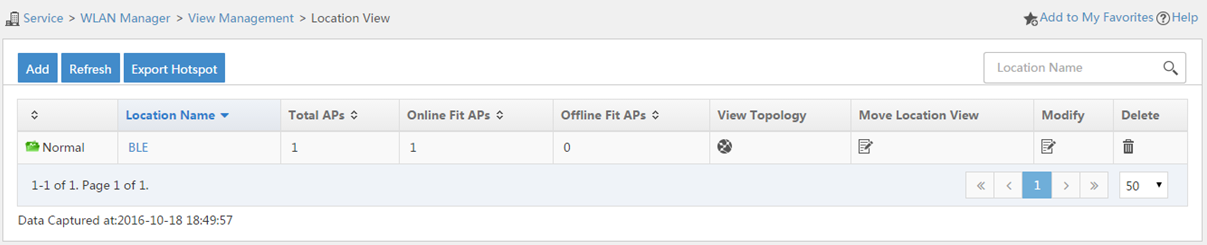

2. Add a Bluetooth AP:
a. On the newly created location view page, click Add, as shown in Figure 3.
The Select Devices page opens.
b. On the Device List area, select the target Bluetooth AP, as shown in Figure 4.
Figure 3 Adding a Bluetooth AP
Figure 4 Selecting a Bluetooth AP
