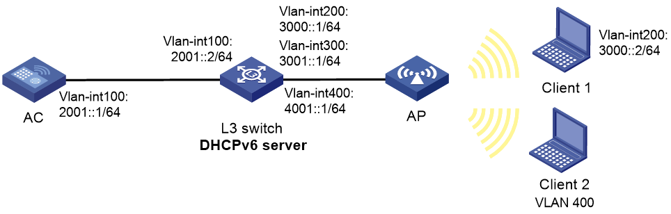

Example: Configuring IPv6 WLAN access
As shown in Figure 1, the Layer 3 switch acts as a DHCP server to assign IPv6 addresses to the AP and Client 1 and assign an IPv6 prefix to Client 2. Configure wireless services to ensure that the WLAN uses IPv6 addresses and Client 1 and Client 2 can access the WLAN. Assume that centralized forwarding is used in this example.
When you configure IPv6 access, follow these restrictions and guidelines:
· Use the serial ID labeled on the AP's rear panel to specify an AP.
· To prevent too many packets from entering VLAN 1, configure the switch's interface that connects the switch to the AP to deny packets from VLAN 1.
