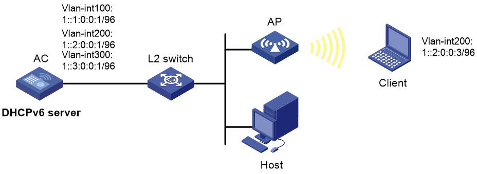

Example: Configuring an AP to associate with the AC at Layer 2 (IPv6)
As shown in Figure 1, the AC acts as a DHCPv6 server to assign IPv6 addresses to the AP, client, and host, and the Layer 2 switch supplies power to the AP through PoE. Assume centralized forwarding is used in this example.
Configure wireless services to enable the client to access the wireless services and communicate with the host.
Figure 1 Network diagram
Procedures

Configuring the Layer 2 switch
# Create VLANs 100, 200, and 300. The switch will use VLAN 100 to forward packets between AC and AP. VLAN 200 will be used for client access. VLAN 300 will be used for host access.

# Verify that the AP is in R/M state.
<AC> display wlan ap all
Total number of APs: 1
Total number of connected APs: 1
Total number of connected manual APs: 1
Total number of connected auto APs: 0
Total number of connected common APs: 1
Total number of connected WTUs: 0
Total number of inside APs: 0
Maximum supported APs: 3072
Remaining APs: 3071
Total AP licenses: 512
Local AP licenses: 512
Server AP licenses: 0
Remaining Local AP licenses: 511
Sync AP licenses: 0
                                 AP information
 State : I = Idle,      J  = Join,       JA = JoinAck,    IL = ImageLoad
         C = Config,    DC = DataCheck,  R  = Run,   M = Master,  B = Backup
AP name                APID    State   Model             Serial ID
officeap               1       R/M     WA6320            219801A28N819CE0002T
# Verify that the client is connected to radio 1 on AP officeap.
<AC> display wlan client ipv6
Total number of clients: 1
MAC address    AP name               IPv6 address                            VLAN
784f-43b6-077c officeap              1::2:0:0:3                              200
# Verify that the client and the host can ping each other successfully.
C:\Users\system32>ping 1::2:0:0:3 -t
Pinging 1::2:0:0:3 with 32 bytes of data:
Reply from 1::2:0:0:3: bytes=32 time=8ms TTL=255
Reply from 1::2:0:0:3: bytes=32 time<1ms TTL=255
Ping statistics for 1::2:0:0:3:
    Packets: Sent = 11, Received = 11, Lost = 0 (0% loss),
    Minimum = 0ms, Maximum = 8ms, Average = 0ms
Control-C
^C
C:\Users\system32>

 port link-type trunk
 undo port trunk permit vlan 1
 port trunk permit vlan 100 200 300
 port trunk pvid vlan 100
wlan ap-group group1
 ap officeap
 ap-model WA6320
  radio 1
   radio enable
   service-template 1 vlan 200
  radio 2
wlan ap officeap model WA6320
 serial-id 219801A28N819CE0002T
·     Layer 2 switch:
vlan 100
vlan 200
vlan 300
 port trunk permit vlan 1 100 200 300
 poe enable
 port access vlan 300
