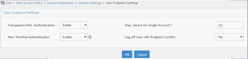

5.     From the navigation tree, select User Access Policy > Service Parameters > Validate System Configuration to make the configuration take effect.
6.     Configure system parameters:
a.     From the navigation tree, select User Access Policy > Service Parameters > System Settings.
b.     Click the Configure icon 说明: 2013-07-29_144255.png for User Endpoint Settings to open the page as shown in Figure 11.
c.     Select Enable for Transparent MAC Authentication.
d.     Select whether to enable transparent portal authentication on non-smart devices.
In this example, select Enable for Non-Terminal Authentication.
e.     Click OK.
Figure 11 Configuring user endpoint settings

1.     Verify that the client needs to pass portal authentication when the client attempts to come online for the first time.
In this case, the RADIUS server does not have the user and its MAC address information. The AC determines that the user has failed the MAC authentication and performs portal authentication for the user.
# Display information about all online portal users on the AC.
[AC] display portal user all
Total portal users: 1
Username: client
  AP name: office
  Radio ID: 2
  SSID: service
  Portal server: newpt
  State: Online
  VPN instance: N/A
  MAC             IP                    VLAN    Interface
  0021-6330-0933  2.2.2.2               200     WLAN-BSS1/0/2
  Authorization information:
    DHCP IP pool: N/A
    User profile: N/A
    Session group profile: N/A
    ACL number: N/A
    Inbound CAR: N/A
     Outbound CAR: N/A
2.     Log out then log in again.
After the client passes portal authentication, the RADIUS server records the user and MAC address information. When the client goes offline and then tries to access the network again, the AC determines that the client has passed MAC authentication and does not perform portal authentication for the client, either.
3.     Verify that the client has passed MAC authentication.
# Display information about online MAC authentication users on the AC.
[AC] display mac-authentication connection
User MAC address              : 0021-6330-0933
AP name                         : office
Radio ID                        : 2
SSID                             : service
BSSID                            : 70ba-efaf-ddb0
Username                        : 002163300933
Authentication domain         : dm2
Initial VLAN                   : 200
Authorization VLAN            : 200
Authorization ACL number      : N/A
Authorization user profile    : N/A
Termination action            : Default
Session timeout period        : 86401 s
Online from                   : 2016/04/22 18:56:20
