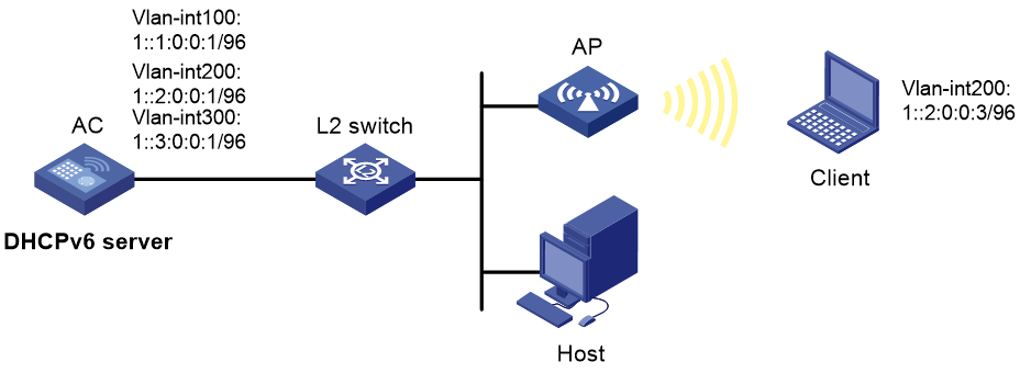

Example: Configuring an AP to associate with the AC at Layer 2 (IPv6)
As shown in Figure 1, the AC acts as a DHCPv6 server to assign IPv6 addresses to the AP, client, and host, and the Layer 2 switch supplies power to the AP through PoE. Assume centralized forwarding is used in this example.
Configure wireless services to enable the client to access the wireless services and communicate with the host.
Figure 1 Network diagram

 port link-type trunk
 undo port trunk permit vlan 1
 port trunk permit vlan 100 200 300
 port trunk pvid vlan 100
wlan ap-group group1
 ap officeap
 ap-model WA6320
  radio 1
   radio enable
   service-template 1 vlan 200
  radio 2
wlan ap officeap model WA6320
 serial-id 219801A28N819CE0002T
·     Layer 2 switch:
vlan 100
vlan 200
vlan 300
 port trunk permit vlan 1 100 200 300
 poe enable
 port access vlan 300
