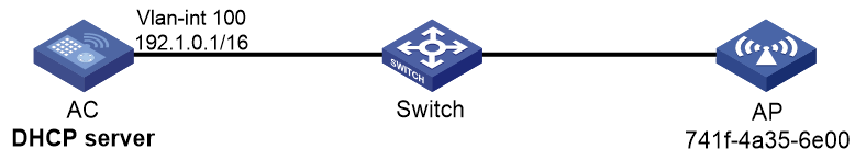

As shown in Figure 1, the AC acts as the DHCP server to assign an IP address to the AP. Enable the auto AP feature so that the AP can connect to the AC without manual configuration and can be automatically converted to a manual AP after coming online.
Figure 1 Network diagram
