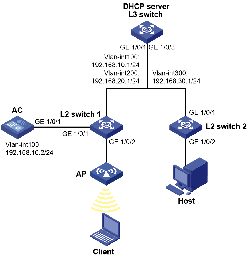

Example: Configuring an AP to associate with the AC at Layer 2
As shown in Figure 1, the AC is attached to a Layer 2 switch, and the Layer 3 switch acts as a DHCP server to assign IP addresses to the AP, client, and host. Assume centralized forwarding is used in this example.
Configure the following settings for the client to communicate with the host:
·     Configure the client to access the WLAN through VLAN 200, and the host to access the network through VLAN 300.
·     Assign the AC to VLAN 100, and configure the AC to establish tunnels with the AP through a Layer 2 network.
·     Configure Layer 2 switch 1 to supply power to the AP through PoE.
Figure 1 Network diagram
Analysis
·     For the AP, the client, and the host to obtain IP addresses through DHCP, enable the DHCP server feature on the Layer 3 switch.
·     For Layer 2 switch 1 to supply power to the AP, enable PoE on the switch.
·     For the client to access the network, configure wireless services on the AC.
When you configure AP's association with the AC at Layer 2, follow these restrictions and guidelines:
·     Use the serial ID labeled on the AP's rear panel to specify an AP.
·     Set the link type of the switch's interface that connects Layer 2 switch 1 to the AP to access. Configure the interface to deny packets from VLAN 1 in case there are too many packets in VLAN 1.

Configuration files
·     Layer 3 switch:
 dhcp enable
vlan 1
vlan 100
vlan 200
vlan 300
dhcp server ip-pool 1
 gateway-list 192.168.10.1
 network 192.168.10.0 mask 255.255.255.0
 static-bind ip-address 192.168.10.2 mask 255.255.255.0 hardware-address 000f-e212-3510
dhcp server ip-pool 2
 gateway-list 192.168.20.1
 network 192.168.20.0 mask 255.255.255.0
 dns-list 192.168.20.1
dhcp server ip-pool 3
 gateway-list 192.168.30.1
 network 192.168.30.0 mask 255.255.255.0
 dns-list 192.168.30.1
interface Vlan-interface100
 ip address 192.168.10.1 255.255.255.0
interface Vlan-interface200
 ip address 192.168.20.1 255.255.255.0
interface Vlan-interface300
 ip address 192.168.30.1 255.255.255.0
 port link-type trunk
 undo port trunk permit vlan 1
port trunk permit vlan 100 200
 port trunk permit vlan 300
·     AC:
wlan service-template 1
 ssid service
 client forwarding-location ac
 akm mode psk
 preshared-key pass-phrase cipher $c$3$9tIUHSkAUVqCH9/EPrL26ldkcEQnngexUEFj
 cipher-suite ccmp
 security-ie rsn
 service-template enable
port trunk pvid vlan 100
wlan ap-group group1
 ap officeap
 ap-model WA6320
  radio 1
   radio enable
   service-template 1 vlan 200
  radio 2
wlan ap officeap model WA6320
 serial-id 219801A28N819CE0002T
·     Layer 2 switch 1:
vlan 100
vlan 200
 port link-type access
 port access vlan 100
 poe enable
·     Layer 2 switch 2:
vlan 300
 port access vlan 300
 poe enable
