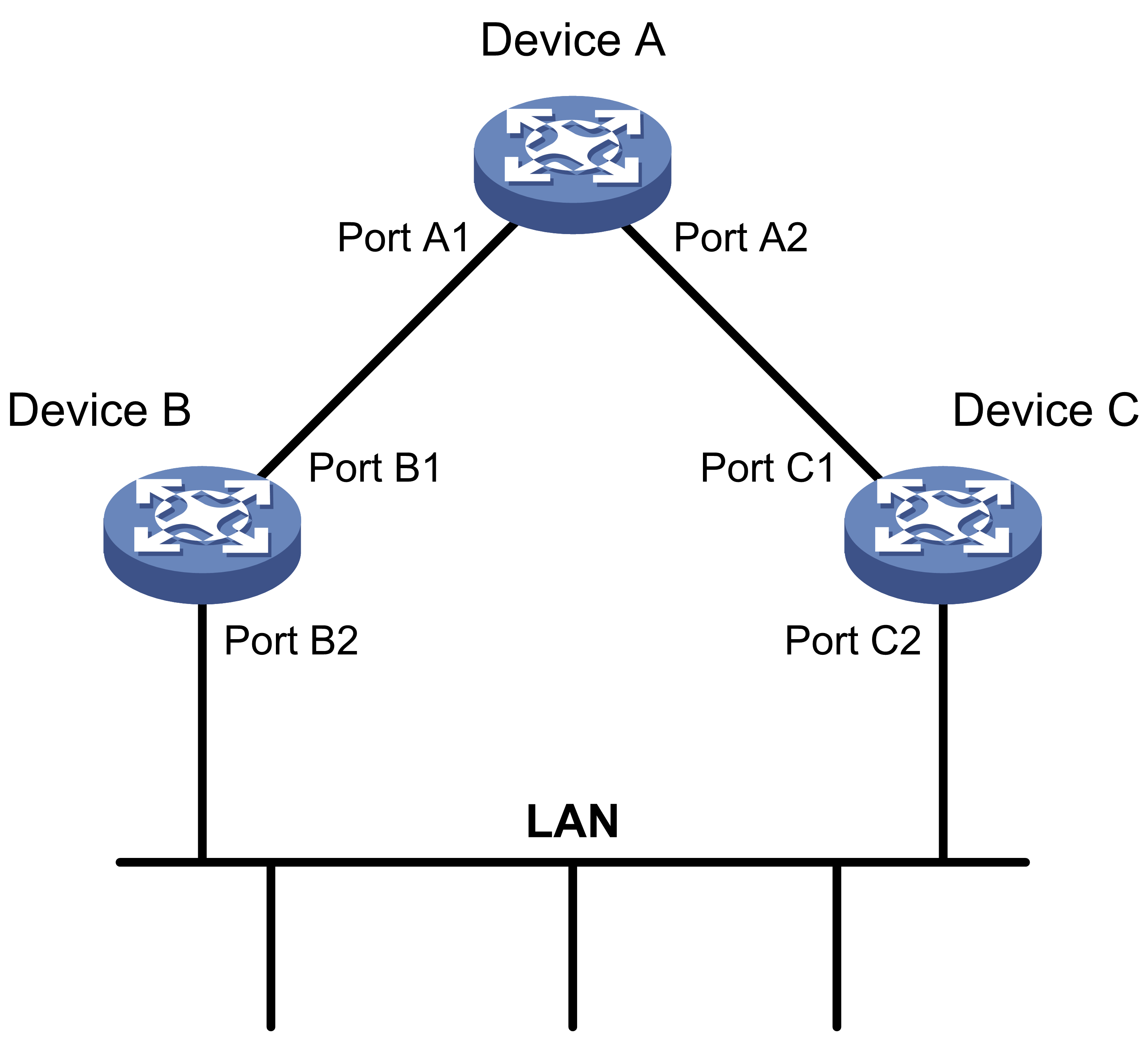

As shown in Figure 3, Device B and Device C are directly connected to a LAN.
If Device A forwards BPDUs to Device B through port A1, the designated bridge and designated port are as follows:
·     The designated bridge for Device B is Device A.
·     The designated port for Device B is port A1 on Device A.
If Device B forwards BPDUs to the LAN, the designated bridge and designated port are as follows:
·     The designated bridge for the LAN is Device B.
·     The designated port for the LAN is port B2 on Device B.
Figure 3 Designated bridges and designated ports

Figure 4 provides an example showing how the STP algorithm works.
Figure 4 The STP algorithm
As shown in Figure 4, the priority values of Device A, Device B, and Device C are 0, 1, and 2, respectively. The path costs of links among the three devices are 5, 10, and 4.
Device state initialization
In Table 3, each configuration BPDU contains the following fields: root bridge ID, root path cost, designated bridge ID, and designated port ID.
Table 3 Initial state of each device
Device
Port name
Configuration BPDU on the port
Device A
Port A1
{0, 0, 0, Port A1}
Port A2
{0, 0, 0, Port A2}
Device B
Port B1
{1, 0, 1, Port B1}
Port B2
{1, 0, 1, Port B2}
Device C
Port C1
{2, 0, 2, Port C1}
Port C2
{2, 0, 2, Port C2}
Configuration BPDUs comparison on each device
In Table 4, each configuration BPDU contains the following fields: root bridge ID, root path cost, designated bridge ID, and designated port ID.
Table 4 Comparison process and result on each device
Device
Comparison process
Configuration BPDU on ports after comparison
Device A
Port A1 performs the following operations:
1.     Receives the configuration BPDU of Port B1 {1, 0, 1, Port B1}.
2.     Determines that its existing configuration BPDU {0, 0, 0, Port A1} is superior to the received configuration BPDU.
3.     Discards the received one.
Port A2 performs the following operations:
1.     Receives the configuration BPDU of Port C1 {2, 0, 2, Port C1}.
2.     Determines that its existing configuration BPDU {0, 0, 0, Port A2} is superior to the received configuration BPDU.
Device A determines that it is both the root bridge and designated bridge in the configuration BPDUs of all its ports. It considers itself as the root bridge. It does not change the configuration BPDU of any port and starts to periodically send configuration BPDUs.
·     Port A1: {0, 0, 0, Port A1}
·     Port A2: {0, 0, 0, Port A2}
Device B
Port B1 performs the following operations:
4.     Receives the configuration BPDU of Port A1 {0, 0, 0, Port A1}.
5.     Determines that the received configuration BPDU is superior to its existing configuration BPDU {1, 0, 1, Port B1}.
6.     Updates its configuration BPDU.
Port B2 performs the following operations:
1.     Receives the configuration BPDU of Port C2 {2, 0, 2, Port C2}.
2.     Determines that its existing configuration BPDU {1, 0, 1, Port B2} is superior to the received configuration BPDU.
3.     Discards the received BPDU.
·     Port B1: {0, 0, 0, Port A1}
·     Port B2: {1, 0, 1, Port B2}
Device B performs the following operations:
1.     Compares the configuration BPDUs of all its ports.
2.     Decides that the configuration BPDU of Port B1 is the optimum.
3.     Selects Port B1 as the root port with the configuration BPDU unchanged.
Based on the configuration BPDU and path cost of the root port, Device B calculates a designated port configuration BPDU for Port B2 {0, 5, 1, Port B2}. Device B compares it with the existing configuration BPDU of Port B2 {1, 0, 1, Port B2}. Device B determines that the calculated one is superior, and determines that Port B2 is the designated port. It replaces the configuration BPDU on Port B2 with the calculated one, and periodically sends the calculated configuration BPDU.
·     Root port (Port B1): {0, 0, 0, Port A1}
·     Designated port (Port B2): {0, 5, 1, Port B2}
Device C
Port C1 performs the following operations:
1.     Receives the configuration BPDU of Port A2 {0, 0, 0, Port A2}.
2.     Determines that the received configuration BPDU is superior to its existing configuration BPDU {2, 0, 2, Port C1}.
3.     Updates its configuration BPDU.
Port C2 performs the following operations:
1.     Receives the original configuration BPDU of Port B2 {1, 0, 1, Port B2}.
2.     Determines that the received configuration BPDU is superior to the existing configuration BPDU {2, 0, 2, Port C2}.
·     Port C1: {0, 0, 0, Port A2}
·     Port C2: {1, 0, 1, Port B2}
Device C performs the following operations:
2.     Decides that the configuration BPDU of Port C1 is the optimum.
3.     Selects Port C1 as the root port with the configuration BPDU unchanged.
Based on the configuration BPDU and path cost of the root port, Device C calculates the configuration BPDU of Port C2 {0, 10, 2, Port C2}. Device C compares it with the existing configuration BPDU of Port C2 {1, 0, 1, Port B2}. Device C determines that the calculated configuration BPDU is superior to the existing one, selects Port C2 as the designated port, and replaces the configuration BPDU of Port C2 with the calculated one.
·     Root port (Port C1): {0, 0, 0, Port A2}
·     Designated port (Port C2): {0, 10, 2, Port C2}
1.     Receives the updated configuration BPDU of Port B2 {0, 5, 1, Port B2}.
2.     Determines that the received configuration BPDU is superior to its existing configuration BPDU {0, 10, 2, Port C2}.
1.     Receives a periodic configuration BPDU {0, 0, 0, Port A2} from Port A2.
2.     Determines that it is the same as the existing configuration BPDU.
·     Port C2: {0, 5, 1, Port B2}
Device C determines that the root path cost of Port C1 is larger than that of Port C2. The root path cost of Port C1 is 10, root path cost of the received configuration BPDU (0) plus path cost of Port C1 (10). The root path cost of Port C2 is 9, root path cost of the received configuration BPDU (5) plus path cost of Port C2 (4). Device C determines that the configuration BPDU of Port C2 is the optimum, and selects Port C2 as the root port with the configuration BPDU unchanged.
Based on the configuration BPDU and path cost of the root port, Device C performs the following operations:
1.     Calculates a designated port configuration BPDU for Port C1 {0, 9, 2, Port C1}.
2.     Compares it with the existing configuration BPDU of Port C1 {0, 0, 0, Port A2}.
3.     Determines that the existing configuration BPDU is superior to the calculated one and blocks Port C1 with the configuration BPDU unchanged.
Port C1 does not forward data until a new event triggers a spanning tree calculation process: for example, the link between Device B and Device C is down.
·     Blocked port (Port C1): {0, 0, 0, Port A2}
·     Root port (Port C2): {0, 5, 1, Port B2}
Final calculated spanning tree
After the comparison processes described in Table 4, a spanning tree with Device A as the root bridge is established, as shown in Figure 5.
Figure 5 The final calculated spanning tree

As shown in Figure 12, Port C3 is an edge port connected to a host. When a network topology change occurs, the port can immediately transit from the blocking state to the forwarding state because no loop will be caused.
Because a device cannot determine whether a port is directly connected to a terminal, you must manually configure the port as an edge port.
Figure 12 Edge port rapid transition

As shown in Figure 14, the P/A transition operates as follows:
1.     Device A sends a proposal BPDU to Device B through Port A1.
2.     Device B receives the proposal BPDU on Port B2. Port B2 is elected as the root port.
3.     Device B blocks its designated port Port B1 and alternate port Port B3 to eliminate loops.
4.     The root port Port B2 transits to the forwarding state and sends an agreement BPDU to Device A.
5.     The designated port Port A1 on Device A immediately transits to the forwarding state after receiving the agreement BPDU.
Figure 14 P/A transition for RSTP and PVST

As shown in Figure 18, an IRF fabric connects to two user networks through double links.
·     Device A and Device B form the IRF fabric.
·     The spanning tree feature is disabled on Device A and Device B and enabled on all devices in user network 1 and user network 2.
·     The IRF fabric transparently transmits BPDUs for both user networks and is not involved in the calculation of spanning trees.
When the network topology changes, it takes time for the IRF fabric to update its MAC address table and ARP table. During this period, traffic in the network might be interrupted.
Figure 18 TC Snooping application scenario
image14.emf
To avoid traffic interruption, you can enable TC Snooping on the IRF fabric. After receiving a TC-BPDU through a port, the IRF fabric updates MAC address table and ARP table entries associated with the port's VLAN. In this way, TC Snooping prevents topology change from interrupting traffic forwarding in the network. For more information about the MAC address table and the ARP table, see "Configuring the MAC address table" and Layer 3—IP Services Configuration Guide.

Disabling dispute guard
About dispute guard
Dispute guard can be triggered by unidirectional link failures. If an upstream port receives inferior BPDUs from a downstream designated port in forwarding or learning state because of a unidirectional link failure, a loop appears. Dispute guard blocks the upstream designated port to prevent the loop.
As shown in Figure 19, in normal conditions, the spanning tree calculation result is as follows:
·     Device A is the root bridge, and Port A1 is a designated port.
·     Port B1 is blocked.
When the link between Port A1 and Port B1 fails in the direction of Port A1 to Port B1 and becomes unidirectional, the following events occur:
1.     Port A1 can only receive BPDUs and cannot send BPDUs to Port B1.
2.     Port B1 does not receive BPDUs from Port A1 for a certain period of time.
3.     Device B determines itself as the root bridge.
4.     Port B1 sends its BPDUs to Port A1.
5.     Port A1 determines the received BPDUs are inferior to its own BPDUs. A dispute is detected.
6.     Dispute guard is triggered and blocks Port A1 to prevent a loop.
Figure 19 Dispute guard triggering scenario
However, dispute guard might disrupt the network connectivity. You can disable dispute guard to avoid connectivity loss in VLAN networks. As shown in Figure 20, the spanning tree feature is disabled on Device B and enabled on Device A and device C. Device B transparently transmits BPDUs.
Device C cannot receive superior BPDUs of VLAN 1 from Device A because Port B1 of Device B is configured to deny packets of VLAN 1. Device C determines itself as the root bridge after a certain period of time. Then, Port C1 sends an inferior BPDU of VLAN 100 to Device A.
When Device A receives the inferior BPDU, dispute guard blocks Port A1, which causes traffic interruption. To ensure service continuity, you can disable dispute guard on Device A to prevent the link from being blocked.
Figure 20 Disabling dispute guard application scenario
You can disable dispute guard if the network does not have unidirectional link failures.
2.     Disable dispute guard.
undo stp dispute-protection
By default, dispute guard is enabled.

Example: Configuring PVST
As shown in Figure 23, Device A and Device B work at the distribution layer, and Device C and Device D work at the access layer.
Configure PVST to meet the following requirements:
·     Frames of a VLAN are forwarded along the spanning trees of the VLAN.
·     VLAN 10, VLAN 20, and VLAN 30 are terminated on the distribution layer devices, and VLAN 40 is terminated on the access layer devices.
·     The root bridge of VLAN 10 and VLAN 20 is Device A.
·     The root bridge of VLAN 30 is Device B.
·     The root bridge of VLAN 40 is Device C.
Figure 23 Network diagram

When the network is stable, you can use the display stp brief command to display brief spanning tree information on each device.
# Display brief spanning tree information on Device A.
[DeviceA] display stp brief
 VLAN ID     Port                         Role  STP State     Protection
 10          GigabitEthernet1/0/1         DESI  FORWARDING    NONE
 10          GigabitEthernet1/0/3         DESI  FORWARDING    NONE
 20          GigabitEthernet1/0/1         DESI  FORWARDING    NONE
 20          GigabitEthernet1/0/2         DESI  FORWARDING    NONE
 20          GigabitEthernet1/0/3         DESI  FORWARDING    NONE
 30          GigabitEthernet1/0/2         DESI  FORWARDING    NONE
 30          GigabitEthernet1/0/3         ROOT  FORWARDING    NONE
# Display brief spanning tree information on Device B.
[DeviceB] display stp brief
 10          GigabitEthernet1/0/2         DESI  FORWARDING    NONE
 10          GigabitEthernet1/0/3         ROOT  FORWARDING    NONE
 20          GigabitEthernet1/0/3         ROOT  FORWARDING    NONE
 30          GigabitEthernet1/0/1         DESI  FORWARDING    NONE
 30          GigabitEthernet1/0/3         DESI  FORWARDING    NONE
# Display brief spanning tree information on Device C.
[DeviceC] display stp brief
 10          GigabitEthernet1/0/1         ROOT  FORWARDING    NONE
 10          GigabitEthernet1/0/2         ALTE  DISCARDING    NONE
 20          GigabitEthernet1/0/1         ROOT  FORWARDING    NONE
 20          GigabitEthernet1/0/2         ALTE  DISCARDING    NONE
 40          GigabitEthernet1/0/3         DESI  FORWARDING    NONE
# Display brief spanning tree information on Device D.
[DeviceD] display stp brief
 20          GigabitEthernet1/0/1         ALTE  DISCARDING    NONE
 20          GigabitEthernet1/0/2         ROOT  FORWARDING    NONE
 20          GigabitEthernet1/0/3         ALTE  DISCARDING    NONE
 30          GigabitEthernet1/0/1         ROOT  FORWARDING    NONE
 30          GigabitEthernet1/0/2         ALTE  DISCARDING    NONE
 40          GigabitEthernet1/0/3         ROOT  FORWARDING    NONE
Based on the output, you can draw a topology for each VLAN spanning tree, as shown in Figure 24.
Figure 24 VLAN spanning tree topologies
