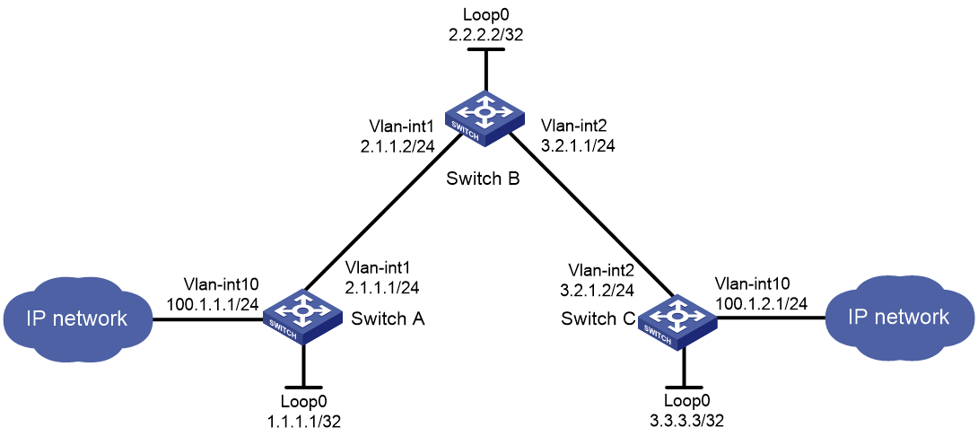

Static CRLSP configuration examples
Example: Configuring a static CRLSP
Switch A, Switch B, and Switch C run IS-IS.
Establish an MPLS TE tunnel over a static CRLSP from Switch A to Switch C to transmit data between the two IP networks. The required bandwidth for the tunnel is 2000 kbps.
The maximum bandwidth for MPLS TE traffic is 10000 kbps, and the maximum reservable bandwidth is 5000 kbps.
Figure 1 Network diagram

6.     Create a static CRLSP:
# Configure Switch A as the ingress node of the static CRLSP, and specify the next hop address as 2.1.1.2, outgoing label as 20, and required bandwidth as 2000 kbps.
[SwitchA] static-cr-lsp ingress static-cr-lsp-1 nexthop 2.1.1.2 out-label 20 bandwidth 2000
# On Switch A, configure tunnel 1 to use the static CRLSP static-cr-lsp-1.
[SwitchA] interface tunnel 1
[SwitchA-Tunnel1] mpls te static-cr-lsp static-cr-lsp-1
[SwitchA-Tunnel1] quit
# Configure Switch B as the transit node of the static CRLSP, and specify the incoming label as 20, next hop address as 3.2.1.2, outgoing label as 30, and required bandwidth as 2000 kbps.
[SwitchB] static-cr-lsp transit static-cr-lsp-1 in-label 20 nexthop 3.2.1.2 out-label 30 bandwidth 2000
# Configure Switch C as the egress node of the static CRLSP, and specify the incoming label as 30.
[SwitchC] static-cr-lsp egress static-cr-lsp-1 in-label 30
7.     Configure a static route on Switch A to direct traffic destined for subnet 100.1.2.0/24 to MPLS TE tunnel 1.
[SwitchA] ip route-static 100.1.2.0 24 tunnel 1 preference 1

[SwitchC] display mpls lsp
FEC                         Proto    In/Out Label    Out Inter/NHLFE/LSINDEX
-                           StaticCR 30/-            -
[SwitchA] display mpls static-cr-lsp
Name            LSR Type    In/Out Label   Out Interface        State
static-cr-lsp-1 Ingress     Null/20        Vlan1                Up
[SwitchB] display mpls static-cr-lsp
static-cr-lsp-1 Transit     20/30          Vlan2                Up
[SwitchC] display mpls static-cr-lsp
static-cr-lsp1  Egress      30/Null        -                    Up
# Verify that Switch A has a static route entry with interface Tunnel 1 as the output interface.
[SwitchA] display ip routing-table
