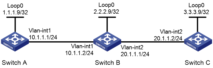

CRLSP setup procedure
As shown in Figure 1, a CRLSP is set up by using the following steps:
1.     The ingress LSR generates a Path message that carries LABEL_REQUEST, and then forwards the message along the path calculated by CSPF hop-by-hop towards the egress LSR.
2.     After receiving the Path message, the egress LSR generates a Resv message carrying the reservation information and the LABEL object. It forwards the Resv message to the ingress LSR along the reverse direction of the path that the Path message traveled.
The Resv message advertises labels, reserves resources, and creates a reserve state on each LSR it passes, so QoS can be guaranteed for services transmitted on the CRLSP.
3.     When the ingress LSR receives the Resv message, the CRLSP is established.
Figure 1 Setting up a CRLSP

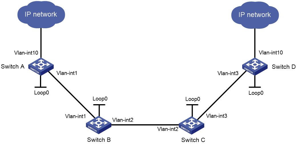

RSVP P2MP
RSVP point-to-multipoint (P2MP) is used to establish P2MP CRLSPs (P2MP LSPs). A P2MP LSP has one source and multiple destinations. A P2MP LSP is consisted of multiple sub-LSPs. Each sub-LSP is from the source node to a destination node of the P2MP LSP.
One or more P2MP LSPs form a P2MP TE tunnel. A P2MP TE tunnel is uniquely identified by a P2MP SESSION object that contains the following fields:
·     P2MP ID—Each P2MP TE tunnel has a unique P2MP ID assigned by the tunnel ingress node.
·     Tunnel ID—ID of the tunnel.
·     Extended Tunnel ID—Source address of the tunnel.
A P2MP LSP is identified by the P2MP SESSION object and the LSP ID field in the P2MP SENDER_TEMPLATE object.
RSVP P2MP adds new objects to Path and Resv messages.
New objects added to the Path message:
·     S2L_SUB_LSP—An S2L_SUB_LSP object carries one of the destination addresses for a P2MP LSP. A Path message carries one S2L_SUB_LSP object. An ingress LSR uses multiple Path messages for signaling a P2MP LSP.
·     SENDER_TEMPLATE—RSVP P2MP adds the Sub-Group Originator ID and Sub-Group ID fields to a P2P SENDER_TEMPLATE object to create a P2MP SENDER_TEMPLATE object. The P2MP SENDER_TEMPLATE object distinguishes different Path messages for the same P2MP LSP. An LSR uses its LSR ID as the Sub-Group Originator ID and assigns a unique Sub-Group ID for each Path message.
New objects added to the Resv message:
·     FILTER_SPEC—RSVP P2MP adds the Sub-Group Originator ID and Sub-Group ID fields to a P2P FILTER_SPEC object to create a P2MP FILTER_SPEC object. The P2MP FILTER_SPEC object distinguishes different Resv messages for the same P2MP LSP. An LSR uses its LSR ID as the Sub-Group Originator ID and assigns a unique Sub-Group ID for each Resv message.

Example: Establishing an MPLS TE tunnel with RSVP-TE
Switch A, Switch B, Switch C, and Switch D run IS-IS and all of them are Layer 2 switches.
Use RSVP-TE to establish an MPLS TE tunnel from Switch A to Switch D to transmit data between the two IP networks. The MPLS TE tunnel requires a bandwidth of 2000 kbps.
The maximum bandwidth of the link that the tunnel traverses is 10000 kbps and the maximum reservable bandwidth of the link is 5000 kbps.
Figure 2 Network diagram
Device
Interface
IP address
Device
Interface
IP address
Switch A
Loop0
1.1.1.9/32
Switch D
Loop0
4.4.4.9/32
Vlan-int1
10.1.1.1/24
Vlan-int3
30.1.1.2/24
Vlan-int10
100.1.1.1/24
Vlan-int10
100.1.2.1/24
Switch B
Loop0
2.2.2.9/32
Switch C
Loop0
3.3.3.9/32
Vlan-int1
10.1.1.2/24
Vlan-int3
30.1.1.1/24
Vlan-int2
20.1.1.1/24
Vlan-int2
20.1.1.2/24
1.     Configure IP addresses and masks for interfaces. (Details not shown.)
2.     Configure IS-IS to advertise interface addresses, including the loopback interface address:
# Configure Switch A.
<SwitchA> system-view
[SwitchA] isis 1
[SwitchA-isis-1] network-entity 00.0005.0000.0000.0001.00
[SwitchA-isis-1] quit
[SwitchA] interface vlan-interface 1
[SwitchA-Vlan-interface1] isis enable 1
[SwitchA-Vlan-interface1] isis circuit-level level-2
[SwitchA-Vlan-interface1] quit
[SwitchA] interface loopback 0
[SwitchA-LoopBack0] isis enable 1
[SwitchA-LoopBack0] isis circuit-level level-2
[SwitchA-LoopBack0] quit
# Configure Switch B.
<SwitchB> system-view
[SwitchB] isis 1
[SwitchB-isis-1] network-entity 00.0005.0000.0000.0002.00
[SwitchB-isis-1] quit
[SwitchB] interface vlan-interface 1
[SwitchB-Vlan-interface1] isis enable 1
[SwitchB-Vlan-interface1] isis circuit-level level-2
[SwitchB-Vlan-interface1] quit
[SwitchB-Vlan-interface2] isis enable 1
[SwitchB-Vlan-interface2] isis circuit-level level-2
[SwitchB-Vlan-interface2] quit
[SwitchB] interface loopback 0
[SwitchB-LoopBack0] isis enable 1
[SwitchB-LoopBack0] isis circuit-level level-2
[SwitchB-LoopBack0] quit
# Configure Switch C.
<SwitchC> system-view
[SwitchC] isis 1
[SwitchC-isis-1] network-entity 00.0005.0000.0000.0003.00
[SwitchC-isis-1] quit
[SwitchC] interface vlan-interface 3
[SwitchC-Vlan-interface3] isis enable 1
[SwitchC-Vlan-interface3] isis circuit-level level-2
[SwitchC-Vlan-interface3] quit
[SwitchC] interface vlan-interface 2
[SwitchC-Vlan-interface2] isis enable 1
[SwitchC-Vlan-interface2] isis circuit-level level-2
[SwitchC-Vlan-interface2] quit
[SwitchC] interface loopback 0
[SwitchC-LoopBack0] isis enable 1
[SwitchC-LoopBack0] isis circuit-level level-2
[SwitchC-LoopBack0] quit
# Configure Switch D.
<SwitchD> system-view
[SwitchD] isis 1
[SwitchD-isis-1] network-entity 00.0005.0000.0000.0004.00
[SwitchD-isis-1] quit
[SwitchD] interface vlan-interface 3
[SwitchD-Vlan-interface3] isis enable 1
[SwitchD-Vlan-interface3] isis circuit-level level-2
[SwitchD-Vlan-interface3] quit
[SwitchD] interface loopback 0
[SwitchD-LoopBack0] isis enable 1
[SwitchD-LoopBack0] isis circuit-level level-2
[SwitchD-LoopBack0] quit
# Execute the display ip routing-table command on each switch to verify that the switches have learned the routes to one another, including the routes to the loopback interfaces. (Details not shown.)
3.     Configure an LSR ID, and enable MPLS, MPLS TE, and RSVP:
[SwitchA] mpls lsr-id 1.1.1.9
[SwitchA] mpls te
[SwitchA-te] quit
[SwitchA] rsvp
[SwitchA-rsvp] quit
[SwitchA-Vlan-interface1] mpls enable
[SwitchA-Vlan-interface1] mpls te enable
[SwitchA-Vlan-interface1] rsvp enable
[SwitchB] mpls lsr-id 2.2.2.9
[SwitchB] mpls te
[SwitchB-te] quit
[SwitchB] rsvp
[SwitchB-rsvp] quit
[SwitchB-Vlan-interface1] mpls enable
[SwitchB-Vlan-interface1] mpls te enable
[SwitchB-Vlan-interface1] rsvp enable
[SwitchB-Vlan-interface2] mpls enable
[SwitchB-Vlan-interface2] mpls te enable
[SwitchB-Vlan-interface2] rsvp enable
[SwitchC] mpls lsr-id 3.3.3.9
[SwitchC] mpls te
[SwitchC-te] quit
[SwitchC] rsvp
[SwitchC-rsvp] quit
[SwitchC-Vlan-interface3] mpls enable
[SwitchC-Vlan-interface3] mpls te enable
[SwitchC-Vlan-interface3] rsvp enable
[SwitchC-Vlan-interface2] mpls enable
[SwitchC-Vlan-interface2] mpls te enable
[SwitchC-Vlan-interface2] rsvp enable
[SwitchD] mpls lsr-id 4.4.4.9
[SwitchD] mpls te
[SwitchD-te] quit
[SwitchD] rsvp
[SwitchD-rsvp] quit
[SwitchD-Vlan-interface3] mpls enable
[SwitchD-Vlan-interface3] mpls te enable
[SwitchD-Vlan-interface3] rsvp enable
4.     Configure IS-IS TE:
[SwitchA] isis 1
[SwitchA-isis-1] cost-style wide
[SwitchA-isis-1] mpls te enable level-2
[SwitchB] isis 1
[SwitchB-isis-1] cost-style wide
[SwitchB-isis-1] mpls te enable level-2
[SwitchC] isis 1
[SwitchC-isis-1] cost-style wide
[SwitchC-isis-1] mpls te enable level-2
[SwitchD] isis 1
[SwitchD-isis-1] cost-style wide
[SwitchD-isis-1] mpls te enable level-2
5.     Configure MPLS TE attributes of links:
# Set the maximum link bandwidth and maximum reservable bandwidth on Switch A.
[SwitchA-Vlan-interface1] mpls te max-link-bandwidth 10000
[SwitchA-Vlan-interface1] mpls te max-reservable-bandwidth 5000
# Set the maximum link bandwidth and maximum reservable bandwidth on Switch B.
[SwitchB-Vlan-interface1] mpls te max-link-bandwidth 10000
[SwitchB-Vlan-interface1] mpls te max-reservable-bandwidth 5000
[SwitchB-Vlan-interface2] mpls te max-link-bandwidth 10000
[SwitchB-Vlan-interface2] mpls te max-reservable-bandwidth 5000
# Set the maximum link bandwidth and maximum reservable bandwidth on Switch C.
[SwitchC-Vlan-interface3] mpls te max-link-bandwidth 10000
[SwitchC-Vlan-interface3] mpls te max-reservable-bandwidth 5000
[SwitchC-Vlan-interface2] mpls te max-link-bandwidth 10000
[SwitchC-Vlan-interface2] mpls te max-reservable-bandwidth 5000
# Set the maximum link bandwidth and maximum reservable bandwidth on Switch D.
[SwitchD-Vlan-interface3] mpls te max-link-bandwidth 10000
[SwitchD-Vlan-interface3] mpls te max-reservable-bandwidth 5000
6.     Configure an MPLS tunnel on Switch A:
# Configure MPLS TE tunnel interface Tunnel 1.
[SwitchA] interface tunnel 1 mode mpls-te
[SwitchA-Tunnel1] ip address 7.1.1.1 255.255.255.0
# Specify the tunnel destination address as the LSR ID of Switch D.
[SwitchA-Tunnel1] destination 4.4.4.9
# Configure MPLS TE to use RSVP-TE to establish the tunnel.
[SwitchA-Tunnel1] mpls te signaling rsvp-te
# Assign 2000 kbps bandwidth to the tunnel.
[SwitchA-Tunnel1] mpls te bandwidth 2000
[SwitchA-Tunnel1] quit
7.     Configure a static route on Switch A to direct the traffic destined for subnet 100.1.2.0/24 to the MPLS TE tunnel 1 for forwarding.
[SwitchA] ip route-static 100.1.2.0 24 tunnel 1 preference 1
# Verify that the tunnel interface is up on Switch A.
[SwitchA] display interface tunnel
Tunnel1
Current state: UP
Line protocol state: UP
Description: Tunnel1 Interface
Bandwidth: 64kbps
Maximum transmission unit: 64000
Internet address: 7.1.1.1/24 (primary)
Tunnel source unknown, destination 4.4.4.9
Tunnel TTL 255
Tunnel protocol/transport CR_LSP
Last clearing of counters: Never
    Last 300 seconds input rate: 0 bytes/sec, 0 bits/sec, 0 packets/sec
    Last 300 seconds output rate: 6 bytes/sec, 48 bits/sec, 0 packets/sec
Input: 0 packets, 0 bytes, 0 drops
Output: 177 packets, 11428 bytes, 0 drops
# Display detailed information about the MPLS TE tunnel on Switch A.
[SwitchA] display mpls te tunnel-interface
Tunnel Name            : Tunnel 1
Tunnel State            : Up (Main CRLSP up, Shared-resource CRLSP down)
Tunnel Attributes      :
  LSP ID               : 23331           Tunnel ID            : 1
  Admin State          : Normal
  Ingress LSR ID       : 1.1.1.9         Egress LSR ID        : 4.4.4.9
  Signaling            : RSVP-TE         Static CRLSP Name    : -

Example: Configuring RSVP GR
Switch A, Switch B, and Switch C run IS-IS, and all of them are Layer 2 switches.
Use RSVP-TE to establish a TE tunnel from Switch A to Switch C.
Configure RSVP GR on the switches to ensure continuous forwarding when a switch reboots.
Figure 3 Network diagram
2.     Configure IS-IS to advertise interface addresses, including the loopback interface address. (Details not shown.)
3.     Configure an LSR ID, enable MPLS, MPLS TE, RSVP, and RSVP hello extension:
[SwitchA] mpls te
[SwitchA-te] quit
[SwitchA] rsvp
[SwitchA-rsvp] quit
[SwitchA-Vlan-interface1] rsvp hello enable
[SwitchB] mpls te
[SwitchB-te] quit
[SwitchB] rsvp
[SwitchB-rsvp] quit
[SwitchB-mpls] interface vlan-interface 1
[SwitchB-Vlan-interface1] rsvp hello enable
[SwitchB-Vlan-interface2] rsvp hello enable
[SwitchC] mpls te
[SwitchC-te] quit
[SwitchC] rsvp
[SwitchC-rsvp] quit
[SwitchC-Vlan-interface2] rsvp hello enable
4.     Configure IS-IS TE. (Details not shown.)
5.     Configure an MPLS TE tunnel. (Details not shown.)
6.     Configure RSVP GR:
[SwitchA] rsvp
[SwitchA-rsvp] graceful-restart enable
[SwitchB] rsvp
[SwitchB-rsvp] graceful-restart enable
[SwitchC] rsvp
[SwitchC-rsvp] graceful-restart enable
# After a tunnel is established from Switch A and Switch C, display detailed RSVP neighbor information on Switch A.
<SwitchA> display rsvp peer verbose
Peer: 10.1.1.2                            Interface: Vlan1
Hello state: Up                           Hello type: Active
P2P PSB count: 0                          P2P RSB count: 1
P2MP PSB count: 0                         P2MP RSB count: 0
Src instance: 0x1f08                      Dst instance: 0x22
Summary refresh: Disabled                 Graceful Restart state: Ready
Peer GR restart time: 120000 ms           Peer GR recovery time: 0 ms
The output shows that the neighbor's GR state is Ready.
