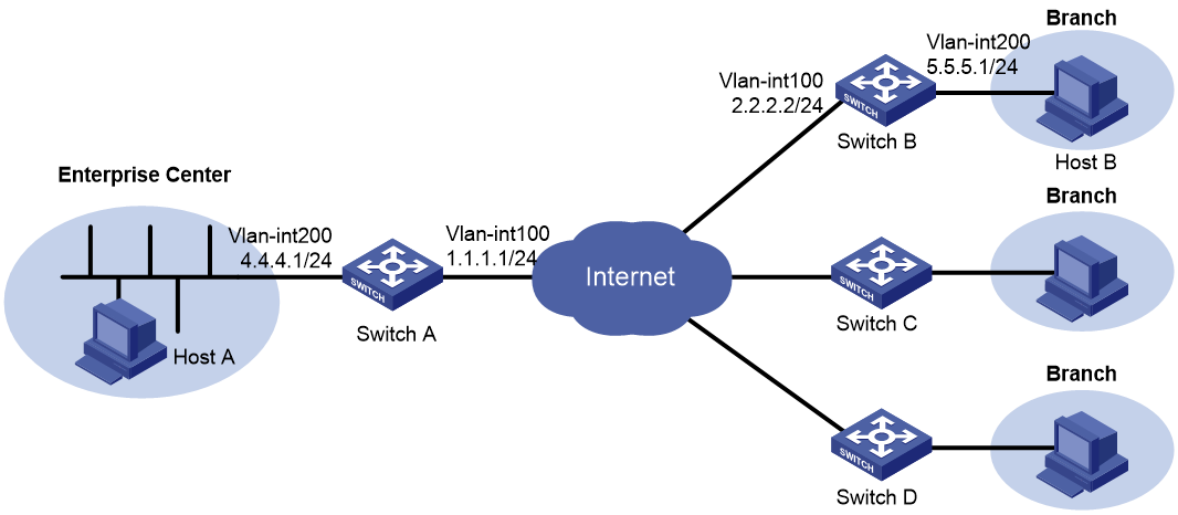

IPsec RRI
IPsec Reverse Route Injection (RRI) enables an IPsec tunnel gateway to automatically add and delete static routes destined for the protected private networks. It automatically adds the static routes when the IPsec SAs are established and deletes the static routes when the IPsec SAs are deleted. This greatly reduces the static route configuration work load on the gateway and increases the scalability of the IPsec VPN.
IPsec RRI is applicable to gateways that must provide many IPsec tunnels (for example, a headquarters gateway).
As shown in Figure 4, the traffic between the enterprise center and the branches are protected by IPsec. The gateway at the enterprise center is configured with static routes to route traffic to the IPsec-protected interfaces. It is difficult to add or modify static routes on the gateway at the enterprise center if the IPsec VPN has a large number of branches or if the network structure changes.
Figure 4 IPsec VPN
After you can enable IPsec RRI on the gateway, the gateway automatically adds a static route to the routing table each time an IPsec tunnel is established. The destination IP address is the protected private network, and the next hop is the remote IP address of the IPsec tunnel. Traffic destined for the peer end is routed to the IPsec tunnel interface and thereby protected by IPsec.
You can advertise the static routes created by IPsec RRI in the internal network, and the internal network device can use them to forward traffic in the IPsec VPN.
You can set preferences for the static routes created by IPsec RRI to implement flexible route management. For example, you can set the same preference for multiple routes to the same destination to implement load sharing, or you can set different preferences to implement route backup.
You can also set tags for the static routes created by IPsec RRI to implement flexible route control through routing policies.

IPsec configuration examples
Example: Configuring a manual mode IPsec tunnel for IPv4 packets
As shown in Figure 7, establish an IPsec tunnel between Switch A and Switch B to protect data flows between the switches. Configure the tunnel as follows:
·     Specify the encapsulation mode as tunnel, the security protocol as ESP, the encryption algorithm as AES-CBC-192, and the authentication algorithm as HMAC-SHA1.
·     Manually set up IPsec SAs.
Figure 7 Network diagram

Example: Configuring an IKE-based IPsec tunnel for IPv4 packets
As shown in Figure 8, establish an IPsec tunnel between Switch A and Switch B to protect data flows between them. Configure the IPsec tunnel as follows:
·     Set up SAs through IKE negotiation.
Figure 8 Network diagram

Example: Configuring IPsec RRI
As shown in Figure 10, branches access the enterprise center through an IPsec VPN.
Configure the IPsec VPN as follows:
·     Configure an IPsec tunnel between Switch A and each branch gateway (Switch B, Switch C, and Switch D) to protect traffic between subnets 4.4.4.0/24 and 5.5.5.0/24.
·     Configure the tunnels to use security protocol ESP, encryption algorithm DES, and authentication algorithm SHA1-HMAC-96. Use IKE for IPsec SA negotiation.
·     Configure IKE proposal to use the preshared key authentication method, encryption algorithm 3DES, and authentication algorithm HMAC-SHA1.
·     Configure IPsec RRI on Switch A to automatically create static routes to the branches based on the established IPsec SAs.
Figure 10 Network diagram
1.     Assign IPv4 addresses to the interfaces on the switches according to Figure 10. (Details not shown.)
2.     Configure Switch A:
# Create an IPsec transform set named tran1, and specify ESP as the security protocol, DES as the encryption algorithm, and HMAC-SHA-1-96 as the authentication algorithm.

1.     Verify that IPsec RRI can automatically create a static route from Switch A to Switch B:
# Initiate a connection from subnet 5.5.5.0/24 to subnet 4.4.4.0/24. IKE negotiation is triggered to establish IPsec SAs between Switch A and Switch B. (Details not shown.)
# Verify that IPsec SAs are established on Switch A.
[SwitchA] display ipsec sa

# Verify that IPsec RRI has created a static route to reach Switch B.
[SwitchA] display ip routing-table verbose
2.     Verify that Switch A can automatically create static routes to Switch C and Switch D in the same way that you verify the IPsec RRI feature by using Switch A and Switch B. (Details not shown.)
As shown in Figure 15, establish an IPsec tunnel between Switch A and Switch B to protect data flows between the switches. Configure the IPsec tunnel as follows:
Figure 15 Network diagram

This feature applies to scenarios where the headquarters and branches communicate through virtual tunnels. It enables exchanges of IP address request and set messages between the IPsec gateway at a branch and the IPsec gateway at the headquarters.
Table 2 Parameter descriptions
Parameter
Description
request
Enables the IPsec gateway at a branch to submit IP address request messages to the IPsec gateway at the headquarters.
set accept
Enables the IPsec gateway at a branch to accept the IP addresses pushed by the IPsec gateway at the headquarters.
set send
Enables the IPsec gateway at the headquarters to push IP addresses to IPsec gateways at branches.
