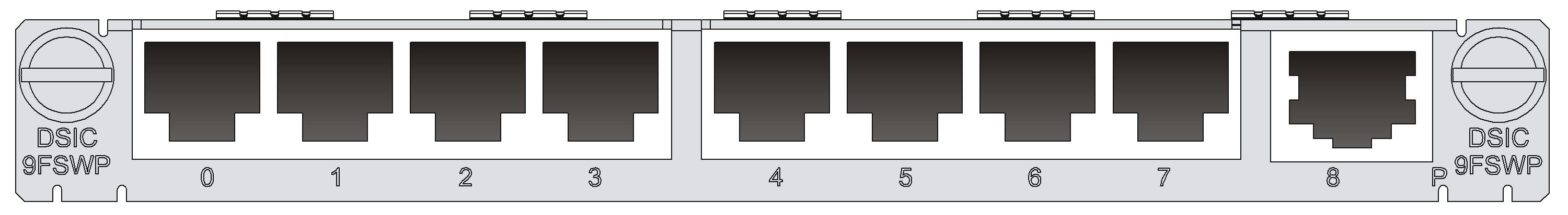

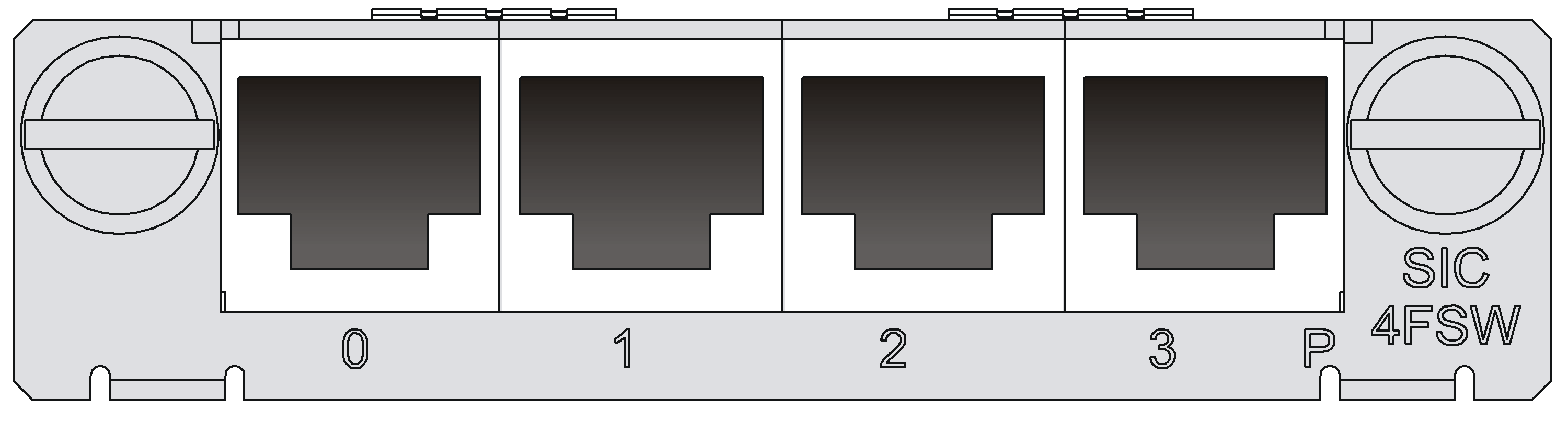

SIC-4FSW/SIC-4FSWP/DSIC-9FSW/DSIC-9FSWP
Introduction
The SIC-4FSW/SIC-4FSWP and DSIC-9FSW/DSIC-9FSWP interface modules are 4/9-port 10/100 Mbps Ethernet Layer 2 SIC interface modules that can be used on H3C MSR series routers. They provide up to 4/9 10/100 BASE-Tx Ethernet ports for Layer 2 and Layer 3 switching. A router installed with SIC-4FSW/SIC-4FSWP and DSIC-9FSW/DSIC-9FSWP modules can work as a switching/routing integrated device on a small-sized enterprise network to connect PCs and network devices inside the network directly. SIC-4FSWP/DSIC-9FSWP interface modules can supply power to powered devices (PDs) through power over Ethernet (PoE).
Functions supported by interface modules are as follows:
· Effective transmission distance of 100 m (328.08 ft) with category-5 twisted pair cables (both crossover and straight-through)
· Effective transmission distance of 100 m (328.08 ft) between any interfaces with category-5 twisted pair cables (both crossover and straight-through)
· Operating speeds of both 100 Mbps and 10 Mbps and autosensing
· Both full duplex (in common use) and half-duplex operating modes
Interface specifications
Table 1 describes the interface specifications of the SIC-4FSW, SIC-4FSWP, DSIC-9FSW, and DSIC-9FSWP interface modules. For information about link mode of the interfaces, see "Link mode of interfaces on Ethernet switching modules and interface modules."
Table 1 Interface specifications
Item |
SIC-4FSW/SIC-4FSWP |
DSIC-9FSW/DSIC-9FSWP |
Connector |
RJ-45 |
Interface type |
MDI/MDIX |
Number of connectors |
Four 100 Mbps RJ-45 connectors |
Nine 100 Mbps RJ-45 connectors |
Cable |
Standard (straight-through)/cross-over Ethernet cable |
Operation mode |
10/100 Mbps autosensing, full/half duplex |
NOTE: Ethernet interfaces on network adapters are usually medium dependent interfaces (MDIs). Medium dependent interfaces crossover (MDIXs) are another type of Ethernet interfaces, which are usually used on hubs and LAN switches. |
Interface LEDs

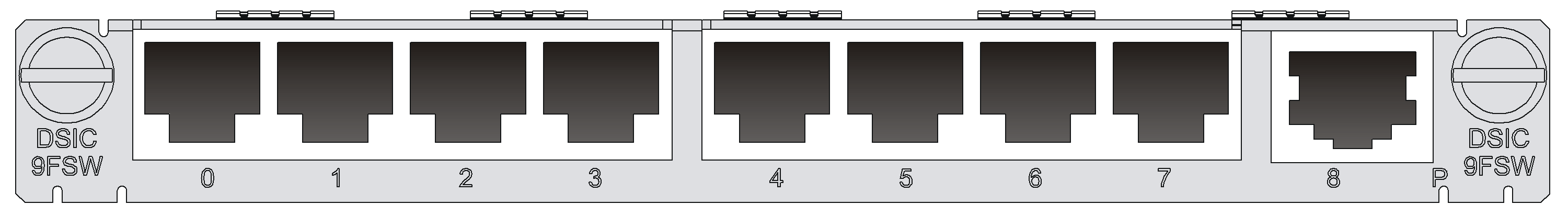

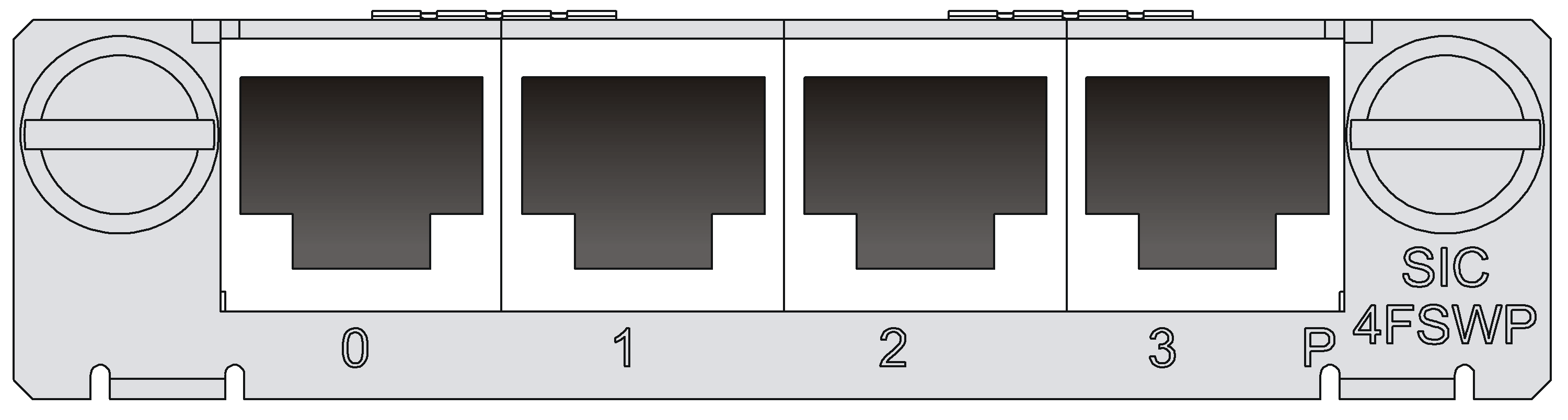

Figure 2 SIC-4FSWP panel
Figure 4 DSIC-9FSWP panel
On the panel, each port corresponds to one green LED. The following table describes the LEDs on the panel.
Table 2 LED description
Status |
Description |
Steady on |
A link is present, but no data is being transmitted or received. |
Off |
No link is present. |
Flashing |
A link is present and data is being transmitted and received (ACT). |
In addition, there is a PoE LED on each module, which is provided for the corresponding modules (SIC-4FSWP and DSIC-9FSWP) with the PoE function.
Interface cables and the connection methods
For more information about Ethernet interface cables and the connection methods, see "Ethernet interface."

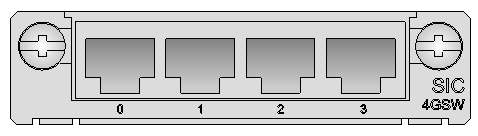

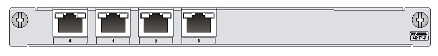

SIC-4GSW
Introduction
The SIC-4GSW interface module is a 4-port 1000 Mbps Ethernet Layer 2 SIC interface module. The SIC-4GSW provides four 1000 Mbps RJ-45 ports. A router installed with SIC-4GSW modules can operate as a switching/routing integrated device on a small-sized enterprise network to connect PCs and network devices inside the network directly.
· Effective transmission distance of 100 m (328.08 ft) over category-5 twisted pair cables (both crossover and straight-through)
· Line rate of 1000 Mbps between any interfaces over category-5 twisted pair cables (both crossover and straight-through)
· Autosensing operating speeds of 1000 Mbps, 100 Mbps, and 10 Mbps
· Both full duplex (typically used) and half-duplex operating modes
Table 3 describes the interface specifications of the SIC-4GSW interface module. For information about link mode of the interfaces, see "Link mode of interfaces on Ethernet switching modules and interface modules."
Table 3 Interface specifications
Item |
Description |
Connector |
RJ-45 |
Interface type |
MDI/MDIX |
4 |
Cable |
Operation mode |
10/100/1000 Mbps autosensing |
Interface LEDs
Figure 5 SIC-4GSW panel
The SIC-4GSW interface module provides a double-color (green/yellow) LED for each port to indicate the operating status of the port.
Table 4 LED description
Status |
Description |
Off |
Steady green |
A 1000 Mbps link is present. |
Flashing green |
The port is sending and receiving data at 1000 Mbps. |
Steady yellow |
A 10/100 Mbps link is present. |
Flashing yellow |
The port is sending and receiving data at 10/100 Mbps. |
For information about Ethernet interface cables and the connection methods, see "Ethernet interface."

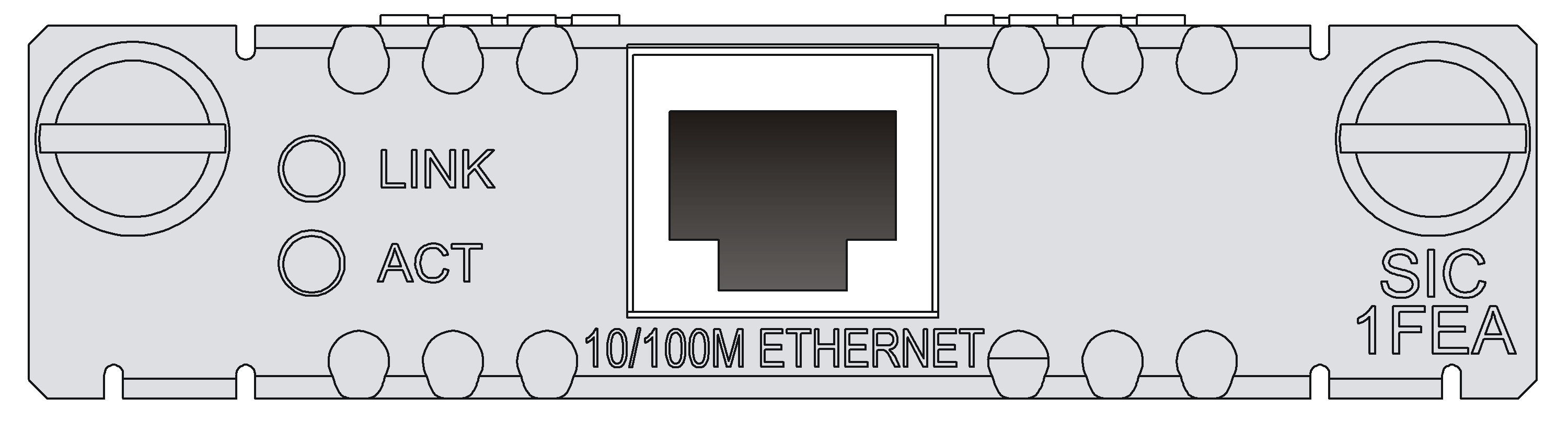

SIC-1FEA
Introduction
The 1-port 10BASE-T/100BASE-TX Ethernet interface module (SIC-1FEA) is used for communication between the router and LAN. It supports:
Table 7 describes the interface specifications of the SIC-1FEA interface module. For information about link mode of the interfaces, see "Link mode of interfaces on Ethernet switching modules and interface modules."
Table 7 Interface specifications
Item |
Description |
Connector type |
RJ-45 |
Interface type |
MDI |
1 |
Cable type |
Straight-through Ethernet cable |
Operating mode |
10/100 Mbps autosensing Full duplex/half duplex |
Interface LEDs
LED |
Description |
LINK |
· Off: No link is present; · On: A link is present. |
ACT |
· Off: No data is being transmitted or received; · Flashing: Data is being received or/and transmitted. |
For more information about the Ethernet interface cables and the connection methods, see "Ethernet interface".

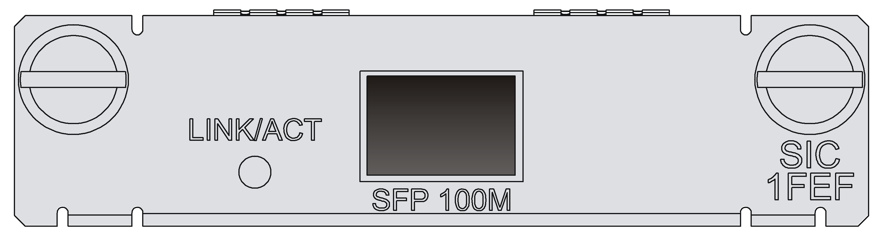

Interface LEDs
Figure 8 SIC-1FEF panel
LED |
Status |
Description |
LINK/ACT |
Off |
Steady green |
The optical module has established a 100 Mbps link. |
Flashing green |
Data is being received and transmitted. |
Steady yellow |
Information detection failed. |
Transceiver modules, optical fibers, and connection methods
For more information about transceiver modules, optical fibers, and connection methods, see "Fiber port."

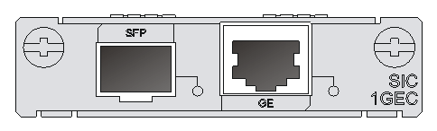

SIC-1GEC-V2
Introduction
The 1-port 10/100/1000 Mbps electrical and fiber Ethernet interface SIC module (SIC-1GEC-V2) has the following functions:
· Receipt, transmission and processing of GE data stream
· CE electrical and fiber port access
· 1000/100/10 Mbps on copper port
· 1000 Mbps on fiber port
Table 11 describes the interface specifications of the SIC-1GEC-V2 interface module. For information about link mode of the interfaces, see "Link mode of interfaces on Ethernet switching modules and interface modules."
Table 11 Interface specifications
Item |
Description |
Connector |
RJ-45 |
Interface type |
MDI |
Frame format |
· Ethernet_II · Ethernet_SNAP · IEEE 802.2 · IEEE 802.3 |
Operation mode |
10/100/1000 Mbps autosensing Full/half duplex |
NOTE: The SIC-1GEC-V2 provides combo interfaces. The fiber and copper ports of a combo interface cannot be used simultaneously. By default, the copper port is available. To use the fiber port, execute the related command. |
Interface LEDs
Table 12 LED description for the copper port on the SIC-1GEC-V2 panel
LED |
Description |
LINK |
· On: A carrier signal is received. · Off: No carrier signal is received. · Green: Data is being received and transmitted at a speed of 1000 Mbps. · Yellow: Data is being received and transmitted at a speed of 100/10 Mbps. |
ACT |
· Off: No data is being received and transmitted; · Flashing: Data is being received and transmitted. |
Table 13 LED description for the fiber port on the SIC-1GEC-V2 panel
LED |
Description |
LINK |
· On: A carrier signal is received. · Off: No carrier signal is received. · Green: Data is being received and transmitted at a speed of 1000 Mbps. · Yellow: Fault. |
ACT |
· Off: No data is being received and transmitted. · Flashing: Data is being received and transmitted. |
For information about transceiver modules, optical fibers, and the connection methods, see "Fiber port."

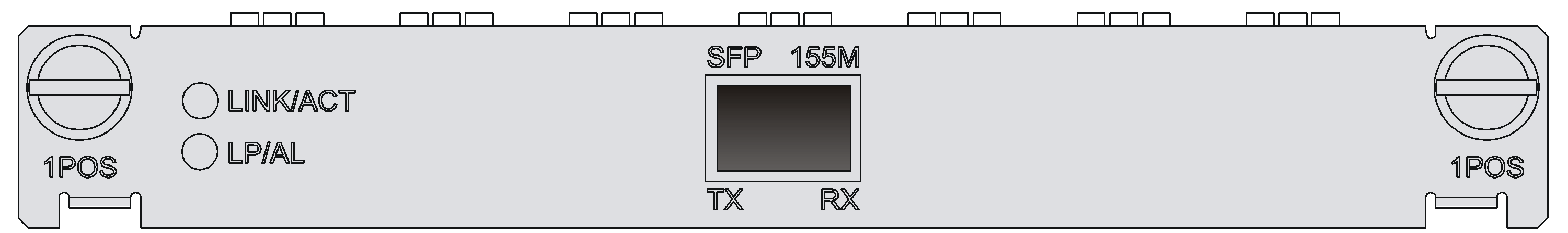

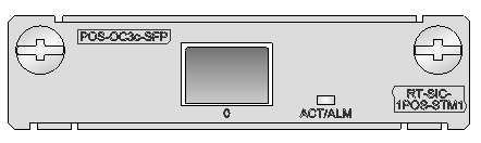

POS (SDH/SONET) interface modules
RT-SIC-1POS-STM1
CAUTION: The RT-SIC-1POS-STM1 interface module is not hot swappable. |
Introduction
The RT-SIC-1POS-STM1 1-port SDH/SONET interface module provides an interface transmission rate of 155.52 Mbps (STM-1/OC-3).
The RT-SIC-1POS-STM1 supports PPP, Frame Relay, and HDLC protocols at the data link layer and the IP protocol at the network layer. It allows direct transmission of packets over SONET/SDH. It provides a 155.52 Mbps fractional interface and supports various types of transceiver modules. You can purchase transceiver modules for it as required.
Table 14 Interface specifications
Item |
Description |
Connector |
SFP/LC |
Number of interfaces |
1 |
Interface standard |
SONET OC-3/SDH STM-1 |
Interface rate |
155.52 Mbps |
Interface LEDs
Figure 10 RT-SIC-1POS-STM1 panel
Table 15 LED description
LED |
Status |
Description |
ACT/ALM |
Steady green |
A 155.52 Mbps link is present. |
Flashing green |
The port is receiving or sending data at 155.52 Mbps. |
Steady red |
An alarm has occurred. |
Off |
No transceiver module is present or the port is in shutdown state. |

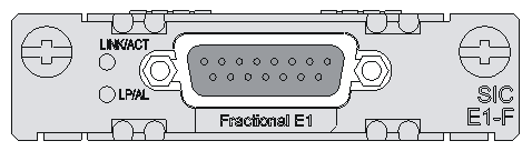

SIC-E1-F
Introduction
The 1-port fractional E1 interface module (SIC-E1-F) supports:
· Transmission/Receiving and handling of E1 data streams
· CE1 (channelized E1) access
· Remote loopback and local loopback functions, facilitating fault test and location.
The timeslots on an interface in FE1 mode on the SIC-E1-F can be bundled to form one interface (namely, can be bundled into one channel, and the rate of the interface is n No 64 Kbps, where n ranges from 1 to 31.)
The SIC-E1-F does not support the PRI mode.
Table 16 Interface specifications
Item |
Description |
Connector type |
D15 |
1 |
· G.703 · G.704 |
Interface rate |
2.048 Mbps |

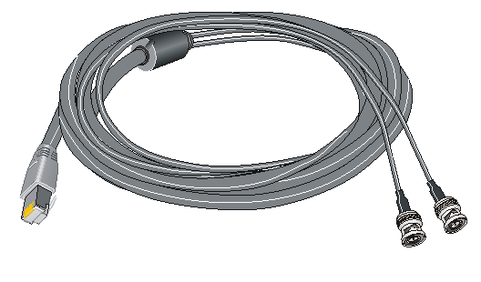

Cable type |
75-ohm unbalanced coaxial cable (D15 to BNC) |
Operating modes |
· E1 · CE1 |
Supported services |
· Backup · Terminal access |
Interface LEDs
Figure 11 SIC-E1-F panel
Table 17 LED description
LED |
Description |
LINK/ACT |
· On: A carrier signal is received. · Flashing: Data is being transmitted or received. · Off: No carrier signal is received. |
LP/AL |
· On: The interface is in loopback mode. · Off: Neither loopback nor alarm is present. · Flashing: No cable is connected to the interface, the cable is damaged or not connected correctly, or the peer device is faulty. |
For more information about E1 interface cables and the connection methods, see "E1 interface."

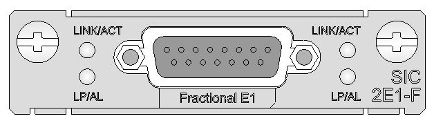

SIC-2E1-F
Introduction
The 2-port fractional E1 interface module (SIC-2E1-F), where F indicates fractional, supports:
Table 18 Interface specifications
Item |
Description |
Connector type |
D15 |
1 |
· G.703 · G.704 |
Interface rate |
2.048 Mbps |

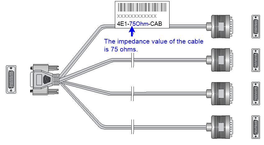

Cable type |
Operating modes |
· E1 · CE1 |

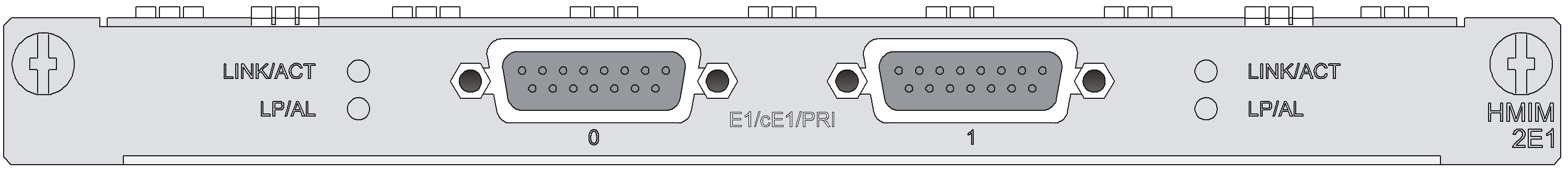

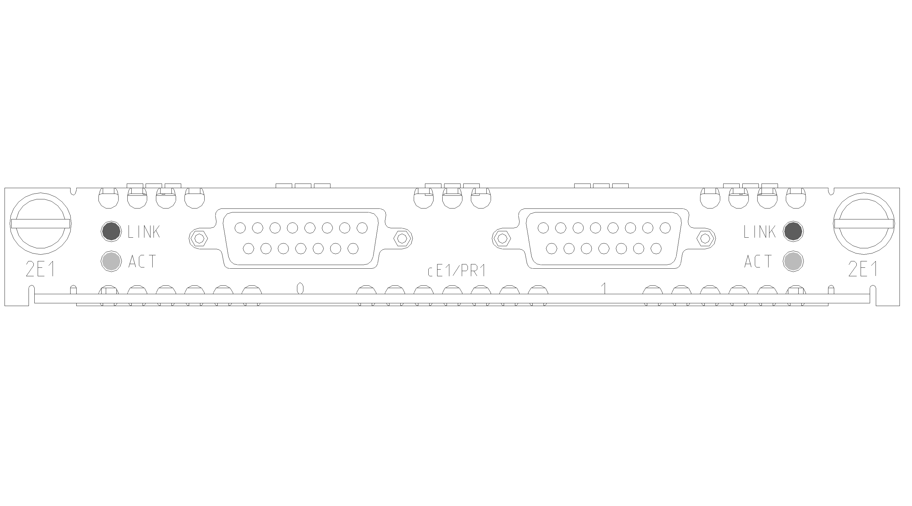

Interface LEDs
Figure 12 SIC-2E1-F panel
Table 19 LED description
LED |
Description |
LINK/ACT (left) |
· On: A carrier signal is received on line RX1. · Flashing: Data is being transmitted on line TX1 or received on line RX1. · Off: No carrier signal is received on line RX1. |
LP/AL (left) |
· On: The interface of lines TX1 and RX1 is in loopback mode. · Flashing: No cable is connected to the interface of lines TX1 and RX1, the cable is damaged or not connected correctly, or the peer device is faulty. · Off: Neither loopback nor alarm is present on the interface of lines TX1 and RX1. |
LINK/ACT (right) |
· On: A carrier signal is received on line RX2. · Flashing: Data is being transmitted on line TX2 or received on line RX2. · Off: No carrier signal is received on line RX2. |
LP/AL (right) |
· On: The interface of lines TX2 and RX2 is in loopback mode. · Flashing: No cable is connected to the interface of lines TX2 and RX2, the cable is damaged or not connected correctly, or the peer device is faulty. · Off: Neither loopback nor alarm is present on the interface of lines TX2 and RX2. |
For more information about E1 interface cables and the connections methods, see "E1 interface."

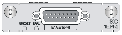

SIC-1EPRI
Introduction
The SIC-1EPRI is a 1-port E1/CE1/PRI SIC interface module that provides the following features:
· Transmission/Receiving and handling of E1 data streams.
· CE1 (channelized E1) access.
· ISDN PRI function.
You can use the module for multiple purposes through different configurations.
Table 20 Interface specifications
Item |
Description |
Connector type |
D15 |
1 |
· G.703 · G.704 |
Interface rate |
2.048 Mbps |
Cable type |
· 75-ohm unbalanced coaxial cable (D15 to BNC) · Coaxial connector, network interface connector, and 75-ohm to 120-ohm adapter NOTE: The default resister for the interface on the SIC-1EPRI is 75 ohm. A 75-ohm to 120-ohm adapter must be used when a 120-ohm cable is connected to the SIC-1EPRI. |
Operating mode |
· E1 · CE1 · ISDN PRI |
Supported service |
· Backup · Terminal access · ISDN |
Interface LEDs
Figure 13 SIC-1EPRI panel
Table 21 LED description
LED |
Description |
LINK/ACT |
LP/AL |
· On: The interface is in loopback mode. · Flashing: No cable is connected to the interface, the cable is damaged or not connected correctly, or the peer device is faulty. · Off: Neither loopback nor alarm is present. |

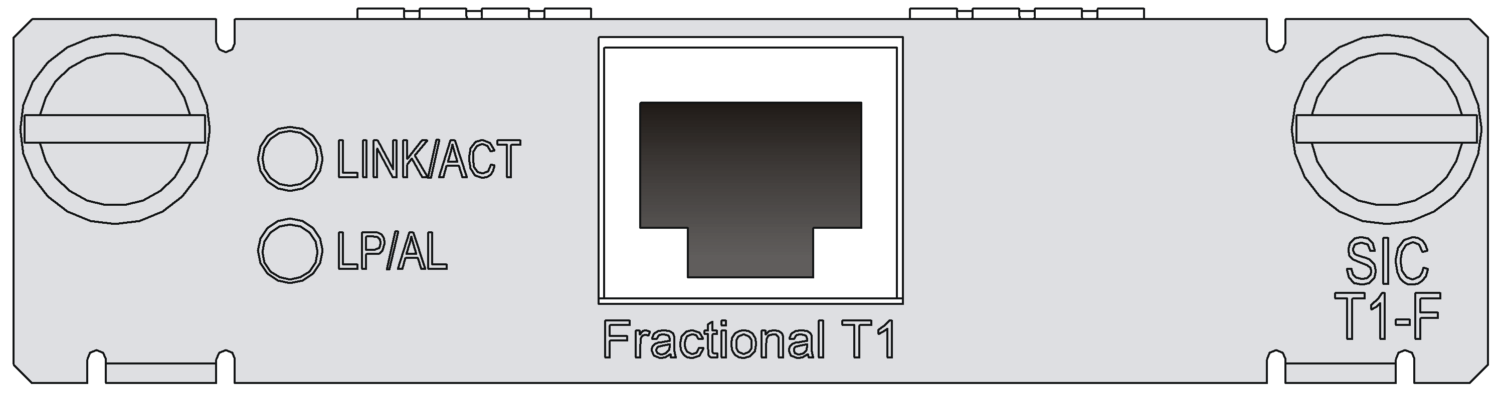

SIC-T1-F
Introduction
1-port Fractional T1 interface card (SIC-T1-F) has the following features:
· The timeslots on an interface in FT1 mode on the SIC-T1-F can be bundled to form one interface (namely, can be bundled into one channel, and the rate of the interface is n No 56 Kbps, where n ranges from 1 to 24.).
· The SIC-T1-F does not support the PRI mode.
Table 22 Interface specifications
Item |
Description |
Connector type |
RJ-45 |
1 |
· G.703/T1.102 · G.704 · AT&T TR 54016 · AT&T TR 62411 · ANSI T1.403 |
Interface rate |
1.544 Mbps |
Cable type |
T1 cable (100-ohm standard shielded network cable) |
Operating mode |
FT1 |
Supported service |
Interface LEDs
LED |
Description |
LINK/ACT |
· On: A carrier signal is received. · Off: No carrier signal is received. · Flashing: Data is being transmitted or/and received. |
LP/AL |
· On: The interface is in loopback mode. · Off: No loopback or alarm is present. · Flashing: No cable is connected to the interface, the cable is damaged or not connected correctly, or the peer device is faulty. |
For more information about T1 interface cables and the connection methods, see "T1 interface."

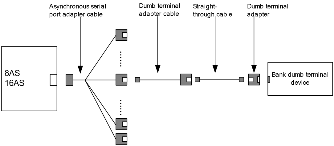

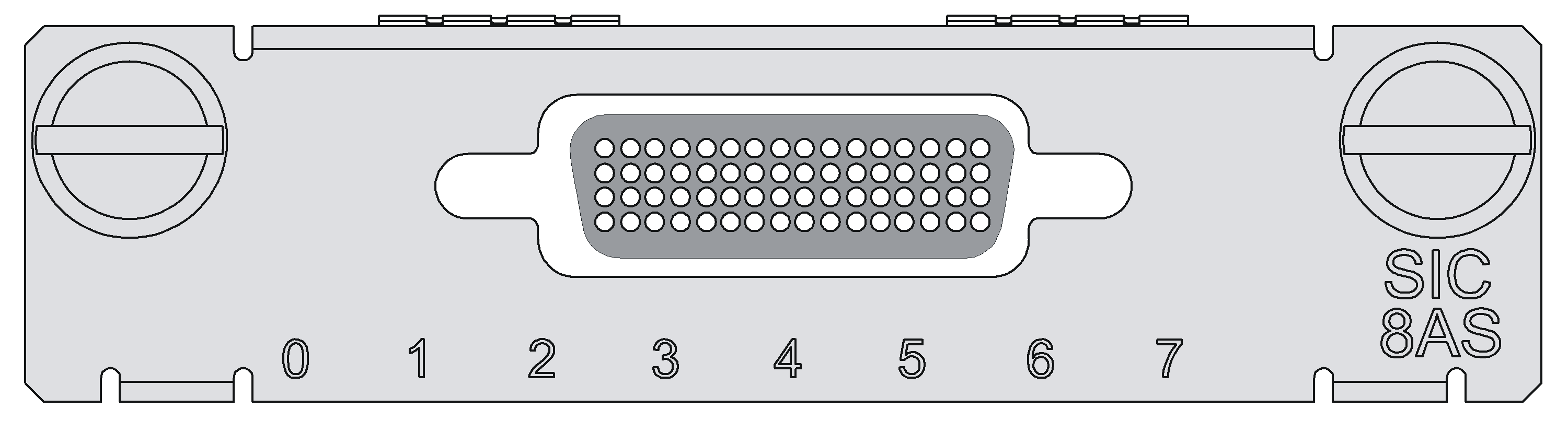

SIC-8AS
Introduction
The 8-port asynchronous serial interface module (SIC-8AS) mainly transmits and processes asynchronous data streams.
SIC-8AS has these features:
· Each asynchronous serial port provides a rate up to 115.2 Kbps.
· Supports the terminal access service and asynchronous dedicated line.
· Serves as the small-/medium-sized ISP dial-up access server when an asynchronous serial port is used for dial-up.
Table 24 Interface specifications
Item |
Description |
Connector |
DB60 |
1 |
Interface cable |
Customized cable with 8-port RJ-45 connector |
RS-232 |
Minimum baud rate |
300 bps |
Maximum baud rate |
115.2 Kbps |
· Modem dial-up · Backup · Terminal access service · Asynchronous dedicated line |
Interface LEDs
Figure 15 SIC-8AS front panel
Table 25 LED description
LED |
Description |
LINK/ACT |
· Off: No link is present. · On: A link is present. · Flashing: Data is being received or/and transmitted. |

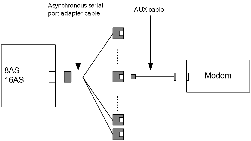

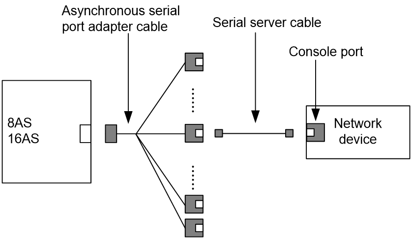

For more information about asynchronous serial port cables and the connection methods, see "Asynchronous serial ports."

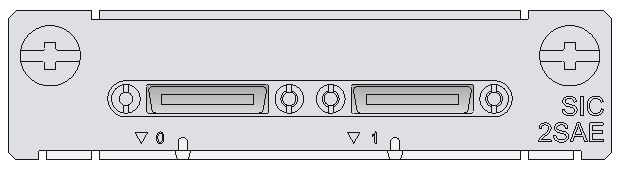

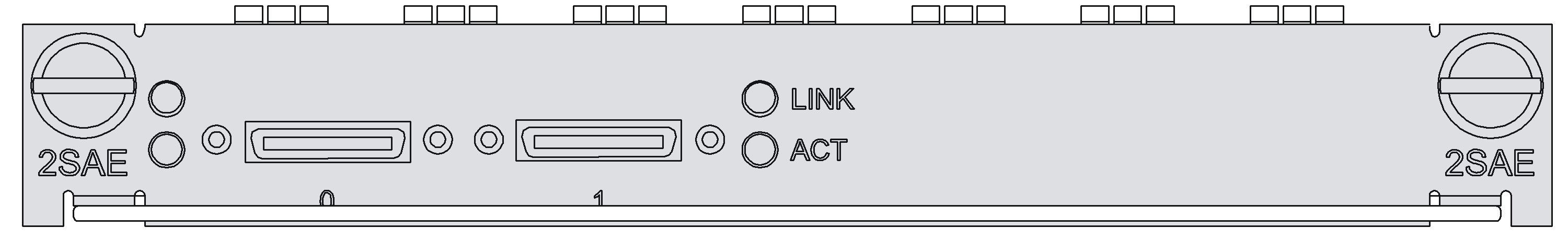

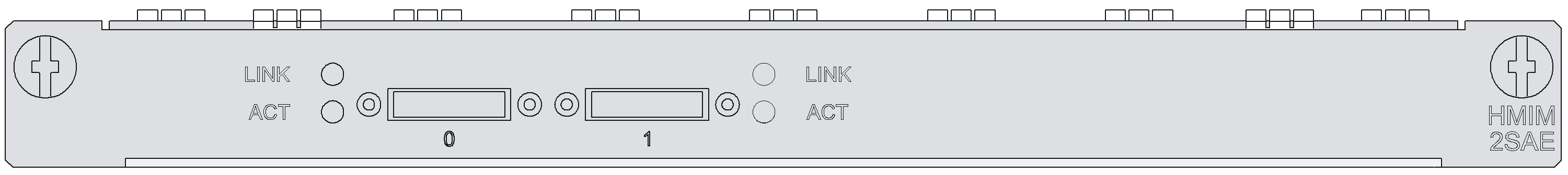

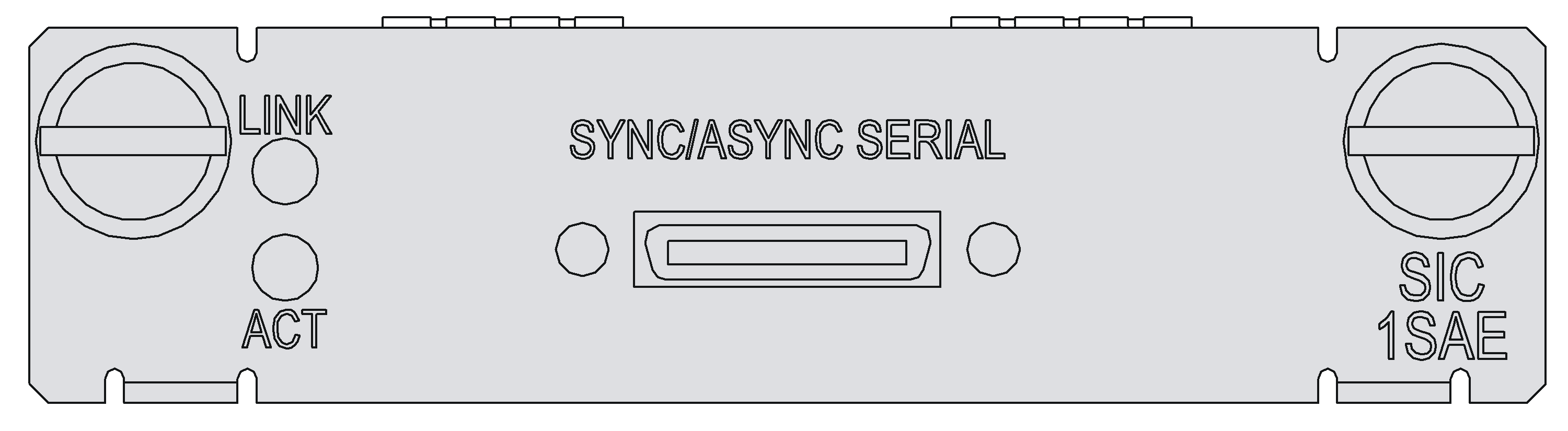

SIC-1SAE/SIC-2SAE/SIC-4SAE
Introduction
The SIC-1SAE/SIC-2SAE/SIC-4SAE is a 1-port/2-port/4-port enhanced high-speed synchronous/asynchronous serial interface module.
Table 28 Interface specifications
Item |
Synchronous |
Asynchronous |
Connector |
D28 |
· 1 (SIC-1SAE) · 2 (SIC-2SAE) · 4 (SIC-4SAE) |
Interface standard and operating mode |
V.24 |
· V.35 · RS449 · X.21 · RS-530 |
RS-232 |
· DTE · DCE |
· DTE · DCE |
Minimum baud rate (bps) |
1200 |
1200 |
300 |
Maximum baud rate (bps) |
64 k |
2.048 M |
115.2 |
Cable |
· V.24 (RS-232) DTE cable · V.24 (RS-232) DCE cable · V.35 DTE cable · V.35 DCE cable · X.21 DTE cable · X.21 DCE cable · RS449 DTE cable · RS449 DCE cable · RS530 DTE cable · RS530 DCE cable |
Supported service |
· DDN leased line · Terminal access service |
· Dialup through modems · Backup · Asynchronous leased line · Terminal access |

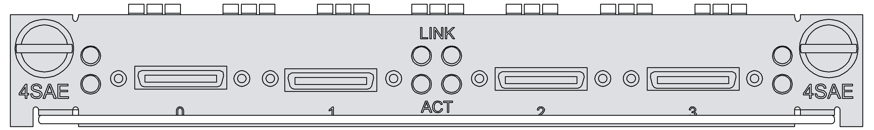

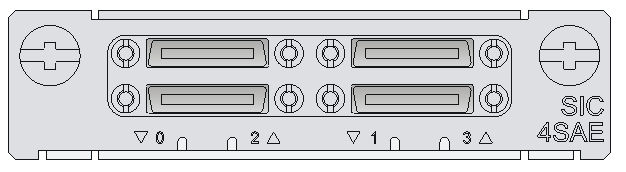

Interface LEDs
Figure 18 SIC-2SAE panel
Figure 19 SIC-4SAE panel
The SIC-1SAE provides separate LINK and ACT LEDs for the port and the SIC-2SAE and SIC-4SAE provide one LINK/ACT LED for each port.
Table 29 LED description for the port on the SIC-1SAE
LED |
Description |
LINK |
· Off: No link is present. · On: A link is present. |
ACT |
Table 30 LED description for ports on the SIC-2SAE/SIC-4SAE
LED |
Description |
LINK/ACT |
For more information about synchronous/asynchronous serial port cables and the connection methods, see "Synchronous/asynchronous serial ports."

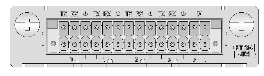

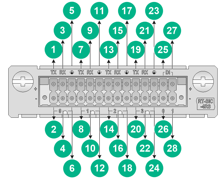

SIC-4RS
Introduction
The SIC-4RS is a 4-port asynchronous serial interface module.
The SIC-4RS has these features:
· Allows users to make matching wires connected to the terminal block themselves.
· Supports simultaneous connection to four asynchronous serial ports.
Table 31 Interface specifications
Item |
Description |
Connector |
Terminal block |
1 |
Interface cable |
Allows users to make matching cables themselves. |
RS-232/485/422 |
300 |
115200 |
Supported service |
· 4 asynchronous serial port connection · 2-channel digital input (DI) detection |
Interface LEDs
Figure 20 SIC-4RS panel
Table 32 LED description
LED |
Description |
0 to 3 |
The SIC-4RS interface module allows users to make matching cables themselves for connection to it. Figure 21 and Table 33 describe the requirements for making matching cables.
Figure 21 Pin numbering
Pin |
Interface standards and working modes |
RS-232 |
RS-422 |
RS-485 |
RTS0 |
TX0+ |
Data0+ |
2 |
TXD0 |
TX0- |
Data0- |
3 |
RXD0 |
RX0+ |
4 |
CTS0 |
RX0- |
5 |
GND |
6 |
GND |
7 |
RTS1 |
TX1+ |
Data1+ |
8 |
TXD1 |
TX1- |
Data1- |
9 |
RXD1 |
RX1+ |
10 |
CTS1 |
RX1- |
11 |
GND |
12 |
GND |
13 |
RTS2 |
TX2+ |
Data2+ |
TXD2 |
TX2- |
Data2- |
15 |
RXD2 |
RX2+ |
16 |
CTS2 |
RX2- |
17 |
GND |
18 |
GND |
19 |
RTS3 |
TX3+ |
Data3+ |
20 |
TXD3 |
TX3- |
Data3- |
21 |
RXD3 |
RX3+ |
22 |
CTS3 |
RX3- |
23 |
GND |
24 |
GND |
25 |
DN0_P |
26 |
DN0_N |
27 |
DN1_P |
28 |
DN1_N |

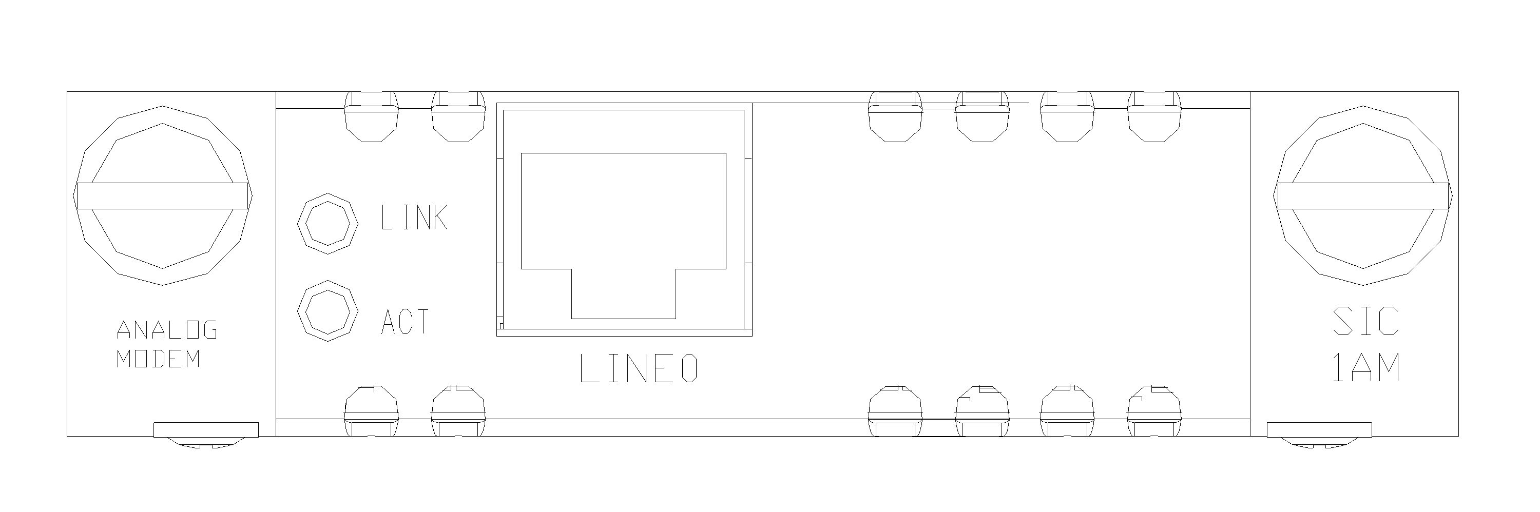

Analog modem interface modules

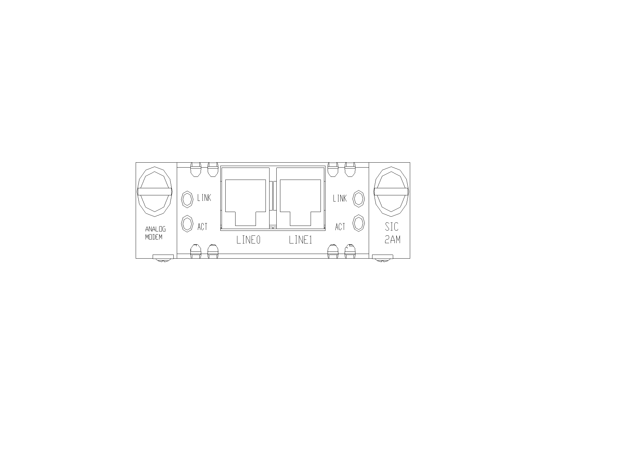

· SIC-1AM
· SIC-2AM
SIC-1AM/SIC-2AM
Introduction
The 1/2-port analog modem interface module (SIC-1AM/SIC-2AM) integrates the functions of asynchronous interface and external modem, that is, allowing 1/2 channel(s) of remote modem subscribers to directly access the Router. They support:
· Data rate of 56 kbps.
· Accessing and handling analog signals and transmitting the processed data to the Router host through the serial interface bus. And also, processing the data received from the host and then transmitting them to the PSTN via the telephone port.
Table 34 Interface specifications
Item |
Description |
Connector type |
RJ-11 |
· 1 (SIC-1AM) · 2 (SIC-2AM) |
Cable type |
Telephone cable with ferrite core |
Maximum speed |
56 kbps |
Supported standard |
· ITU-T V.90 · K56flex · V.34 (33.6 kbps) · V.FC · V.32 bis · V.32 · V.22 bis · V.22A/B · V.23 · V.21 · Bell 212A a · Bell 103 |
Supported service |
Modem dial-up |
Interface LEDs
LED |
Description |
LINK |
· Off: The link is idle. · On: The connection has been established. · Flashing: The connection is being set up. |
ACT |
· Off: The link is idle. · Flashing: Data is being transmitted or received. |
For more information about the Ethernet interface cables and the connection methods, see "ADSL/BS/FXS/FXO/AM/FCM interface."

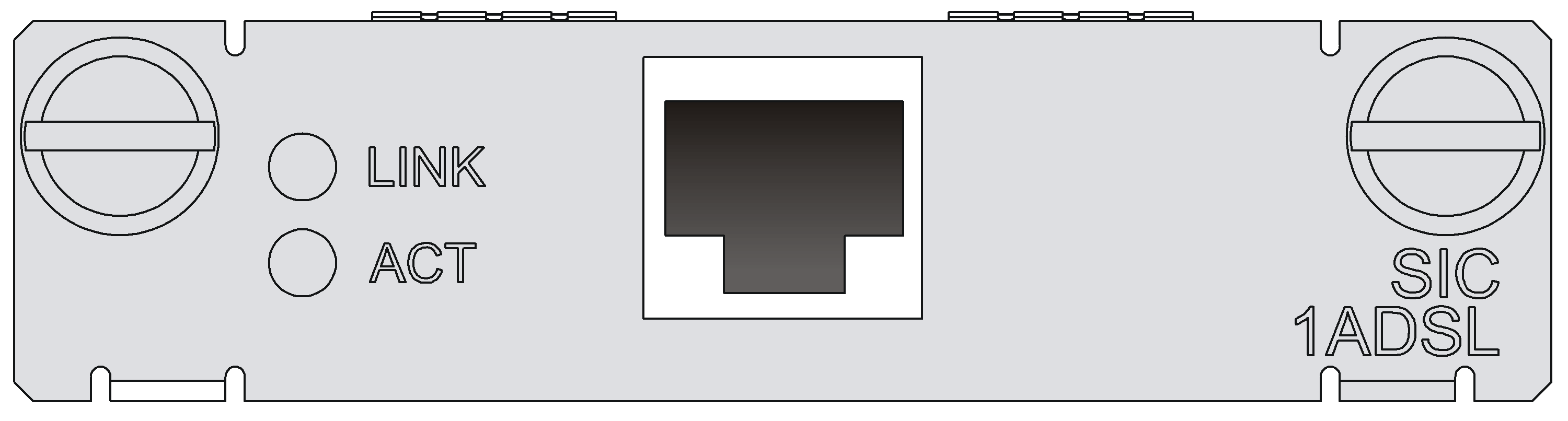

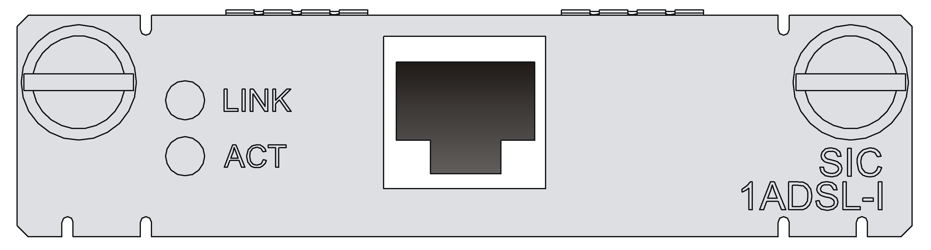

SIC-1ADSL
Introduction
The 1-port ADSL over PSTN interface module (SIC-1ADSL) provides an RJ-11 interface that can work as a WAN interface. It allows a LAN subscriber to connect to the digital subscriber's loop access multiplexer (DSLAM) at the central office over a regular analog subscriber line or telephone line. Thus, the subscriber can access the ATM/IP backbone or the Internet to enjoy services such as high-speed data communication and video on demand (VoD).
ADSL transmits data in the high frequency band above 26 kHz. Therefore, it can provide services without interfering with the voice service being provided in the low frequency band (0 to 4 kHz) on the same line. It provides downlink rates in the range 32 kbps to 8 Mbps and uplink rates in the range 32 kbps to 1 Mbps.
The SIC-1ADSL delivers these features:
· Manual ADSL line activation and deactivation, providing a convenient fault location means.
· Interface standards of G. DMT, G. Lite, and T1.413, autosensing.
· Trellis coding (except for G. Lite) on ADSL interfaces, enhancing the stability of ADSL connection.
Table 36 Interface specifications
Item |
Description |
Connector |
RJ-11 |
1 |
Interface rate |
· In ADSL full rate mode (ITU-T 992.1 G.DMT/ANSI T1.413): ¡ 8 Mbps (downlink rate) ¡ 1024 kbps (uplink rate) · In ADSL Lite mode (ITU-T 992.2 G.Lite): ¡ 64 kbps to 1 Mbps (downlink rate) ¡ 64 kbps to 512 kbps (uplink rate) · In ADSL2+ full rate mode (ITU-T 992.5): ¡ 24 Mbps (downlink rate) ¡ 1024 kbps (uplink rate) |
· ITU-T 992.1 G.DMT · ITU-T 992.2 G.Lite · ANSI T1.413 Issue 2 · ITU-T 992.3 · ITU-T 992.5 |
Cable |
Telephone cable |
Supported service |
ADSL over the regular telephone line |
Maximum received and sent frame |
1700 bytes |
Interface LEDs
LED |
Description |
LINK |
· Off: The loop is inactive. · On: The loop has been activated and has entered the data mode · Flashing: The loop is being activated. |
ACT |
· Off: No data is being transmitted or received. · Flashing: Data is being received or/and transmitted. |
For more information about ADSL interface cables and the connection methods, see "ADSL/BS/FXS/FXO/AM/FCM interface."
SIC-1ADSL-I
Introduction
The 1-port ADSL over ISDN interface module (SIC-1ADSL-I) uses the RJ-11 connector for the WAN interface. It allows a LAN subscriber to connect to the DSLAM at the central office over a regular analog subscriber line or telephone line. Thus, the subscriber can access the ATM/IP backbone or the Internet to enjoy services such as high-speed data communication and video on demand (VoD).
The module transmits data in the high frequency band above 138 kHz. Therefore, it can provide services on the same line without interfering with the ISDN service being provided on the same line. It provides downlink rates in the range 32 kbps to 8 Mbps and uplink rates in the range 32 kbps to 1 Mbps.
The SIC-1ADSL-I interface module delivers these features:
· A G.992.1-compliant interface, autosensing
· Trellis coding on ADSL interfaces, enhancing the stability of ADSL connection
Table 38 Interface specifications
Item |
Description |
Connector |
RJ-11 |
1 |
Interface rate |
Interface rate |
· Downlink: 8 Mbps · Uplink: 1024 kbps |
Interface cable |
Regular telephone cable |
ADSL over ISDN |
1700 bytes |
Interface LEDs
Figure 25 SIC-1ADSL-I panel
LED |
Description |
LINK |
ACT |

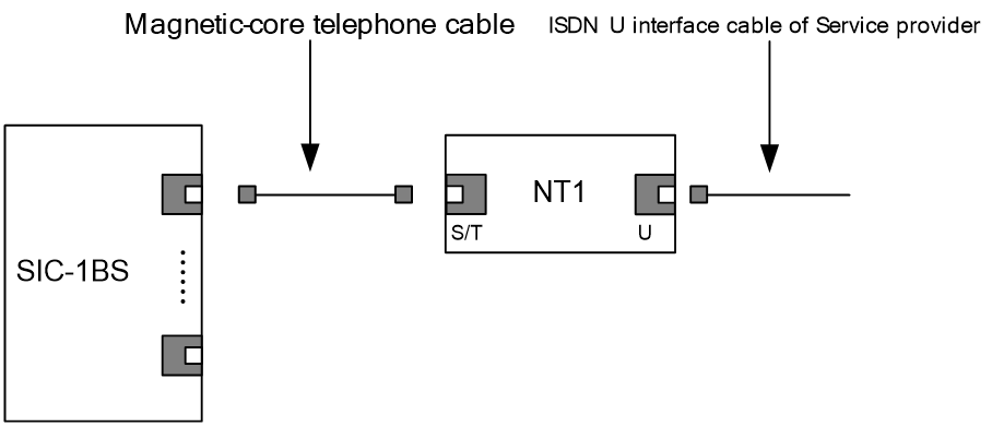

ISDN BRI interface modules
· SIC-1BS
· SIC-2BS
SIC-1BS/SIC-2BS
Introduction
The 1/2-port ISDN BRI S/T interface module (SIC-1BS/SIC-2BS) is mainly used to transmit, receive, and process ISDN BRI S/T traffic flows.
The SIC-1BS/SIC-2BS has two operating modes: dial-up and leased line.
Table 40 Interface specifications
Item |
Description |
Connector |
RJ-45 |
· 1 (SIC-1BS) · 2 (SIC-2BS) |
Cable type |
· ITU-T I.430 · Q.921 · Q.931 |
Operating mode |
· ISDN Dial-up · ISDN leased line |
· ISDN · ISDN supplementary services · Multi-subscriber number · Sub-address · Backup |
Interface LEDs
Figure 26 SIC-1BS panel
Table 41 LED description
LED |
Description |
B1 |
· Off indicates the B1 channel is idle. · Flashing indicates the B1 channel is being used for data communication. |
B2 |
· Off indicates the B2 channel is idle. · Flashing indicates the B1 channel is being used for data communication. |
ACT |
· Off indicates the inactive state. · Steady on indicates the active state. |
ON |
· Off indicates interface module is powered off. · On indicates the interface module is powered on. |
For more information about BS interface cables and the connection methods, see "ADSL/BS/FXS/FXO/AM/FCM interface."

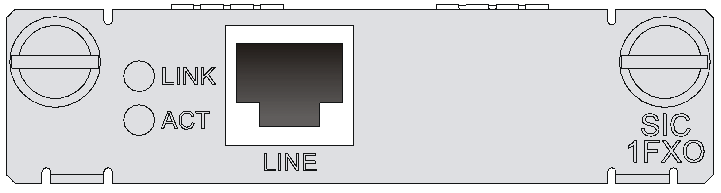

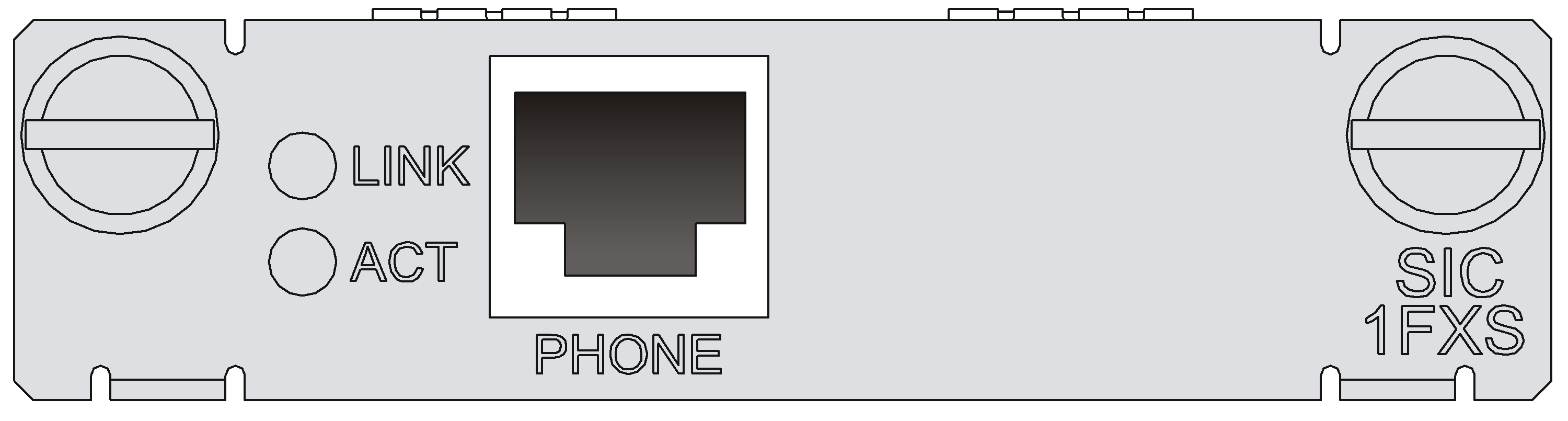

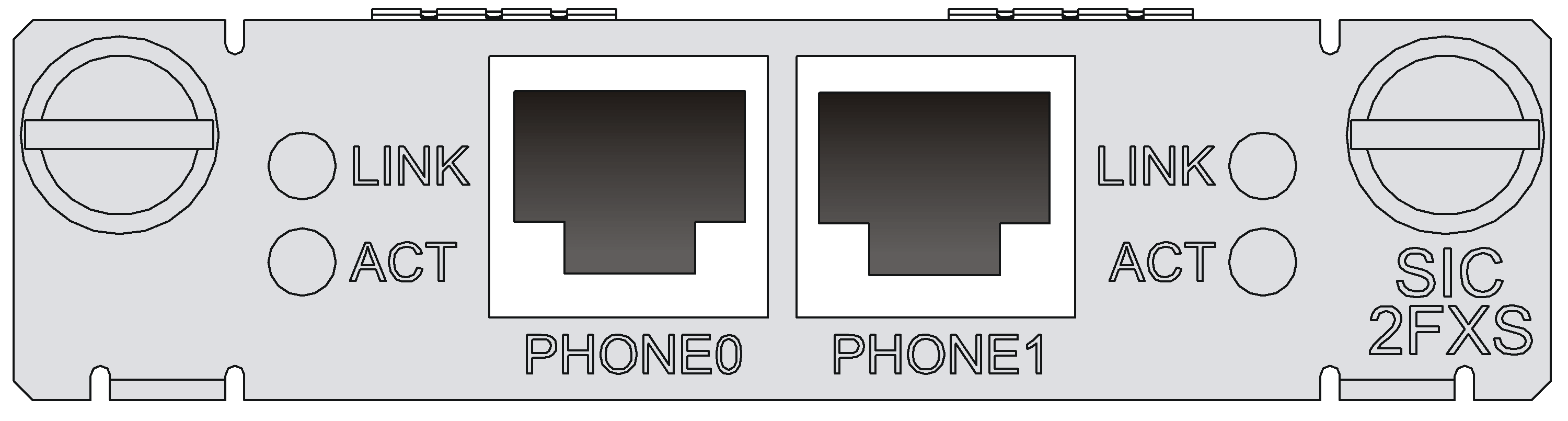

SIC-1FXS/SIC-1FXO/SIC-2FXS/SIC-2FXO
Introduction
The 1/2-port voice subscriber circuit interface module (SIC-1FXS/SIC-2FXS) and 1/2-port voice AT0 analog trunk interface module (SIC-1FXO/SIC-2FXO) serve to access and handle 1/2 channel(s) of analog voice signals over data communication networks. The differences between SIC-FXS and SIC-FXO are listed below:
· SIC-FXS modules are analog subscriber line modules that provide ordinary analog telephone and fax access and also can connect AT0 loop trunks of exchanges.
· SIC-FXO modules are loop trunk modules that provide access of common subscriber lines of exchanges.
Table 42 Interface specifications
Item |
Description |
Connector type |
RJ-11 |
1 (SIC-1FXS/SIC-1FXO) 2 (SIC-2FXS/SIC-2FXO) |
· Subscriber circuit interface (SIC-1FXS/SIC-2FXS) compliant with ITU Q.512. · Loop trunk interface (SIC-1FXO/SIC-2FXO) compliant with ITU Q.552. · Over-current and over-voltage protection compliant with ITU K.20 |
Cable type |
Telephone cable with ferrite core. |
Dialing mode |
Supports DTMF, not supports pulse dial-up. |
Bandwidth |
300 Hz to 3400 Hz |
Interface LEDs
LED |
Description |
LINK |
· Off: The link is idle. · On: The link is being occupied for call connection. |
ACT |
· Off: The link is idle. · On: The link is being occupied for communication. |
For more information about FXS/FXO interface cables and the connection methods, see "ADSL/BS/FXS/FXO/AM/FCM interface."

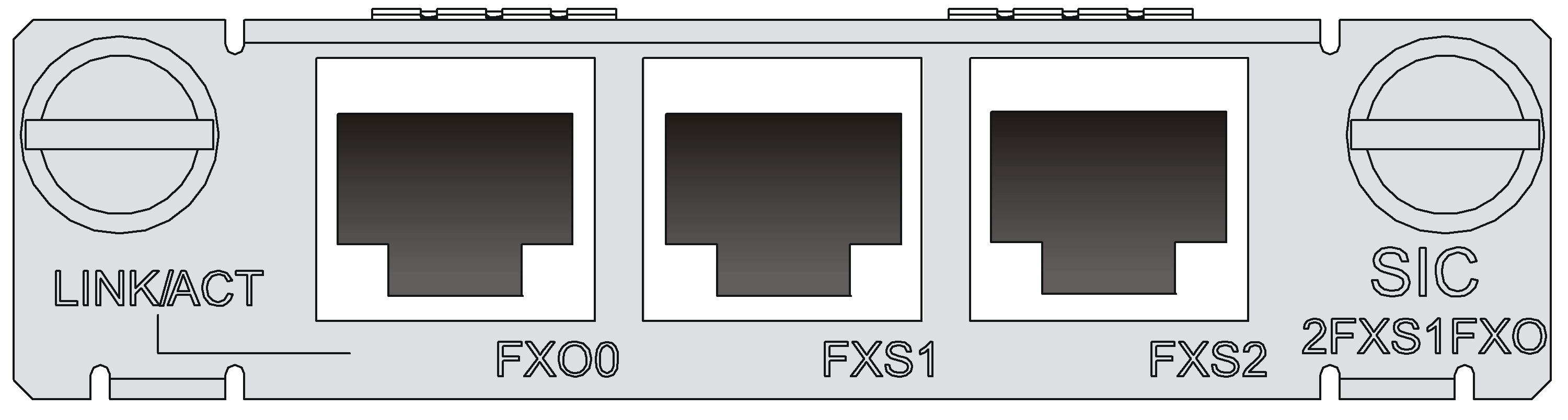

SIC-2FXS1FXO
Introduction
The 2-port analog subscriber circuit interface module and 1-port voice AT0 loop trunk interface module (SIC-2FXS1FXO) serve to access and handle three channels of analog voice signals over data communication networks. Two FXS interfaces and one FXO interface are available on a SIC-2FXS1FXO module:
· FXS interfaces are analog subscriber line interfaces that provide ordinary analog telephone and fax access and also can connect AT0 loop trunks of exchanges.
· FXO interfaces are loop trunk interfaces that provide access of common subscriber lines of exchanges.
Table 44 Interface specifications
Item |
Description |
Connector type |
RJ-11 |
2 FXS interfaces 1 FXO interface |
· Supports subscriber circuit interface (FXS), compliant with ITU Q.512 · Supports loop trunk interface (FXO), compliant with ITU Q.552 · Over-current and over-voltage protection compliant with ITU K.20 |
Cable type |
Dial-up mode |
Supports DTMF, compliant with GB3378, but does not support pulse dial-up. |
Bandwidth |
300 Hz to 3400 Hz |
Interface LEDs
Figure 32 SIC-2FXS1FXO panel
Table 45 LED description
LED |
Description |
LINK/ACT |
· Off: The link is idle. · Steady green: The link is being occupied for call connection. · Flashing yellow: The link is being occupied for communication. |

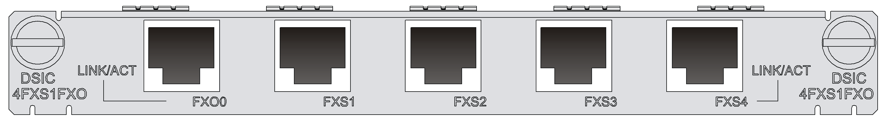

DSIC-4FXS1FXO
Introduction
The 4-port analog subscriber circuit interface module and 1-port voice AT0 loop trunk interface module (DSIC-4FXS1FXO) serve to access and handle five channels of analog voice signals over data communication networks.
Table 46 Interface specifications
Item |
Description |
Connector type |
RJ-11 |
4 FXS interfaces 1 FXO interface |
Cable type |
Dial-up mode |
Bandwidth |
300 Hz to 3400 Hz |
Interface LEDs
Figure 33 DSIC-4FXS1FXO panel
Table 47 LED description
LED |
Description |
LINK/ACT |

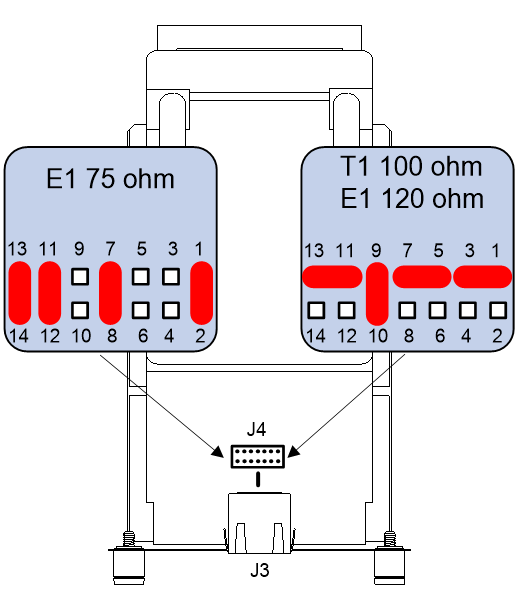

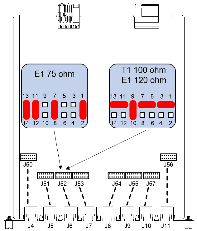

SIC-1VE1T1
Introduction
The 1-port E1/T1 voice interface module SIC-1VE1T1 handles dense voice signals in VoIP and FoIP systems. The E1 module transmits, receives, and processes E1 voice signals. It allows the interface to operate in CE1 mode or ISDN PRI mode to process a maximum of 30 channels of voice signals. The T1 module transmits, receives, and processes T1 voice signals. It allows the interface to operate in CT1 mode or ISDN PRI mode to process a maximum of 23 channels of voice signals.
You can use command lines and a jumper to configure the interface as a 75-ohm E1 interface, 100-ohm T1 interface, or 120-ohm E1 interface. By default, the interface is a 75-ohm E1 interface.
· To configure the interface as a 75-ohm E1 interface, connect the jumper to pins 1 and 2, pins 7 and 8, pins 11 and 12, and pins 13 and 14.
· To configure the interface as a 100-ohm T1 or 120-ohm E1 interface, connect the jumper to pins 1 to 3, pins 5 to 7, pins 9 and 10, and pins 11 to 13.
Figure 38 Jumper connecting methods

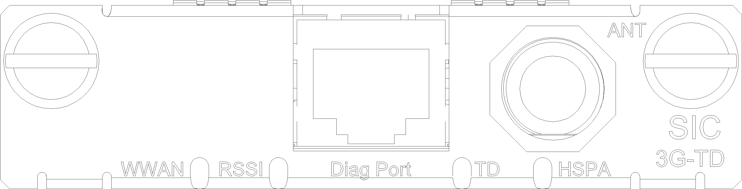

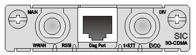

3G interface modules
· SIC-3G-CDMA
· SIC-3G-TD
· SIC-3G-HSPA
SIC-3G-CDMA
Introduction
The SIC-3G-CDMA module is used to access 3G WLANs. It supports:
· CDMA 2000 1x RTT
· 1x EV-DO Rev.0
· 1x EV-DO Rev.A
Table 56 Interface specifications
Item |
Description |
Connector type |
· TNC RF: Antenna for accessing WLANs. · RJ-45: For connecting to a third-party WLAN debugging and testing software such as CAIT of Qualcomm. |
· 2 TNC RF · 1 RJ-45 |
· TNC RF: Omni antenna, supporting CDMA 2000 1 No RTT, 1 No EV-DO Rev.0, 1 No EV-DO Rev.A. · RJ-45: RS-232 |
Cable type |
· TNC RF: None · RJ-45: AUX cable |
Rates |
Network standards: · 1 No EV-DO Rev.A (Downlink: 3.1 Mbps, uplink: 1.8 Mbps) · 1 No EV-DO Rev.0 (Downlink: 2.4 Mbps, uplink: 153.6 Kbps) · 1 No RTT (Downlink: 153.6 Kbps, uplink: 153.6 Kbps) |
Services |
· CDMA 2000 1x RTT · 1 No EV-DO Rev.0 · 1 No EV-DO Rev.A |
Interface LEDs
Figure 40 SIC-3G-CDMA panel
Table 57 LED description
LED |
Description |
WWAN |
· Steady green indicates that a link is present. · Flashing green indicates that data is being transmitted or received. |

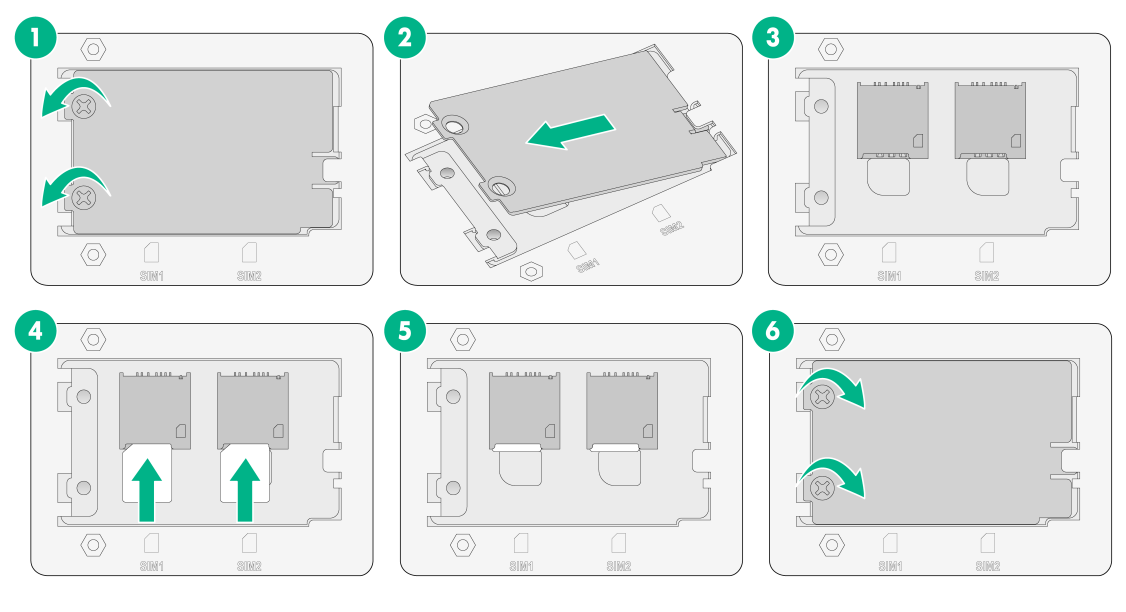

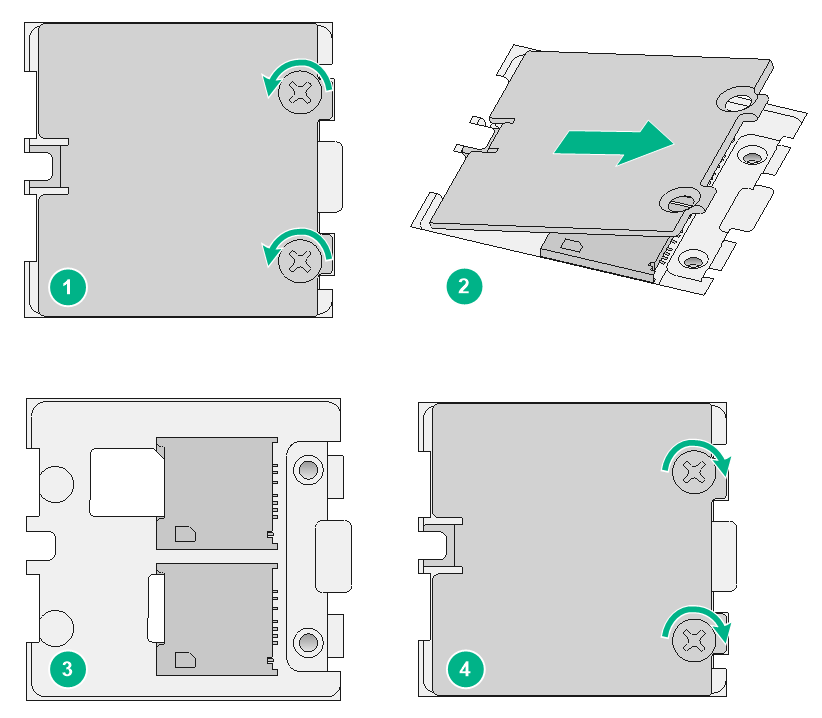

Installing Micro SIM card
CAUTION: Make sure the beveled corner of the Micro SIM card is oriented as indicated by the Micro SIM card icon. |
The SIC-4G-CNDE interface module supports Micro SIM cards.
The SIC-4G-CNDE has two Micro SIM card slots, but only one is active at a time. If you install SIM cards in both slots, the SIM1 slot 1 is active, the SIM2 slot is in standby state by default. To perform an active/standby switchover, execute the sim switch-to command. For more information about the command, see Layer 2—WAN Access Command Reference for the product.
To install a Micro SIM card:
1. Use a Phillips screwdriver to remove the two screws on the SIM card retainer cover.
2. Lift the cover up and away from the retainer.
3. Insert SIM cards into the SIM card slots on the retainer.
4. Reattach the retainer cover and use the two screws to secure the cover.
5. Execute the display cellular [ interface-number ] command after the router is started. If "SIM Status = OK" is displayed in the output information, the Micro SIM card is identified.
Figure 45 Installing Micro SIM cards
